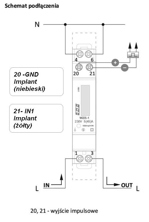

    I have an energy meter WZE1 with pulse output (open collector) and I would like to connect it to the Fibaro HC2 control panel via Universal Binary Sensor
    FGBS-001 to which I currently have 4 DS18B20 temperature sensors connected.
    From what I have found on the web, it is possible to connect such a counter through the IN1 or IN2 input of the Universal Binary Sensor, I have made such a connection,
    universal Binary Sensor counter
    (20) SO+ > GND (blue)
    (21) SO- > IN1 (yellow)
    When GND is shorted to IN1, the application shows a change of state, i.e. the Sensor is working , but when connected to the counter there is no reaction. I have tried with different settings in the Sensor interface with no result.
    Please tell me what to improve .
    Connection diagram of WZE-1 energy meter to Fibaro UBS using pulse outputs 20 and 21

    And swap the polarity of SO- to GND, SO+ to IN1

    Well, then check with a meter whether this output from the meter is still alive, because you may have lost it.
    Or the signal lasts too short for your module to notice the pulse.

    It's alive, I have a second one with the same counter and between the SO+ and SO- connectors there is the same value of 0.22V and when the diode blinks it drops to 0.12V. When I connect the Sensor the voltage is 2.80V and when the diode blinks it drops to 2.5V, it seems that this is definitely not enough to drive the IN1 input, it seems that it should be below 1V for the Sensor to treat this as a short circuit.

    The signal may be too short, an oscilloscope would be useful.

    Exactly -the signal is too short .
    I have connected a 12V relay powered by a 12 v power supply to the SO- and SO + connectors and on the contact side I have connected to IN1 and to ground , the Universal Implant counts the pulses .
    To make it not so good it loses pulses , the counter gives a pulse of 90 ms and you need 200-300 ms .
    How to get a longer pulse but the simplest way.
  • #8 21817363
    stach2005
    Posts: 211
    Rate: 24
    I bought a 12V NE555 time relay module , triggered by ground and it counts without any problem .I set the pulse duration to about 500 ms.
