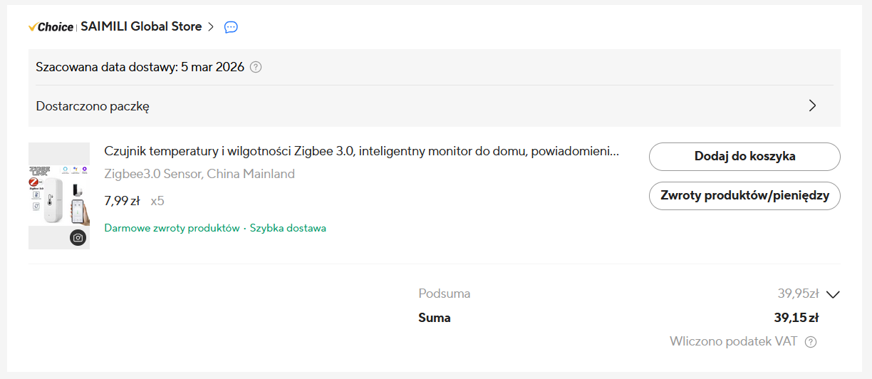

    I recently bought on Aliexpress extremely cheap temperature and humidity sensors powered by two AAA batteries and communicating via Zigbee. The price of one unit was less than PLN8 - and that's probably their only advantage.
    AliExpress order screenshot showing a Zigbee 3.0 temperature and humidity sensor listing
    Even before the package arrived, some rather interesting comments started appearing on the product page. Standard ones like " ***** are great! but I haven't checked yet " and " * crap, doesn't work! ", suggesting that some buyers had not read that the device required a Zigbee gateway. Others began to appear, with very poor range, self-disconnection, and incorrect indications. There was even one with pictures of the device board, which.... was about 1/3 the size of those in older versions.

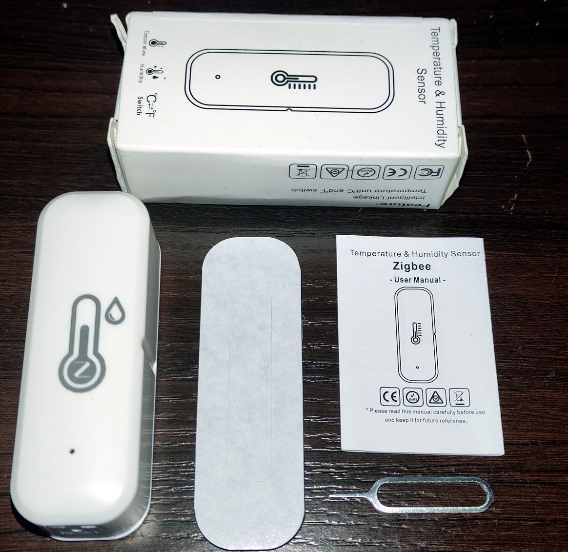

    Eventually, the thermometers arrived. A standard cardboard box, and in it: a brief manual, foam with adhesive tape for assembly, a key for the reset button and the device itself.
    Right out of the box, you can see that this is budget equipment. The plastic gives the impression of being of inferior quality - it is not perfectly white, rather slightly creamy and seems to be softer.

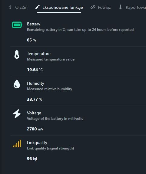

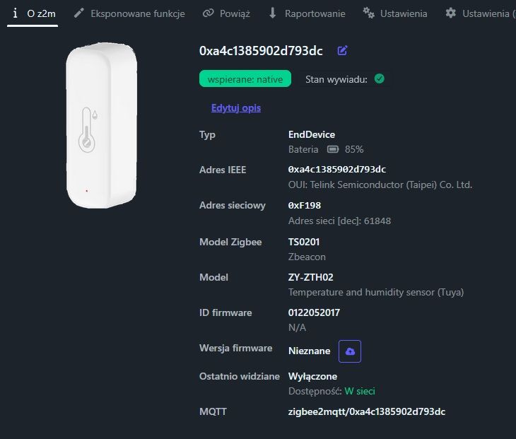

    After inserting the rechargeable batteries, I paired the device with the Zigbee2MQTT I was using. The sensor was detected without any problems and reported itself as ZY-ZTH02.
    The Z2M detected the basic entities:
    - temperature
    - humidity
    - battery percentage
    - battery voltage
    - signal level
    Zigbee2MQTT device page showing a white sensor and details for model ZY‑ZTH02 Zigbee2MQTT screenshot showing sensor values: battery, temperature, humidity, voltage, and link quality.
    At this stage everything looked correct.

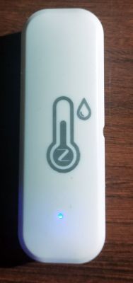

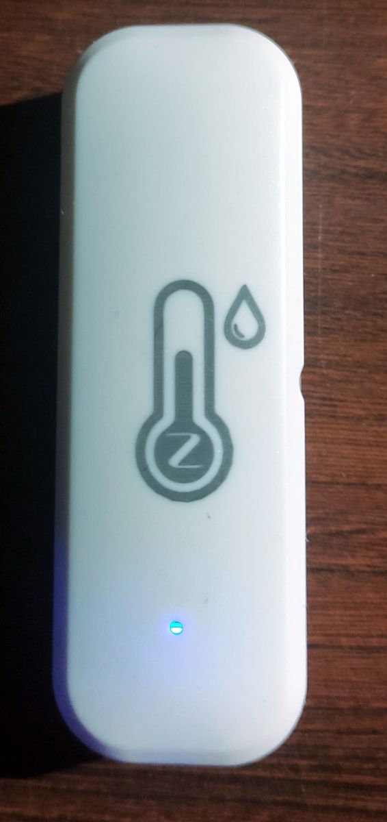

    The only thing I noticed was the use of a blue LED instead of a red one. Blue LEDs require a higher voltage, so I'm curious to see how this LED will behave with heavily discharged batteries.
    White temperature and humidity sensor with thermometer and droplet icons on a wooden surface
    The temperature and humidity readings update very quickly - presumably the measurement is sent every time the value changes. This will have an impact on battery life, but for now it is difficult to assess how much.

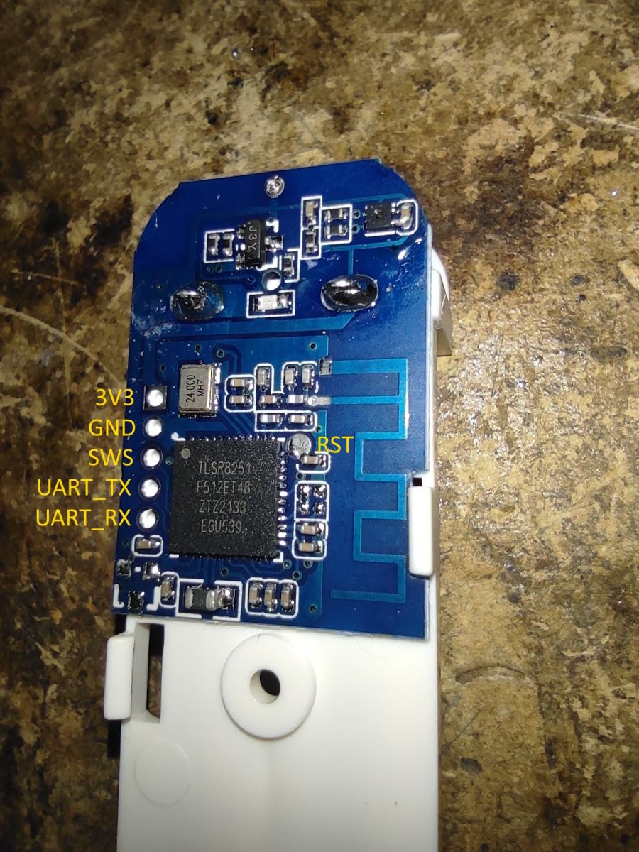

    Of course, I also took a look inside. The thermometer comes apart very easily, it just snaps on either side. Inside is a small blue plate - already familiar to me from the photos in the comments.
    However, I was now able to read what components were used there. The main circuit is most likely the original Telink TLSR8251 in a 48-leg case. And on the board itself, the soldering points needed for its programming have been brought out.

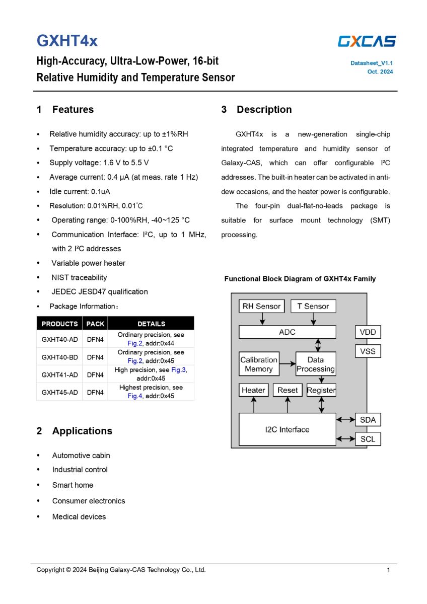

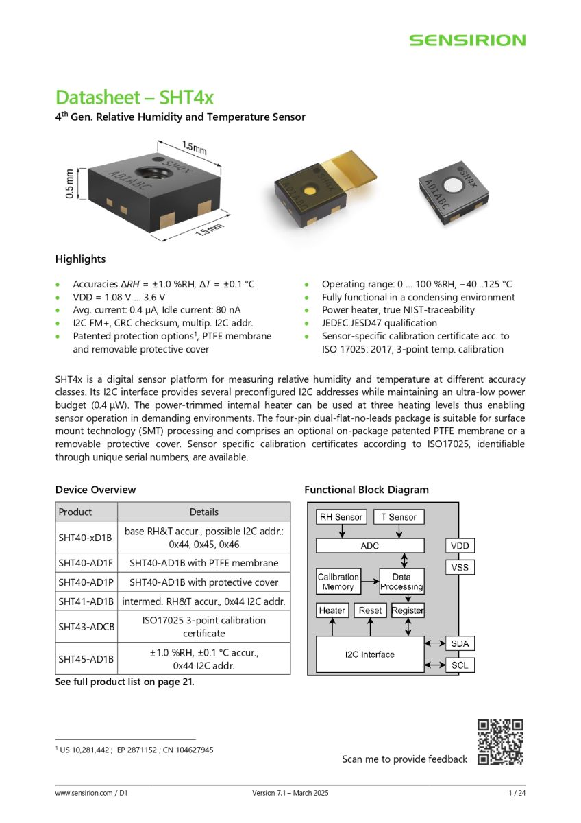

    The situation with the temperature and humidity sensor is much worse. Instead of the Sensirion SHT40 chip, its Chinese equivalent GXHT40 was used, labelled G40 or GV4, depending on the model. In addition, the sensor was placed at the side edge of the board rather than centrally opposite the holes in the housing.
    According to the documentation, the performance of the GXHT40 is only marginally worse than the original. In practice, it unfortunately looks worse.
    Cover page of Sensirion SHT4x datasheet with sensor renderings and key specifications Screenshot of GXHT4x datasheet page with feature list and a functional block diagram

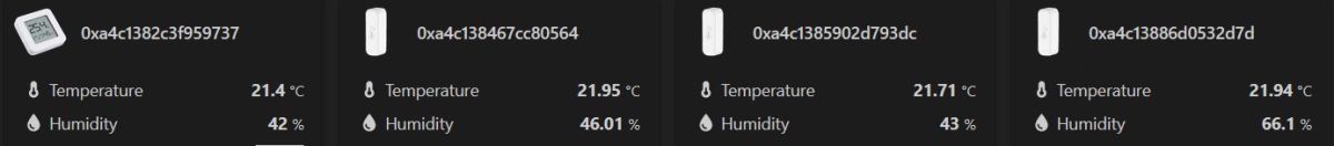

    The differences in temperature readings between the units purchased were around 0.5°C, so still acceptable. In the case of humidity, on the other hand, discrepancies could exceed 20%.
    Admittedly, Zigbee2MQTT enables calibration of the readings, but such differences are a good indication of the quality of the sensors used.

    So you can try uploading new software. To play with, I took the copy with the largest scatter of indications. The OTA update unfortunately failed - there was a non-response error. I don't know if this was due to a bad file header or a lack of OTA support on this unit.
    This left the programmer. As with previous devices on Telink, I used TlsrComSwireWriter and a USB-TTL adapter for the CP2102. I first ripped the original firmware so that I could have a return.
    PCB of a Zigbee sensor with TLSR8251 chip and labeled pads: 3V3, GND, SWS, UART_TX, UART_RX, RST
    I then uploaded the file ZBTH01_v0134.bin and rebooted the device. The LED started flashing - but it looked more like a CPU reboot than a pairing mode. On the factory fw the LED then flashed quickly evenly. However, I clicked on Z2M connecting a new device and this was added as TH01-z. Unfortunately, it turned out once again that Z2M does not have a ready-made configuration for this firmware. So I had to add it manually in external_converters .

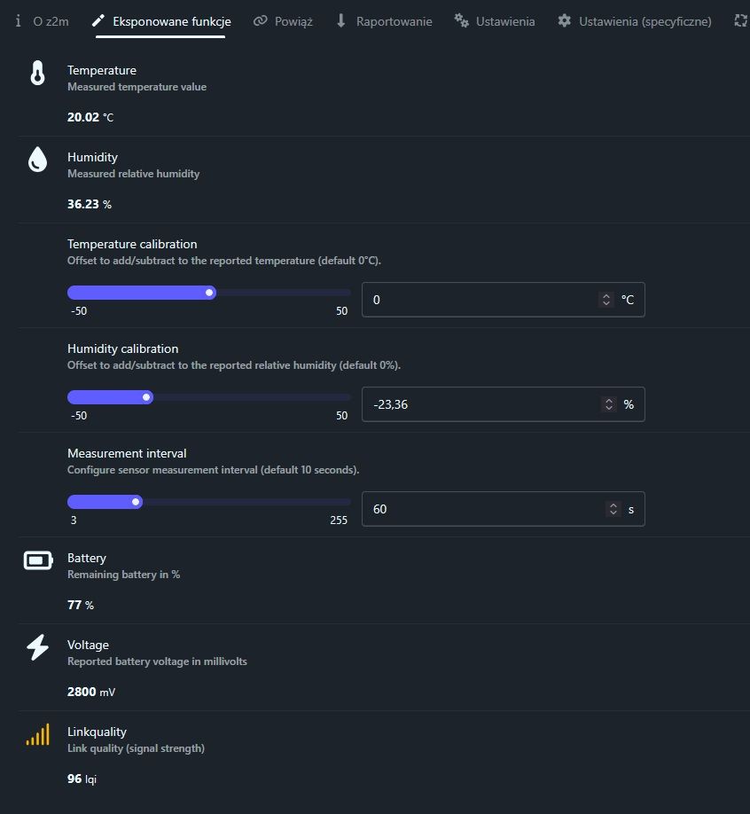

    After adding the configuration, additional options appeared:
    - temperature calibration
    - humidity calibration
    - setting the reporting frequency
    Zigbee2MQTT screenshot showing temperature, humidity, and calibration sliders
    For clarification I would like to add that these calibrations work at the device level, i.e. the corrected values are already sent out. In addition to this, the Z2M itself has calibration options in the "Specific settings" tab, but those there simply improve the Z2M.
    I am testing one piece for now and it looks like the firmware is working fine. It will also be possible to assess the battery life against the factory firmware after more time.

    In fact I even confirmed this by uploading the firmware from pvvx, which is under SHT40 and also reads the values from GXHT40 correctly.
    popek9 wrote:
    I have several pieces of such sensors at home on BT and Zigbee, 2 pieces I put outside to have temperature measurement outside. Unfortunately for the last few months they only work when the temperature is above 0 °C. In the ad, the temperature measurement range in one bid was stated as -10 to 50 °C and in another from -20 to 60 °C
    Generally the sensors are cool, I did not notice any great divergence in the measurements, the differences between the sensors were max 0.2 °C and 0.5 % humidity. At a price of up to PLN10 I think you will not get anything better, and the extra charge for the more expensive company xiaomi is not worth it.
    Meaning you don't have exactly those, just similar ones. What is inside is unknown.
    Both the original SHT40 and the Chinese ones according to the specifications should measure temperatures down to -40°C. It is just not yet known what the Chinese might have tampered with in the firmware. I put mine outside a couple of days ago to still check the humidity measurement, as it varies more outside than indoors. The frost is gone, so all I managed to record was about -1°C.
    If you want to play around, you can take one of those thermometers that don't show negative temperatures apart and look for it, maybe it's one of the versions supported by the firmware: https://github.com/pvvx/ZigbeeTLc
    Might work better than the factory fw.
    Even the Xiaomi Mija 2 comes in several hardware versions and from what I have found they can also have a replacement instead of the original SHT40, only that maybe in a better design.
