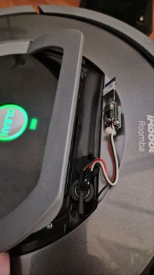

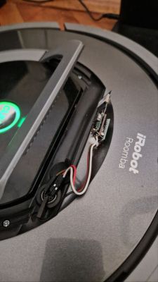

  • iRobot Roomba with open top flap and visible circuit board, near a docking station on a floor

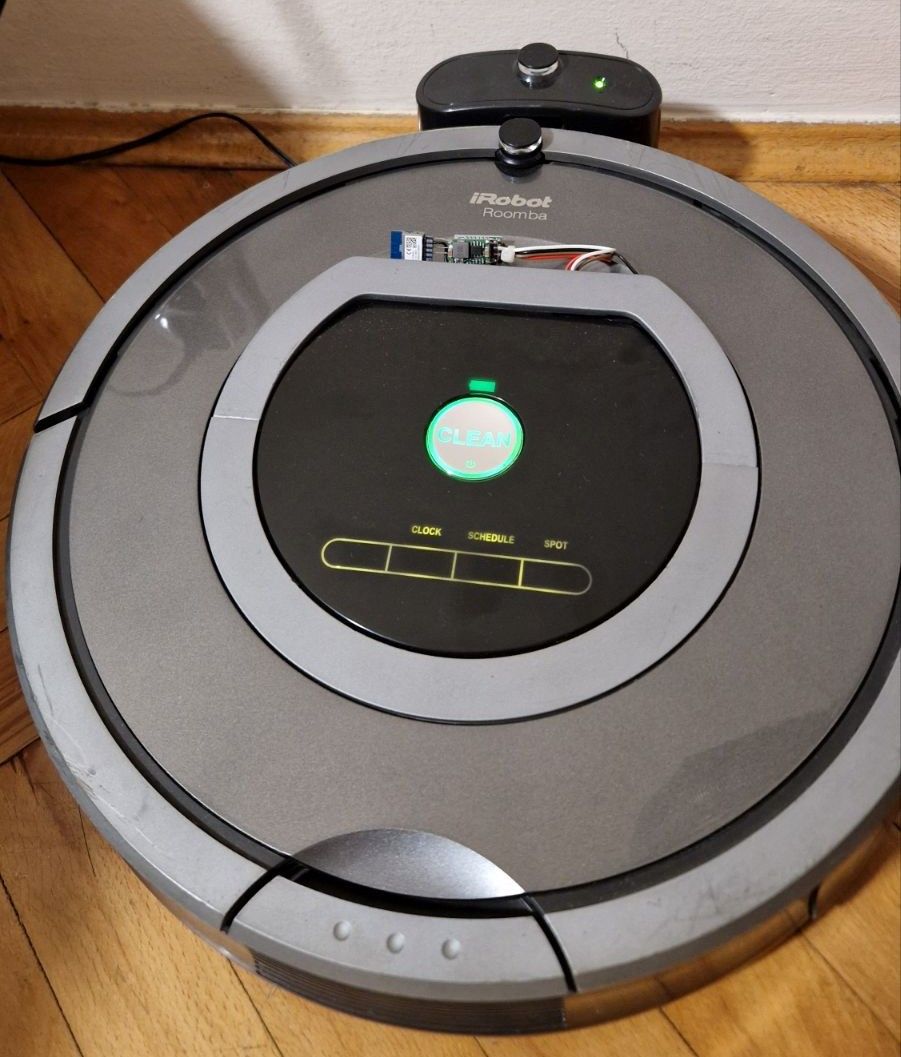

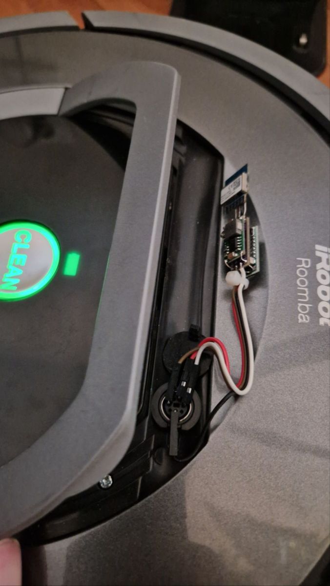

    Here I will show how to make and connect a custom remote control module for iRobot Roomba 500-800 series hoovers. The control will be via Wi-Fi and will offer ready integration with Home Assistant via MQTT. The hoover modified in this way will be able to work according to a schedule, follow sent commands and will operate fully cloudless. This solution is particularly useful for older Roomba models that do not have factory network connectivity.

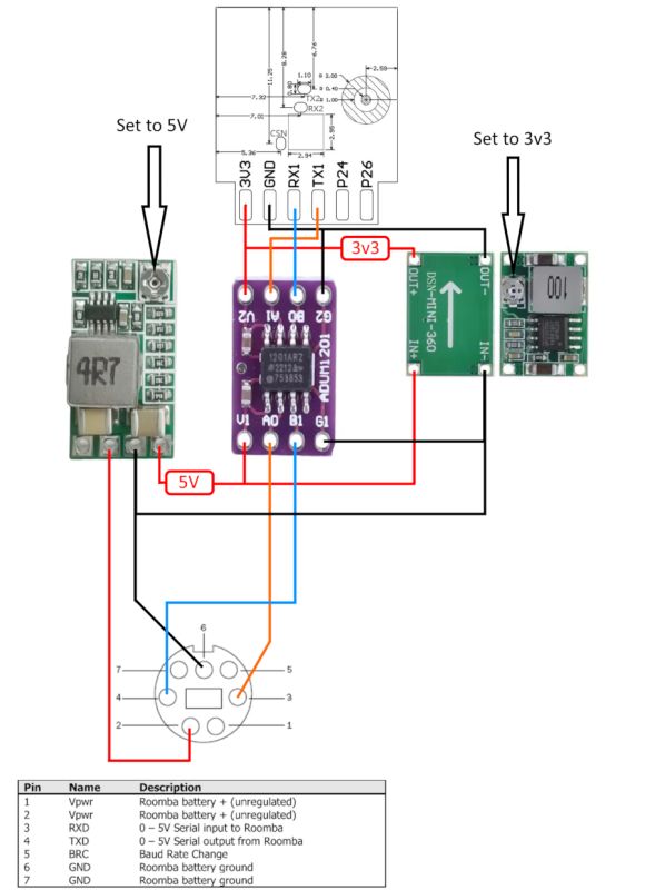

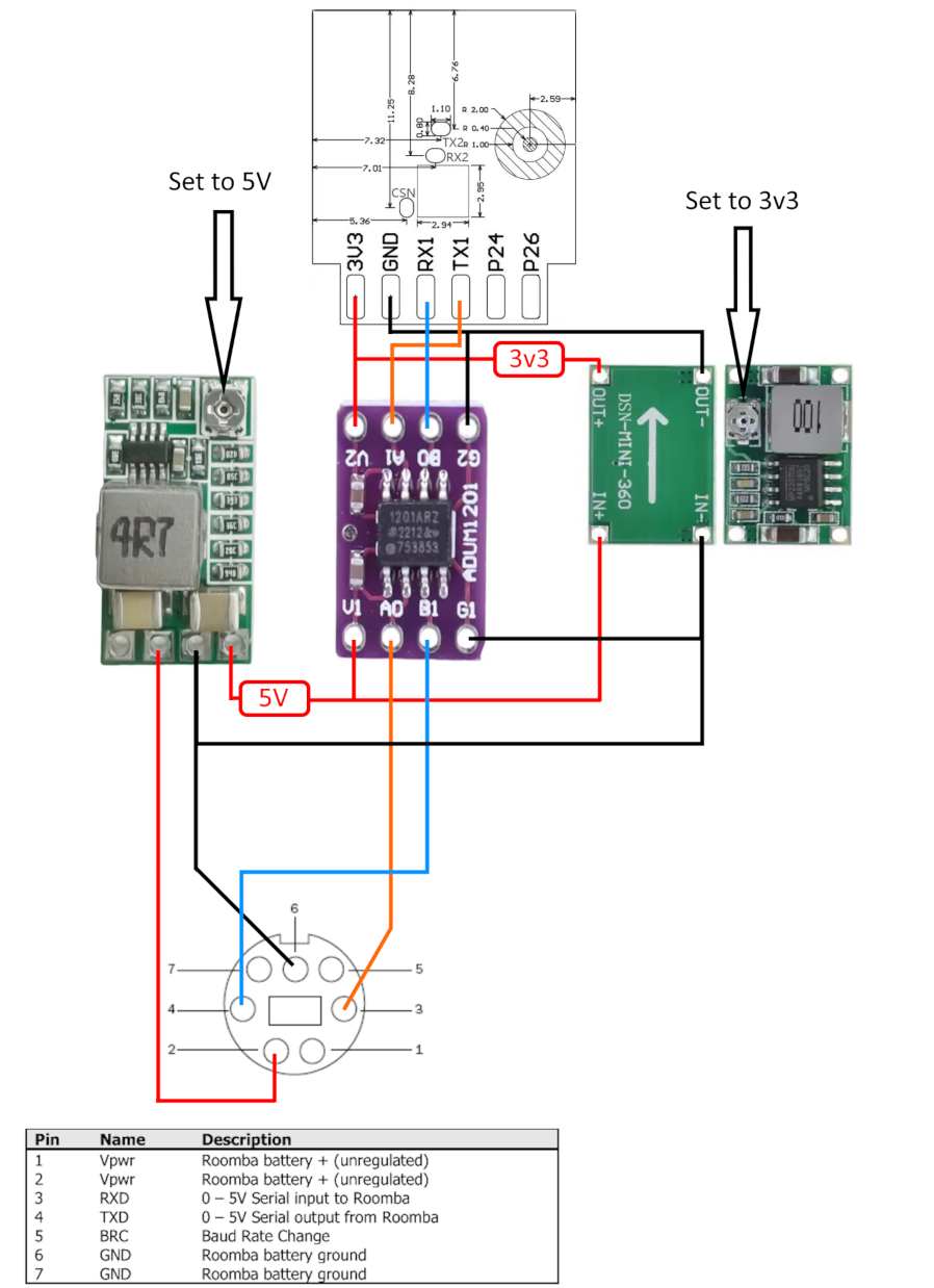

    Hardware required
    We have implemented the project in our environment on 33+ platforms , so you will need some supported Wi-Fi module. You can check the support status on the repository but in the big picture, some sort of Beken or ESP32 will probably suffice. You'll need inverters from the power supply (because we have battery voltage on the connector from the Roomba) and a UART level converter, as in the diagram:
    Wiring diagram of Wi‑Fi module with UART level shifter and 5V/3.3V power for an iRobot Roomba connector

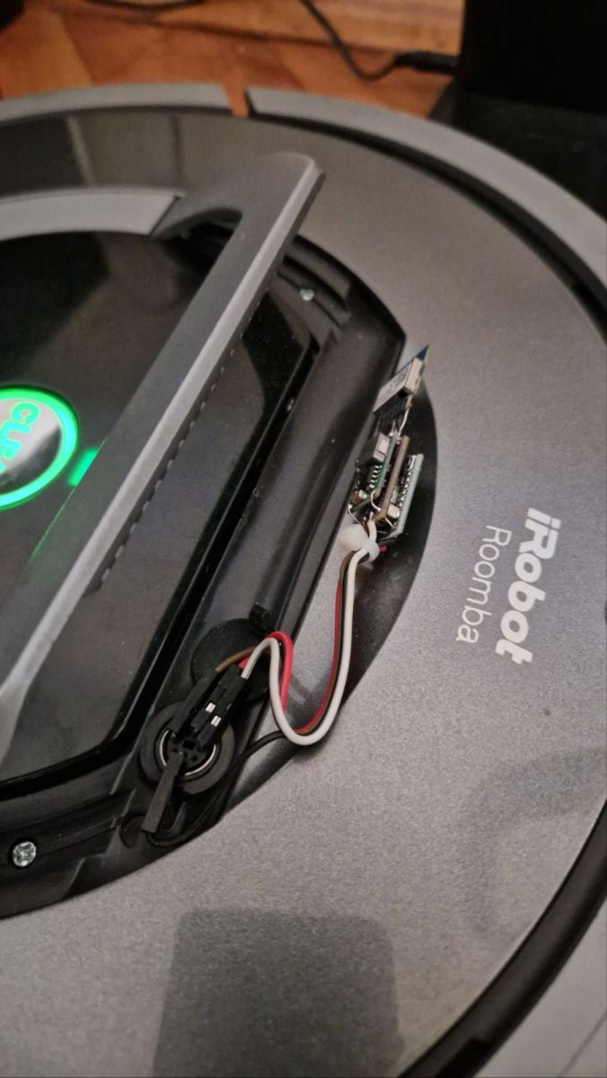

    The logic level converter is needed because the Roomba's UART interface works with voltages different from most common Wi-Fi modules. Without it, a direct connection could lead to damage to the microcontroller or unstable communication. We managed to sandwich the module together.
    iRobot Roomba vacuum with exposed small circuit board and red, white, and black wires Inside an iRobot Roomba with a small electronic module and wires connected near the compartment

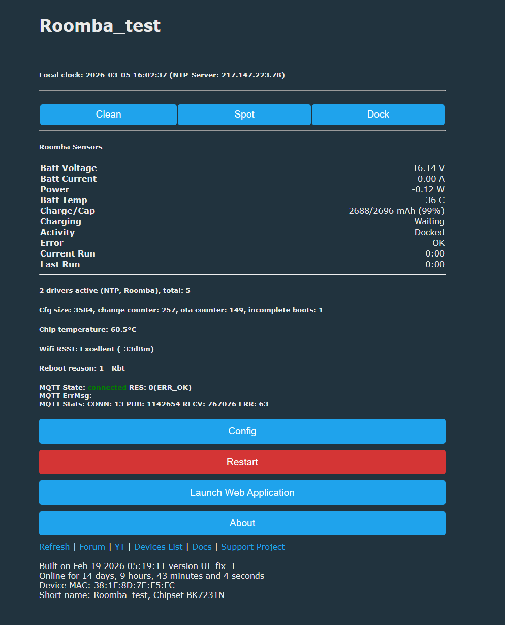

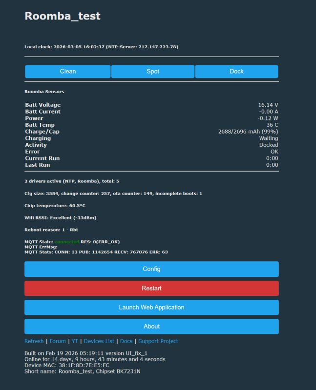

    We should get the controls on the device web page:
    Screenshot of “Roomba_test” web UI with Clean/Spot/Dock buttons, sensor readouts, and MQTT status
    From the web interface you can also check the status of the UART connection and verify that the hoover is responding to the commands sent by the firmware.

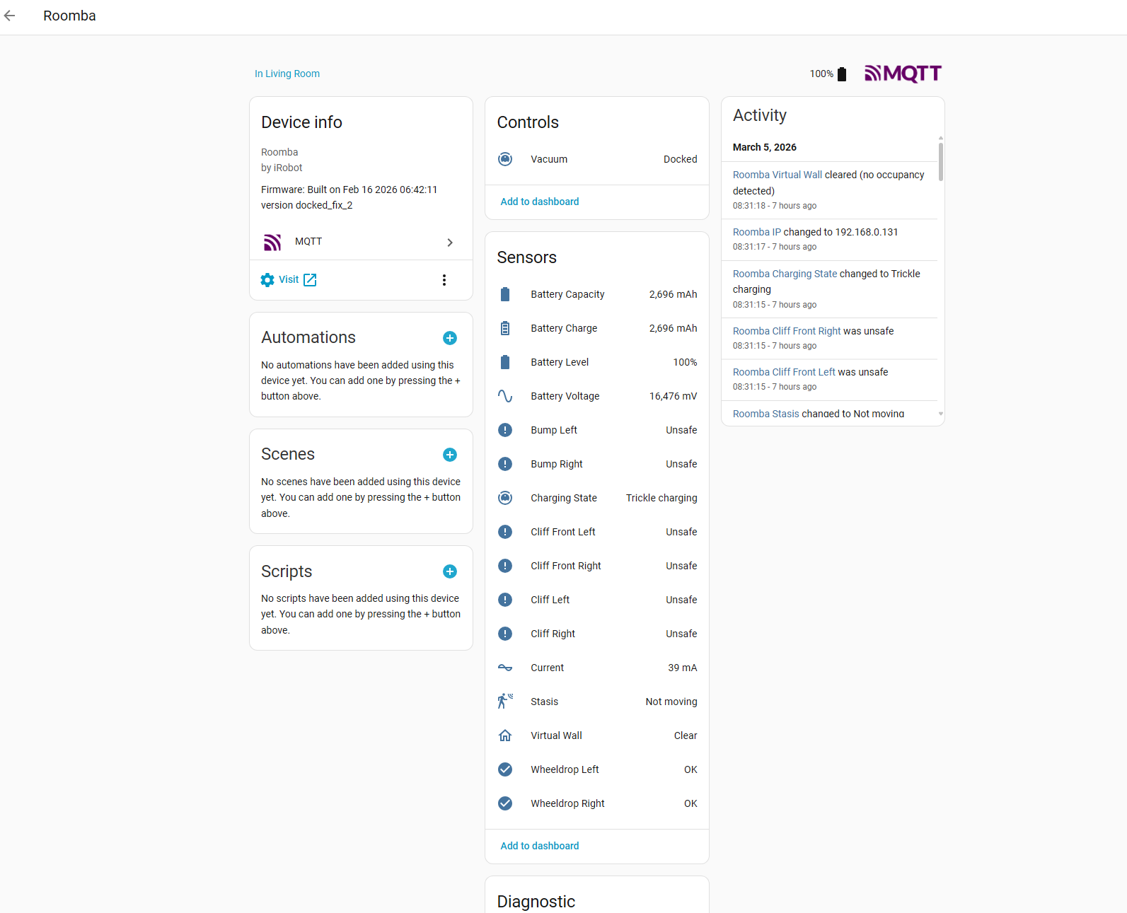

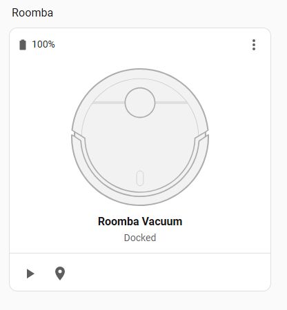

    Integrate Home Assistant
    It is enough to perform the classic HASS Discovery, as on other OBK devices:
    This way we get full readings in Home Assistant, together with correct integration of the vacuum cleaner .
    Home Assistant screenshot: Roomba via MQTT with battery sensors, controls, and activity log

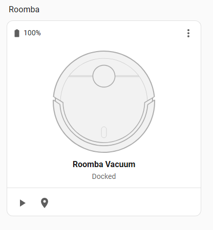

    This gives us dedicated controls, docking status, etc:
    Home Assistant card “Roomba Vacuum” with robot vacuum icon, “Docked” status, and 100% battery

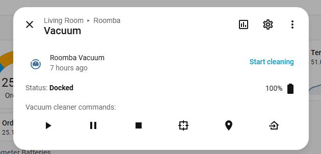

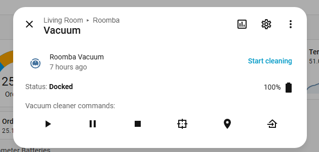

    Once the device has been correctly detected in Home Assistant, it will appear as a vacuum entity. This makes standard HA services such as start, stop, return to base or cleaning mode available.
    Home Assistant “Vacuum” card for Roomba showing Docked status, 100% battery, and control buttons
