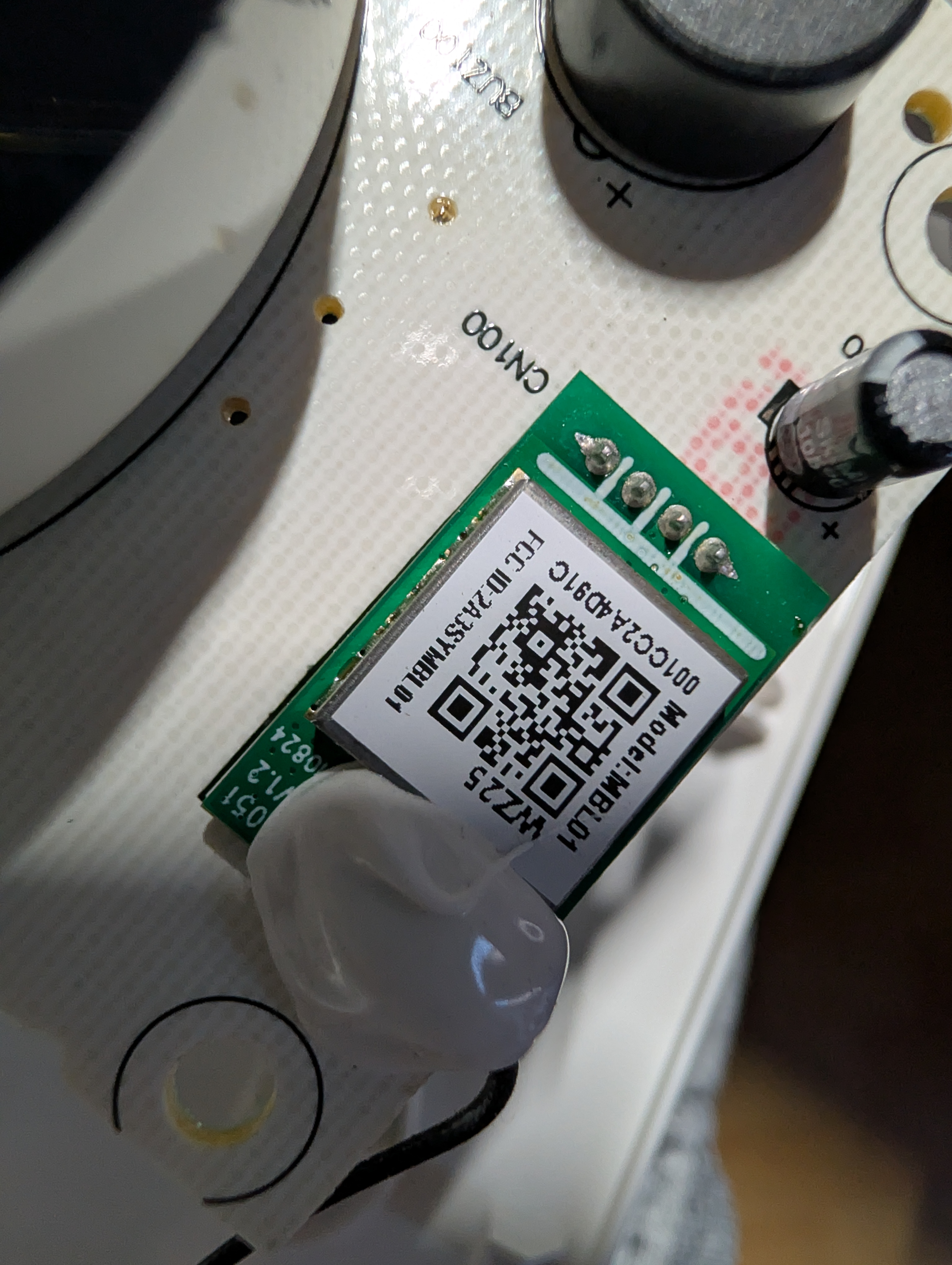

How can I cloud-cut the Dreo 517s wall heater, identify its Beken module, and back up/flash its firmware safely?
The heater appears to use a Hesung Innovation Limited MBL01 / BL2028N Beken module, and the suggested backup path is to treat it like a Beken/Tuya device: dump the stock flash first with BK7231GUIFlashTool/Easy Flasher, using TX1/RX1 for flash read/write and TX2 for logs, then restore the RF partition if OBK won’t connect because the dump showed RF at 0x1E0000 while OBK expects 0x1D0000 [#21856107] [#21856302] [#21857178] The UART protocol is TuyaMCU-like but not identical: frames start with 0x55 0xAA 0x00 , the sequence increments from 0 after boot, and the checksum is roughly (sequence + sum(payload bytes) - 1) % 256 [#21856296] The live capture showed a 10-second heartbeat/ping-pong, with full status frames carrying all datapoints, and the parsed DPs included power, operating mode, submode/context, target temperature, and several mode flags/constants [#21856296] [#21856379] A Dreo-specific driver/repo already appeared on GitHub, and an early OpenBeken port was put into PRs, so the path forward was to use that driver instead of reverse-engineering everything from scratch [#21856568] [#21868387] [#21857261]

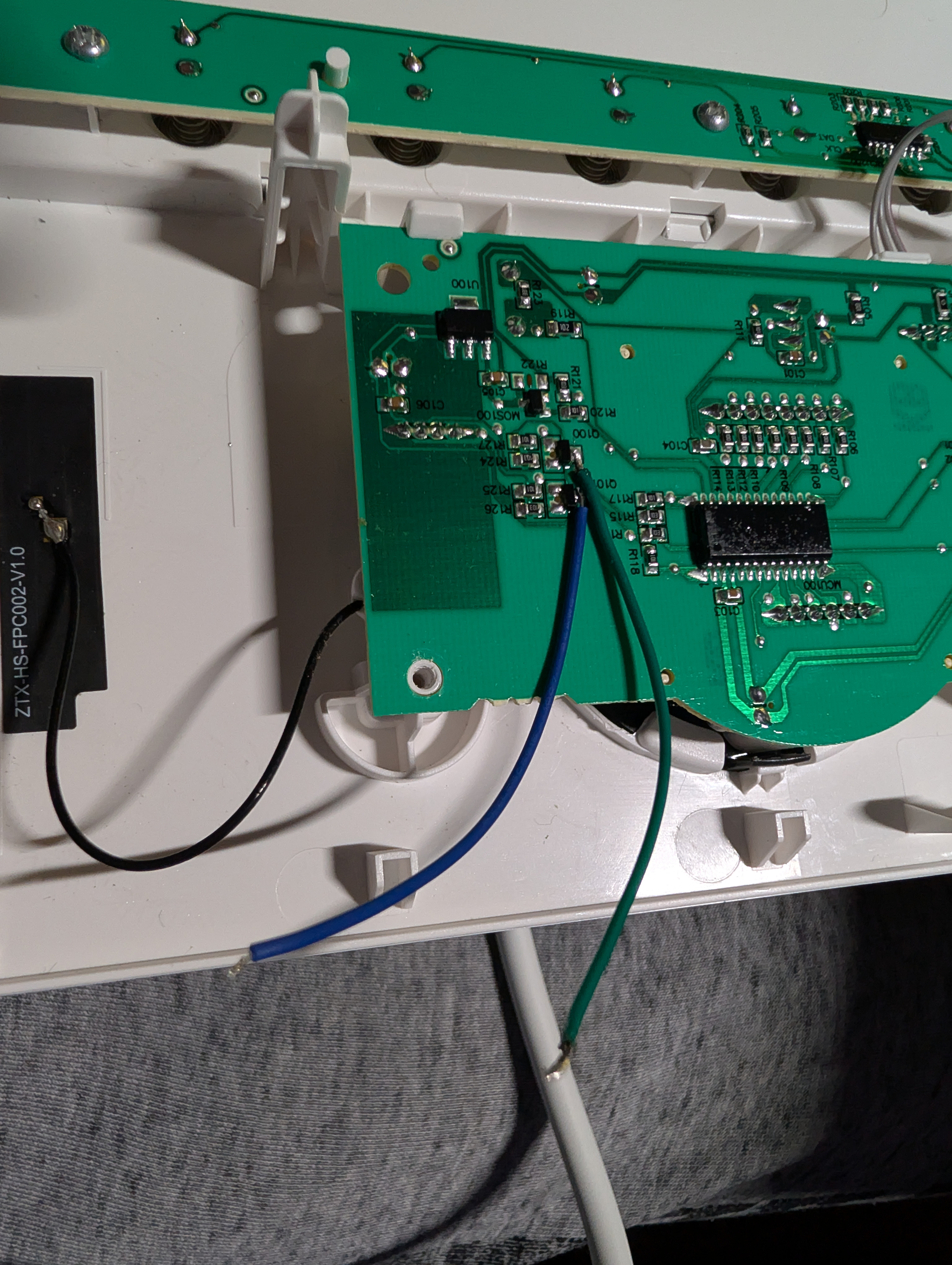

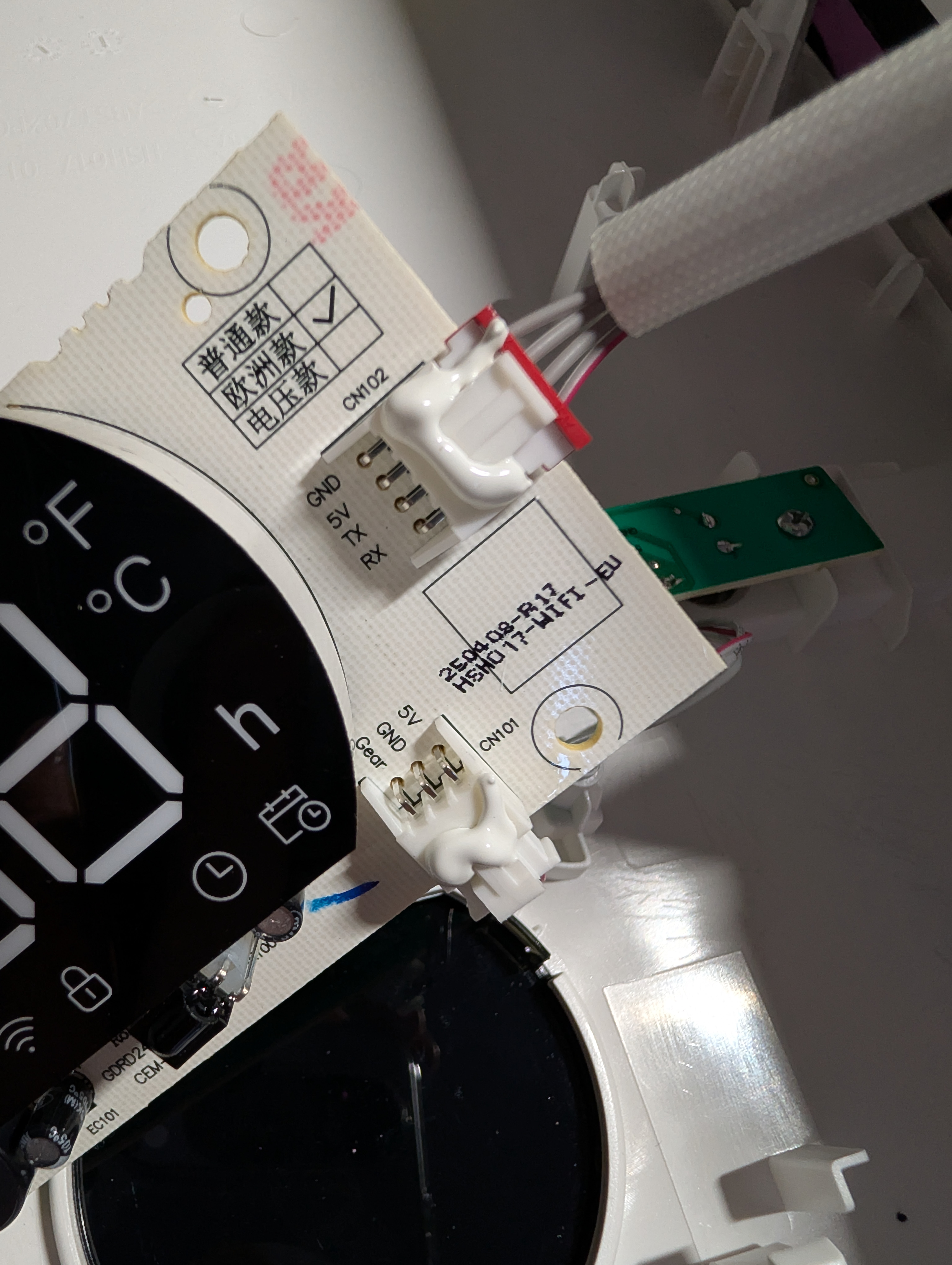

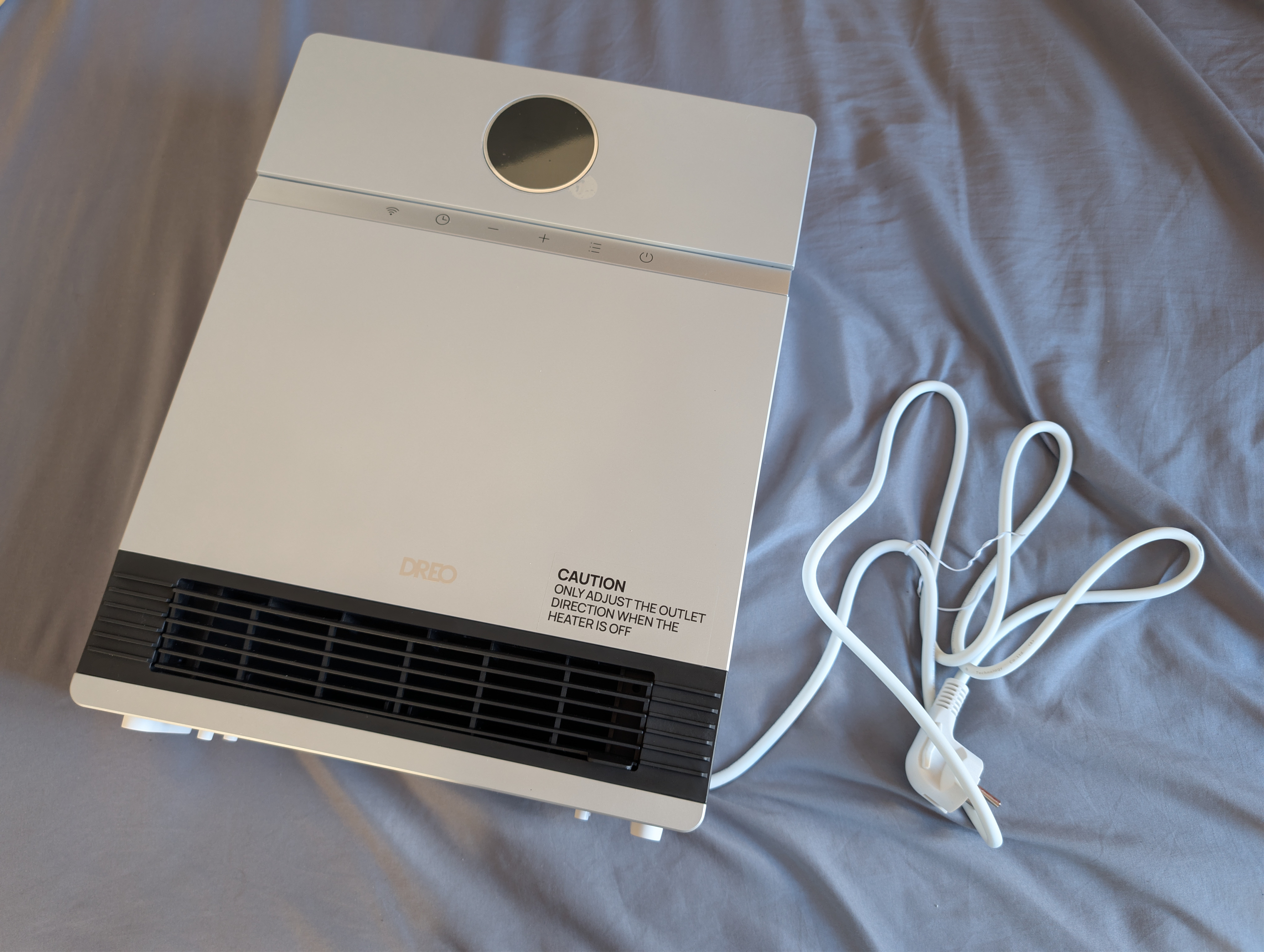

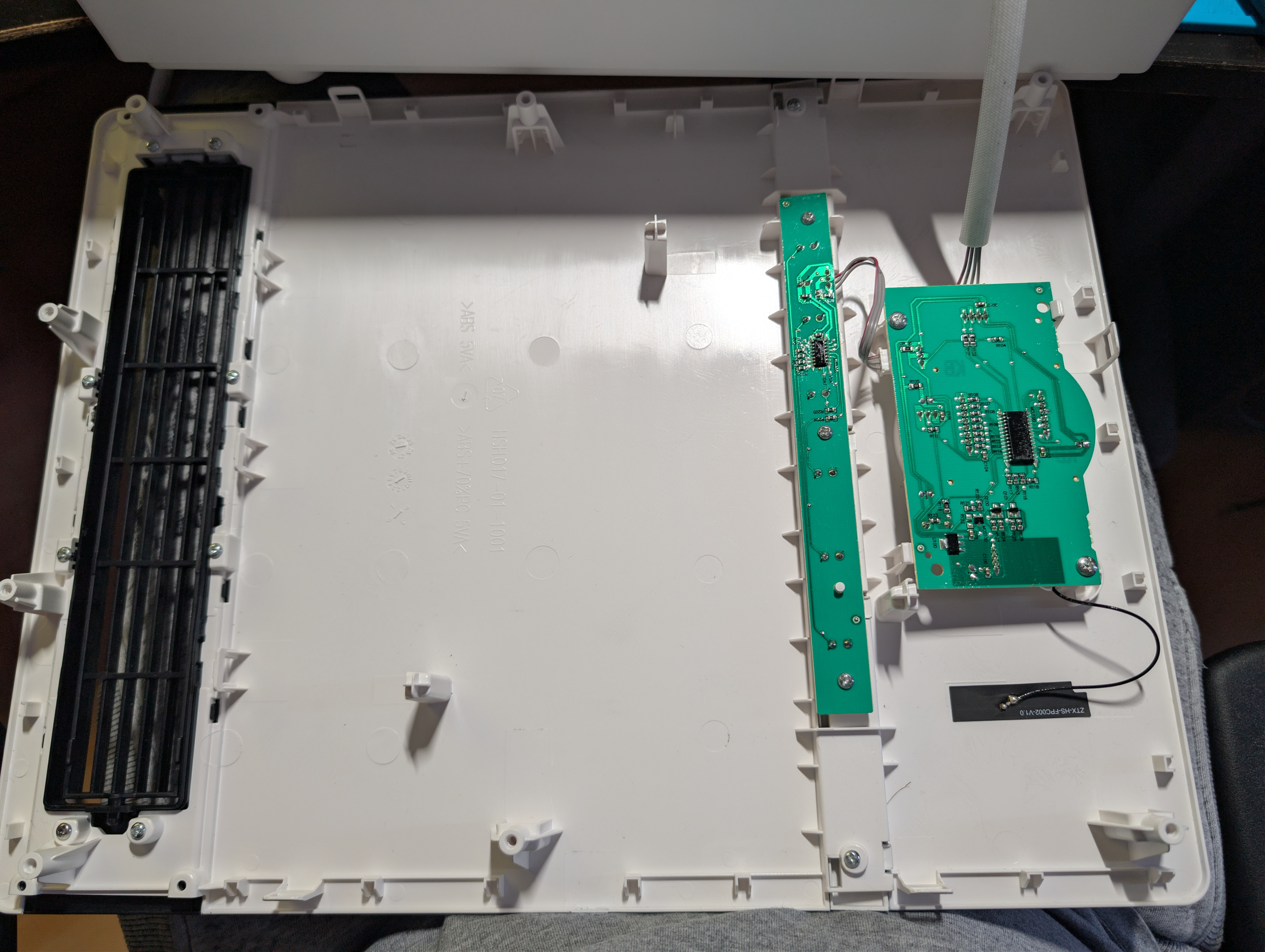

    Added after 5 [hours] 11 [minutes]:
    So. It is here.

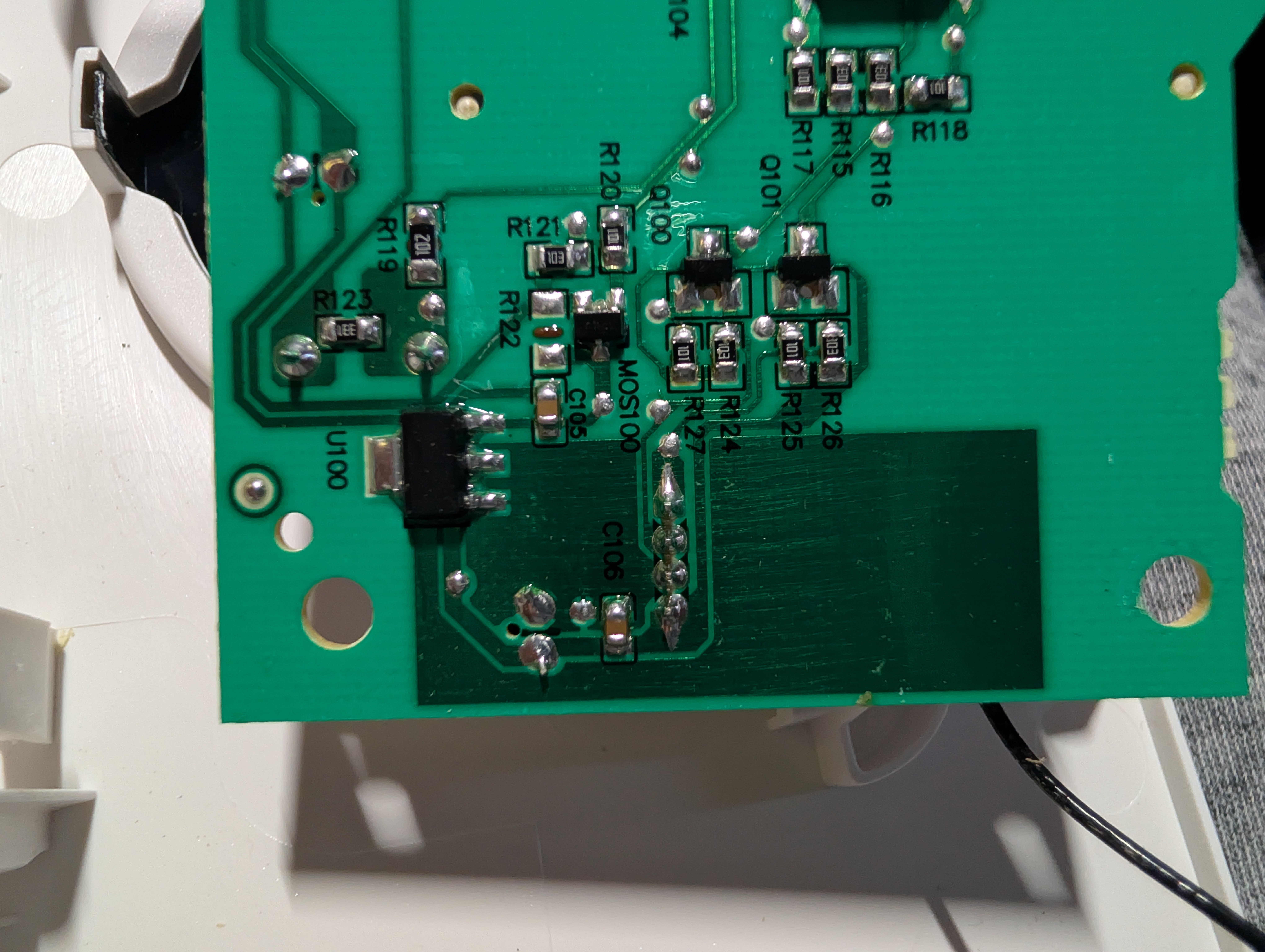

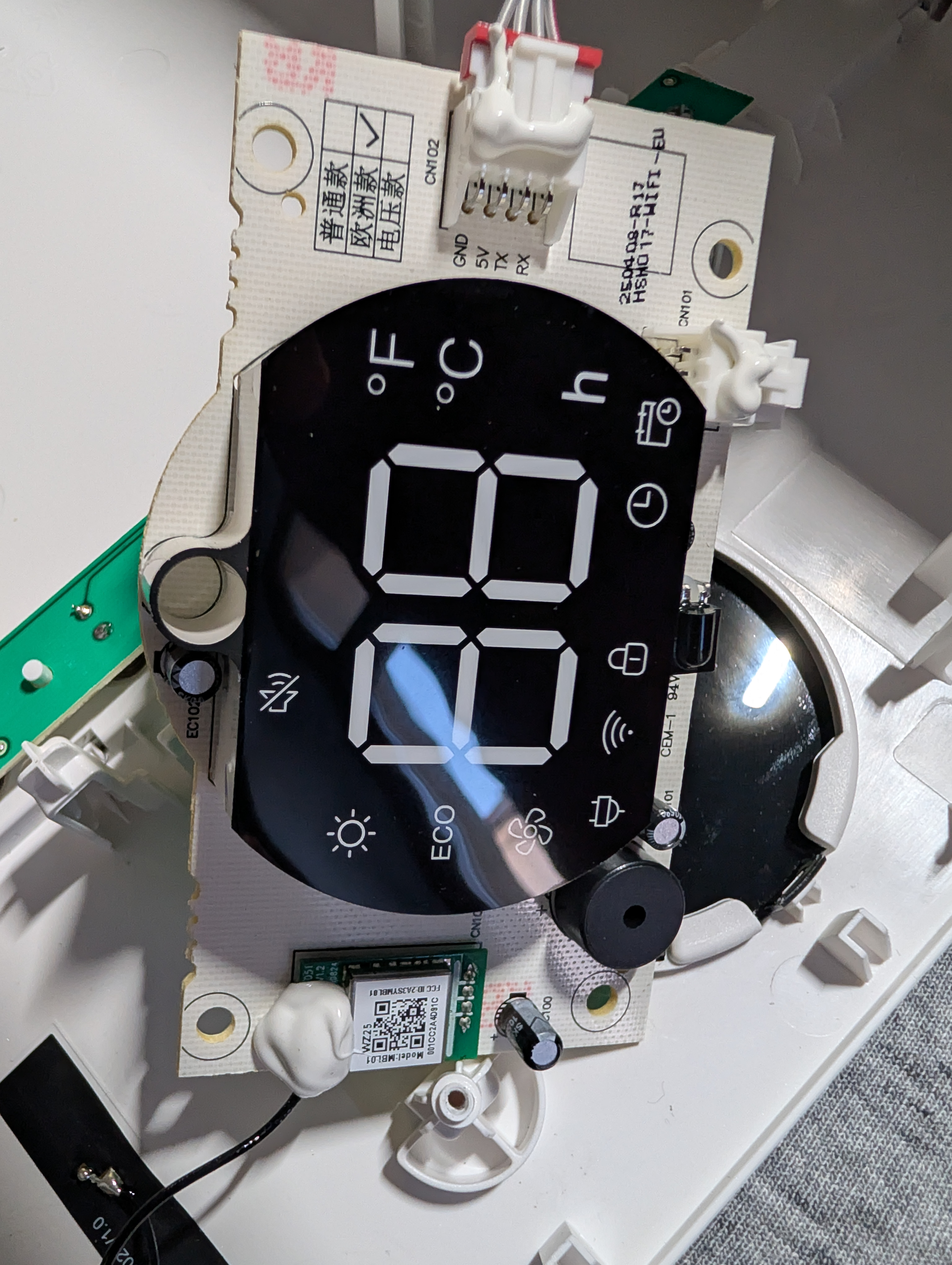

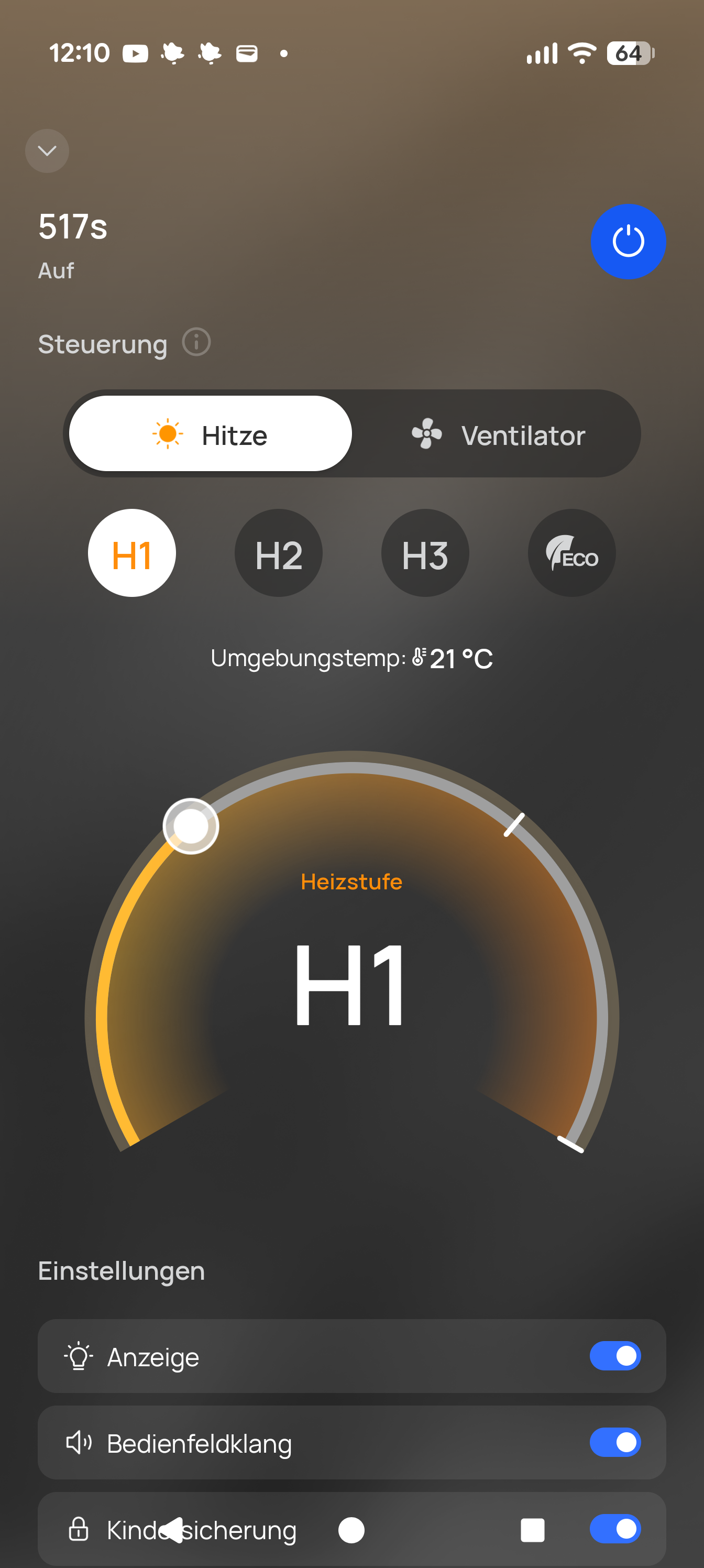

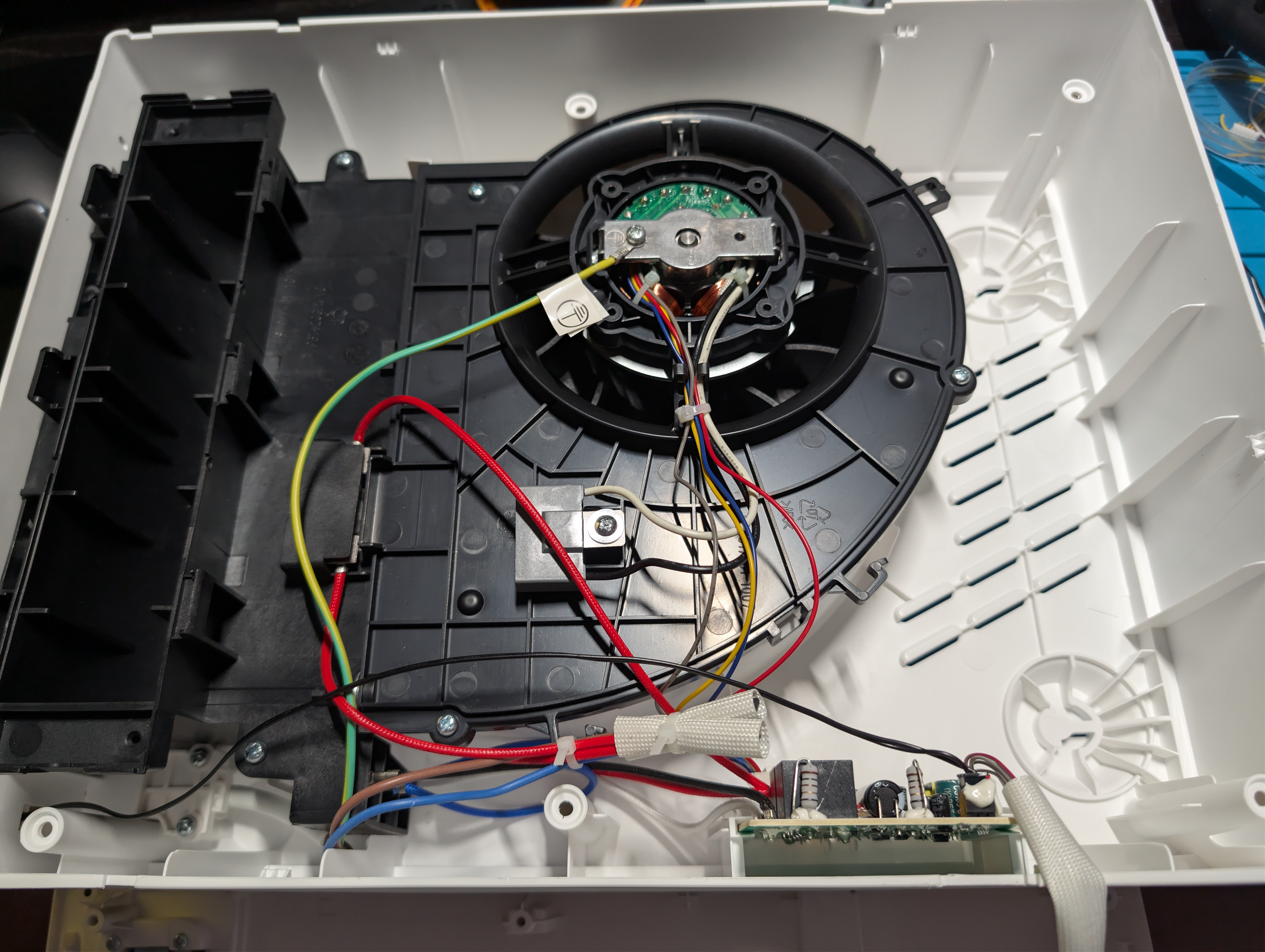

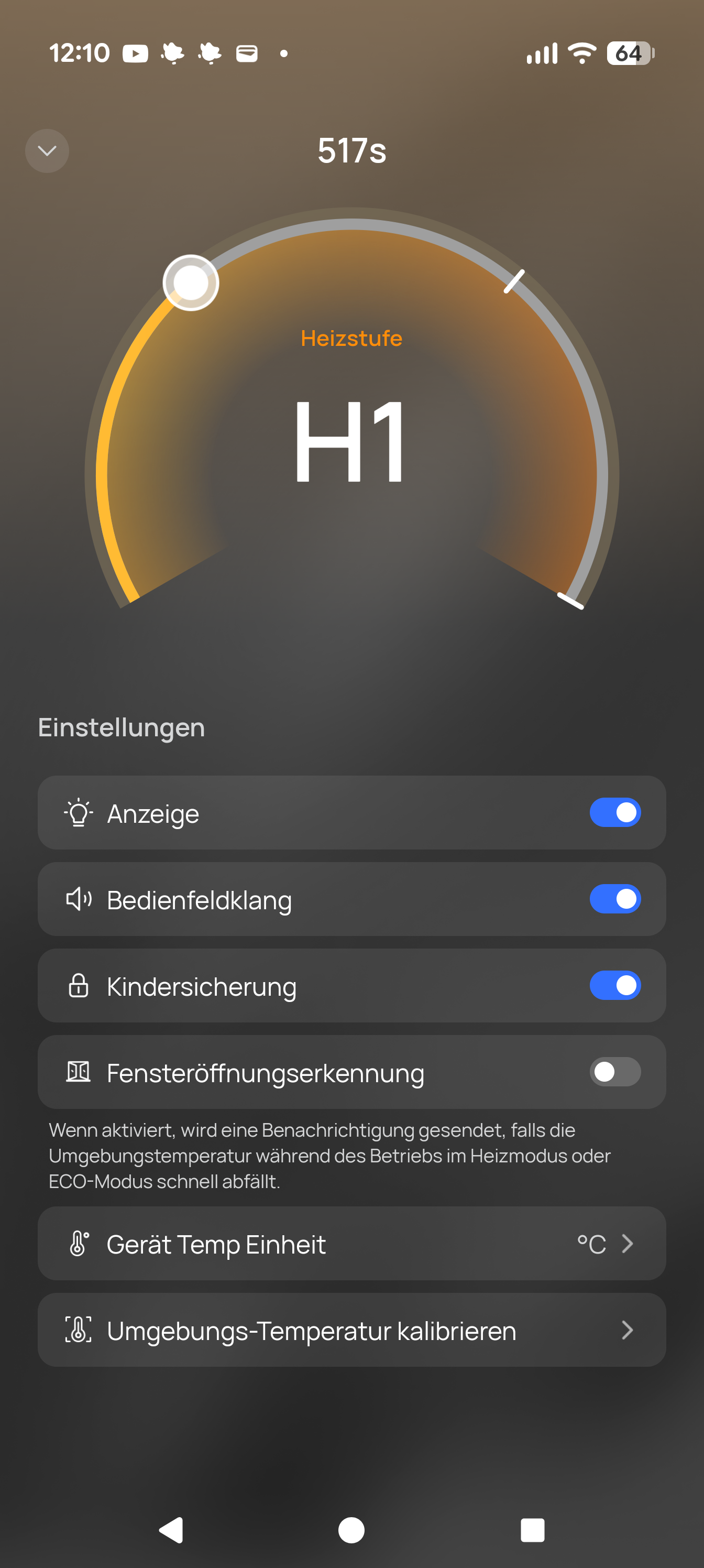

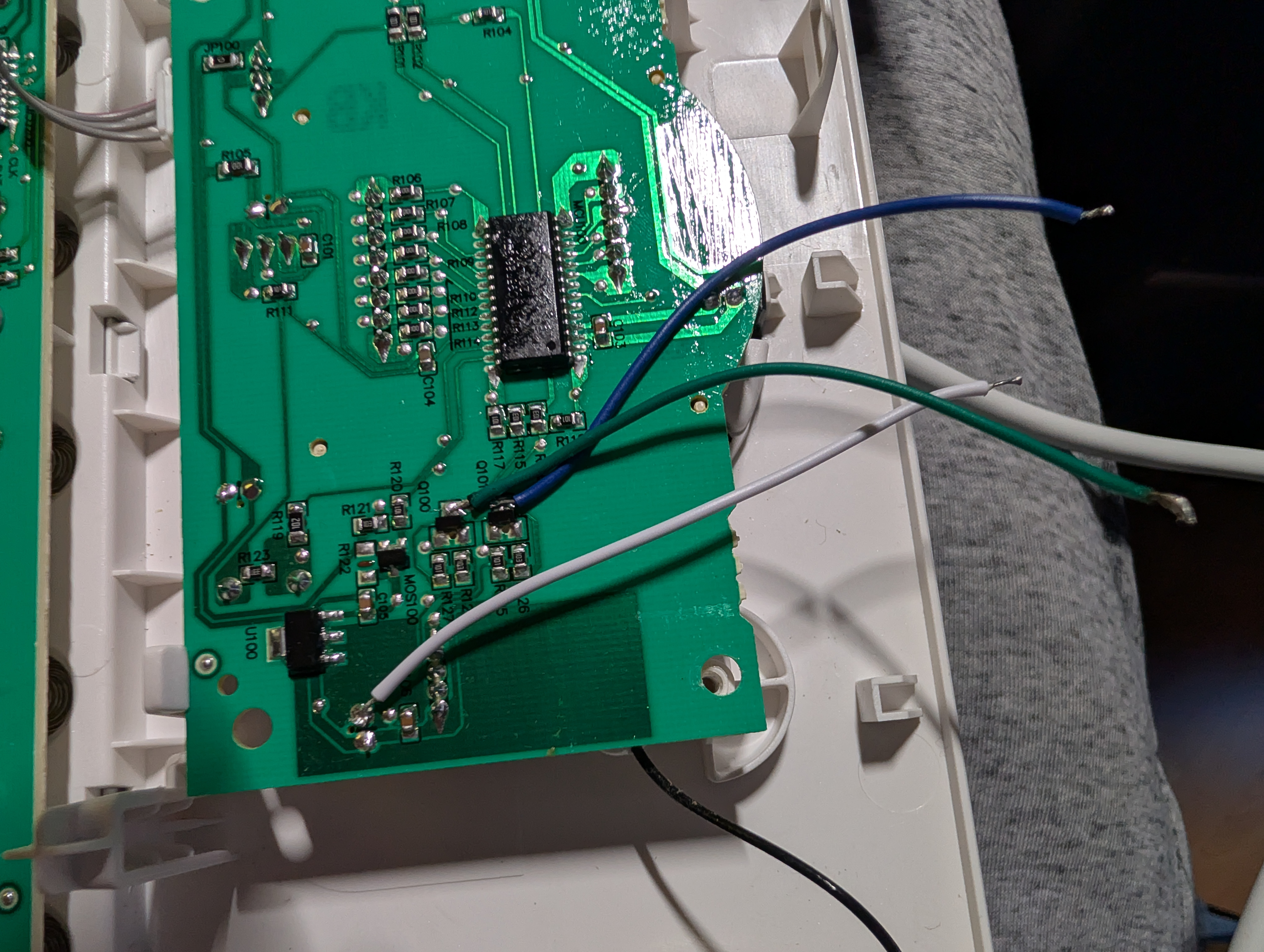

    I have attached photos of the device and what it looks like taken apart.
    It is now coupled with Dreo cloud and I intend to sniff the UART comms at the level shifter transistors.
    I have therefore attached 2 wires and a ground connection where my slogic LA is now connected.
    All of this looks extremely similar to a TuyaMCU device, I would almost say the MCU is basically identical to what was in the argo heater.
    So let's see what we get, I will share some captures in due course.
    Any more ideas what we should look at? Also: which openBeken compatible chip is this and what do we need to do for saving the stock firmware and flashing our own later?
    EDIT: attached manual

  • Backfeeding 5 V enables safe UART capture
    #2 21856029
    markusdd
    Posts: 74

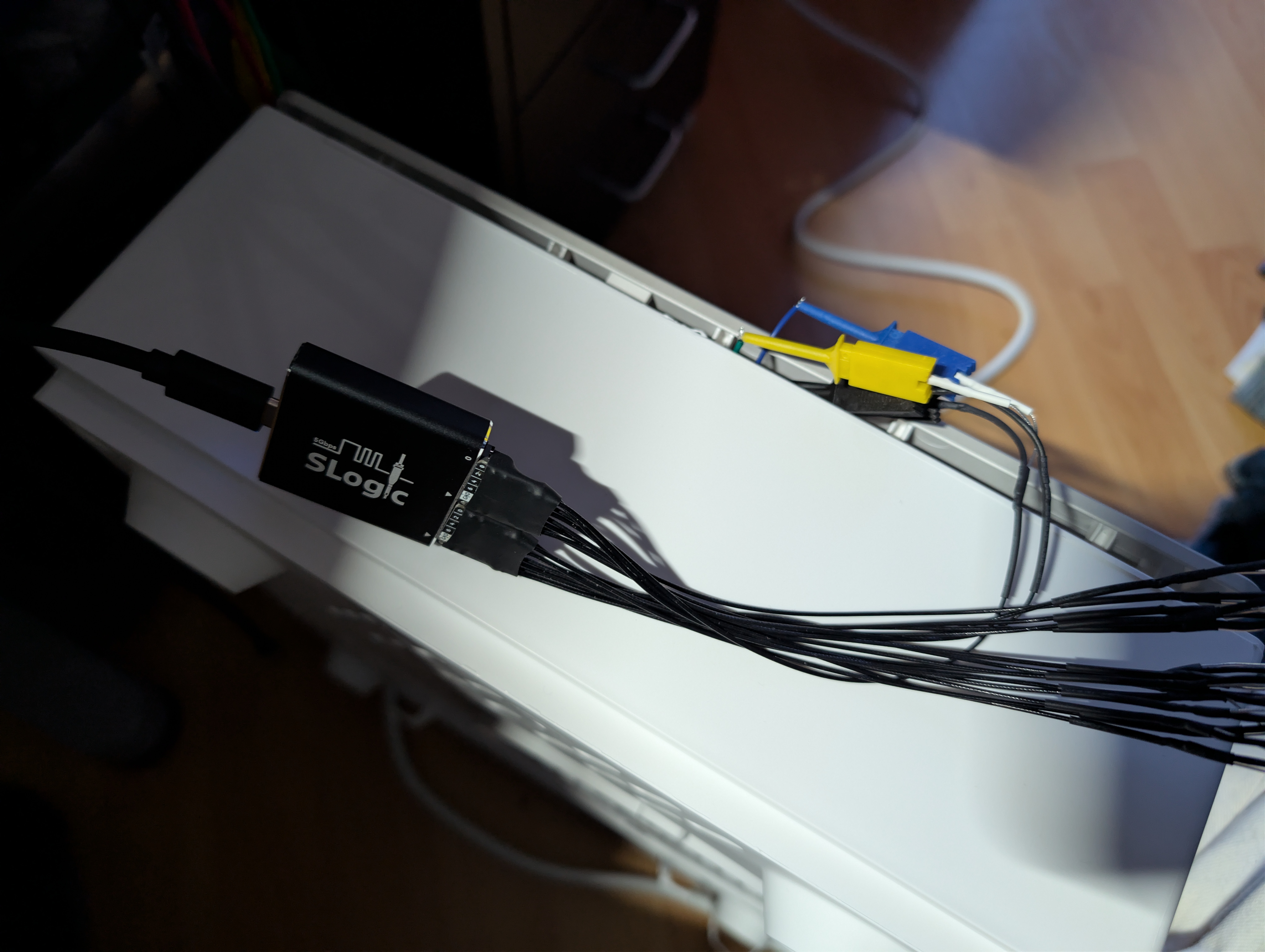

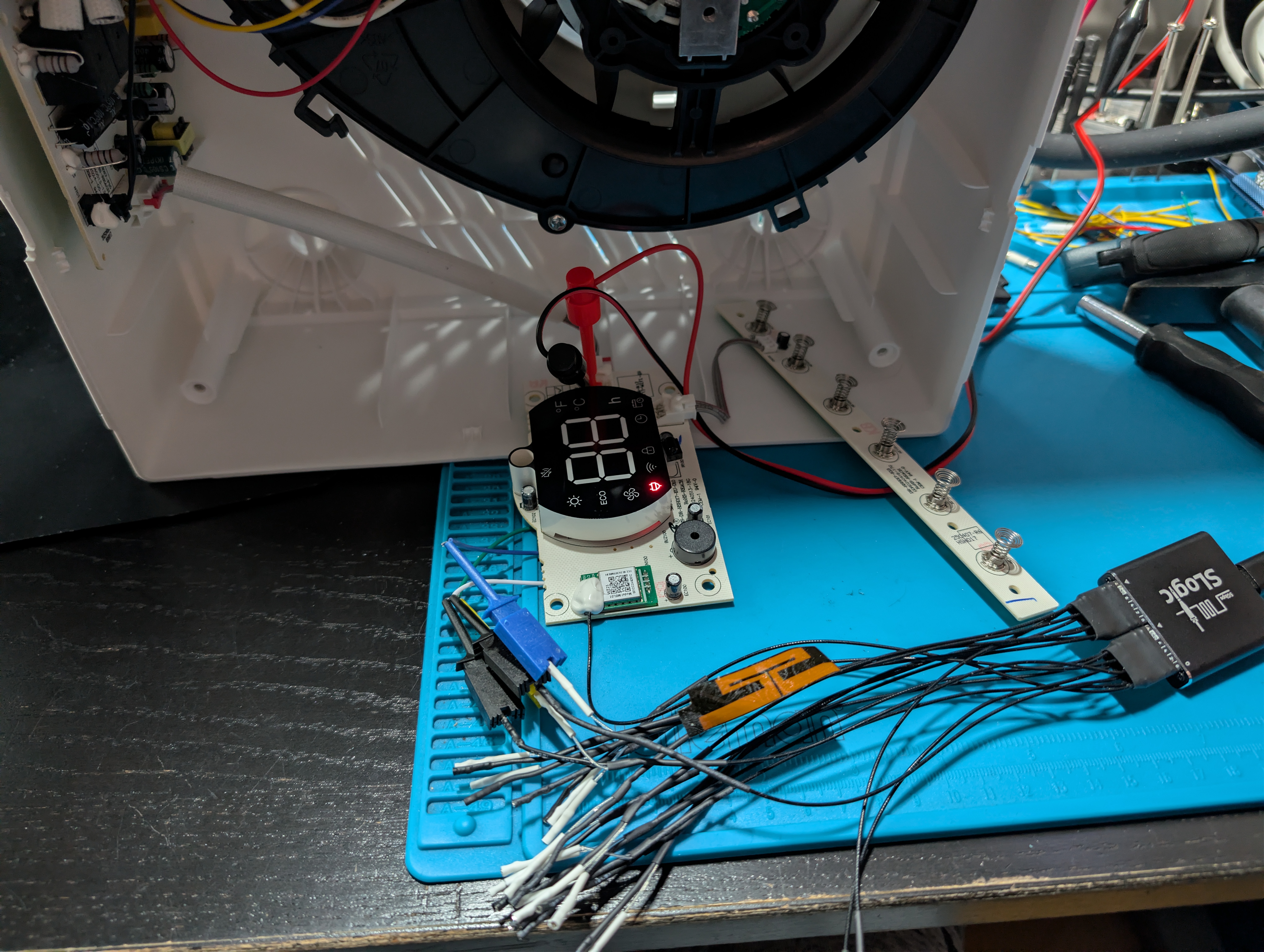

    OK, first hurdle: Grounding issues with the logic analyzer. You can't have the heater connected to the mains. But it is intelligent, and also needs the HV board connected, which makes the 5 V.
    So I backfed the connector from my lab supply with 5 V and reconnected the RX/TX/5 V/GND connector.
    Compared to the other heater, the Dreo has another MCU on the mains board, probably it has fancier control of fan speed, etc. It also monitors stuff, because if this MCU is disconnected, the display just shows "E0".

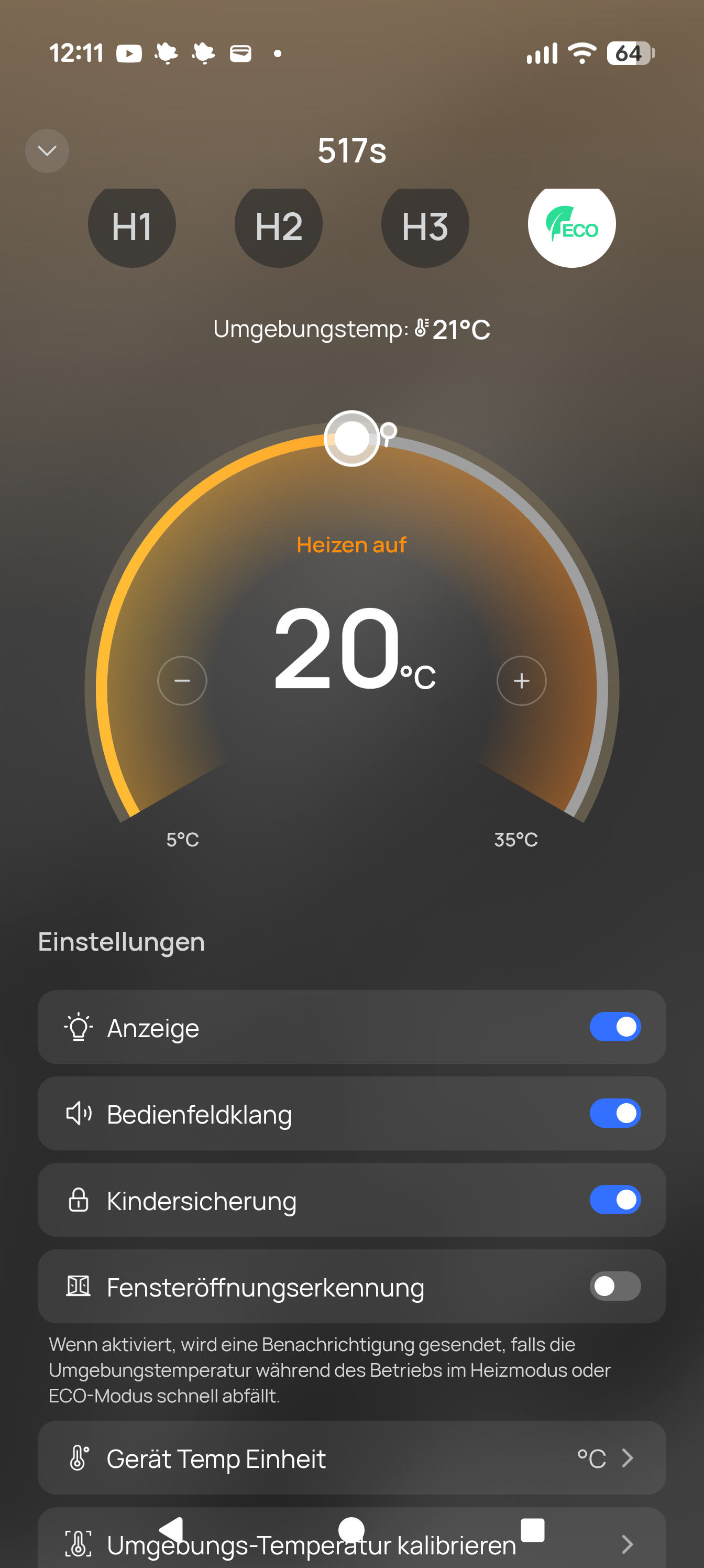

    Good news is: with this setup, the app works and even reports back the temperature, and I can select heating cycles, etc.
    So in that setup, we can capture everything. I will report back.

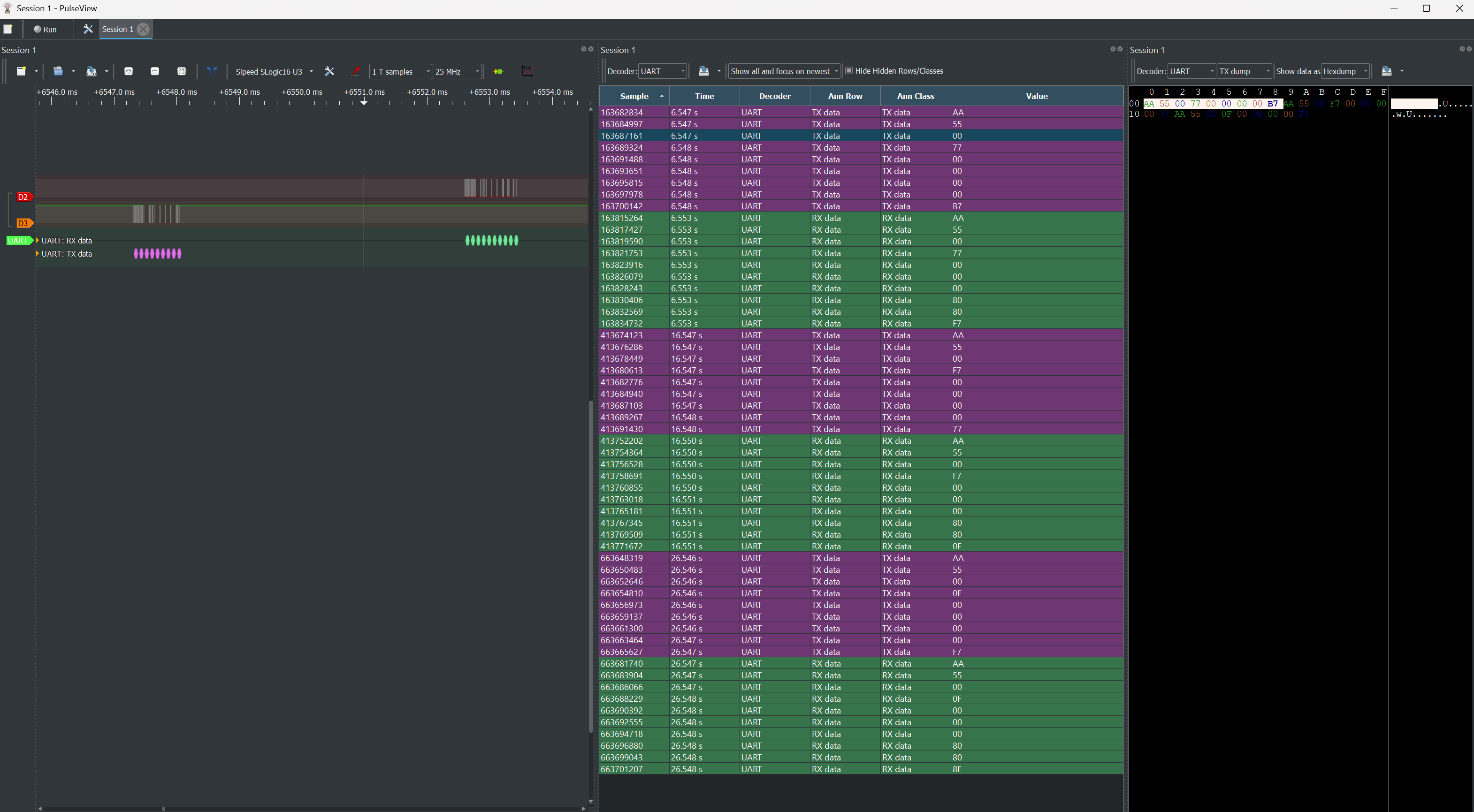

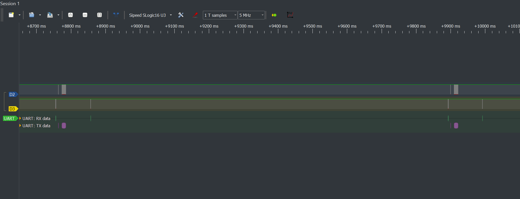

    First capture when idle. Everything is off, and Wi-Fi is connected. There seems to be some kind of status and alive ping-pong every ten seconds:

    Next one. On at approx. 8 s, followed by off at 9 s (both from app). RX, followed by short tx, then a long tx and then another RX.
    The regular idle packets are at 4 s and 14 s.

    #12 21856296
    markusdd
    Posts: 74
    Ok, some further findings: Temperature seemed to behave erratically, and Grok (correctly) suggested that indeed everything is probably LSB-first. So, back to square one.
    I fed this in, and we already have some findings:
    - It is somewhat akin to TuyaMCU from the structure, but it is different. Good news is that the basic idea is very similar; hence a new driver is probably not rocket science.
    - Header is always 0x55 0xAA 0x00 0x<ID>, where ID is just incrementally counting up from 0 after boot. This seems to act as a ping-pong ID, so you know which message is a response to what.
    - The checksum (1 byte) seems to be something like this: 0x55AA00 ignored always; (ID + sum(all payload bytes) - 1) % 256.
    - There is a heartbeat ping-pong every 10 seconds.
    - Status messages always seem to be the full meal containing all info.
    EDIT: I should add: Everything in those captures is as viewed from the MCU. So, RX is what the Wi-Fi module is sending, and TX is what the MCU is responding.

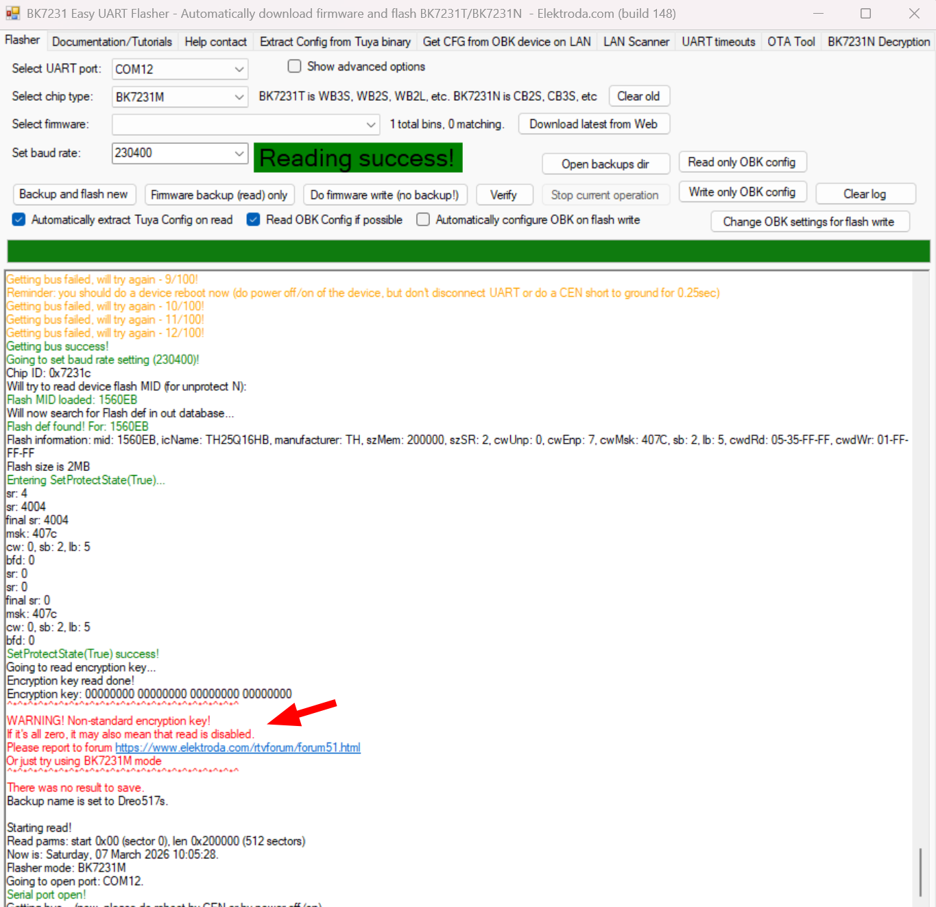

    Posts: 5220
    Help: 449
    Rate: 918
    also, have you backed-up factory flash yet, not flash OBK, just the backup

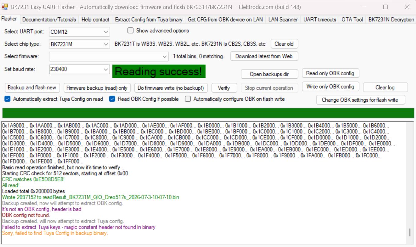

    If they help, I can try. But the pulseview version I am using has the problem of being beta as the SLogic 16 is very new and not on mainline yet. I had problems with it crashing during export. Let me see.
    @DeDaMrAz, it does work at least for the startup capture. Can you try to open it? (Had to zip because forum does not like the sr extension)
    Added after 52 [seconds]:
    >>21856300

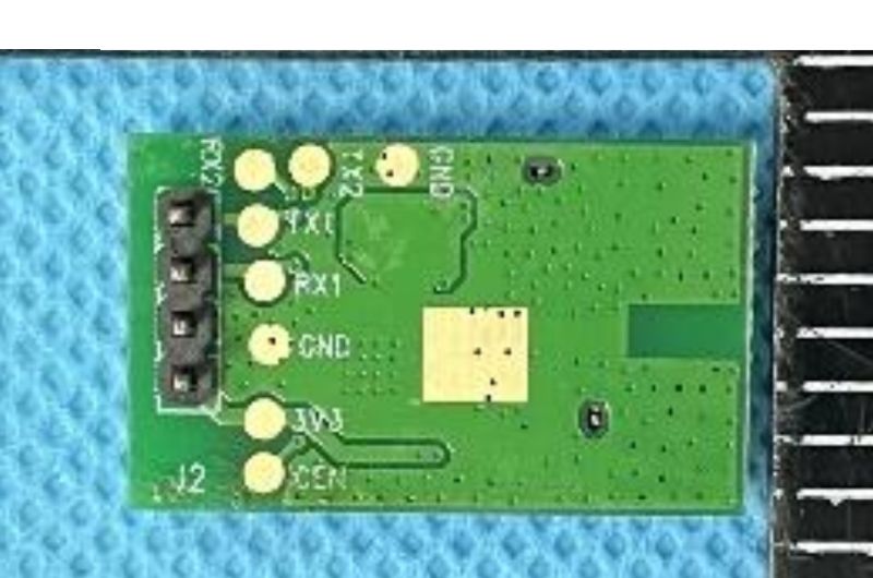

    No, I have not yet. I am only doing UART analysis now.

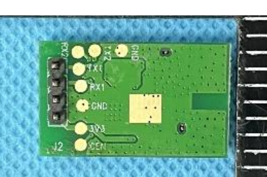

    Can you point me to the tutorial for that module on how to dump it?
    • LSB_plugging_mains_in_no_command_sent.zip (21.69 KB) You must be logged in to download this attachment.
    BK7231 dump via TX2 debug log and TX1/RX1 flash access
    #16 21856302

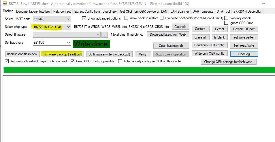

    Posts: 5220
    Help: 449
    Rate: 918
    markusdd wrote:
    No I have not yet, I am only doing UART analysis now.
    Can you point me to the turorial for that module on how to dump it?
    sure. if it's the same as Tuya Beken then probably debug log from TX2 and flash read/write from TX1/RX1.
    https://github.com/openshwprojects/BK7231GUIFlashTool/releases
    Screenshot of BK7231 Easy UART Flasher showing the message “Write done”
    power-on (3.3v) or quick pulldown CEN pad after clicking "firmware backup" for Easy Flasher to catch and begin dump https://www.elektroda.com/rtvforum/topic3951016.html

  • #18 21856327
    markusdd
    Posts: 74
    >>21856302
    OK, with that setting it complained about the encryption key. I then chose, as recommended by the flasher, BK7231M, and then it started dumping at 230400 baud. It then said it found no Tuya or OBK config, which makes sense.
    Here is the binary.
    Screenshot of BK7231 Easy UART Flasher showing “Reading success!” and a warning about a non-standard encryption key
    Screenshot of BK7231 Easy UART Flasher showing “Reading success!” and a read log.
    • readResult_BK7231M_QIO_Dreo517s_2026-07-3-10-07-10.bin (2 MB) You must be logged in to download this attachment.
    #19 21856328

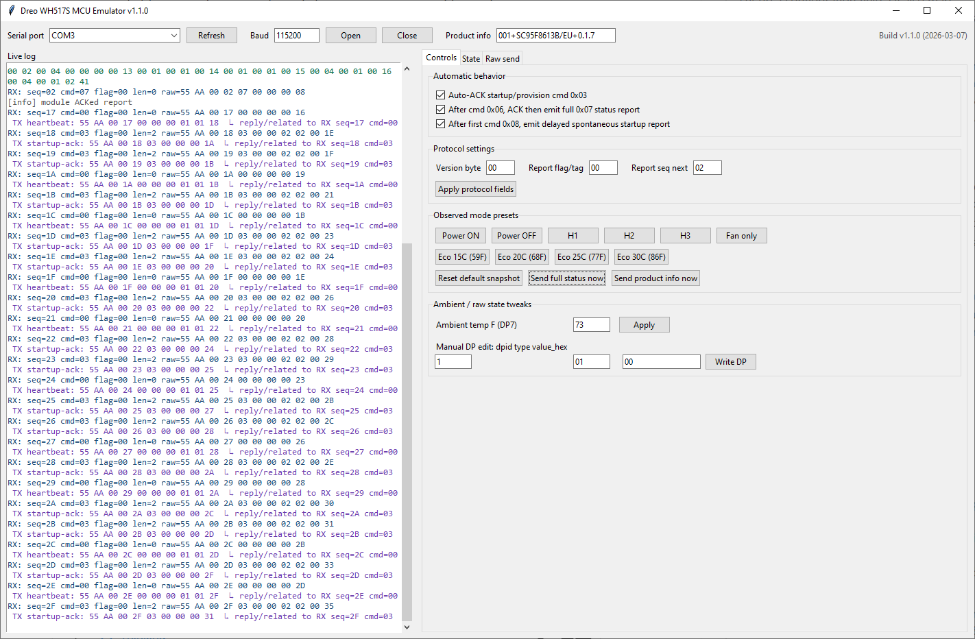

    I'm just messing about with an early DreoMCU emulator.
    Screenshot of “Dreo WHS17S MCU Emulator” showing COM port logs and a control panel
    Have you captured anything yet to reset device/get back into pairing mode?

    For example
    Bytes | Meaning | Value
    01 | DP ID | DP01
    00 | report marker | status/report
    01 | type| bool / 1-byte simple value
    00 01 | length | 1
    00 | value | 0x00
  • Protocol capture refines packet structure and checksum rules

  • App controls for display, beep, lock, and compensation
    #25 21856404
    markusdd
    Posts: 74
    OK, more stuff. The app also has provisions for display on/off, beep on/off, child lock, window-open detection, and ambient temperature compensation.
    See file name for the order in which I toggled them. Ambient temperature was 22 °C all the time. (note that window open is on/off instead of off/on like the others)
    The heater was already on in Eco20 mode; there is no on or off in this capture.
    EDIT: Forgot one setting: you can change device display from °C to °F and back to °C. So I did that as well.
    EDIT: Also added pictures of the app controls.

  • #26 21856431
    Posts: 5220
    Help: 449
    Rate: 918
    does the unit have physical buttons? I see only rx/tx to the BL2028N module, so I guess any buttons are to gpios on the DreoMCU? Did you already capture the effect of single-push, long-push etc on buttons?
  • Button presses trigger MCU status messages
    #27 21856436
    markusdd
    Posts: 74
    >>21856431
    Yes, if you check the pictures, you see a capacitive button line at the front. This one has a single-wire comms line and is going to the MCU (so it does not seem to be classic UART — or maybe just TX?). In the disassembled pic, it's the board with the springs on it. There is no connection directly to the Beken module. Also, for the other TuyaMCU heater, the button presses and IR remote just kept working normally, as they just interacted with the MCU.
    I will test if maybe presses there trigger status updates or something.
    EDIT: Indeed, pressing the buttons triggers messages from the MCU to the Wi-Fi module. I played around with on/off, cycling through modes, using /- to set temperature, and also the timer button, where you can cycle through how many hours it should be on. I guess the effect when using the IR remote is the same. Attached the PDF manual in the first post

  • #28 21856475
    Posts: 14770
    Rate: 12913
    Are the variable types here matching TuyaMCU? I mean IDs of boolean, number, enum, etc...
    Probably we could reuse TuyaMCU code just use a different main function for parsing packets so we can handle sequence ids.
  • TuyaMCU datapoint type mapping confirmed
    #29 21856478
    DeDaMrAz
    Posts: 621
    Help: 34
    Rate: 130
    Looks like they are matching from the quick glance I had at them, see below.
    DP 01 bool Main power / run enable
    DP 02 enum Main operating mode
    DP 03 enum Submode / context flag
    DP 04 value Temperature / eco target byte
    DP 07 value4 Constant here: 0x0000004A
    DP 09 value4 Constant zero here
    DP 0D value4 Constant zero here
    DP 0E value4 Fanonly-specific value, 0x0000001E in this capture
    DP 0F value4 Constant zero here
    DP 11 value4 Constant zero here
    DP 13 bool Usually 1 in heating states, 0 later
    DP 14 bool 0/1 flag, changes with some modes
    DP 15 raw4 constant-ish in this sample
    DP 16 raw4 constant-ish in this sample
