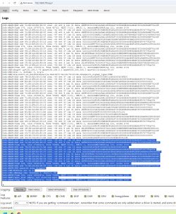

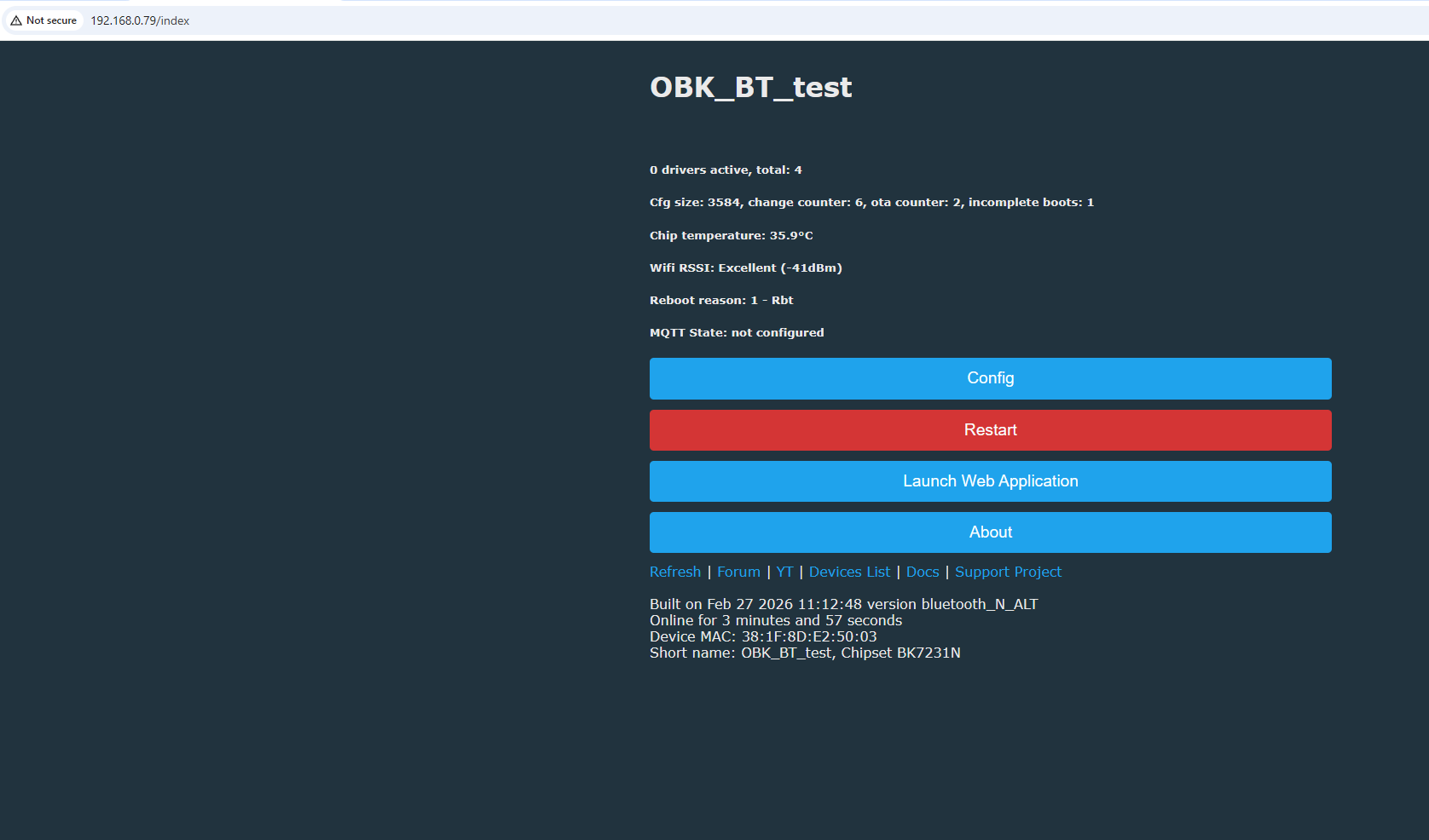

    Super early tests but I want to test if this is feasible at all an implement it as a BT proxy that can be enabled with a flag for testing proposes. If all the test pass I'll look into adding it to other platforms but since ESP gave me most problems before I am starting with the "biggest" fish first 😁 will update this once some progress is made, stay tuned.

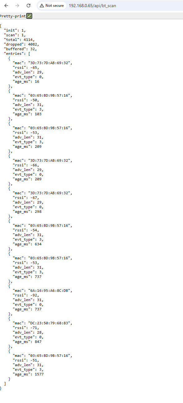

    Added after 2 [hours] 31 [minutes]:
    Browser screenshot showing JSON data with Bluetooth scan results
    Some progress but with a lot of struggle... not sure it is worth it but I'll explore more....

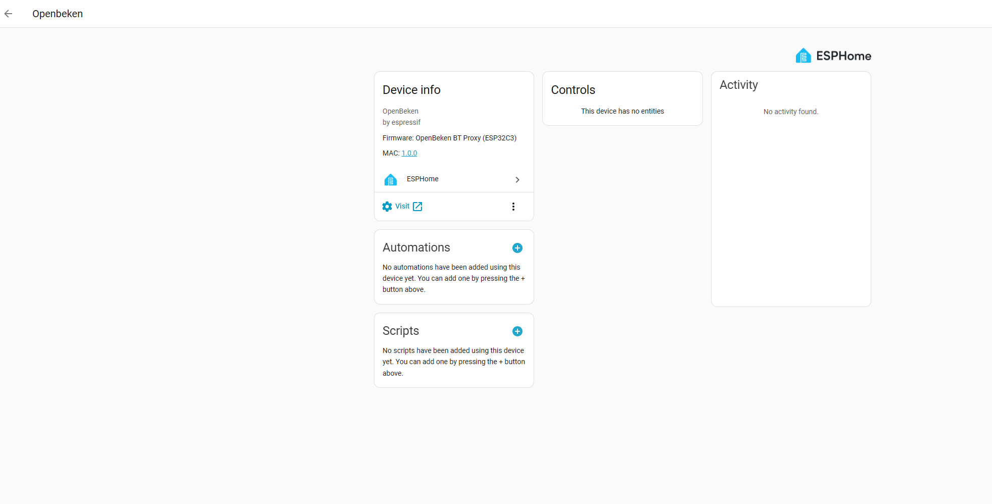

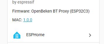

    Added after 33 [minutes]:
    Screenshot of OpenESP32C3_test status page with system info and buttons: Config, Restart, Launch Web Application, About
    Added after 3 [minutes]:
    ESPHome screenshot showing the OpenBeken device page with device info and empty panels.

    Weird mashup....

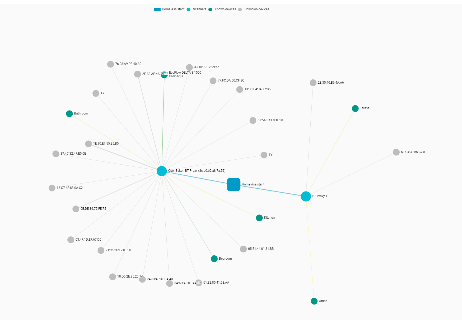

    Added after 1 [hours]:
    Bluetooth network graph: OpenBeken BT Proxy linked to Home Assistant and node “BT Proxy 1”
    Proof of concept is working...
    Since I've been digging through Bluetooth entire night and made this proof of concept work I came to the conclusion that it is a lot of work for somewhat little benefit. Every platform has it's own BT API so no one BTProxy driver is strictly plausible and binaries required are often large so that will most likely exclude 2Mb platforms (not tested - just a guess).
    Overall - not impossible but problematic and cost to benefit ratio is significant so I am going to stop this experiment here unless there is a viable usage case and a need for such a driver. The current device will remain as a test in my setup just to collect data and observe overall stability and behavior.

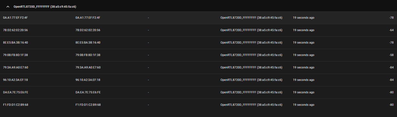

  • #6 21847062
    insmod
    Posts: 1432
    Help: 168
    Rate: 455
    Screenshot of a table listing MAC addresses, OpenRTL8720D device name, last seen time, and signal values
  • #7 21847063
    DeDaMrAz
    Posts: 621
    Help: 34
    Rate: 130

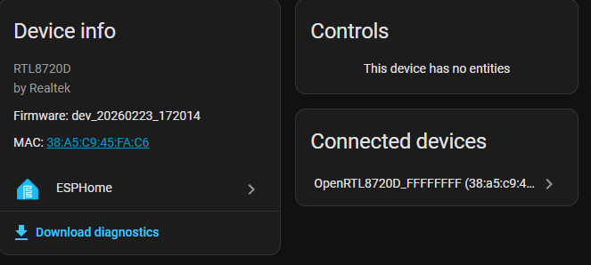

    Nice, same ESP route? I see you have mac "problem" that I came across on the first go :D
    Screenshot showing a device list: “ESPHome”, OpenBeken BT Proxy firmware, and a MAC address.
    And what is your coexistence ratio? I used 40 for WiFi and 60 for BT
    #8 21847064
    insmod
    Posts: 1432
    Help: 168
    Rate: 455
    Nope, fixed it first thing
    Dark UI showing Device info for RTL8720D with firmware and MAC, plus Controls and Connected devices sections
    Not configurable (i think?) It's enabled just via bt_coex_init and wifi_btcoex_set_bt_on.
    Or are you talking about window/interval?

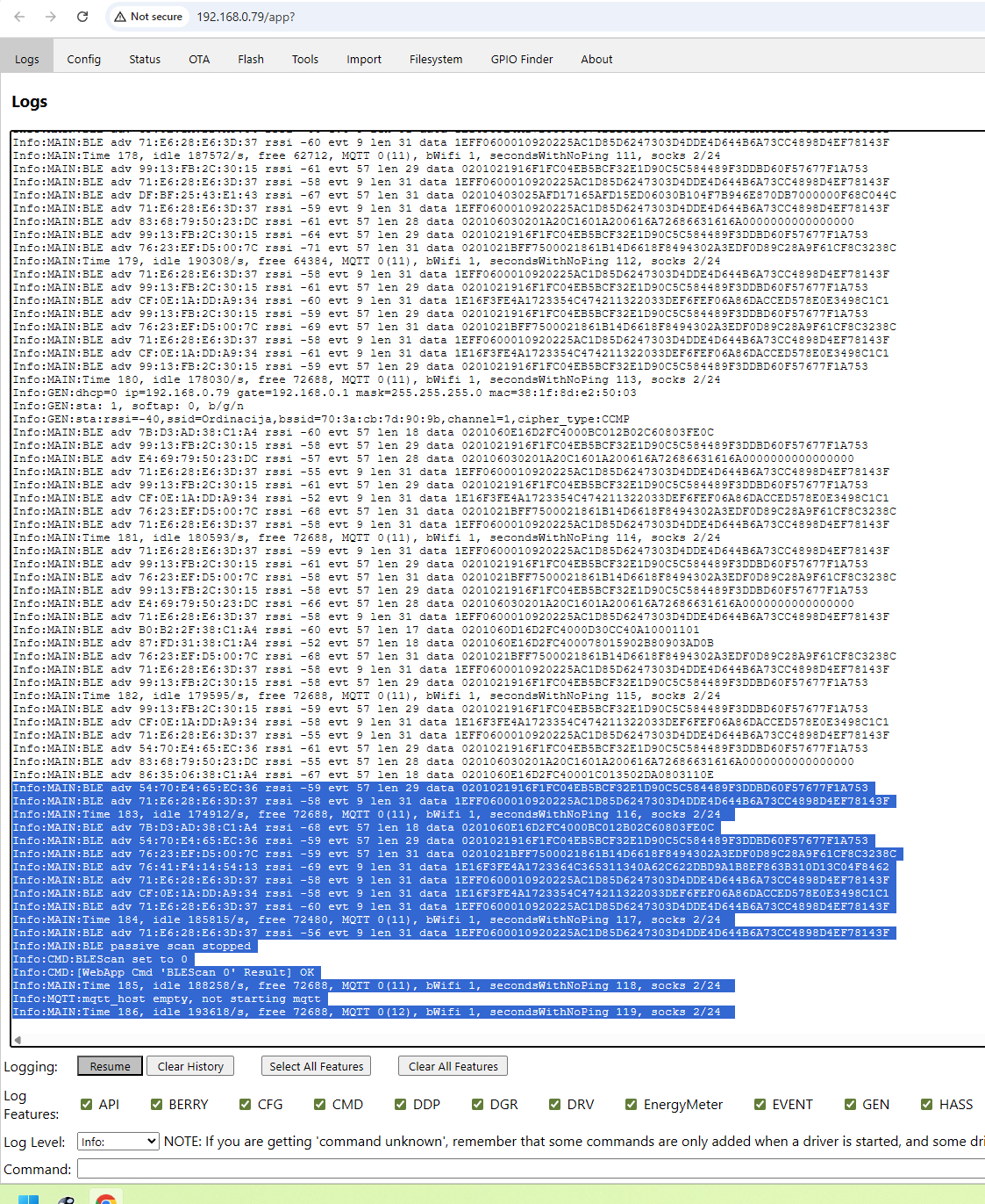

  • ESP32-C3 scan buffer overflows with advertisements
    #16 21847558
    insmod
    Posts: 1432
    Help: 168
    Rate: 455
    After some time online it started to catch a LOT of advertisements. So much, that most of them are dropped. I'm not even sure if they're valid. 157k total after 2.5 hours uptime.
      "init": 1,
      "scan": 1,
      "total": 157695,
      "dropped": 155560,
      "buffered": 32,
      "entries": [

    In log i see a lot of
    hciuart_irq: LSR 00000063 interrupt
    hciuart_irq: LSR over run interrupt
    (during ota, and once during normal operation)
    Disabling duplicates helped, but sending advs to HA is done once every 40 seconds.
    I've bumped ringbuffer limit to 256 and send all advs instead of just ten, see more advs in HA (including my bthome sensor), but a lot of them are still dropped.
    And with a simple dedup in callback, none are dropped.

    Works on RTL C, almost no changes were required. Disabled by default, ir and berry must be disabled to enable it (not enough flash otherwise).

    Info:CMD:BLEScan set to 0
    Info:MAIN:Time 820, idle 175266/s, free 69288, MQTT 0(51), bWifi 1, secondsWithNoPing 753, socks 2/24
    Info:GEN:dhcp=0 ip=192.168.0.79 gate=192.168.0.1 mask=255.255.255.0 mac=38:1f:8d:e2:50:03
    Info:GEN:sta:rssi=-39,ssid=Ordinacija,bssid=70:3a:cb:7d:90:9b,channel=1,cipher_type:CCMP
    Info:MAIN:Time 821, idle 190526/s, free 60008, MQTT 0(51), bWifi 1, secondsWithNoPing 754, socks 3/24
    Info:MAIN:Time 822, idle 179503/s, free 72632, MQTT 0(51), bWifi 1, secondsWithNoPing 755, socks 2/24
    Info:MAIN:BLE scan mode set to passive
    Info:CMD:BLEScanMode set to 0
    Info:MAIN:Time 823, idle 191055/s, free 72632, MQTT 0(51), bWifi 1, secondsWithNoPing 756, socks 2/24
    Info:MAIN:Time 824, idle 187593/s, free 72632, MQTT 0(51), bWifi 1, secondsWithNoPing 757, socks 2/24
    Info:MAIN:BLE passive scan started (idx=0, intv=100, win=30)
    Info:CMD:BLEScan set to 1
    Info:MAIN:BLE adv CD:A1:3D:4D:A0:23 rssi -60 evt 9 len 31 data 1EFF060001092022912EF1AF8380CF15DB6139A5DDAA2016EFD34D2015B23C
    Info:MAIN:Time 825, idle 190604/s, free 70952, MQTT 0(51), bWifi 1, secondsWithNoPing 758, socks 2/24
    Info:MAIN:BLE adv 83:68:79:50:23:DC rssi -68 evt 57 len 28 data 020106030201A20C1601A200616A72686631616A0000000000000000
    Info:MAIN:BLE adv 5C:5E:34:F1:29:17 rssi -55 evt 57 len 29 data 0201021916F1FC049CEDA91EFEE92CA9F4E3FEE7FC77E8477F48B39197
    Info:MAIN:BLE adv CD:A1:3D:4D:A0:23 rssi -63 evt 9 len 31 data 1EFF060001092022912EF1AF8380CF15DB6139A5DDAA2016EFD34D2015B23C
    Info:MAIN:BLE adv CD:A1:3D:4D:A0:23 rssi -59 evt 9 len 31 data 1EFF060001092022912EF1AF8380CF15DB6139A5DDAA2016EFD34D2015B23C
    Info:MAIN:BLE adv 71:DA:1D:3A:22:4C rssi -68 evt 57 len 31 data 0201021BFF7500021861B16963C9FE471E7A6283404B8F0F5BD2F2E869AEEA
    Info:MAIN:BLE adv E4:69:79:50:23:DC rssi -59 evt 57 len 28 data 020106030201A20C1601A200616A72686631616A0000000000000000
    Info:MAIN:BLE adv B0:9F:84:89:13:4F rssi -66 evt 57 len 31 data 02010403025AFD17165AFD152007037CEBEE4AF1011F76B7000000D4D360C5
    Info:MAIN:Time 826, idle 175623/s, free 64328, MQTT 0(52), bWifi 1, secondsWithNoPing 759, socks 2/24
    Info:MAIN:BLE adv 87:FD:31:38:C1:A4 rssi -53 evt 57 len 18 data 0201060E16D2FC4000F7015A02580903140E
    Info:MAIN:BLE adv 5C:5E:34:F1:29:17 rssi -59 evt 57 len 29 data 0201021916F1FC049CEDA91EFEE92CA9F4E3FEE7FC77E8477F48B39197
    Info:MAIN:BLE adv CD:A1:3D:4D:A0:23 rssi -62 evt 9 len 31 data 1EFF060001092022912EF1AF8380CF15DB6139A5DDAA2016EFD34D2015B23C
    Info:MAIN:BLE adv 71:DA:1D:3A:22:4C rssi -59 evt 57 len 31 data 0201021BFF7500021861B16963C9FE471E7A6283404B8F0F5BD2F2E869AEEA
    Info:MAIN:Time 827, idle 181091/s, free 70960, MQTT 0(52), bWifi 1, secondsWithNoPing 760, socks 2/24
    Info:MAIN:BLE adv 5C:5E:34:F1:29:17 rssi -57 evt 57 len 29 data 0201021916F1FC049CEDA91EFEE92CA9F4E3FEE7FC77E8477F48B39197
    Info:MAIN:Time 828, idle 178752/s, free 70960, MQTT 0(52), bWifi 1, secondsWithNoPing 761, socks 2/24
    Info:MAIN:BLE adv 71:DA:1D:3A:22:4C rssi -54 evt 57 len 31 data 0201021BFF7500021861B16963C9FE471E7A6283404B8F0F5BD2F2E869AEEA
    Info:MAIN:BLE adv 87:FD:31:38:C1:A4 rssi -62 evt 57 len 17 data 0201060D16D2FC4000F80C6B0B10001101
    Info:MAIN:Time 829, idle 186737/s, free 72440, MQTT 0(52), bWifi 1, secondsWithNoPing 762, socks 2/24
    Info:MAIN:BLE passive scan stopped
    Info:MAIN:Time 831, idle 184116/s, free 72632, MQTT 0(52), bWifi 1, secondsWithNoPing 764, socks 2/24
    Info:MAIN:Time 832, idle 187659/s, free 72632, MQTT 0(52), bWifi 1, secondsWithNoPing 765, socks 2/24
    Info:MAIN:Time 833, idle 192467/s, free 72632, MQTT 0(52), bWifi 1, secondsWithNoPing 766, socks 2/24
    Info:MAIN:Time 834, idle 192364/s, free 72632, MQTT 0(52), bWifi 1, secondsWithNoPing 767, socks 2/24
    Info:MAIN:Time 835, idle 197125/s, free 72632, MQTT 0(52), bWifi 1, secondsWithNoPing 768, socks 2/24
    Info:MAIN:Time 836, idle 189198/s, free 72632, MQTT 0(52), bWifi 1, secondsWithNoPing 769, socks 2/24
    Info:MAIN:Time 837, idle 200379/s, free 72632, MQTT 0(52), bWifi 1, secondsWithNoPing 770, socks 2/24
    Info:MAIN:Time 838, idle 189865/s, free 72632, MQTT 0(52), bWifi 1, secondsWithNoPing 771, socks 2/24
    Info:MAIN:Time 839, idle 194219/s, free 72544, MQTT 0(52), bWifi 1, secondsWithNoPing 772, socks 2/24
    Info:MAIN:Time 840, idle 189270/s, free 72632, MQTT 0(52), bWifi 1, secondsWithNoPing 773, socks 2/24
    Info:GEN:sta:rssi=-40,ssid=Ordinacija,bssid=70:3a:cb:7d:90:9b,channel=1,cipher_type:CCMP
    Info:MAIN:Time 841, idle 192863/s, free 72632, MQTT 0(52), bWifi 1, secondsWithNoPing 774, socks 2/24
    Info:MAIN:Time 842, idle 187985/s, free 72632, MQTT 0(53), bWifi 1, secondsWithNoPing 775, socks 2/24

    Works, i see bthome sensor name in HA advertisements.
    Add coded phy support (GAPM_SCAN_PROP_PHY_CODED_BIT/GAPM_SCAN_PROP_ACTIVE_CODED_BIT)?
    I'm using THB2 sensor for testing, and it's disabled in code (with a message that it doesn't work) https://github.com/pvvx/THB2/blob/48db5245d23...53d89c/bthome_phy6222/source/thb2_main.c#L641
    Will need TLSR825x sensor with atc firmware for that.
