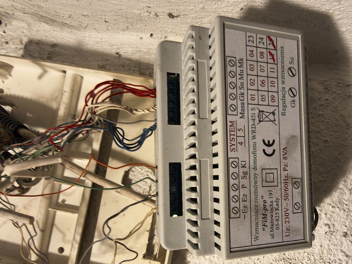

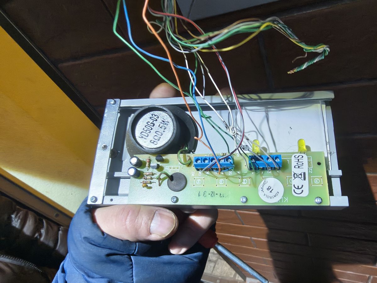

    I have a WRD-45i in my block of flats - a call amplifier and an external cassette with 4 Elfon call buttons. When any call button is pressed the electric door strike goes crazy. The backlighting of the cassette does not work either. Connecting the 12 V backlight separately is OK. I have replaced the call amplifier and the same situation continues. I am uploading photos, maybe they will help to assess the situation.

    I suggest for diagnostic purposes to disconnect the residential part and then check.

    Dziekuje za odpowiedz, przyciski wywołania zaczeły działac ale po kilku minutach cisza jak sie porusza wzmacniaczem zaczyna działac z powrotem .sprawdziłem wszytkie kablelki sa dokrecone do wzmacnicza.[/postid:6bfd15c99a]

    Disconnect everything and with short wires, on the table, connect the power supply, cassette and 1 uniphone. Check the bell and audio.
    If it's OK, connect the electric door opener and look for the fault in small steps.
  • #5 21839169
    zeniosolec
    Problem with installation in basement - burnt neutral wire. Thank you
