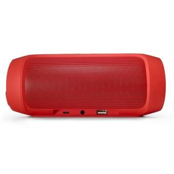

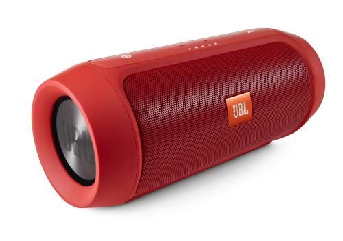

    Hi everyone,
    I have a JBL Charge 2 with an issue. The speaker does not turn on normally. When I press and hold the power button, the LED on the power button lights up white, but as soon as I release my finger, it turns off.
    I disassembled the speaker to investigate and started focusing on this problem.
    i try turn on only motherboard without motherboard of usb and charging port and same issue
    Red JBL Charge 2+ Bluetooth speaker with visible logo and side passive radiator Red JBL Charge 2+ speaker rear view showing ports and grille
    JBL Charge 2+ Speaker Not Turning On or Charging, Unresponsive LEDs
    AI: did you try using different charging cable or adapter to see if the speaker reacts any different?
    yes i try another cable and another adopter
    AI: have you checked the battery voltage with a multimeter or tried another battery to see if that changes anything?
    yes it show 3.7 v
