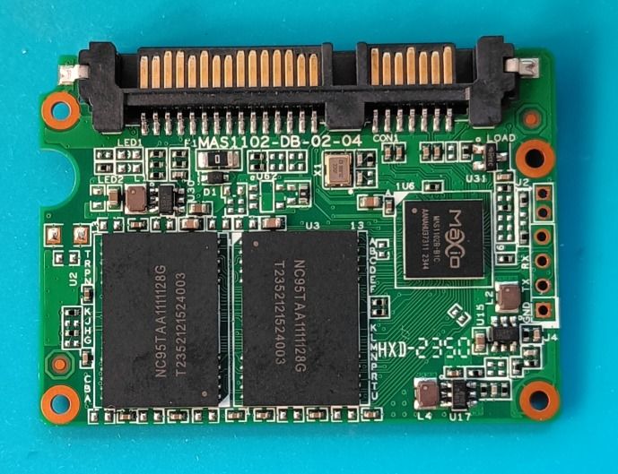

    Looking for info on this drive, I'll give a little bit about what I have, as it has different guts. And the drive itself has died - it's not visible as a drive, although BIOS and Windows in the manager identifies it.
    PCB designation: MAS1102-DB-02-04
    Controller: MAS1102b-b1c
    NAND: 4 dice with designation:
    nc95taa1111128g
    t2352121524003
    Identification by jm_id tool:
    JM/MK/MAS ID v0.20a by Ochkin Vadim
    Drive: 1 (ATA)
    Model : SSDPR-CL100-480-G3
    Fw : SN16907
    Size : 457862 MB [480.1 GB]
    ATA: GetSmart failed! Error: 0x51
    ATA: ID1 failed! Error: 0x51
    ATA: ID2 failed! Error: 0x51
    MXUtility_MAS1102 does not detect it.
    GOODRAM-SSD-firmware-updater_20211026 does not see it either.
    I connected the controller's UART because it's on the PCB. It spits out some text, generally difficult to interpret, but you can see some #BB table, like some badblocks. Number of addresses: 706.
    That would be it. Waste of time on it.
  • #8 21862963
    Piorun2002
    Posts: 269
    Rate: 25
    gekowal19 wrote:
    I connected the controller UART because it's on the PCB. Spit out some text, generally difficult to interpret, but you can see some #BB table like some badblocks. Number of addresses 706.
    Could you take a picture of how you did it, I'm struggling with the same disk - only with me OS sees only partition table + files_name and all files have only '0'
  • UART pins and J2 bootloader jumper identified
    #9 21863025
    gekowal19
    There are two connectors on the right, one is the 3v3 uart (GND, Tx, Rx, 3v3) and the other is the J2 jumper, this is used to enter the bootloader when the power is switched on and off (you can see this on the console).
    SSD PCB with NAND chips and top edge connectors on a blue background
    I have not found a program to operate over uart. Perhaps the PC3000 has such a function, as they wrote something on the forums about it.
    a piece of log from the startup:
