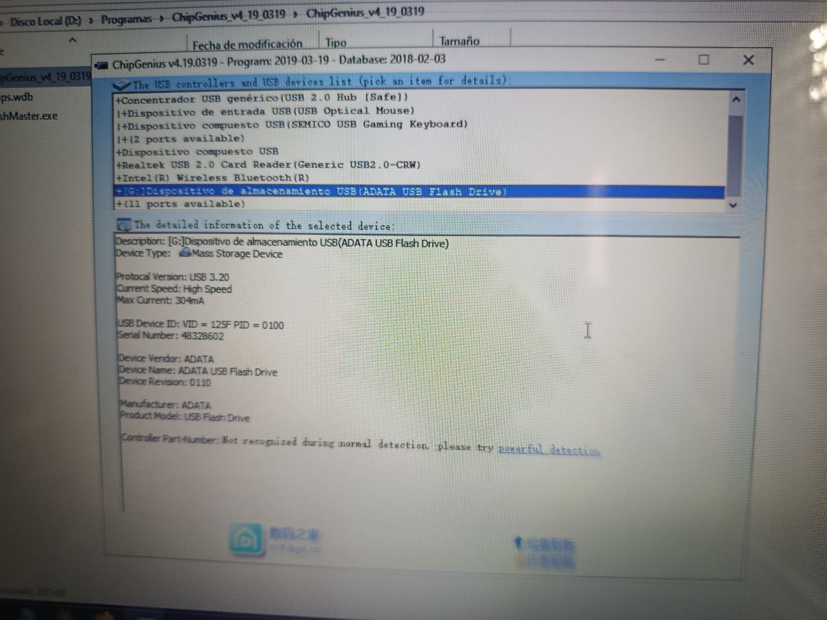

Tools tried (both failed to identify the controller):
ChipGenius v4/v19: Controller Part-Number = "Not recognized during normal detection" / "Unknown"
USBFlashInfo (antspec.com) v9.4.0.645: Controller = "Unknown", Possible Memory Chip(s) = "Not available"
Based on other UV128/64 GB reports I found (VID_125F&PID_DB8A with SM3267AB/SM3268AB controllers), I suspect this may be a Silicon Motion SM32xx series controller, but I cannot confirm since both tools fail to detect it, likely due to the COB design or a firmware fault preventing full identification.
I already backed up all data, so I'm fine with any repair method that requires a full low-level format/re-flash. Could anyone help identify the correct controller and the corresponding MPTool for this exact VID/PID combination?
