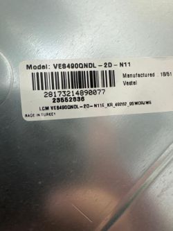

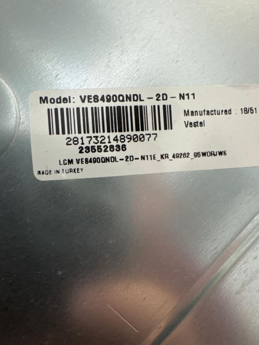

    Label with model VE8490QNDL-2D-N11 printed on a metallic surface

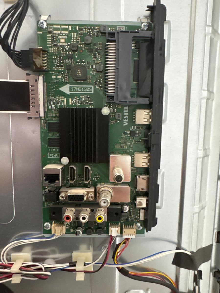

    TV mainboard 17MB130S with visible ports, connectors, and circuit components Hi I'm in search of firmware for my TV. It started updating and it got stuck. The TV is turned off, the red LED is blinking slowly and the screen is black and I can't get past this. I tried everything and I got here asking for the firmware to try updating it remotely!

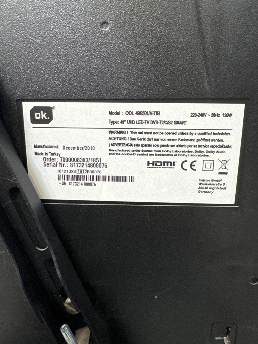

    Brand: OK
    Model: ODL 49650UV-TIB
    Motherboard: Vestel 17MB130S, version 23552834
    LCD Panel: Ves490QNDL-2D-N11
    Information label on the back of OK. TV model ODL 49650UV-TIB
    TV mainboard 17MB130S with visible ports, connectors, and circuit components Label with model VE8490QNDL-2D-N11 printed on a metallic surface

    I have it from Telefunken. Same motherboard and same panel. If the remote control doesn't work anymore, use one from Telefunken. Try it at your own risk. It installs with the OK key.

    Hi, I had to change the whole motherboard. I found one from Horizon 17MB230s; it also works and it is smoother than the original one. The old motherboard did not boot the USB device.
