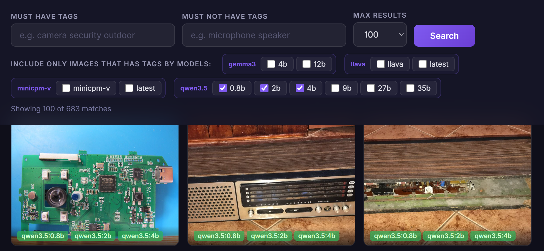

  • Screenshot of an image search tool with AI model filters and three result thumbnails
    Will the Qwen3.5 models allow a simple image search engine to be built by verbal description of the content? Could local AI work in the role of OCR? In the previous topic the AI described more than 1000 images from the Elektroda forum , here I enriched this collection with descriptions from Qwen models 0.8b, 2b, 4b, 9b, 27b, 35b. I have packed the results into a simple search engine. Time to see how it worked.

    The question of publication remains - the results are available on GitHub in the form of an image finder. Each image is clickable and its tags can be previewed:
    https://openshwprojects.github.io/IndexingElektrodaImages/search2.html
    An older version of the site is also available:
    https://openshwprojects.github.io/IndexingElektrodaImages/search.html

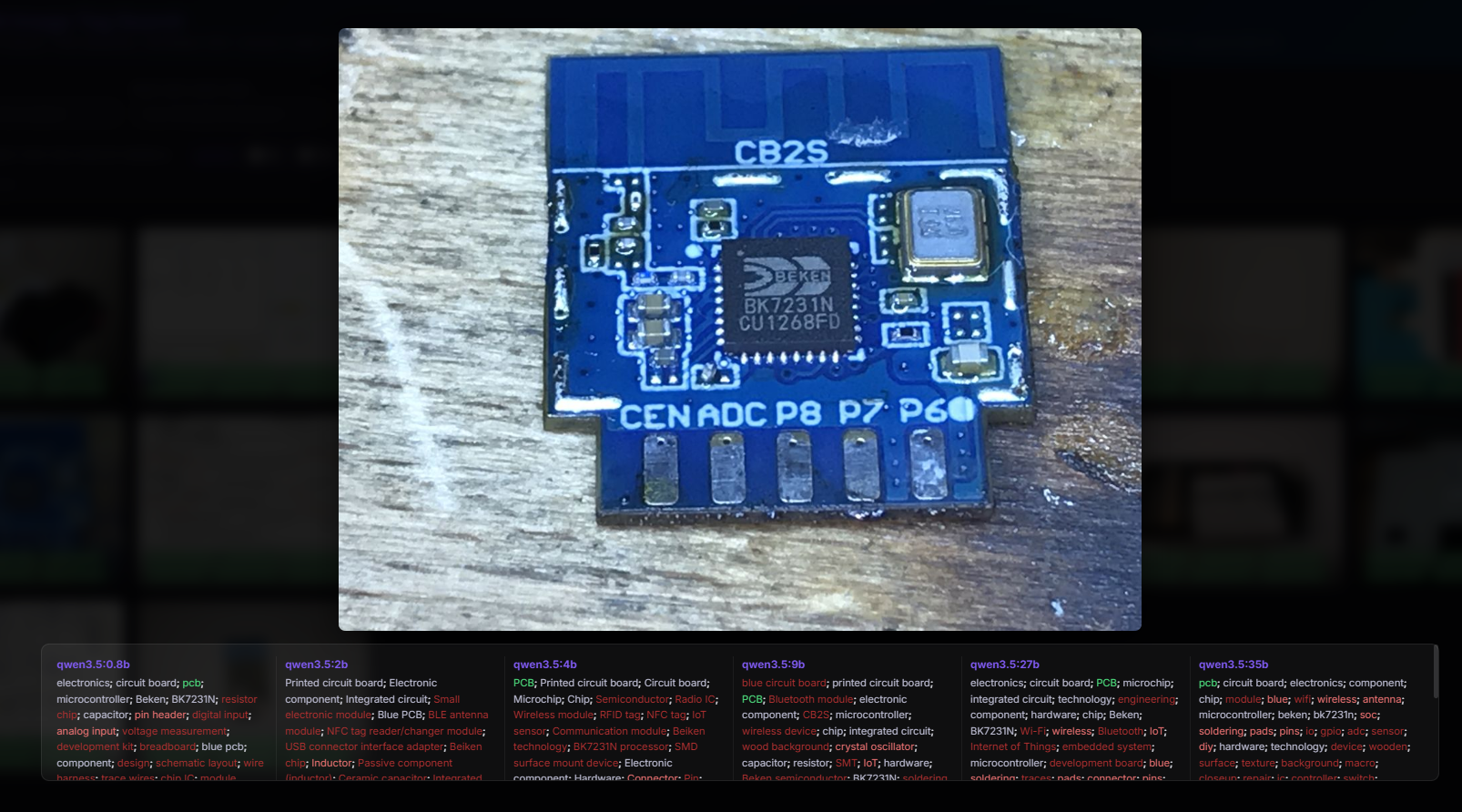

    Board with BK7231N microcontroller
    Close-up of CB2S PCB module with Beken BK7231N chip on a wooden surface
    https://openshwprojects.github.io/IndexingEle...azki.elektroda.pl%2F1667439100_1696245190.jpg
    Apparently the name is clearly visible, but it is still impressive that already the 0.8b version of the parameters read both the Beken and BK7231N lettering. The crunch, however, comes in the context of the name of the entire board - CB2S. CB2S was only read by model 9b and 2b. Even the 35b version lost it. This somewhat raises doubts about the reliability of these models, as such a Wi-Fi module name is important information for me.

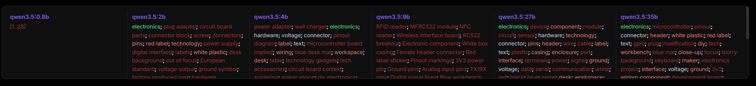

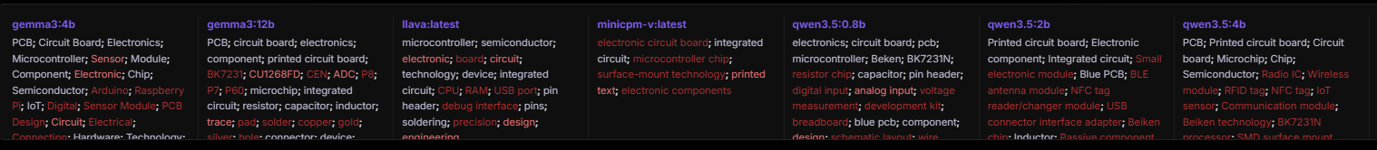

    Apart from that, you can see that many of the tags are quite accurate and correct. Obviously the tags from qwen3.5 are not much better than those from gemma3, llava or minicpm:
    Screenshot comparing AI tag outputs for a PCB board with BK7231N across multiple models
    One can also complain to qwen that some are out of place (NFC tag reader/charger module"), but this happens much less often than in older models.

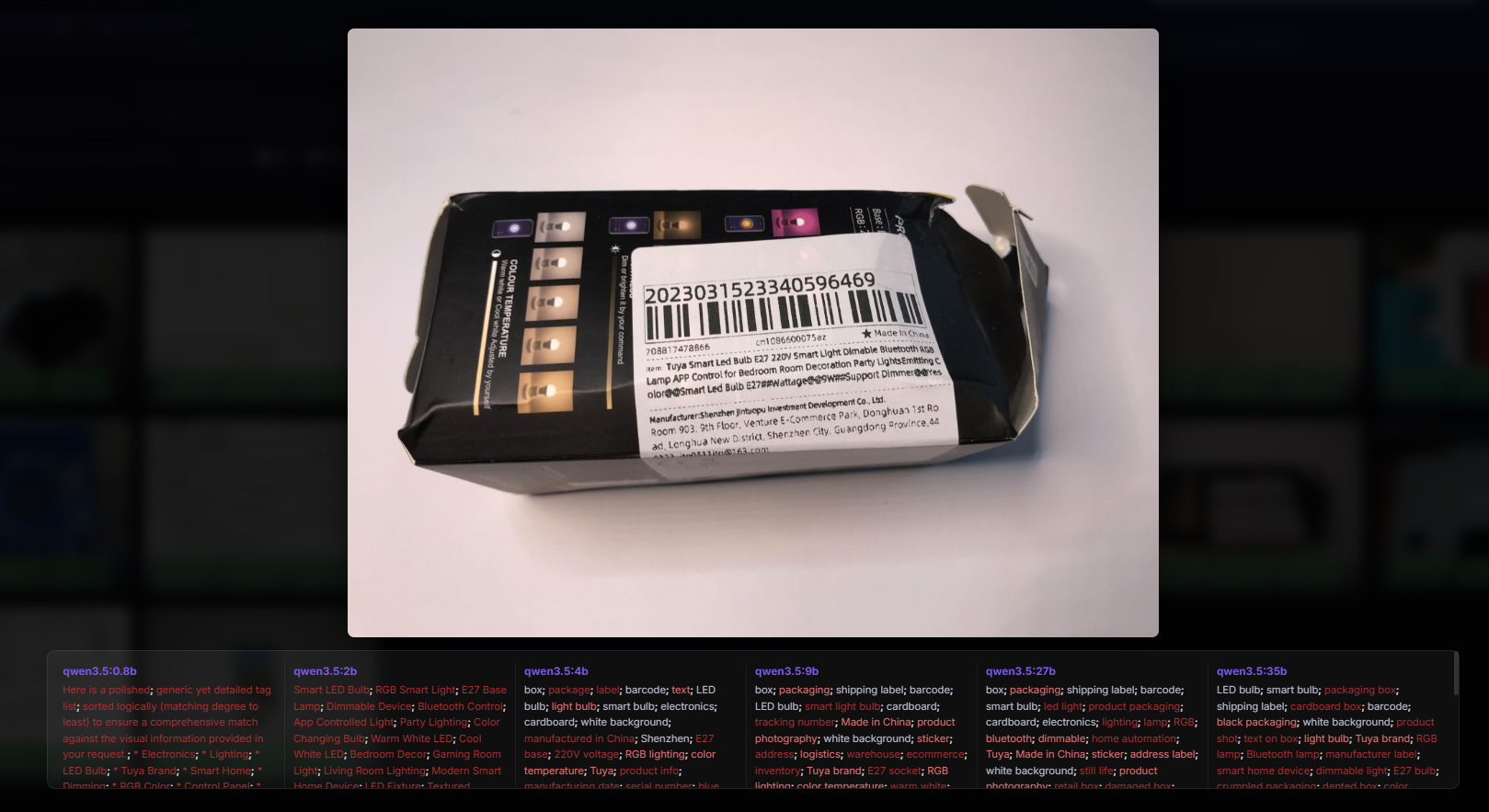

    Packaging of the LED light
    Crumpled black LED bulb box with a white label, barcode, and printed text on a white background.
    https://openshwprojects.github.io/IndexingEle...azki.elektroda.pl%2F3335603200_1739378203.jpg
    Here the striking part of the 0.8b model's verbal response is that instead of providing the tags themselves, it started the response with its introduction. The plus side, however, is that the tags are largely all correct, even the weakest models recognised that this was the E27 standard. They probably read from the text.

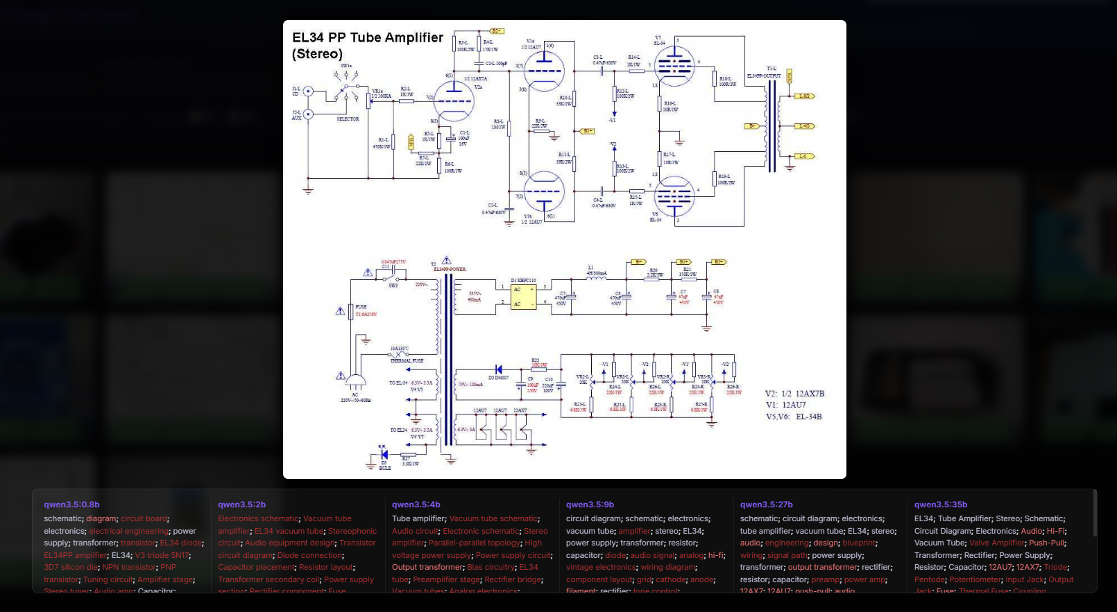

    Schematic of amplifier on EL34
    Circuit schematic of an EL34 PP stereo tube amplifier with a power supply section
    https://openshwprojects.github.io/IndexingEle...azki.elektroda.pl%2F8579096100_1606337170.jpg
    It was simple, but still good to know that even the 0.8b model read the EL34 name correctly. The rest of the tags are right on target too, there are terms there that mainly just fit the schematics. The two largest models also read 12AU7. Overall, I find it hard to point out anything quite nonsense there.

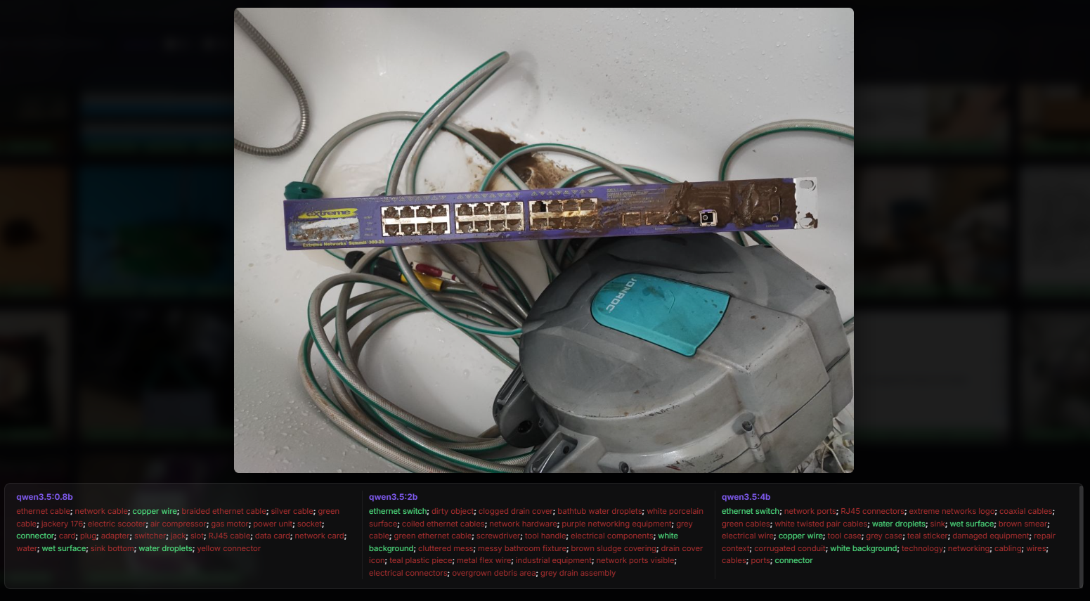

    Switch after flood and hose
    Dirty Ethernet switch with RJ45 ports in a bathtub, surrounded by tangled cables and a gray device part
    https://openshwprojects.github.io/IndexingEle...azki.elektroda.pl%2F4440455200_1744410509.jpg
    Now something difficult. In addition, without a test of the larger models. Nevertheless, the switch was recognised by models 2b and 4b. The 0.8b model was also close - "switcher". In addition, it identified it as a "network card" and also saw an ethernet cable somewhere, but this is unlikely to be correct. The cable itself is not in the picture. These "electric scooter" from the 0.8b model is interesting. It illustrates well that, however, there are still quite incorrect hallucinations in unusual situations.

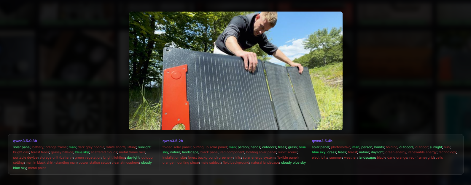

    Panel photo
    Person handling a large solar panel on grass, with trees and blue sky behind
    https://openshwprojects.github.io/IndexingEle...troda.pl%2F3738819600_1748852509_bigthumb.jpg
    Another good result. Virtually everything matches, except maybe that "battery" from the 0.8b model. Except that he in turn stood out with the customs "man in black shirt", the other models did not identify the shirt.

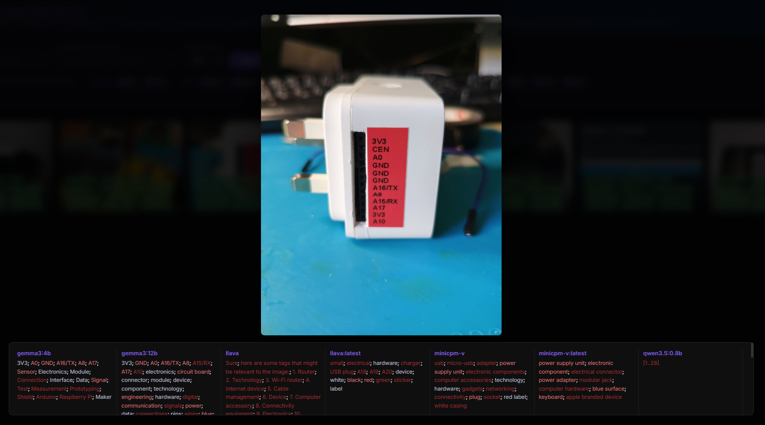

    Build with GPIO descriptions
    White plug-in device with a red pinout label on a blue work mat, shown in a screenshot with model tags below
    Here's where something strange happened with qwen3.5 version 0.8b - it generated what looks like an array programming record? The texts were read by gemma3 and a newer version of llava. Interestingly, the larger qwen3.5 also skipped them:
    Screenshot of a table showing tags generated by Qwen3.5 models for an electronics board image
    This unfortunately shows that, at least with my prompt, these models are not yet fully reliable, although they still often produce meaningful tags.

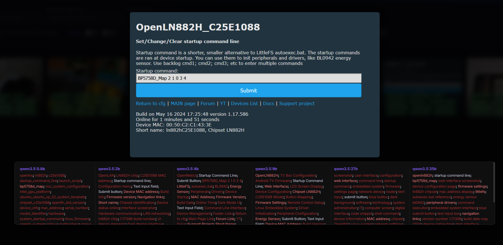

    OCR screenshot
    Screenshot of OpenLN882H page with “Startup command” field and “Submit” button
    https://openshwprojects.github.io/IndexingEle...azki.elektroda.pl%2F1417005500_1715987750.png
    It worked out quite well. Even the smallest qwen3.5 read the chip name (LN882H) and from the short name the code C25E1088. A bit of a hoot with the NUC and Intel, but that's understandable. The larger the model, however, I see slightly less of this hallucination. The only problem is the section with the 27b version:
    screenshot; user interface; configuration; web interface; command line; startup command; embedded system; firmware; settings page; network device; router; text input; submit button; blue button; dark background; software; technology; system administration; IT; computer screen; digital interface; code snippet; shell command; device information; MAC address; chipset; OpenWrt; Linux system; network settings; peripheral drivers
    In this case, the name "OpenLN882H" was not even read, which, again, suggests that the models are not working completely stably and perhaps you would need to experiment with the prompt or repeat generations several times and collect the common part of the tags.

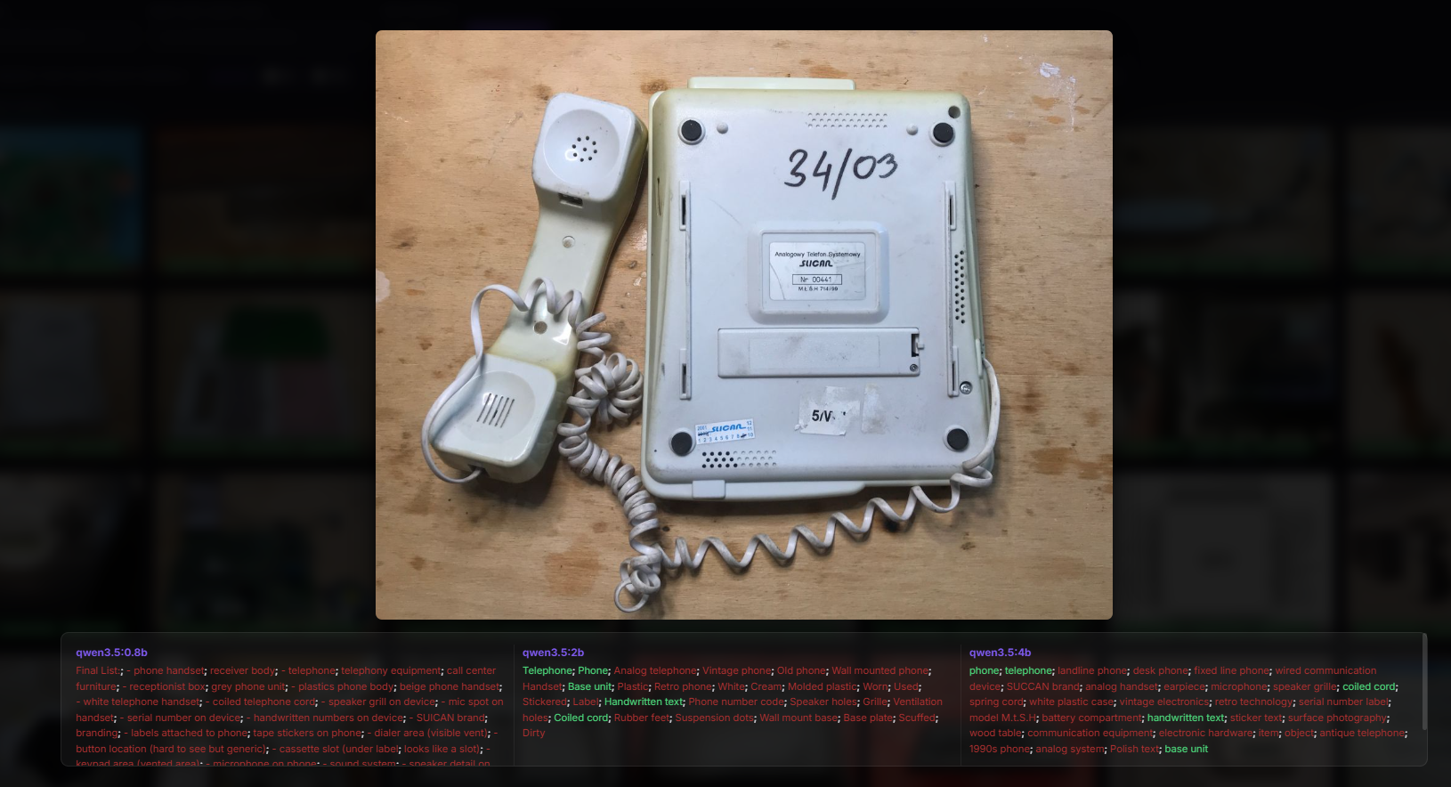

    Old phone
    Back of a Slican landline phone with handset and coiled cord on a wooden surface
    https://openshwprojects.github.io/IndexingEle...azki.elektroda.pl%2F7651628500_1633732341.jpg
    No great comment here - the simpler something is, the easier it is to describe. The models have the same. Qwen3.5 version 4b even wanted to read the Slican name, but it came out SUCCAN brand.

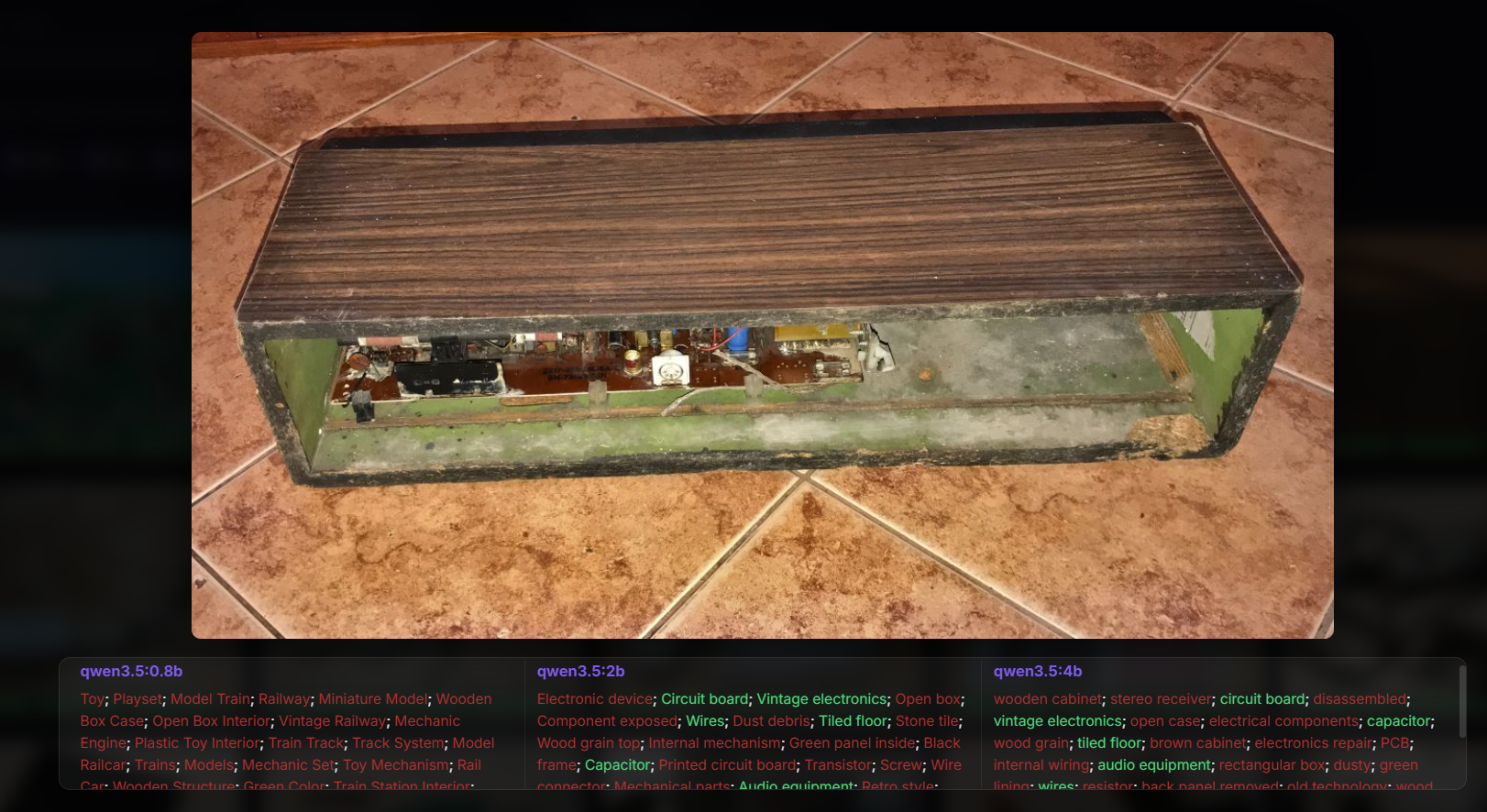

    Standard radio
    Open wooden device enclosure with visible circuit board and wiring on a tiled floor
    https://openshwprojects.github.io/IndexingEle...azki.elektroda.pl%2F1558884600_1665150103.jpg
    A difficult task, so poor results. There are no distinctive elements in the photo, so the 0.8b model recognized it as a toy or model train.... slightly larger models already picked out "stereo receiver" or thereabouts "vintage electronics", so tags would probably be useful anyway.

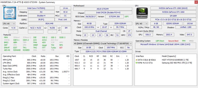

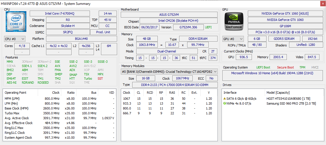

    Tagging performance
    A separate issue is how long a single image is described. I generated my data on two machines, an old gaming laptop and a more powerful computer - a workstation. The results so far are from the laptop:
    HWiNFO64 System Summary screenshot for ASUS G752VM: i7-6700HQ, GTX 1060, 48 GB RAM.
    For a sample of 5-8 images per model:
    Model Minimum time (s) Max time (s) Medium time (s)
    qwen3.5:0.8b 33.40 126,89 76.64
    qwen3.5:2b 39.22 98,43 61.70
    qwen3.5:4b 129.77 <br/394,49 222.36
    qwen3.5:9b 303.79 755,80 488.44
    qwen3.5:27b 1152.14 2661,42 1864.92
    Smaller models generate about a minute, probably with more images more values would separate. The 4b model already requires about 4 minutes on average. 9b twice as long - over 8 minutes. the 27b on this equipment generates an average of 30 minutes per image. Larger ones I have not tested on this laptop.
    I will complete the results from a more powerful computer separately.

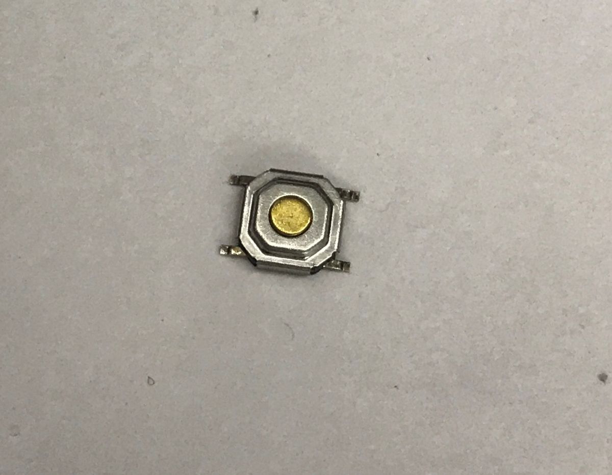

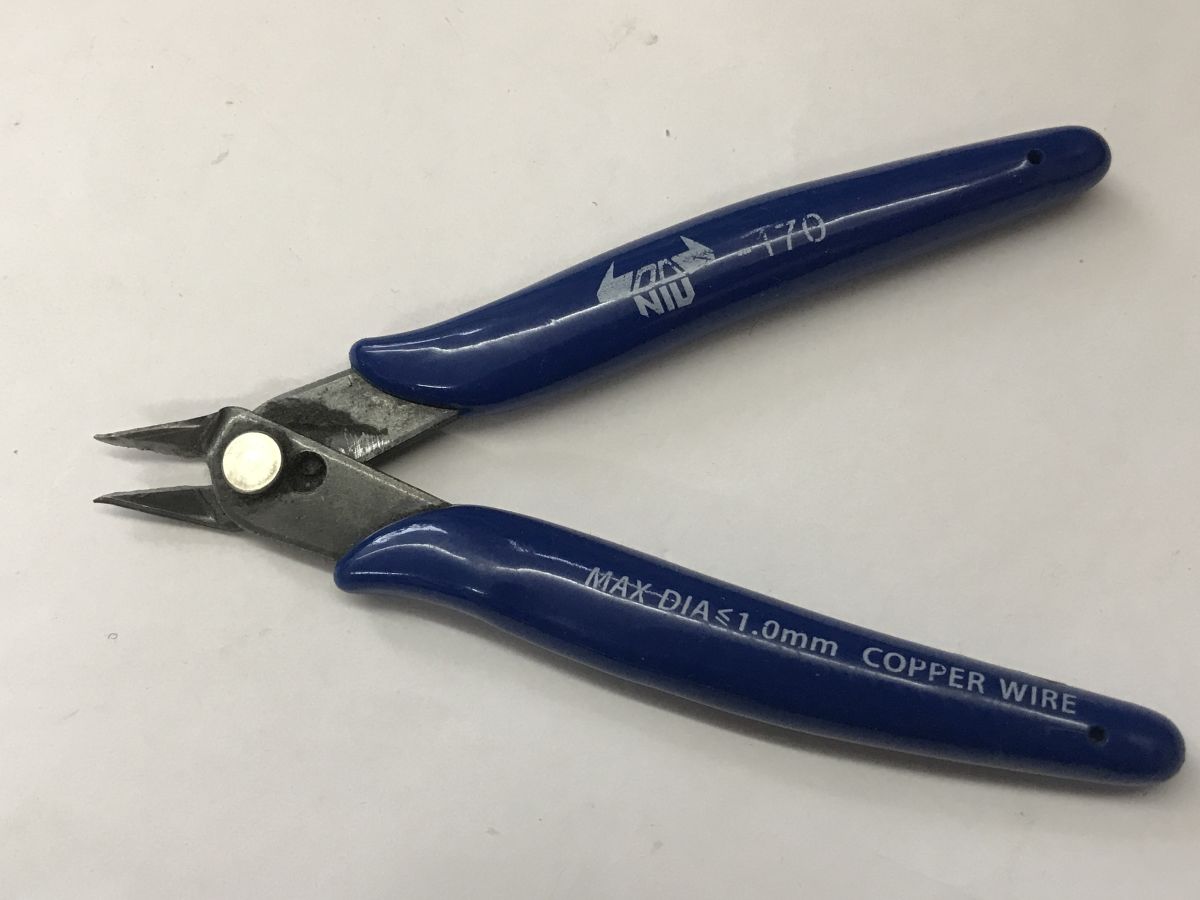

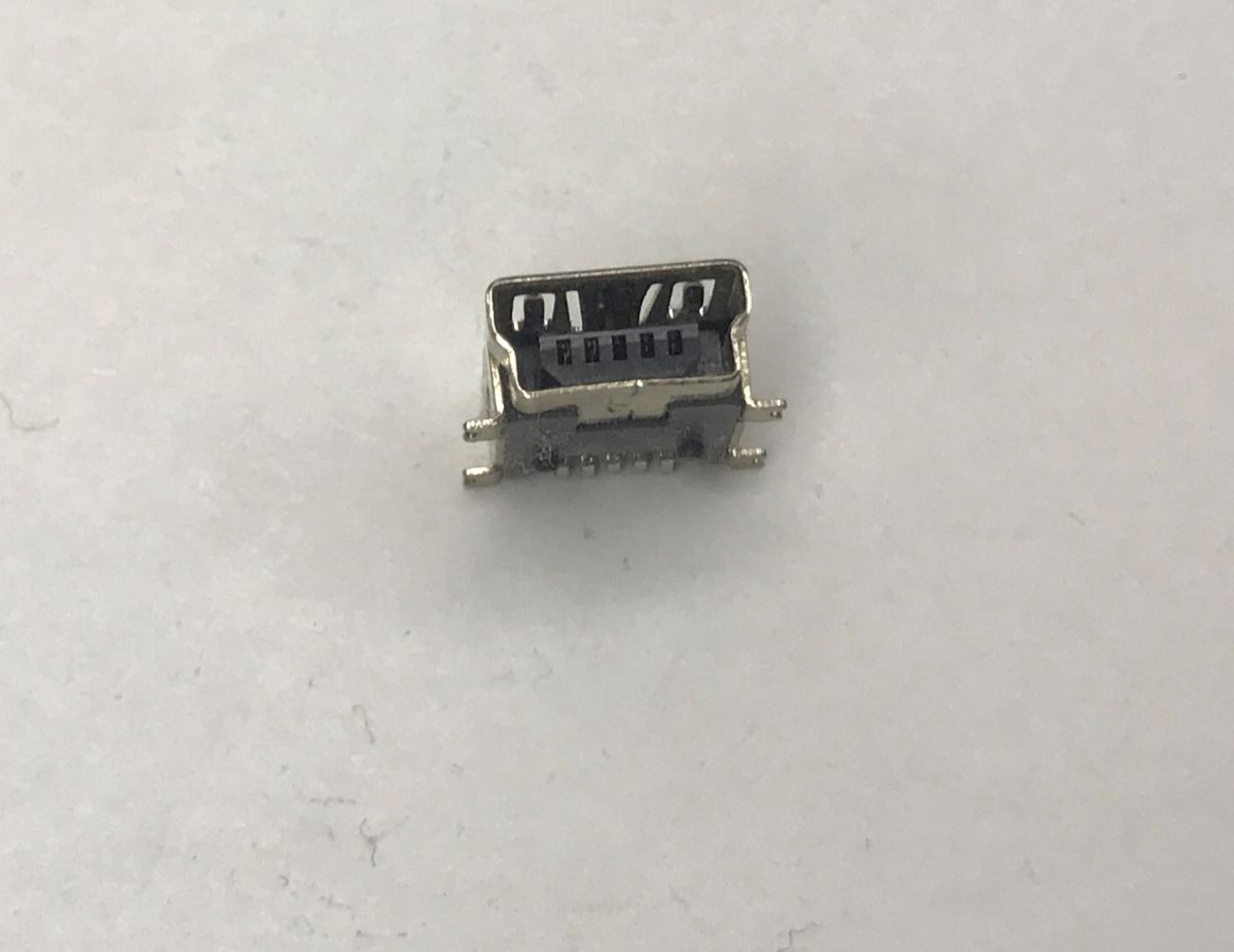

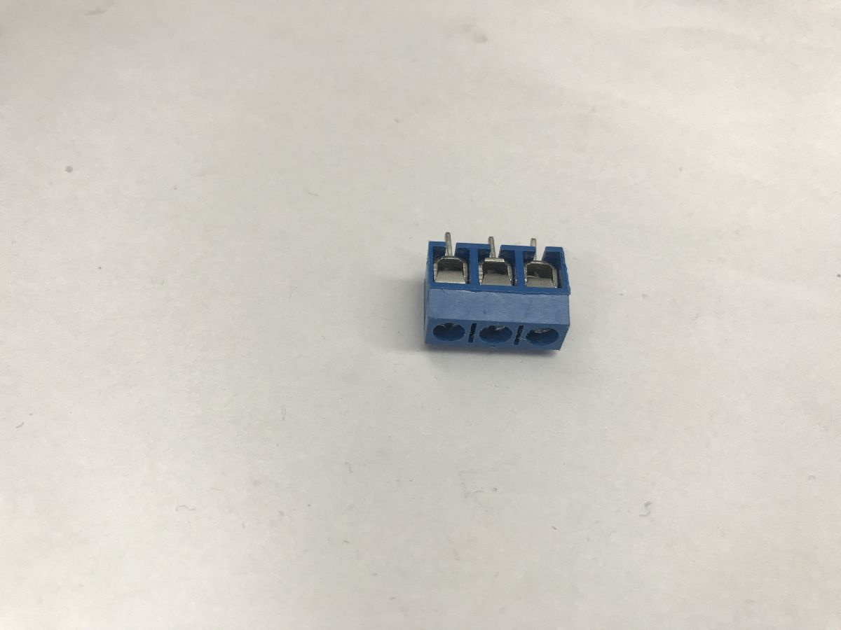

    Hey, you can see that this model works pretty well, I wonder how/whether it would work for indexing electronic components....
    On another topic https://www.elektroda.pl/rtvforum/topic4159786.html (although it's not the only one), you're building your own storage for parts/things, makes me wonder if, based on photos of the contents of the component drawer, it would be able to catalogue them well enough. Even tentatively prompting him for context (if that's a possibility). I wonder if he would correctly recognise that there are diodes / resistors, relays, switches, etc. in the drawer, and how detailed he would be able to do so. You could also insert two pictures from different perspectives for him (if there is a possibility).

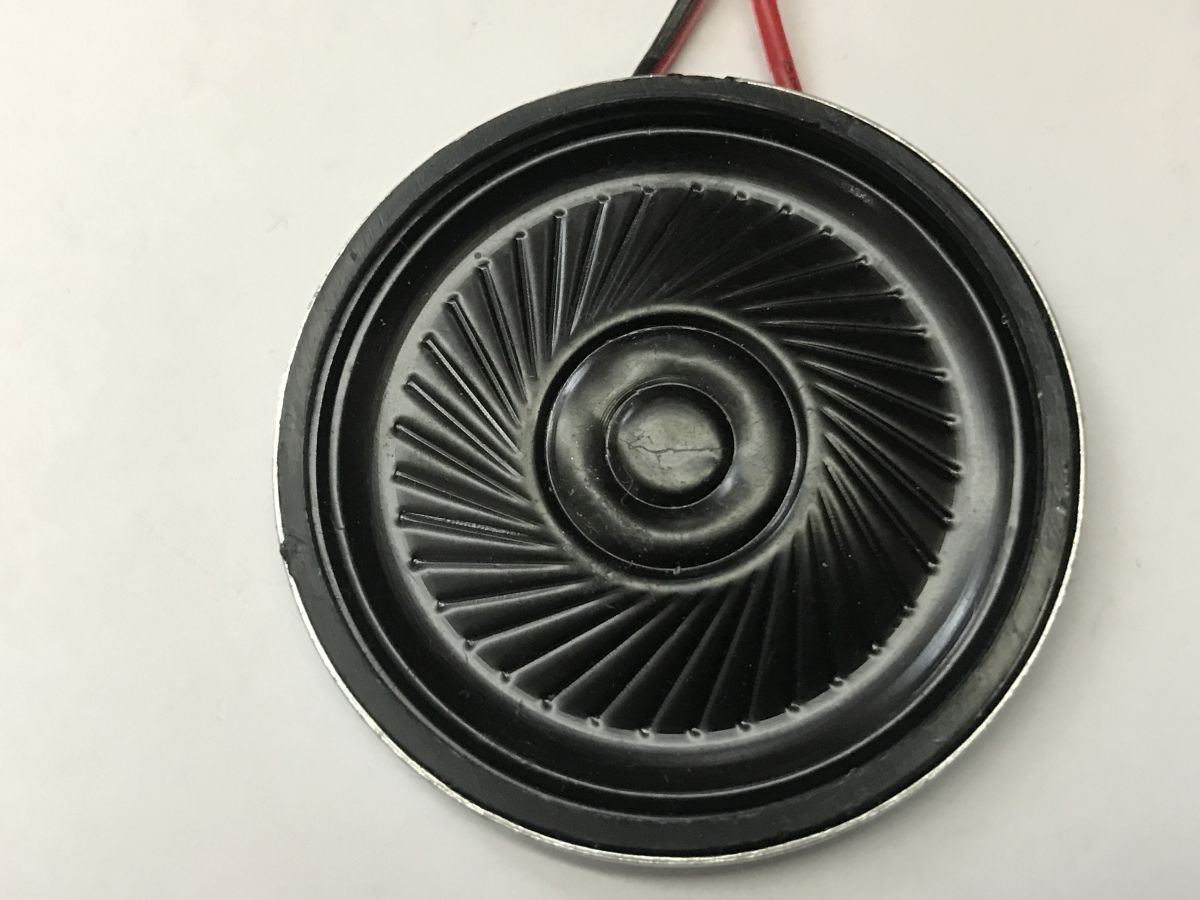

    Let's try it, starting with the simplest tasks first. Do you have any pictures of what I can use for testing? For now I have taken these myself:
    Black round loudspeaker with ribbed cone on a light background, red and black wires at the top Blue diagonal cutting pliers on a light surface, with visible text on the handles. Power transistor in a TO-247 package with three leads on a light background Small metal mini or micro USB socket on a white surface Small metal electronic push button with four leads on a light background. Blue 3-pin screw terminal block on a light background, top view Small metal electronic push button with four leads on a light background. Blue 3-pin screw terminal block on a light background, top view Blue 3-pin screw terminal block on a light background, top view
    I will run a tester on them and give the results.

    ele generates about a minute, probably with more images the values would be more delineated. The 4b already requires about 4 minutes on average. 9b twice as long - over 8 minutes. 27b on this equipment generates an average of 30 minutes n
    I wonder how smoothly this would run on some GPU with more reasonable memory and "tensor cores".
