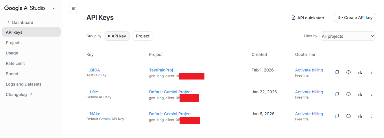

    I assume we already have a Google account and are logged in at aistudio.google.com. You also need to have a payment system hooked up, although you can also use the trial version - Google gives out trial periods and start-up credits quite generously. You start by creating a project and a key - you need to have one in the Keys API:
    Screenshot of Google AI Studio API Keys page listing API keys, projects, and “Activate billing” links

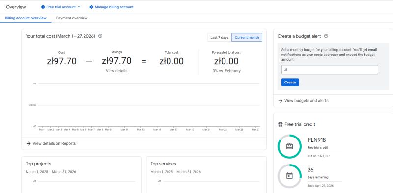

    Our costs, in turn, are available in billing, and we need to keep a close eye on them there. Each model has a cost - I won't repeat it again, but it is easy to use up a lot of tokens.
    Screenshot of Google billing overview showing total costs in PLN and a budget alert creation panel.

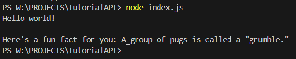

    Hello World - text prompt
    As "Hello world" I will run the simplest LLM model with a simple prompt. In the library used, it boils down to specifying the API key, selecting the model and sending the prompt:
    https://github.com/openshwprojects/GoogleAIDemos/blob/main/helloWorld.js
    The result:
    Screenshot of a PowerShell terminal running Node.js, outputting “Hello world!” and a fun fact about pugs

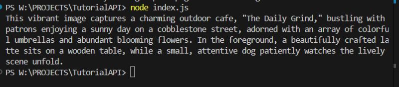

    Image description (prompt + text)
    Today's models, however, are multimodal, and can also describe images. Such images are attached here encoded by Base64. I have prepared an example image for testing:
    Street café terrace with colorful umbrellas, flowers, and a dog beside a table with coffee
    The code gains a few extra lines to process the image. Prompt further is also up to us:
    https://github.com/openshwprojects/GoogleAIDemos/blob/main/describeImage.js
    Result:
    Terminal screenshot showing node index.js output: an English description of a cafe photo.

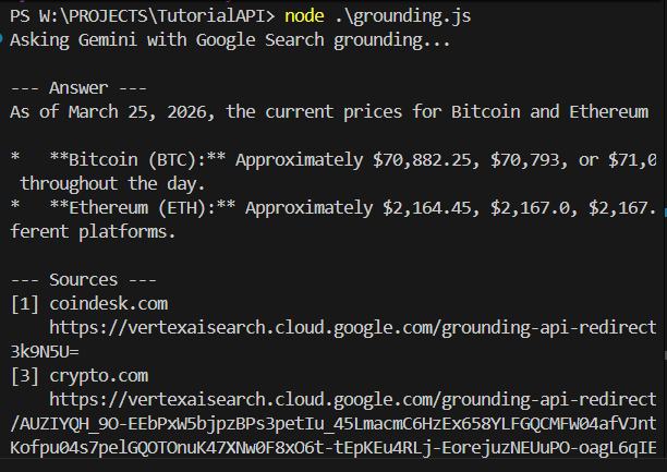

    Grounding, or source-finding
    Today's AI models can still hallucinate, but fortunately various tools, such as the search engine, can be made available to them so that they can provide more valid and reliable answers. Instead of relying solely on knowledge from training, it can refer to data we have prepared in advance or to those found on the internet. This reduces the risk of errors and so-called hallucinations. The search engine is plugged in via the "tools" object:
    Code: Javascript
    Result (abbreviated):
    Terminal screenshot showing Gemini with Google Search grounding returning BTC and ETH prices and a list of sources.

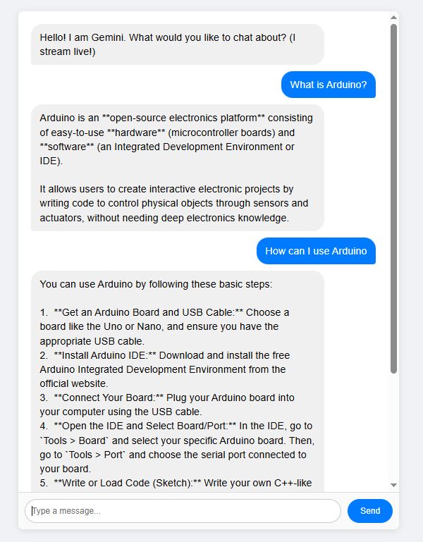

    Example chat
    Of course, you can also easily make a substitute for the classic chat, the kind that became popular with the entry of ChatGPT. A simple chat with an assistant. Here, it is only worth noting that when the AI creates a chat, a system prompt can be defined - it determines the behaviour of the assistant:
    Code: Javascript
    https://github.com/openshwprojects/GoogleAIDemos/blob/main/chat.js
    The simplest chat does not support decoding of bold, code blocks, etc, but the rest of the behaviour is in line with what we know from official products:
    Screenshot of a Gemini chat with questions about Arduino and replies as paragraphs and a step-by-step list.
