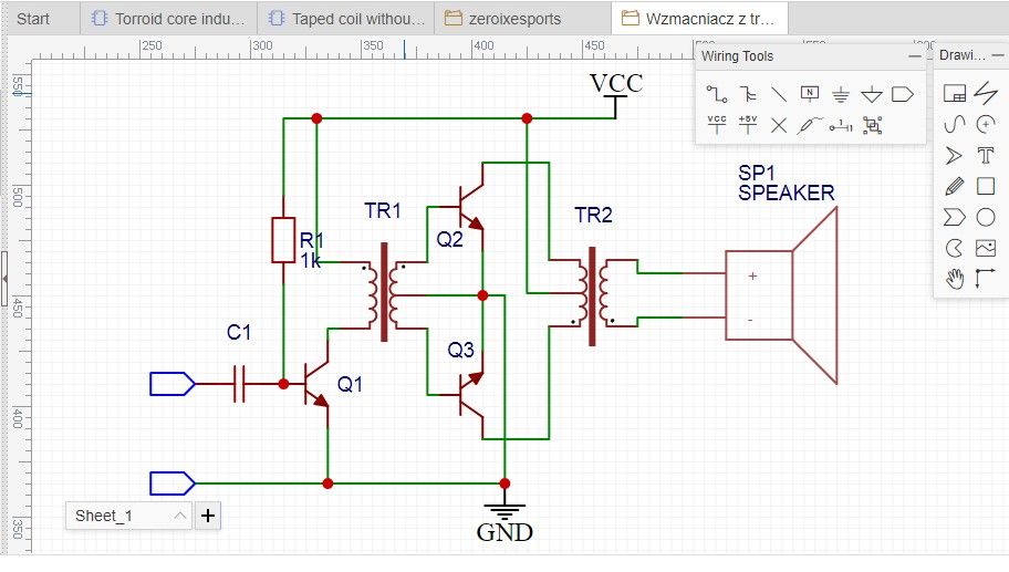

    Of course, there are also amplifiers based on germanium transistors without transformers. However, due to their lower amplification factor, they are usually equipped with an additional stage that imparts the desired timbre to the sound through the introduced distortion.
    A typical schematic of a transformerless amplifier looks as follows:
    Why the popularity of germanium transistors in audio, better than silicon?
    Amplifier without transformers. source: https://cxem.net/sound/amps/amp259.php
    As you can see, there is a complementary pair in front of the terminal transistors. A few days ago there was a question on the forum why amplifiers on germanium transistors are so often made with a transformer. I already explain.

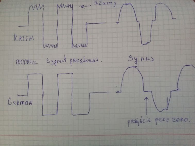

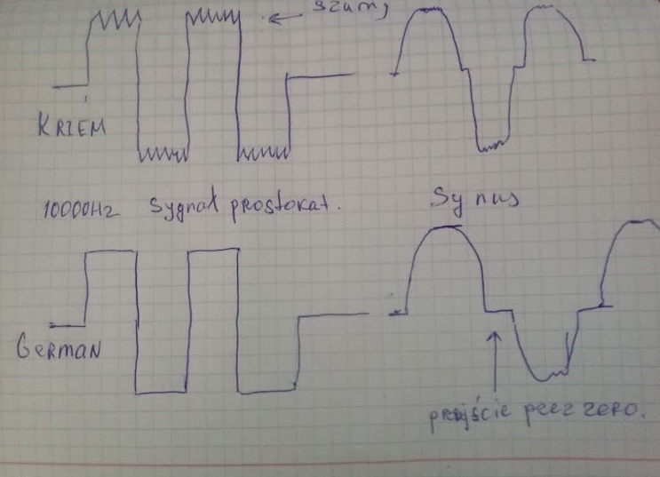

    For this reason, one proponent of 'germanium sound' tried to convince me that germanium elements - due to their low cut-off frequency - do not generate harmonics, presenting an oscillogram similar to the one shown in the figure.
    Hand-drawn graph paper sketch comparing “Silicon” and “Germanium” waveforms: square wave and sine wave
    However, as can be seen, the harmonics and noise have frequencies above 10 kHz and are therefore not audible to most listeners. On the other hand, germanium transistors have a higher noise floor. Although there are special grades of germanium transistors (e.g. Soviet: ГТ107, ГТ108, ГТ308, П27, П28, МП39Б), they did not survive the era of silicon transistors and are now very difficult to find.

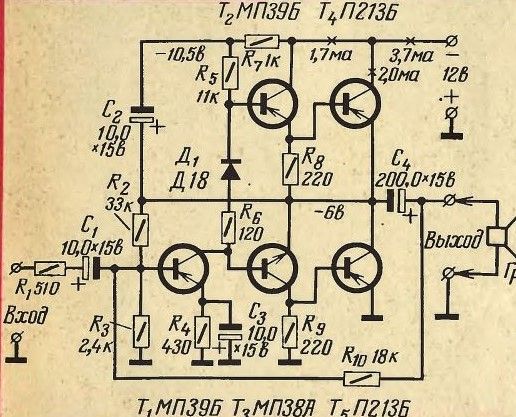

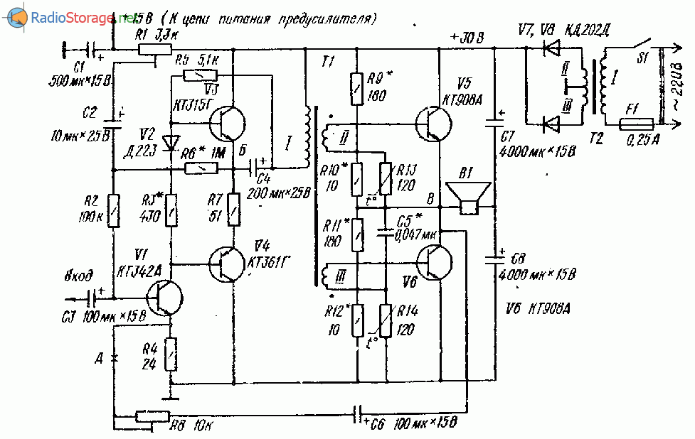

    Silicon transistor amplifier with transformer. source magazine "Радио" №1/1981

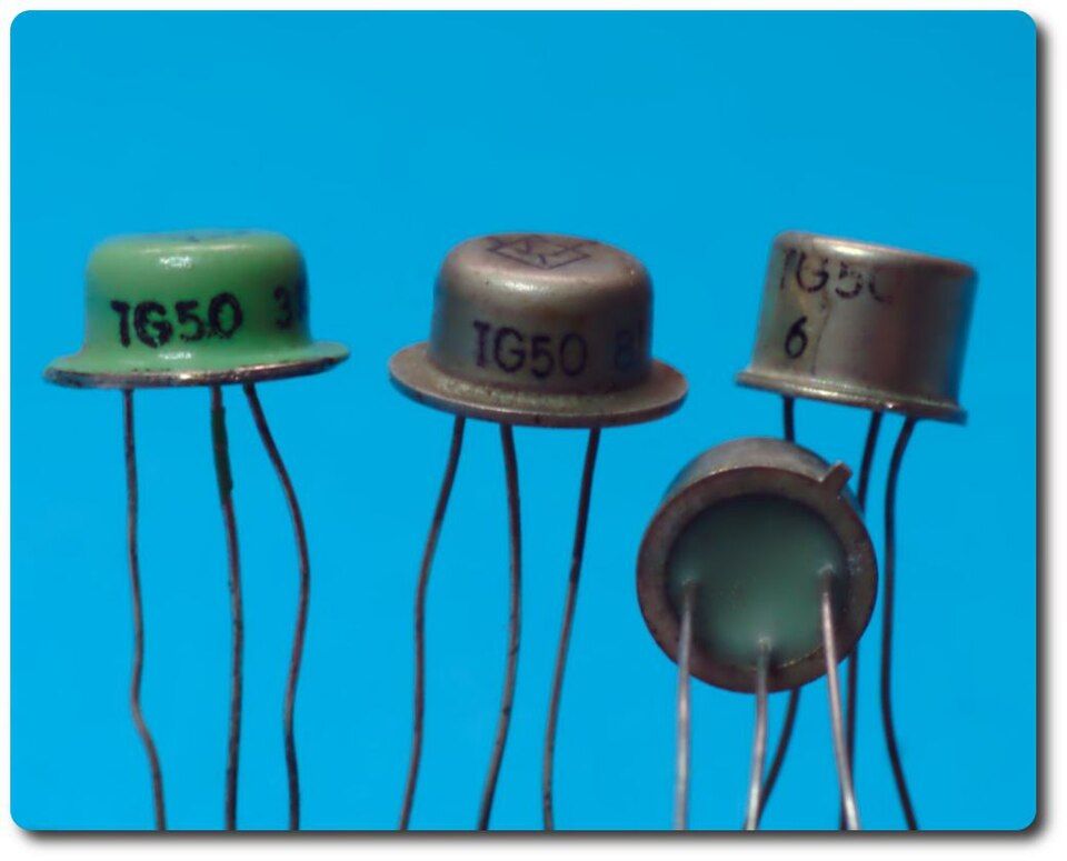

    In Poland, germanium transistors of the TG5, TG50 and TG70 series were popular. The TG50 models came in a distinctive green casing - you may remember them or their later version in a metal casing, no longer painted with paint.
    Four TG50 germanium transistors in metal can packages on a blue background
    Source: Wikipedia

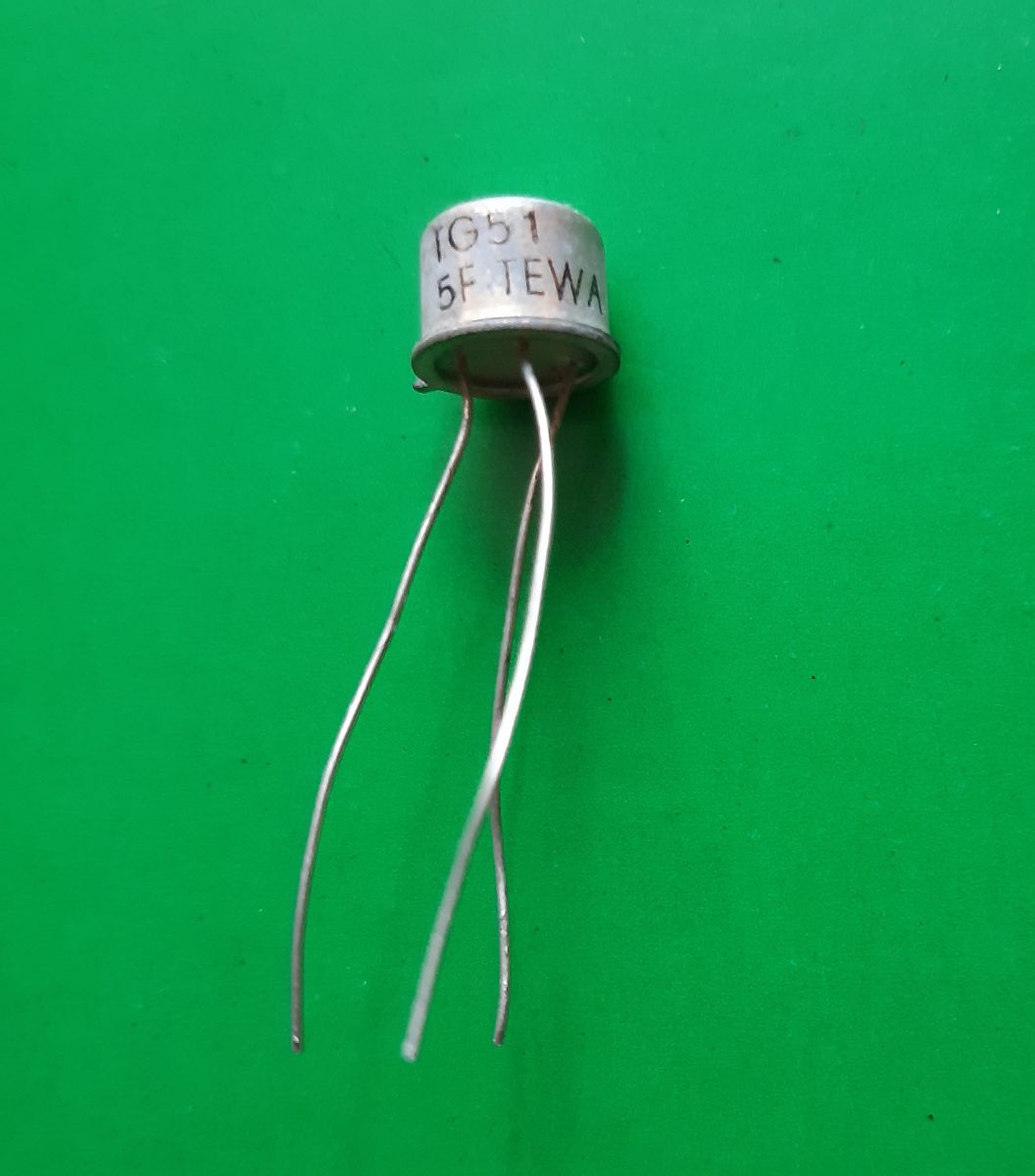

    Below the less common TG51 made by TEWA, which is believed to have been used in inverters.
    Metal-cased transistor with three leads on a green background, labeled “TG51” and “TEWA”.

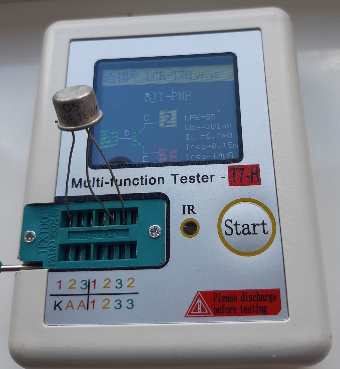

    Despite the passage of years, the tester still shows the efficiency of this transistor.
    Metal-can transistor connected to an LCR-T7H tester showing BJT-PNP measurement results on the screen

    And wasn't it generally the case that a germanium diode starts conducting already from 0.2V, i.e. the voltage drop at the germanium junction is of the order of 0.2-0.3V, and at the silicon junction 0.6-0.7V, which significantly reduces the cross distortion when the sine wave passes through zero?
    Shouldn't this oscillogram be reversed?

    saly wrote:
    that a germanium diode starts conducting as low as0.2V, i.e. the voltage drop across the germanium junction is in the order of 0.2-0.3V and the silicon junction 0.6-0.7V,
    This is true, right.
    saly wrote:
    which significantly reduces the cross distortion after the sine wave passes through zero?
    However, there are other factors of germanium technology that increase significantly.
    No. I wanted to show that due to the higher transition capacitance on the germanium transistor the zero voltage is slightly longer than it would be on a silicon transistor. Admittedly, in amplifiers designed with silicon transistors (without a transformer), high-frequency harmonics can be generated at the zero crossing. According to proponents of germanium, this phenomenon spoils the sound. I doubt it, because I do not hear it.

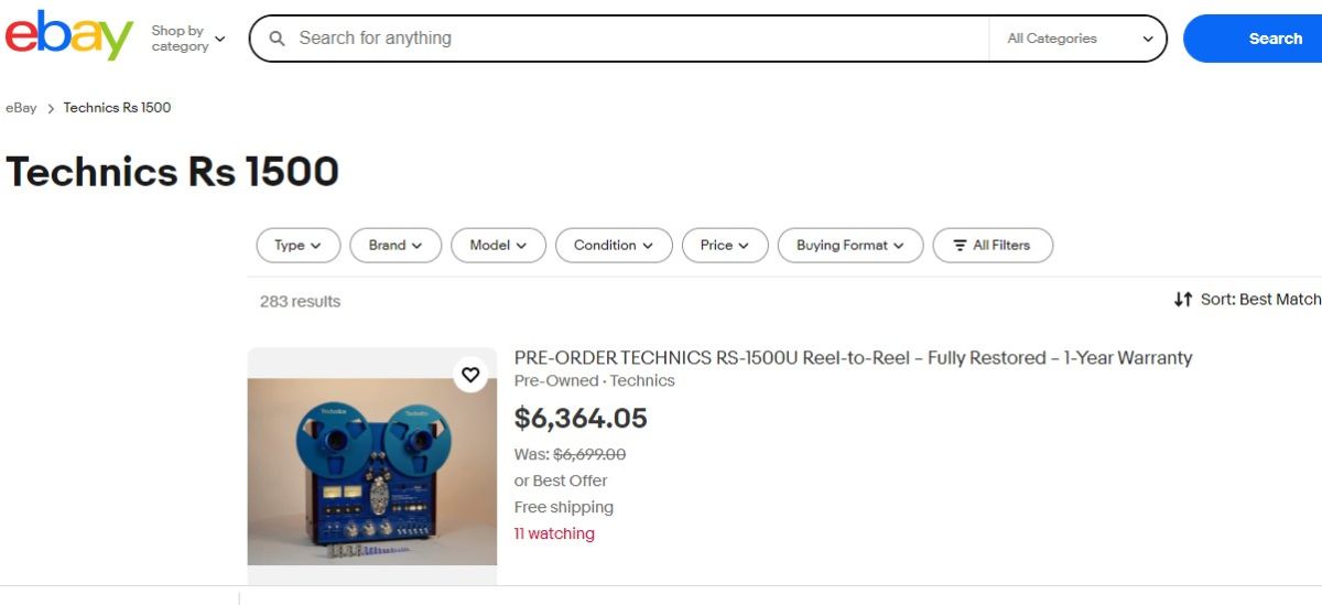

    elukam wrote:
    I have long assumed that we will probably still see the return of wire tape recorders
    the reel-to-reel ones are already making a comeback and cost a fortune.
    Screenshot of eBay results for “Technics Rs 1500” showing a listing priced at $6,364.05
    The Tr-1000 from Analog Audio Design costs US$26,000 on average.

    andreyatakum wrote:
    The Tr-1000 from Analog Audio Design costs $26,000 on average.
    Just because someone puts out at that price doesn't mean there will be a buyer.
    As for audiophiles and their equipment, they are most often people who are as deaf as a stump but who have a lot of money and thus tickle their ego. This is why golden HDMI cables are made for them to improve sound and picture. Or amplifiers that sound mediocre, but look nice and expensive and are for fat $.
