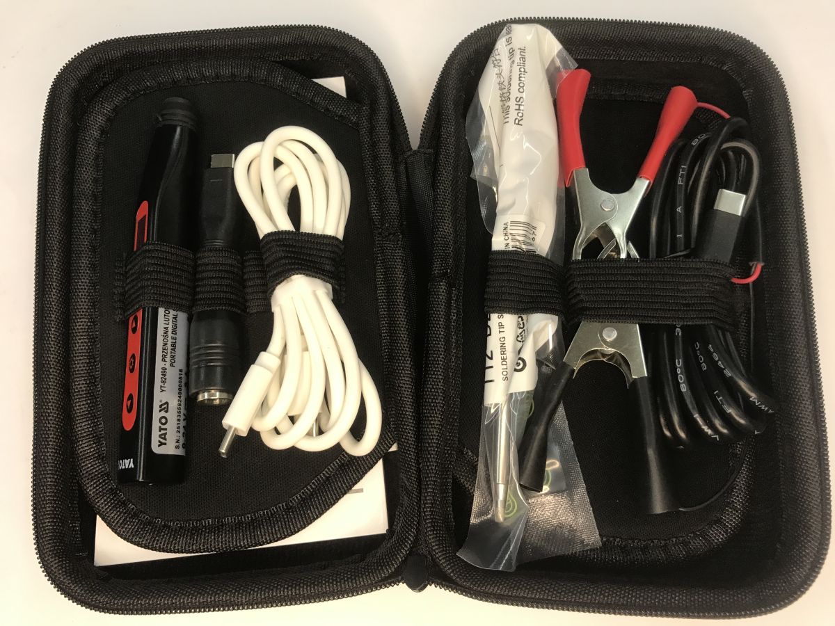

    With three leads, including one with crocodile clips, this soldering iron could even be fired from the battery. It promises to be promising. One T12 tip for testing is also included - T12-D24.

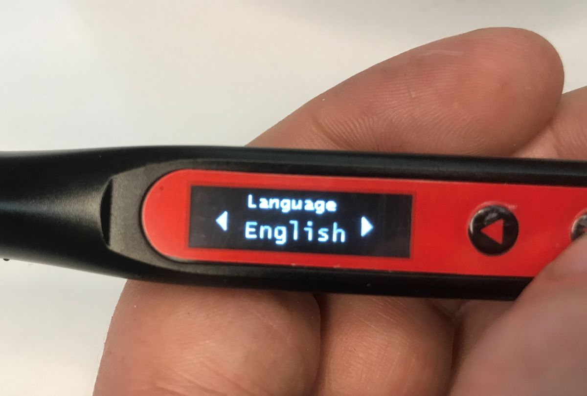

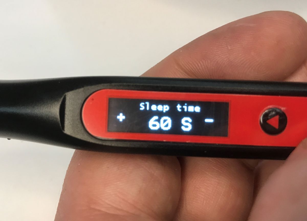

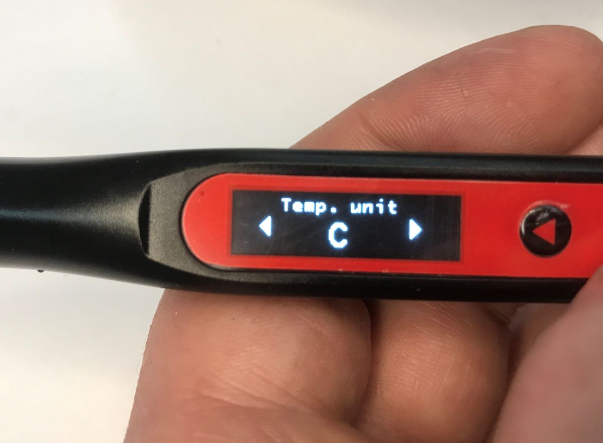

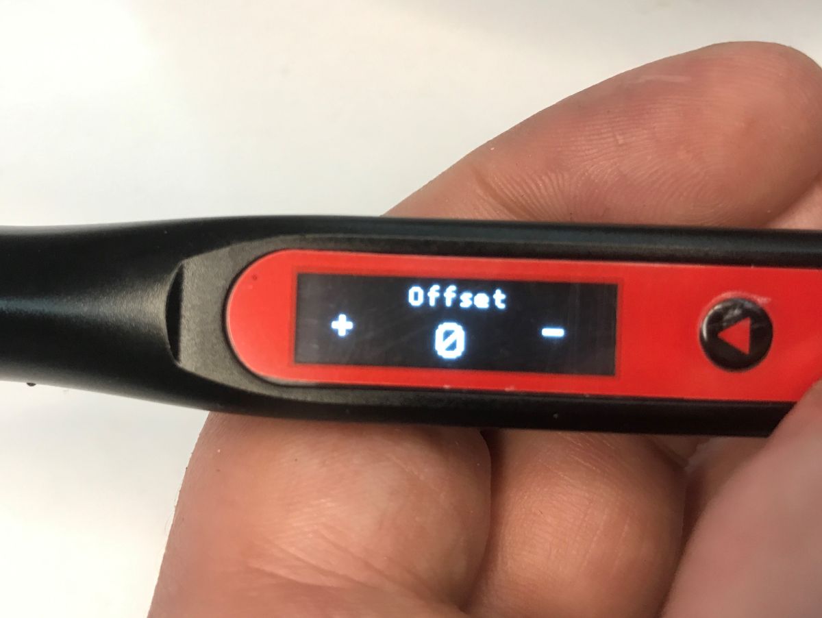

    The display is clear and easy to read, looking better in person than in the photos. Even the input voltage is shown, and you can also change the language in the options.

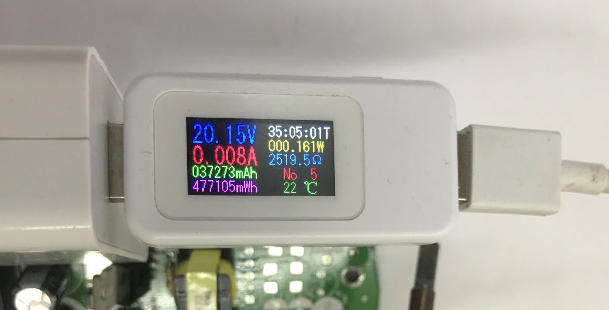

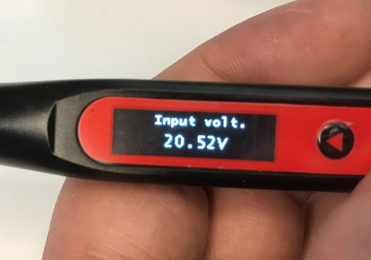

    The whole thing is indeed capable of switching on 20 V with a suitable QC/PD-compatible power supply. What's more, I used a really old unit for testing, still from a 2021 Xiaomi 11T. The five-year-old hardware is fully capable.

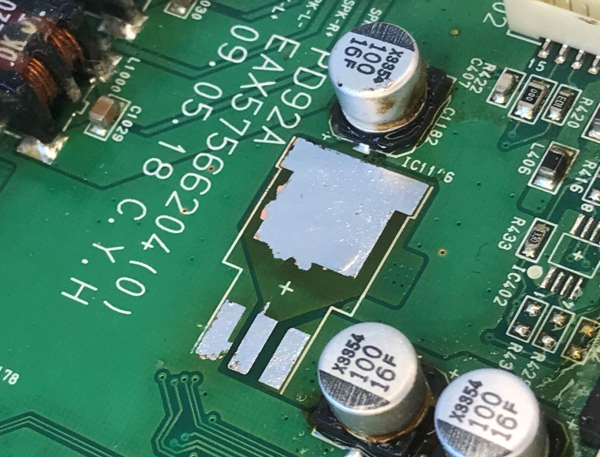

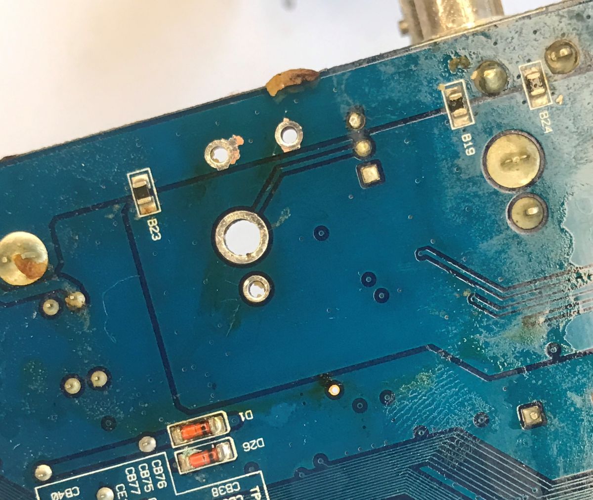

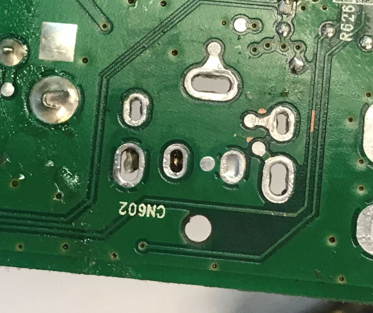

    Troubleshooting the connector - 450°C:
    A bit of such silly wrestling came out as the board was riding in front of the camera, but I tried applying lead binder to the connector solder and seeing if I could get it all hot enough to get the connector off the PCB. I then cleaned the holes a little with braid:
    Results:
    Is it worth buying a USB C soldering iron? We are testing the Yato YT-82490 65 W compatible T12
    Not a bad way to clean it up, even considering the "riding plate" and camera tripod blocking movement. It's a bit of a shame about the braid, suction would have been better, but I wanted to see if the heating would be enough to pick up the binder with it. There is no doubt this soldering iron can do the job.

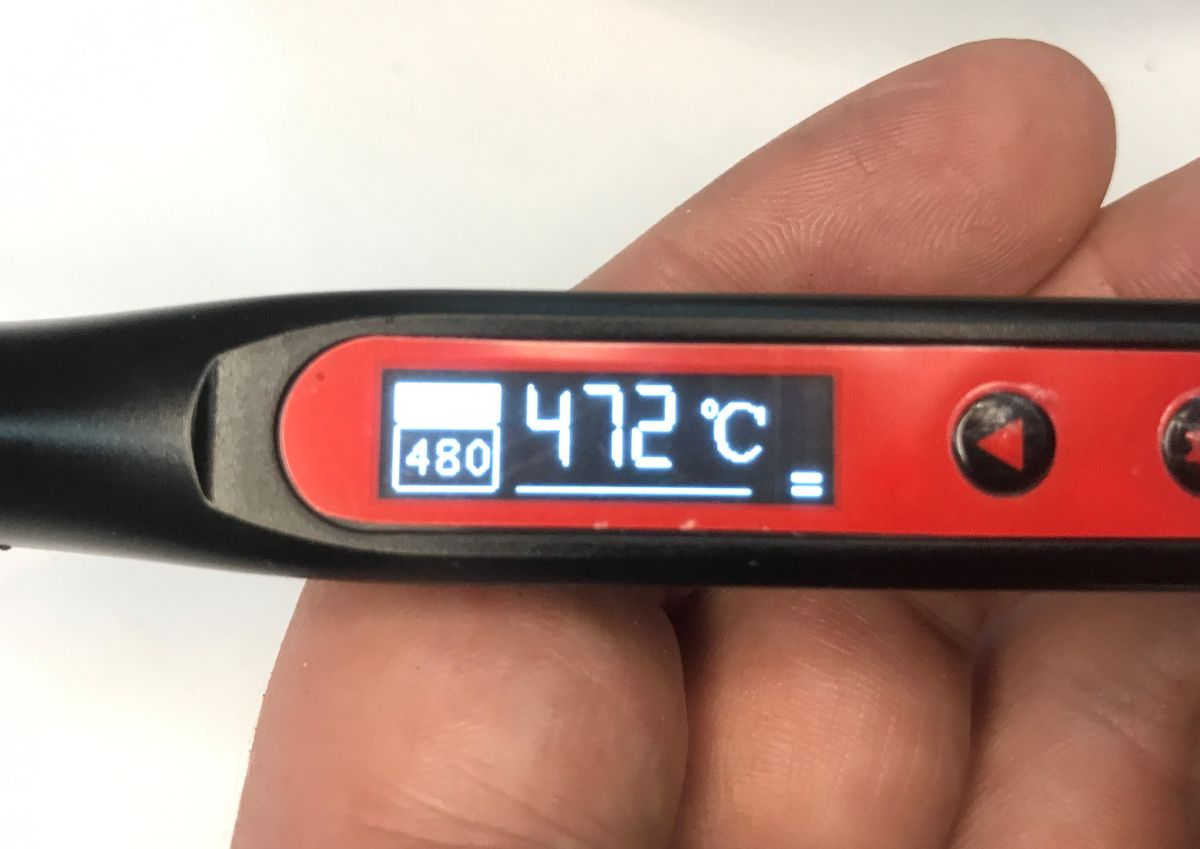

    As above, test number 2 - 480°C:
    Successful again, no doubt this soldering iron can do the job.

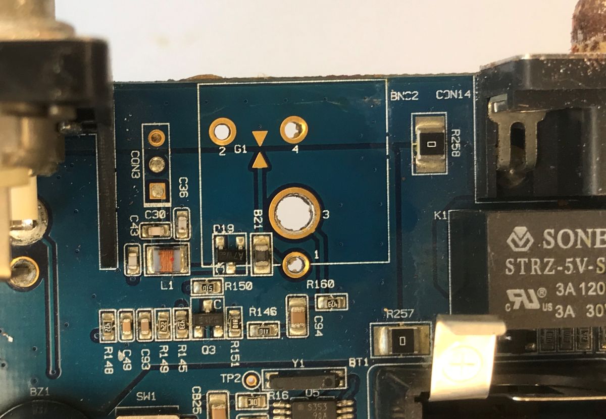

    Close-up of a blue PCB with solder pads, traces, and printed component labels
    Close-up of a blue PCB with solder pads, vias, traces, and labels B23, B19, B24
    Heat up from 0 and play with cottage solder - 480°C:
    This time the soldering iron heats up from 0, you can see it in the video. Then I try to wildly solder a transistor from it, which also has a large ground pad. Will there be enough heat output? We are about to find out.
    It worked, and a little bit of the pad was cleaned up too, although the PCB could still be improved.

    Brief test of actual heating power - comes out at 40 watts.

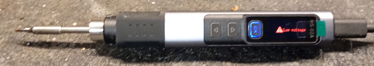

    I have been carrying the Fnrisi HS-02A with me for several months now;
    A nice piece of equipment, but not suitable for thicker cases. There is no built-in battery. As for the T12 itself, there are several types of blade, varying in power and dimensions. Pictured above, is the connection to the USB port of the computer. When working with a USB PD charger/power supply, there are no problems.

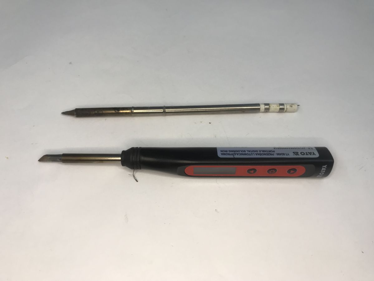

    What kind of soldering tip does the soldering iron you showed have? I think I associate it with the weaker, battery operated copies. My impression is that it's a bit of wasted potential. Once there's corded power, I always prefer at least a T12.

    I don't remember the exact designation, overall length approximately 8 cm. Here you have to pay attention. I had a T12, which I lost after changing the cob (mainsail holder). Apparently the plug is the same, but the connections and the mainsail itself are completely different. And a curiosity, the power supply is whole, the microcontroller in the controller died. I purchased another one in the Plus version.

    A question - this HS 02A soldering iron seriously has the 100W?
    And is it seriously for T245 tips?
    To the author, thank you for the review.

    I have just checked; the factory mainsheet is C245-KU. The power depends on the power source. I consider the declared 100W to be realistic with a suitable power supply.

    >>21906851 this is a T12 type K (Knife) spearhead available on aliexpres for £8-12 depending on the offer.
