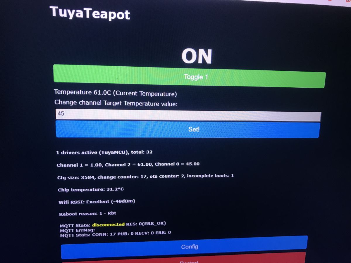

  • After intercepting UART traffic and flashing OpenBeken, the kettle works locally without manufacturer servers and can be discovered by Home Assistant.
  • The main caveat is safety: the power supply appears uninsulated, so the UART lines cannot be connected directly to a computer.

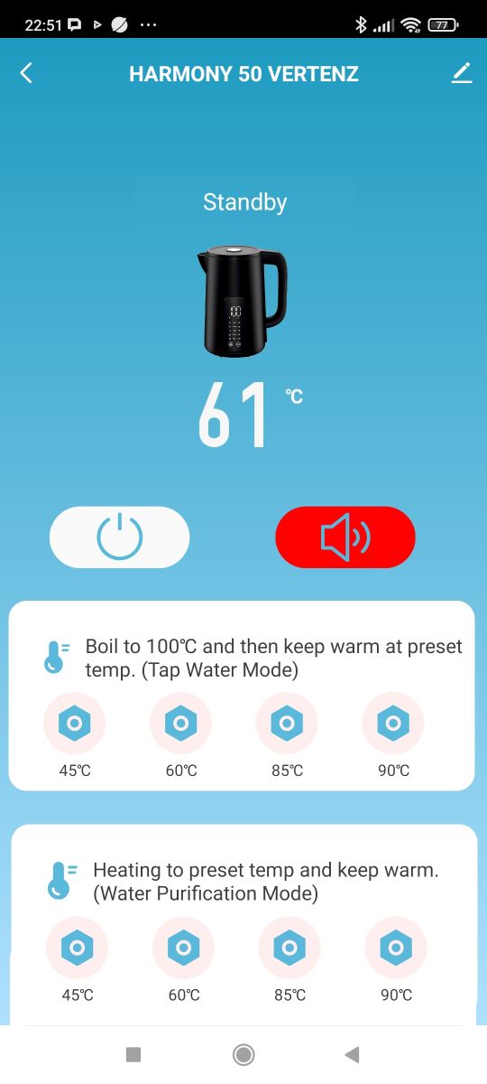

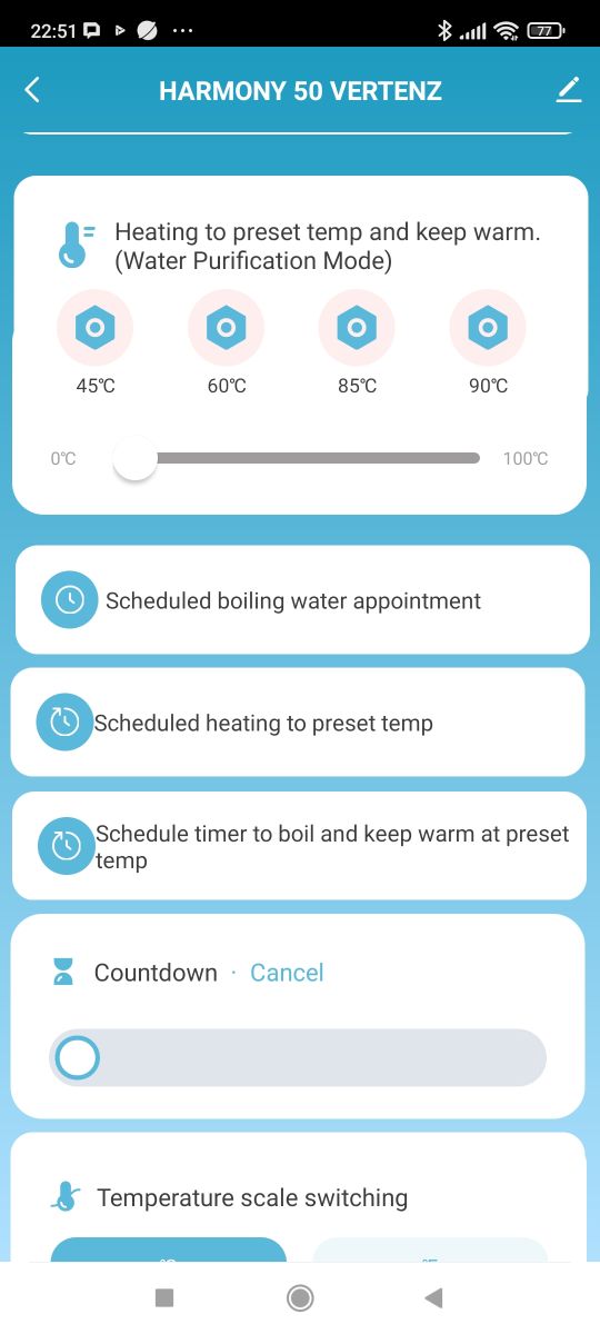

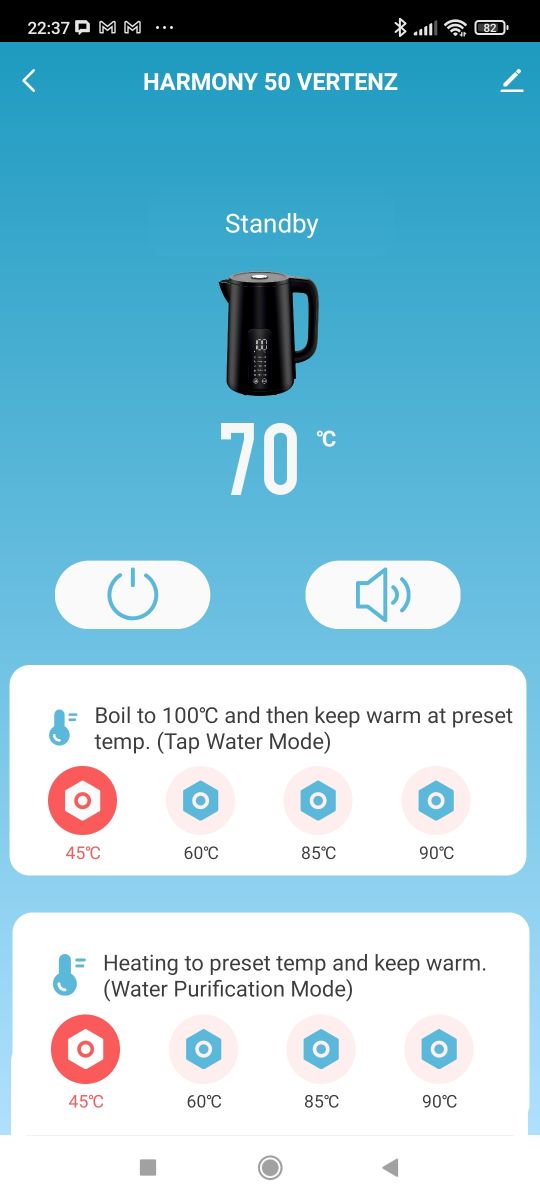

    The first thing that catches the eye is the two modes of operation - boiling water and heating. That's what all the supposed 'intelligence' (the 'smart' of the title) is here for. This kettle allows you to set the temperature and then it can also maintain it - for up to 12 hours. The second curiosity is the error codes - someone has made an effort and even in such a cheap product there is a basic fault diagnosis mechanism. We can find out whether the NTC circuit is open or perhaps shorted. There is also a warning about too little water! Convenient.

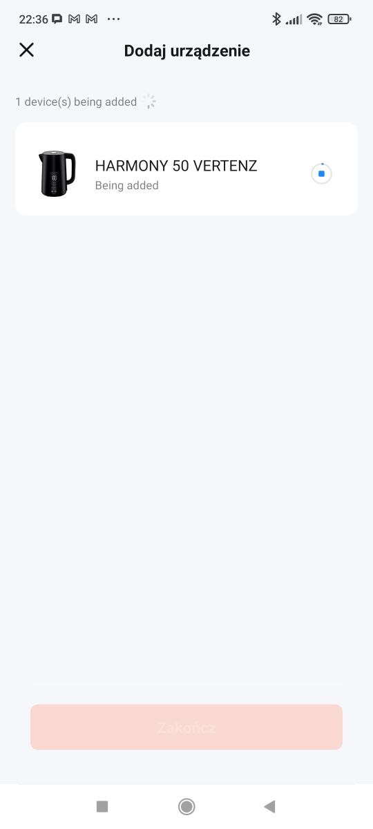

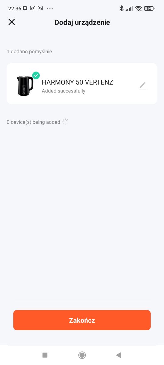

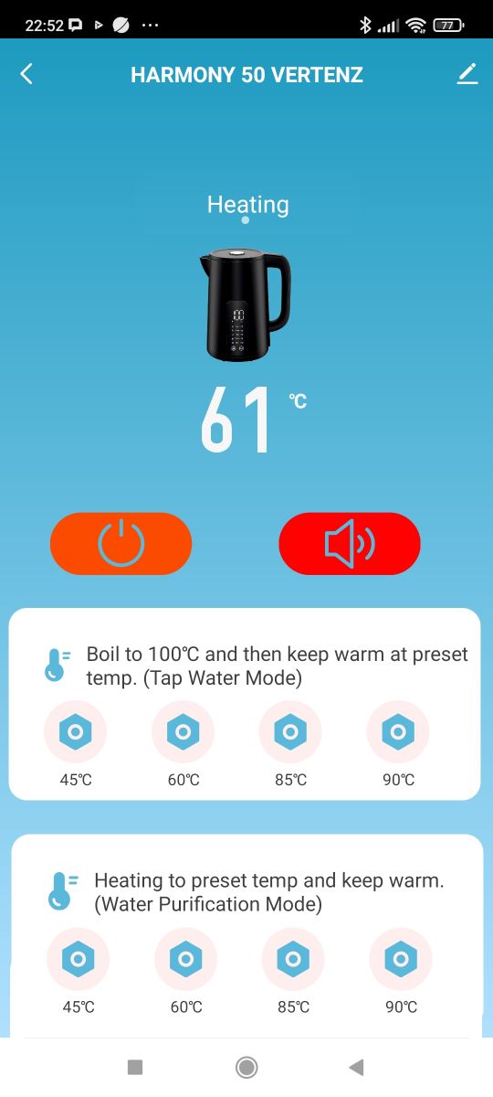

    Test with the Tuya app

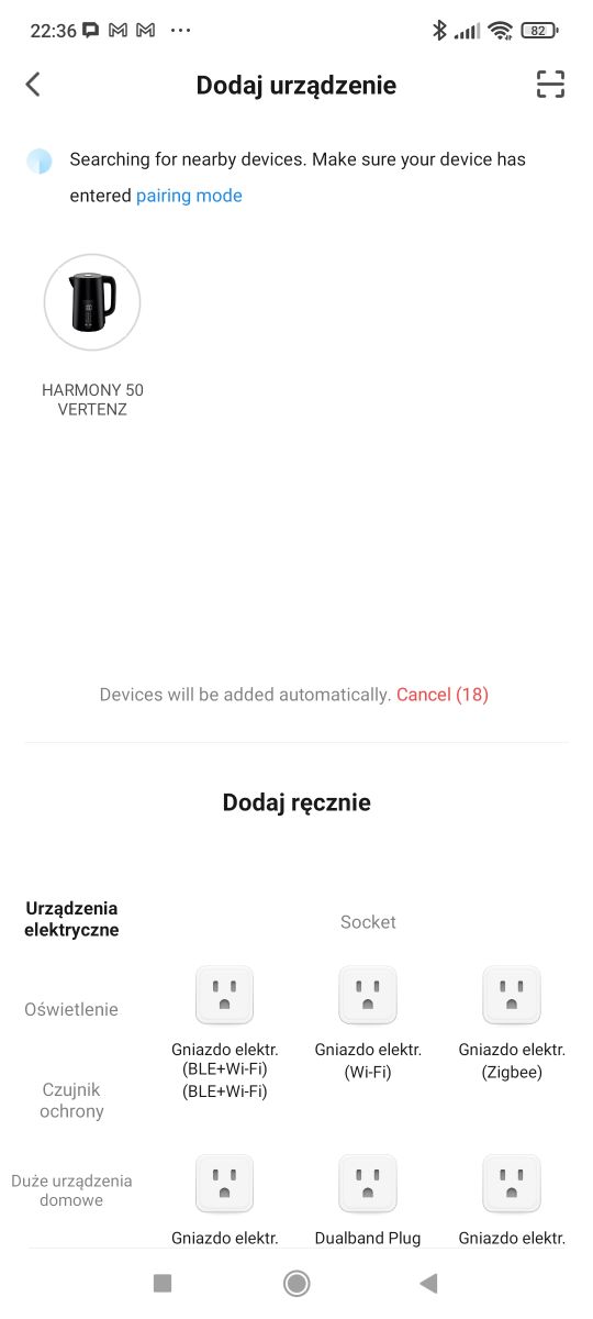

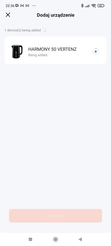

    We install the app, make sure we have 2.4 GHz Wi-Fi, turn on Bluetooth. We pair according to the instructions.
    Wi-Fi module in an electric kettle, what does it do? Interior and programming of Harmony 50 Wi-Fi module in an electric kettle, what does it do? Interior and programming of Harmony 50 Wi-Fi module in an electric kettle, what does it do? Interior and programming of Harmony 50

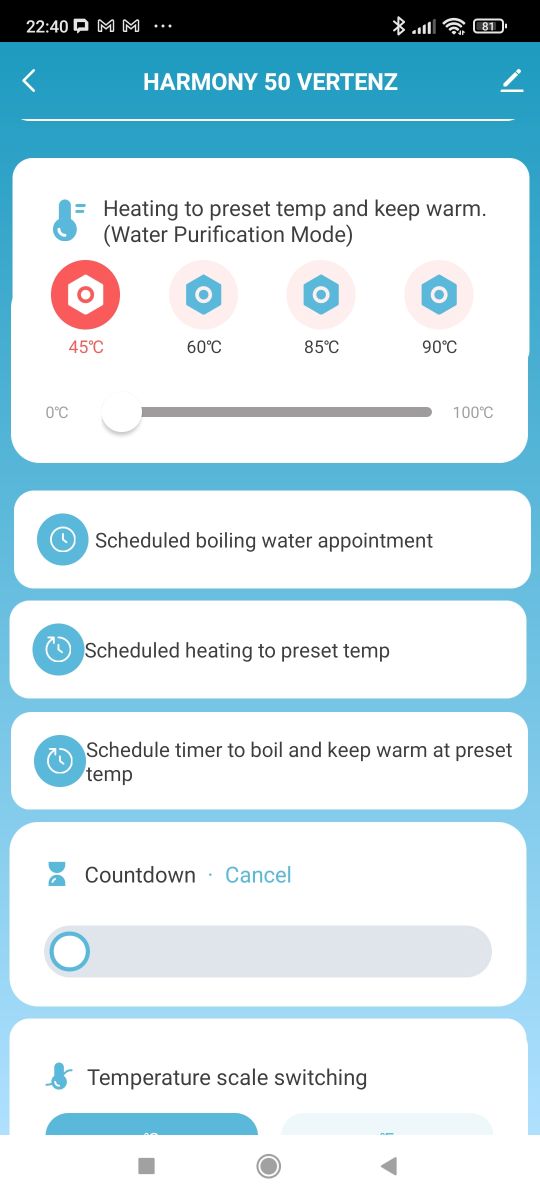

    In the menu, we have the two modes mentioned - either cooking and temperature maintenance or maintenance alone.
    We also have the option of scheduling a given action for a given time:

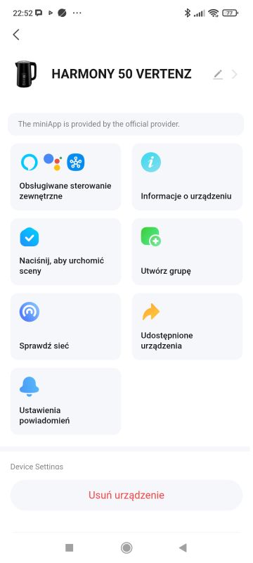

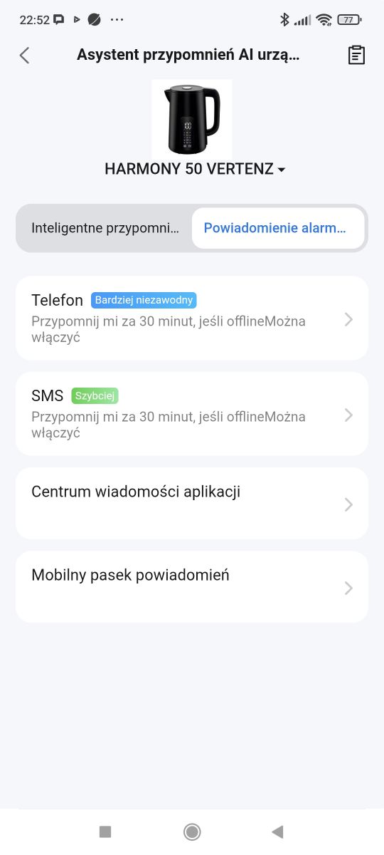

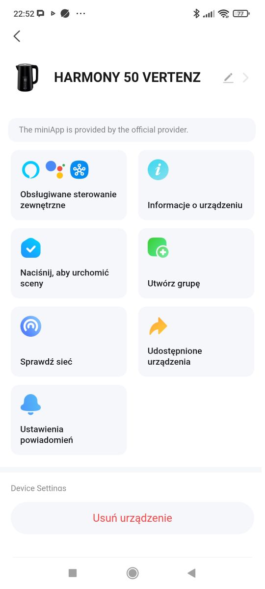

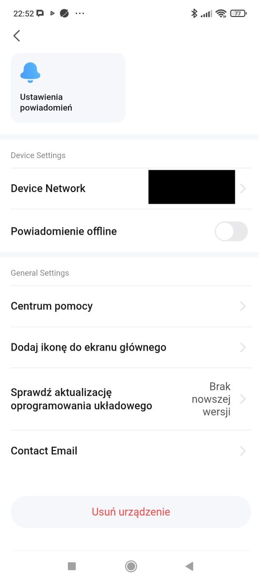

    Another interesting feature from the options is the possibility of notifications, including SMS:

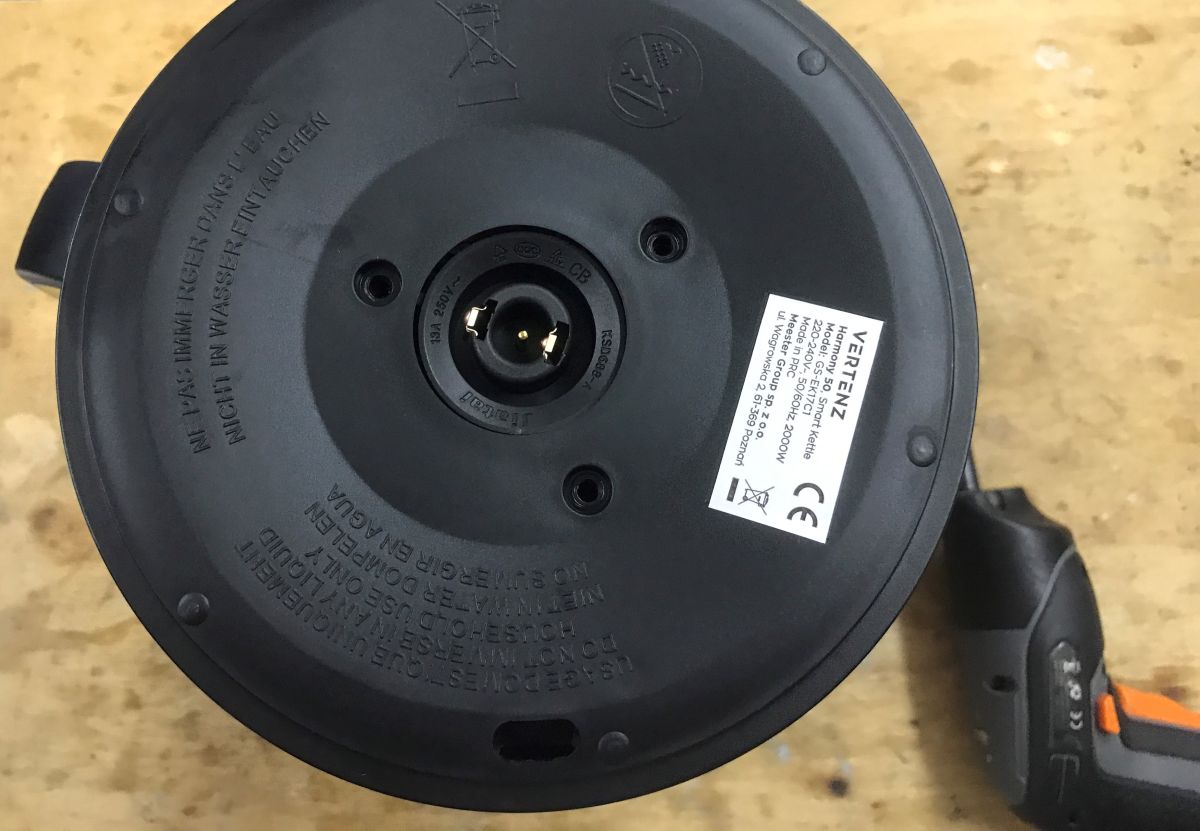

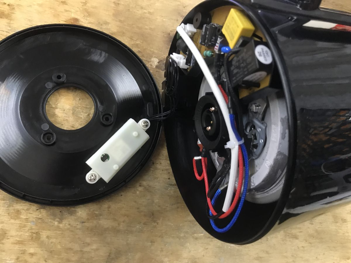

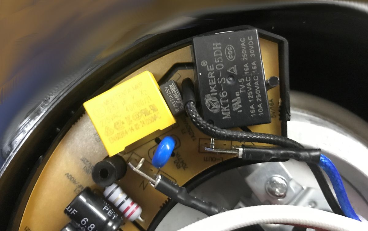

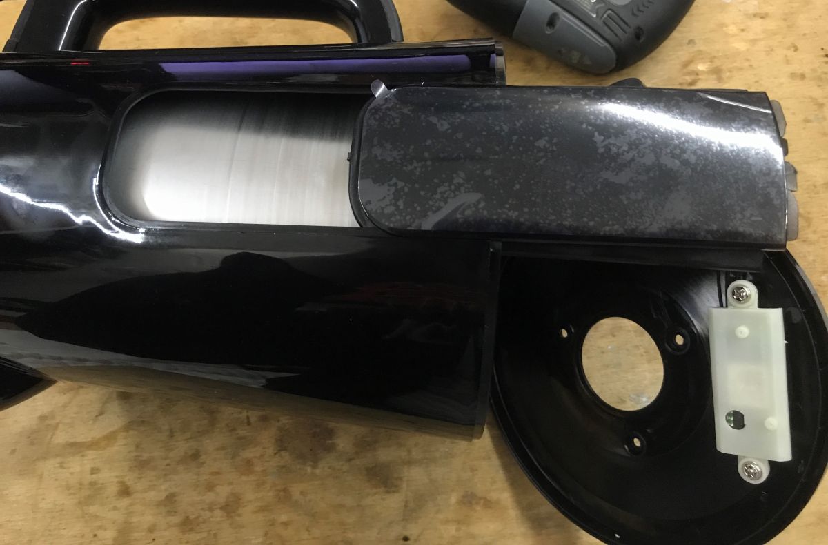

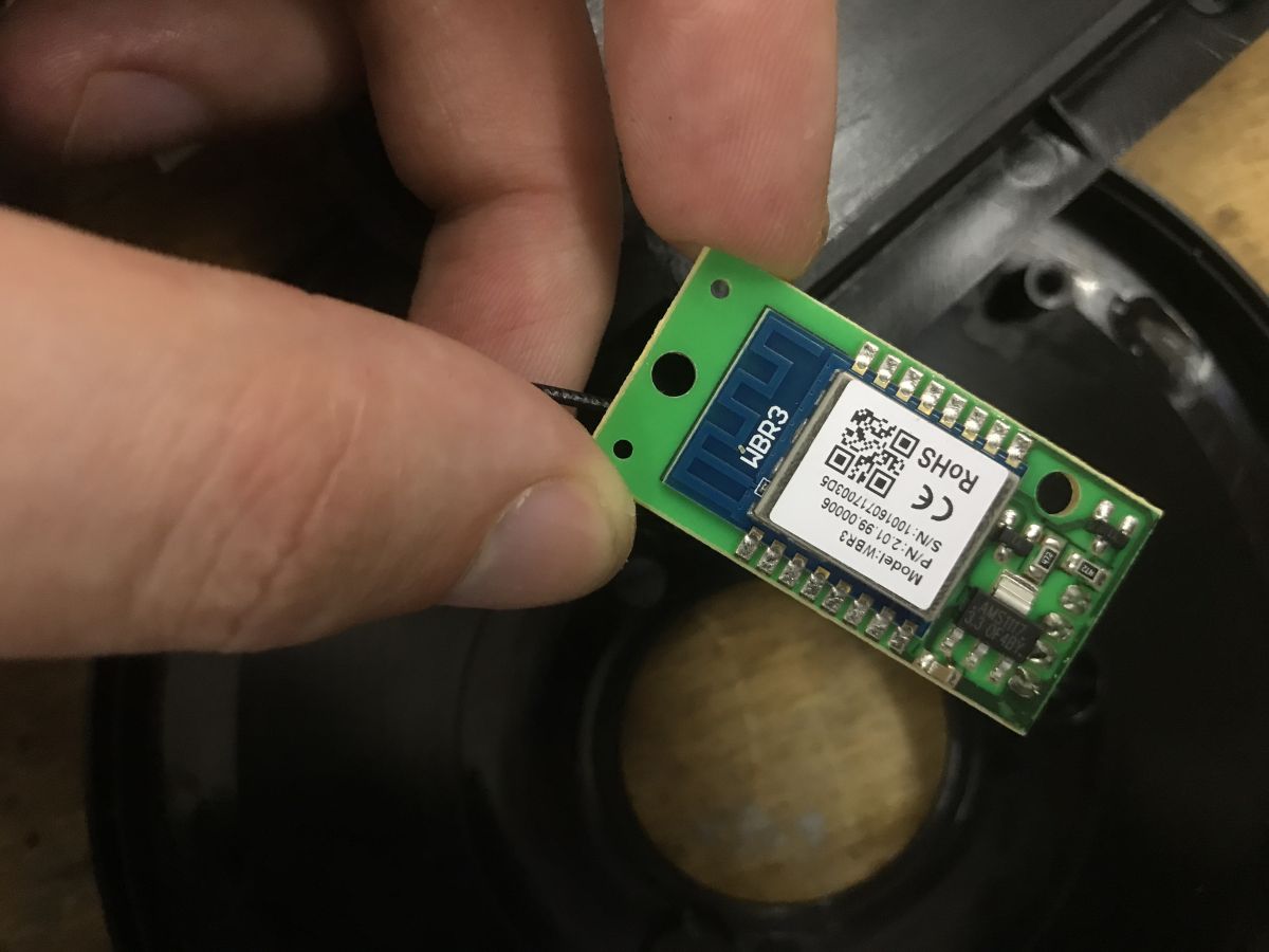

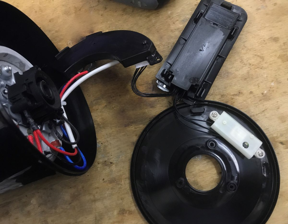

    Interior of the kettle

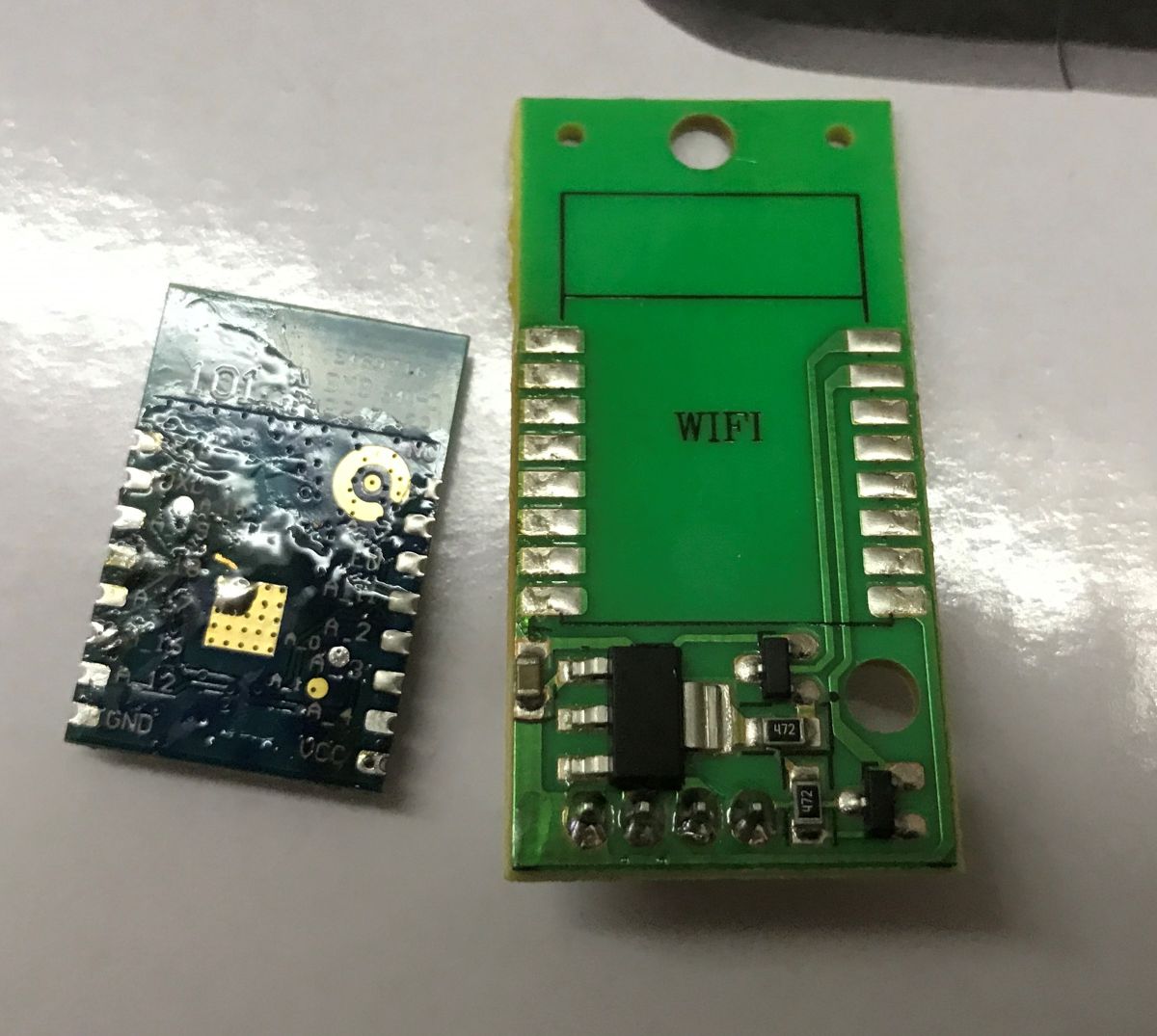

    Unlike the Svenson model shown earlier, here the Wi-Fi module is on the bottom, not in the handle. The screws are removed.

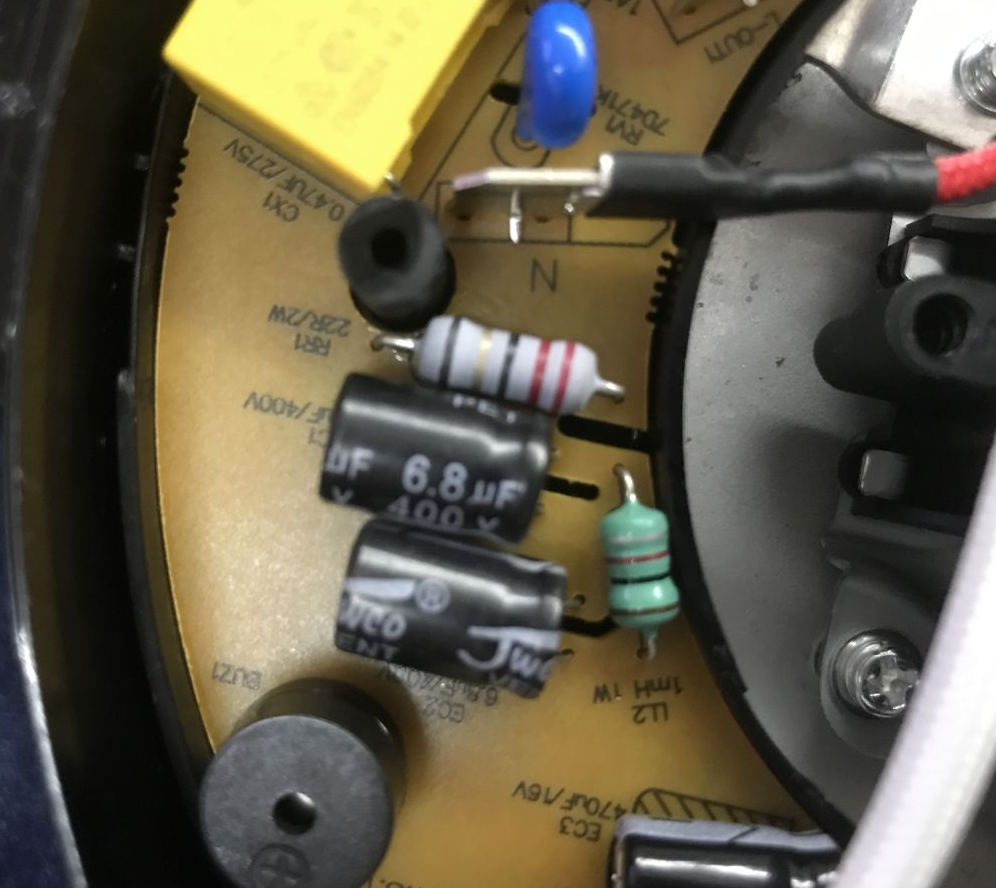

    The power supply appears to be uninsulated. There is also a buzzer on the PCB. The basic protection is there - I see a varistor.

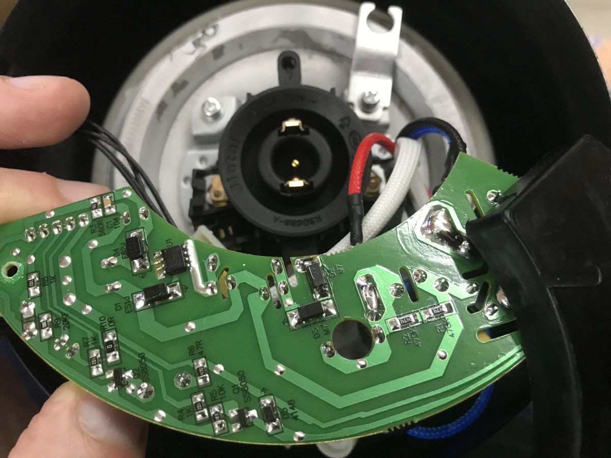

    PCB designation: GS-EK17C1 KH:2024.8.19
    Inside again is WBR3 - coincidence, or do they just make kettles based on Realtek?
    WBR3 discussion:
    WBR2, WBR3, WBRU, W701-VA2-CG pinout, datasheet, flashing for Home Assistant
    WBR3 is on the mother board with a 3.3V LDO and transistors, perhaps to change UART logic levels. This device is based on the TuyaMCU. The WBR3 controls the kettle via TX and RX lines.

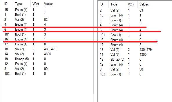

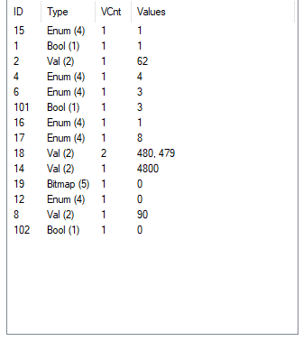

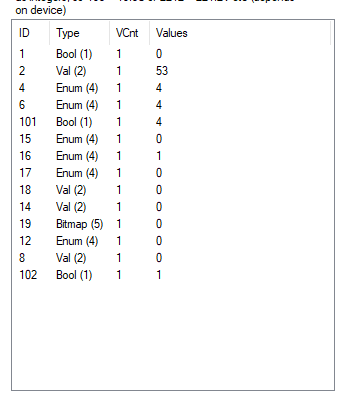

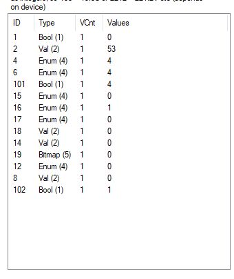

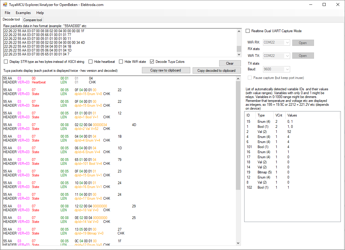

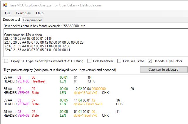

    Communication analysis

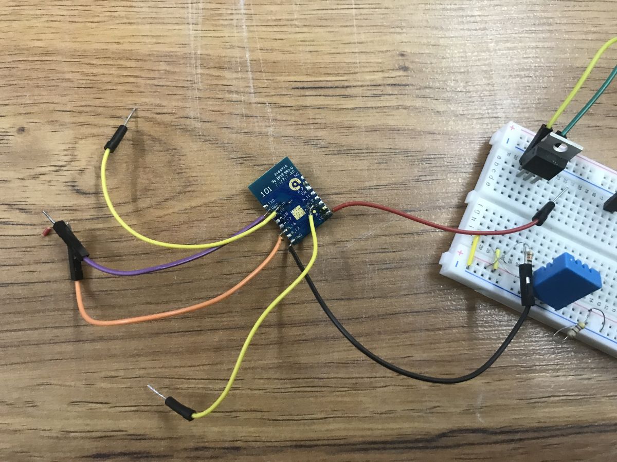

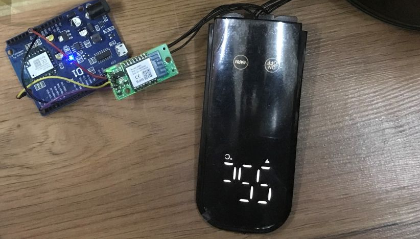

    According to the aforementioned documentation of the TuyaMCU , the protocol used inside is based on variables identified by so-called dpIDs, i.e. unique indices corresponding to individual functions. Here we have to guess which dpID is responsible for what. Intercepting the UART communication can help us with this. We simply need to plug in with an additional device first on the RXmcu->TXwifi line and then TXmcu->RXwifi.
    I used a Wemos conversion on the CB3S as a 'listener'. I fired up a UART to TCP bridge driver on it so I could remotely view the packets. This is important, because many products like this kettle may have non-isolated inverters and network potential present on the MCU circuit. You can't connect them directly to the computer via the UART port, you could short circuit them.
    The analysis of such communication is that I start a record, perform some specific action in the application or on the product buttons, and then stop that record. I analyse the packets collected in this way in terms of which variable might relate to the action being taken, for example in which dpID is the target temperature, in which the current temperature, and so on.
    I use a program to do this:
    TuyaMCU analyser - UART packet decoder for Tuya devices - dpID detector
    Switching on with the On/Off button on the touch panel:

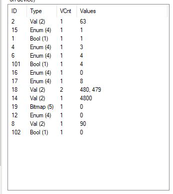

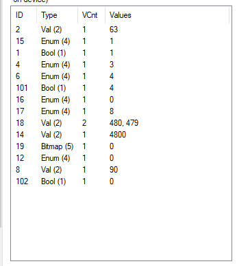

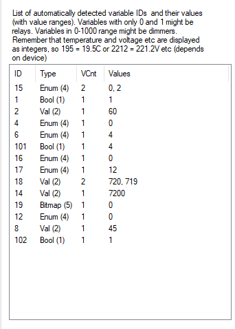

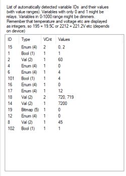

    Conclusion: dpID 1 of type bool is probably the on/off state. Additionally 53 looks like the current temperature.
    Warm pressed once - 45 appears on the display:
    22:30:28 55 AA 03 07 00 05 0F 04 00 01 00 22
    22:30:30 55 AA 03 07 00 05 01 01 00 01 01 12
    22:30:31 55 AA 03 07 00 08 02 02 00 04 00 00 00 3C 55
    22:30:31 55 AA 03 07 00 05 04 04 00 01 00 17
    22:30:31 55 AA 03 07 00 05 06 04 00 01 04 1D 55 AA 03 07 00 05 65 01 00 01 04 79
    22:30:31 55 AA 03 07 00 05 0F 04 00 01 02 24 55 AA 03 07 00 05 10 04 00 01 00 23
    22:30:31 55 AA 03 07 00 05 11 04 00 01 0C 30 55 AA 03 07 00 08 12 02 00 04 00 00 02 D0 FB
    22:30:32 55 AA 03 07 00 08 0E 02 00 04 00 00 1C 20 61 55 AA 03 07 00 05 13 05 00 01 00 27
    22:30:32 55 AA 03 07 00 05 0C 04 00 01 00 1F 55 AA 03 07 00 08 08 02 00 04 00 00 00 2D 4C
    22:30:32 55 AA 03 07 00 05 66 01 00 01 01 77
    22:30:32 55 AA 03 07 00 08 12 02 00 04 00 00 02 CF FA 55 AA 03 07 00 08 0E 02 00 04 00 00 1C 20 61
    22:30:33 55 AA 03 00 00 01 01 04
    the dpID 8 set to 45 is the target temperature. In addition, the enumerator dpID 15 looks like a mode. and dpID 14 and 18 look like some kind of time.

    This confirms the previous findings.

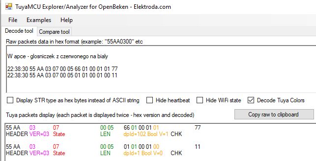

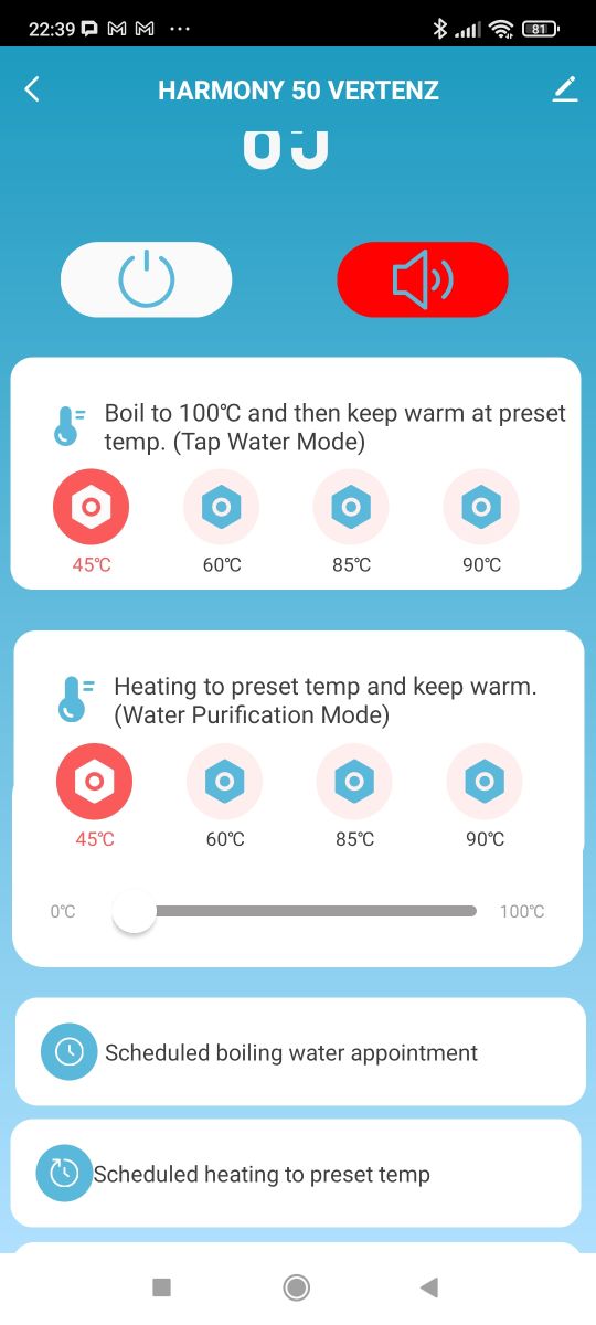

    Operation in app - speaker from red to white:
    22:38:30 55 AA 03 07 00 05 66 01 00 01 01 77
    22:38:30 55 AA 03 07 00 05 01 01 00 01 00 11
    dpID 1 we already know is the power on/off state, so dpID 102 is sound - the value true is off.
    From white to red:
    22:39:26 55 AA 03 07 00 05 66 01 00 01 00 76
    22:39:26 55 AA 03 07 00 05 01 01 00 01 00 11
    Off, i.e. change to false.

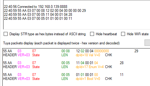

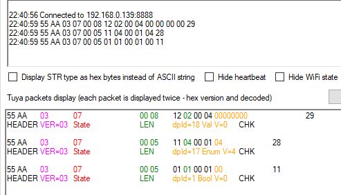

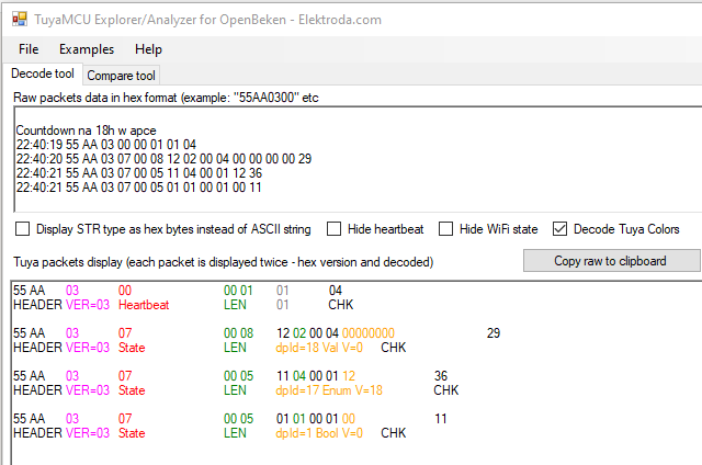

    Countdown to 18h in app:
    22:40:19 55 AA 03 00 00 01 01 04
    22:40:20 55 AA 03 07 00 08 12 02 00 04 00 00 00 00 29
    22:40:21 55 AA 03 07 00 05 11 04 00 01 12 36
    22:40:21 55 AA 03 07 00 05 01 01 00 01 00 11

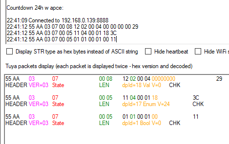

    This indicates that dpID 17, although of enumerator type, contains the number of countdown hours:
    Same - for 4h:
    24h:

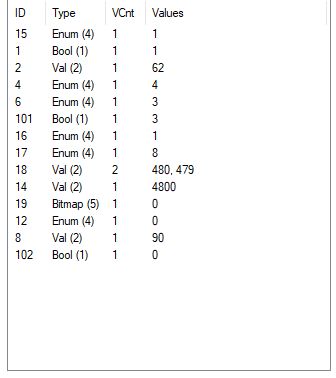

    Operation "Boil to 100 and keep warm at 90":
    22:41:56 55 AA 03 00 00 01 01 04
    22:41:59 55 AA 03 07 00 05 0F 04 00 01 01 23
    HEADER	VER=03	State		LEN	dpId=15 Enum V=1	CHK
    22:42:00 55 AA 03 07 00 05 01 01 00 01 01 12
    22:42:00 55 AA 03 07 00 08 02 02 00 04 00 00 00 3E 57
    22:42:00 55 AA 03 07 00 05 04 04 00 01 04 1B
    22:42:00 55 AA 03 07 00 05 06 04 00 01 03 1C
    22:42:00 55 AA 03 07 00 05 65 01 00 01 03 78
    22:42:00 55 AA 03 07 00 05 10 04 00 01 01 24
    22:42:00 55 AA 03 07 00 05 11 04 00 01 08 2C
    22:42:00 55 AA 03 07 00 08 12 02 00 04 00 00 01 E0 0A
    22:42:00 55 AA 03 07 00 08 0E 02 00 04 00 00 12 C0 F7
    22:42:00 55 AA 03 07 00 05 13 05 00 01 00 27
    22:42:01 55 AA 03 07 00 05 0C 04 00 01 00 1F
    22:42:01 55 AA 03 07 00 08 08 02 00 04 00 00 00 5A 79
    22:42:01 55 AA 03 07 00 05 66 01 00 01 00 76
    22:42:01 55 AA 03 07 00 08 12 02 00 04 00 00 01 DF 09
    22:42:01 55 AA 03 07 00 08 0E 02 00 04 00 00 12 C0 F7
    dpID 8 is the target temperature:
    Operation "Heating to present temp and keep warm 90":
    22:42:23 Connected to 192.168.0.139:8888
    22:42:24 55 AA 03 07 00 08 02 02 00 04 00 00 00 3F 58
    22:42:24 55 AA 03 07 00 05 0F 04 00 01 01 23
    22:42:24 55 AA 03 07 00 05 01 01 00 01 01 12
    22:42:24 55 AA 03 07 00 05 04 04 00 01 03 1A
    22:42:24 55 AA 03 07 00 05 06 04 00 01 04 1D
    22:42:24 55 AA 03 07 00 05 65 01 00 01 04 79
    22:42:24 55 AA 03 07 00 05 10 04 00 01 00 23
    22:42:25 55 AA 03 07 00 05 11 04 00 01 08 2C
    22:42:25 55 AA 03 07 00 08 12 02 00 04 00 00 01 E0 0A
    22:42:25 55 AA 03 07 00 08 0E 02 00 04 00 00 12 C0 F7
    22:42:25 55 AA 03 07 00 05 13 05 00 01 00 27
    22:42:25 55 AA 03 07 00 05 0C 04 00 01 00 1F
    22:42:25 55 AA 03 07 00 08 08 02 00 04 00 00 00 5A 79
    22:42:25 55 AA 03 07 00 05 66 01 00 01 00 76
    22:42:25 55 AA 03 07 00 05 0F 04 00 01 01 23
    22:42:25 55 AA 03 07 00 08 12 02 00 04 00 00 01 DF 09
    You can now compare the values and assess which variables determine whether you are heating to 100 or just maintaining the temperature:
    OpenBeken upload and configuration
    The WBR3 has programming pads on the bottom, so it needs to be soldered out:
    Program according to the tutorial:
    My layout:

    TuyaMCU flashing, installation and configuration guide - configure dpID for Home Assistant
    Here I have taken the liberty of simplifying the work a little. I only prepared a control for classic heating, up to a set temperature of 100 degrees. It turned out to be enough to map three dpIDs in autoexec.bat with OBK:
    startDriver TuyaMCU
    tuyaMcu_defWiFiState 4
    setChannelType 1 Toggle
    setChannelType 2 Temperature
    setChannelLabel 2 "Current Temperature"
    setChannelType 8 TextField
    setChannelLabel 8 "Target Temperature"
    linkTuyaMCUOutputToChannel 8 val 8
    Here's a picture of the menu - forgive this form, I was testing on short notice and didn't save a screenshot normally:
    That's basically it... the only thing I would add is that after entering and changing the target temperature value, the kettle starts itself. There is no need to separately set the boolean dpID 1 to true, it changes this state itself, although we can use it to turn the kettle off.
    Now you can run Home Assistant Discovery and pair like a pre-programmed device with the HA.

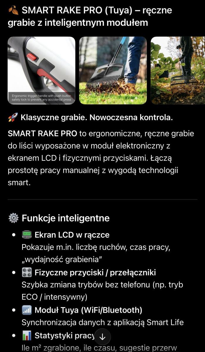

    All in all, you can already buy a rake from tuya ;)
    Screenshot about “SMART RAKE PRO (Tuya)” with rake photos and a bullet list of smart features.

  • The internal board is marked GS-EK17C1 KH:2024.8.19 and carries a WBR3 module, a 3.3 V LDO, transistors, a buzzer, and a varistor. [#21889268]
  • The author flags the power supply as uninsulated, which makes direct UART-to-PC probing unsafe on a live kettle and raises real electrical-risk concerns during analysis. [#21889268]

How do you pair the Harmony 50 kettle with the Tuya app, and why does it require 2.4 GHz Wi-Fi and Bluetooth?
You pair it through the Tuya app using 2.4 GHz Wi‑Fi with Bluetooth turned on. 1. Install the app. 2. Confirm your phone is on a 2.4 GHz network and enable Bluetooth. 3. Start pairing exactly as shown in the kettle instructions. The thread states those two radio settings are required for the pairing process; it does not describe a 5 GHz path. [#21889268]
Which functions are available in the Tuya app for this kettle, such as boiling, temperature hold, scheduling, and notifications?
The app offers boiling, keep-warm, hold-only heating, timed scheduling, and notifications. It shows two main operating modes, lets you set a specific temperature, schedules a chosen action for a chosen time, and even exposes notification options including SMS alerts. [#21889268]
What is the difference between the two operating modes in the Harmony 50 kettle: boiling to 100°C with keep-warm versus heating/maintaining a selected temperature?
One mode first boils to 100°C, then holds the chosen temperature, while the other only heats or maintains to the selected setpoint. The author describes the menu as emphasizing exactly those two paths: full boil plus hold, or maintenance alone at values such as 45°C, 60°C, 85°C, or 90°C. [#21889268]
How long can the Harmony 50 kettle maintain water temperature, and how is that configured from the app or touch panel?
It can maintain temperature for up to 12 hours. You configure the target temperature from the app or by pressing the Warm touch control through preset values, and the app also shows countdown-style settings such as 4 hours, 18 hours, and 24 hours for timed actions. [#21889268]

What is the TuyaMCU protocol, and how do dpIDs map kettle functions like power, current temperature, target temperature, mode, timer, and sound?
"TuyaMCU is a serial control protocol that links a main appliance MCU with a Wi‑Fi module, using numbered dpIDs to represent functions such as switches, values, enums, and timers." In this kettle, the author intercepted UART traffic and matched dpIDs to features like power, current temperature, target temperature, operating mode, countdown hours, and buzzer state. [#21889268]
How do you safely sniff UART communication in a mains-powered kettle without risking a short circuit from a non-isolated power supply?
You avoid connecting the live kettle directly to a computer UART. 1. Tap the MCU-to-Wi‑Fi RX/TX lines with a separate listener device. 2. Use that listener as a UART-to-TCP bridge. 3. Capture packets remotely. The author chose this method because products like this may expose mains potential on the control circuit through a non-isolated supply. [#21889268]
Which dpIDs were identified in the Harmony 50 kettle for on/off state, current temperature, target temperature, mode selection, countdown hours, and buzzer control?
The mapped datapoints are clear enough for practical control: dpID 1 is on/off, dpID 2 is current temperature, dpID 8 is target temperature, dpID 15 is operating mode, dpID 17 carries countdown hours, and dpID 102 controls sound. The thread also shows dpID 102 set true as sound off, and false as sound on. [#21889268]
