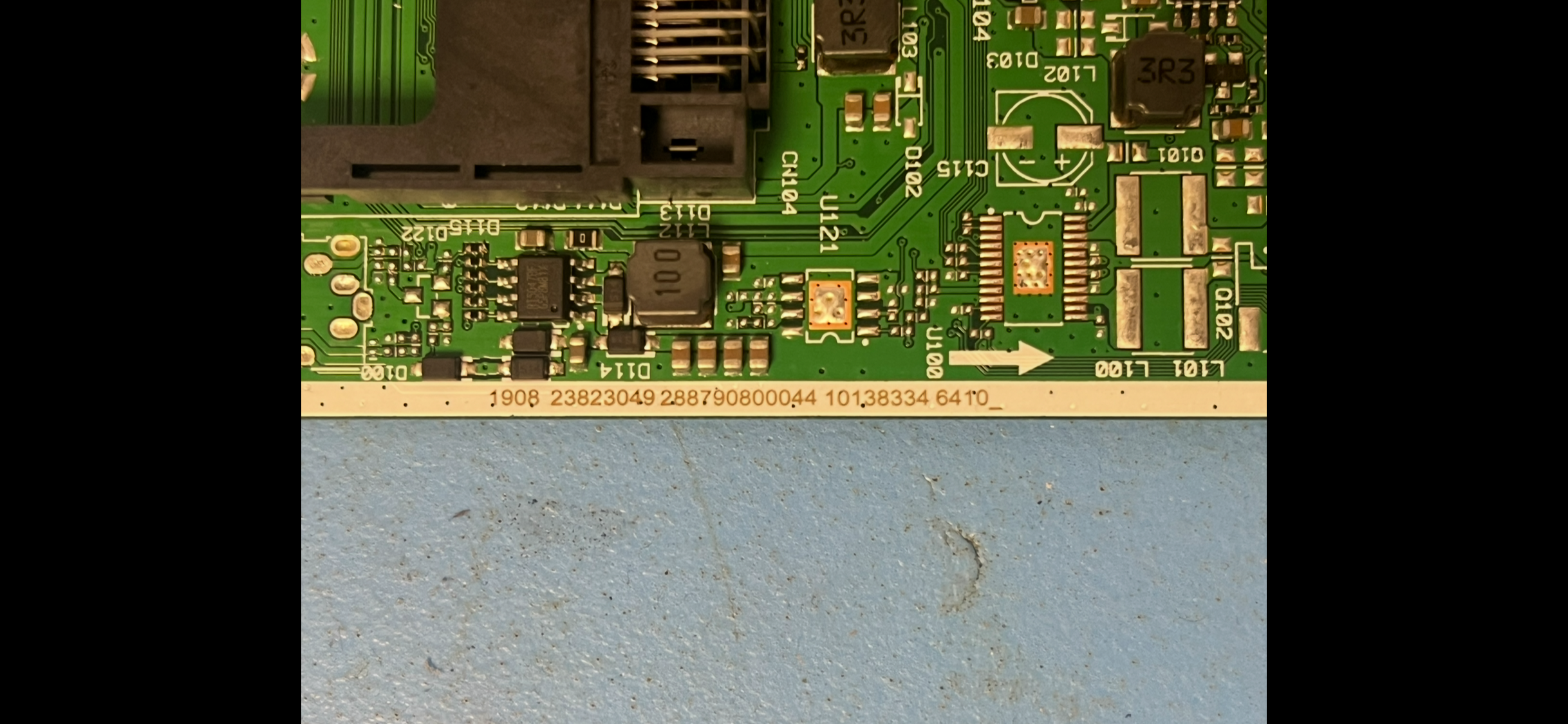

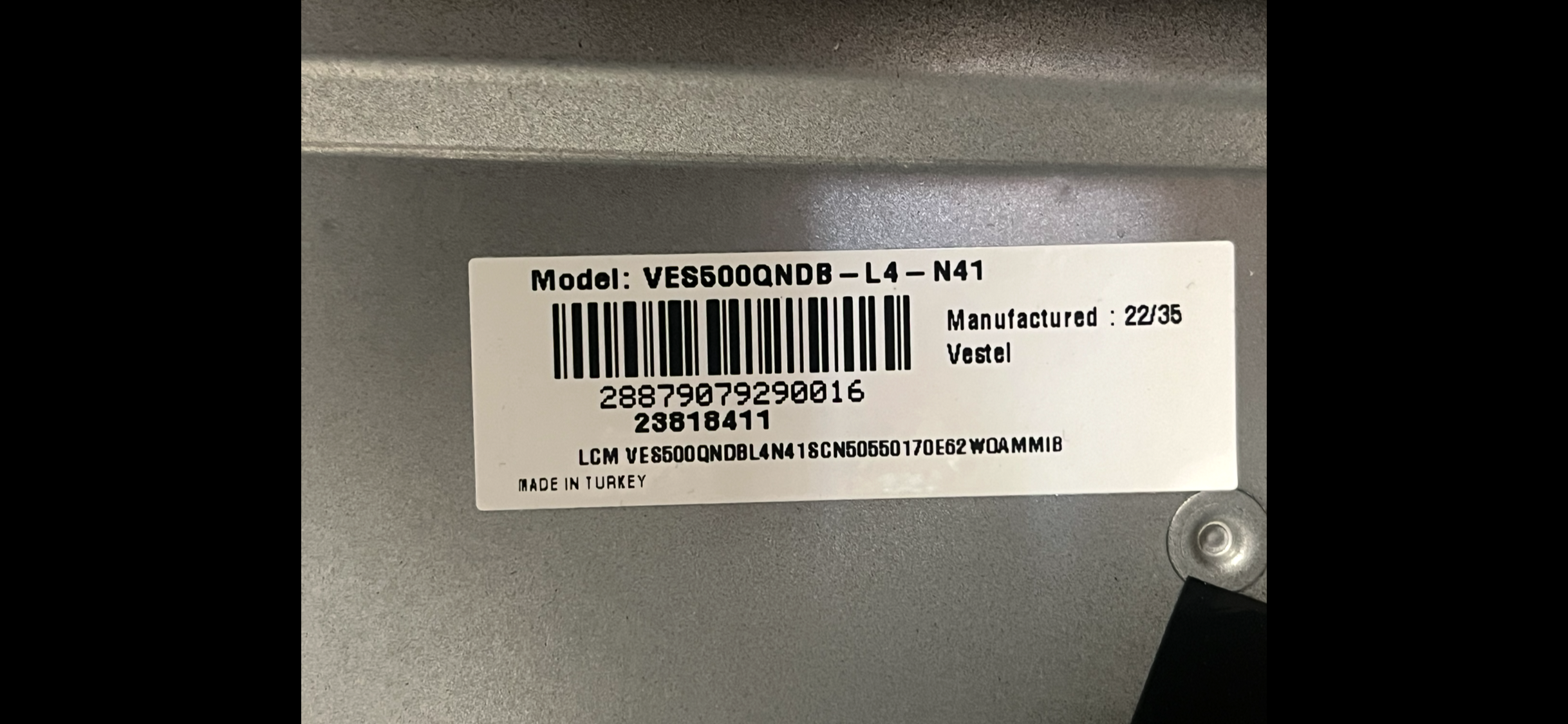

Can you post the exact software/loader/version info from the service menu or boot log, plus any sticker/barcode numbers from the 17MB180E board? For Vestel, board number panel alone is often not enough to match the correct firmware image.
I did add pictures of the barcode & numbers to the post.
