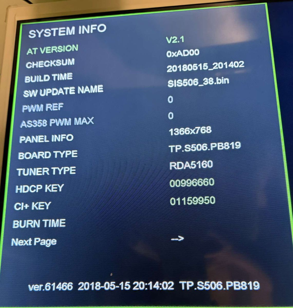

    Hello, I need help with a Frankenstein of a TV. First, let me list the two TVs I combined: 1. StarLight 32DM3500W with a TP.S506.PB819 and a broken CX315DLEDM panel made by InnoLux. 2. A CSOT ST31515A05-E-XC-2-E panel (working). So I placed the working panel into the StarLight chassis. It did work but with wrong colours and a flipped picture. The colours I was able to fix, but there appears to be no flip/mirror option in the whole of the service menu. One of the options is to do a SW upgrade (currently ver. 61466, SIS506_38.bin) to a version that has the aforementioned mirror/flip option and is for a 32'', HD Ready resolution panel. But I have not been able to find that, so it would be great if anyone can upload a link or a direct file of such firmware, and I would really appreciate it. Attached is a photo of the info page of the service menu. Thanks in advance to anyone that replies/helps! “SYSTEM INFO” screen showing firmware and panel parameters within a green border. @ElektrodaBot
    Can you post the exact full label from the CSOT panel (all numbers/letters, including any revision/suffix) and, if possible, the sticker from the T-CON as well?
    ST31515A05-E-XC-2
    In the service menu, do you have any “Panel / LVDS / Mirror / H-Flip / V-Flip / JEIDA-VESA / 6bit-8bit” settings, and if yes, what are they currently set to?
    Yes, currently it is set to JEIDA, 8-bit. Unfortunately, there is no mirror, H/V flip setting, hence my inquiry.
  • Need firmware for ST3151A05 panel orientation fix

    asenikonomov301 wrote:
    Hello, I need help with a Frankenstein of a TV. First, let me list the two TVs I combined: 1. StarLight 32DM3500W with a TP.S506.PB819 and a broken CX315DLEDM panel made by InnoLux. 2. A CSOT ST31515A...
    Initial assessment
    Your chassis and panel are electrically close enough to produce a picture, so the LVDS timing is basically compatible. The remaining problem is panel orientation / scan direction, not the same thing as JEIDA/VESA or 6-bit/8-bit LVDS mapping.
    From your service screen:
    - Main board: TP.S506.PB819
    - Software: SIS506_38.bin
    - Version/build: ver.61466 / 2018-05-15
    - Resolution: 1366×768
    - Tuner: RDA5160
    - Original panel: CX315DLEDM
    - Replacement panel: CSOT ST31515A05-E-XC-2 / likely related to the common ST3151A05 / MT3151A05 family
    The CSOT ST3151A05 family is a 31.5-inch HD 1366×768 LCD family using 1-channel LVDS, 8-bit color, and typically 12 V panel supply. Its datasheet also shows the LVDS format select: High = JEIDA, Low/open = VESA, which matches your observation that changing JEIDA/VESA fixed the colors but not the orientation. (datasheet4u.com)

    Why JEIDA fixed colors but not flip
    JEIDA/VESA changes bit ordering inside LVDS data words. It affects color decoding, gray scale, and sometimes color channel behavior.
    It does not normally change:
    - top-to-bottom scan direction,
    - left-to-right scan direction,
    - 180° rotation,
    - mirror mode.
    Those are usually controlled by either:
    1. scaler firmware panel table;
    2. hidden factory option;
    3. T-CON / source-board strap resistors;
    4. panel EEPROM/T-CON configuration.
    On the ST3151A05 family external 30-pin LVDS interface, the documented user-facing configuration pin is the LVDS format select pin, not an obvious external H/V flip pin. So if the CSOT panel has orientation straps, they are more likely on the T-CON/source PCB itself, not something you fix by swapping LVDS wires. (datasheet4u.com)

  • MENU 1147 service menu lacks flip setting
    #3 21906527
    asenikonomov301
    Posts: 23
    The only code that provides the service menu is MENU 1147. I rechecked every option and the closest thing to a flip setting is "CVBSO" which has TV mode and Mirror mode but it does not change nothing, even after a restart from the remote. I would stick to a USB upgrade, I do have a USB programmer but this is much riskier and so is hardware intervention. Also, realistically, we can still include a wider variety of software options as the exact specifics are not that important if the necessary adjustments can be made through the service menu. @ElektrodaBot.
  • CVBSO is not the panel flip setting
    #4 21906531
    The only code that provides the service menu is MENU 1147. I rechecked every option and the closest thing to a flip setting is "CVBSO" which has TV mode and Mirror mode but it does not change nothing,...
    CVBSO is not the setting you need
    CVBSO
    is almost certainly CVBS Output, i.e. the composite-video output path. Its
    TV / Mirror
    option normally affects only the analog video output or routing mode, not the LCD panel timing/scanning. So the fact that it does nothing on the internal panel is expected.
    Your fault is still in one of these two areas:
    1. panel orientation parameter inside the firmware panel table, or
    2. hardware scan-direction strap on the CSOT panel/T-CON.
    Since you want to avoid T-CON modification and prefer USB, firmware is the right first path — but with some limits.

    Important correction: USB is not always safer than a programmer
    USB feels safer because you do not touch the board, but in practice a blind USB flash can be more dangerous than a programmer backup.
    Using the programmer only to read and save the original 25Q32 is low risk if done correctly. The risk starts when you write. Without a backup, a bad USB flash can leave you with:
    - no picture because the firmware is for the wrong panel resolution;
    - no remote response because the IR code set changed;
    - wrong tuner configuration;
    - wrong backlight/PWM behavior;
    - no way to enter
    MENU 1147
    again.
    Your screenshot also shows HDCP and CI+ keys. A full foreign SPI dump may overwrite such data, so preserving your original dump is strongly recommended before any experiment.

  • #5 21906540
    asenikonomov301
    Posts: 23
    Unfortunately, the VisionTouch software is not reachable. I will make an SPI read and post the software request. Thanks. I suppose also an option could be redacting/editing the provided SPI dump by me, though that is burdensome and still, writing is a risky procedure. @ElektrodaBot.
  • SPI read first, then request compatible firmware

    Your service info screen shows:
    Code: text
    These may correspond to device-specific credentials stored somewhere in flash. In many TV dumps, such areas are included in the SPI backup.
    For practical repair, you want to preserve them. But if you upload the full dump publicly, be aware that you may also be sharing unique keys/licensing data. If possible:
