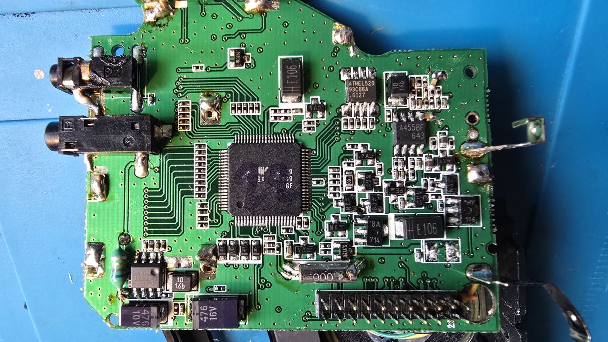

    Hi I have a Midland Alan 42 multi, but there's no sound output, I can hear the beeps when a key is pressed. The squelch seems to work as the radio scans and stop on signals, all seems like it's working but no sound output. Does anyone know if this is a common fault or if I'm doing something wrong, also no sound from the headphone jack either, seems to key up OK too, just looking at the screen.
    Have you tried it with the volume right up and the squelch fully open on a channel you know has traffic, and do you hear any hiss/noise at all apart from the key beeps?
    Yes, only hear keypad beeps when pressed, nothing else.
    Has this just started, and has the radio had any knocks, water damage, repairs, or been tried on both batteries and external power?
    Like this when I bought it.

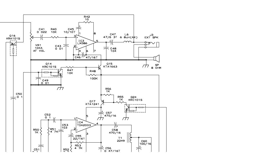

    Transistor, what feeds the LM386 - Q15, to be checked.
  • Beep from Samsung IC pin 32, no FM/AM output

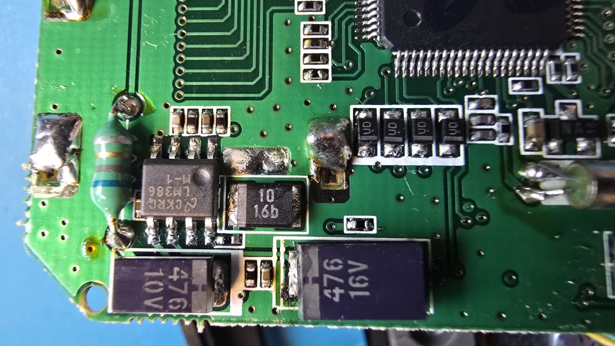

    Transistor Q15 seems to test OK in circuit, not short. Can't see anything obvious? Looking on the schematics am I right in thinking the beep noise is coming from the Samsung ic pin 32? This works, But I get no FM/AM Radio output, is this generated from the TK10931 ic?

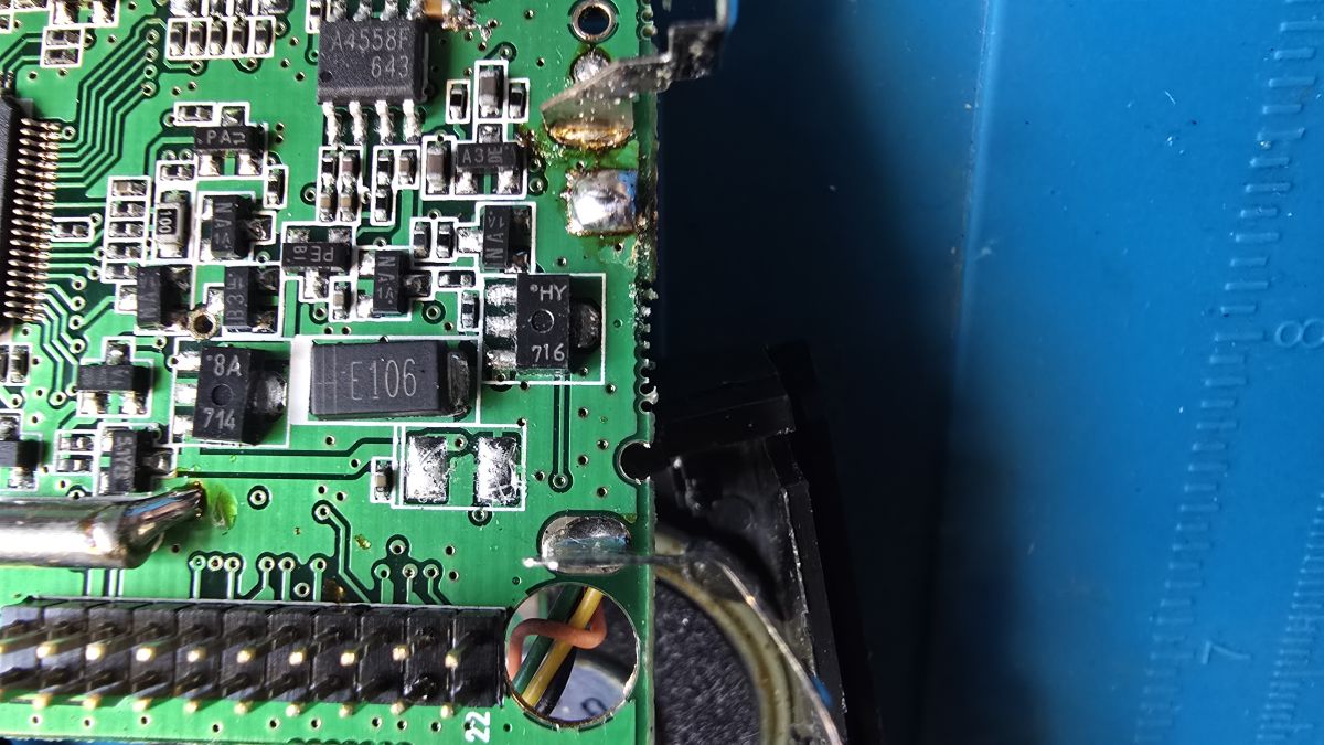

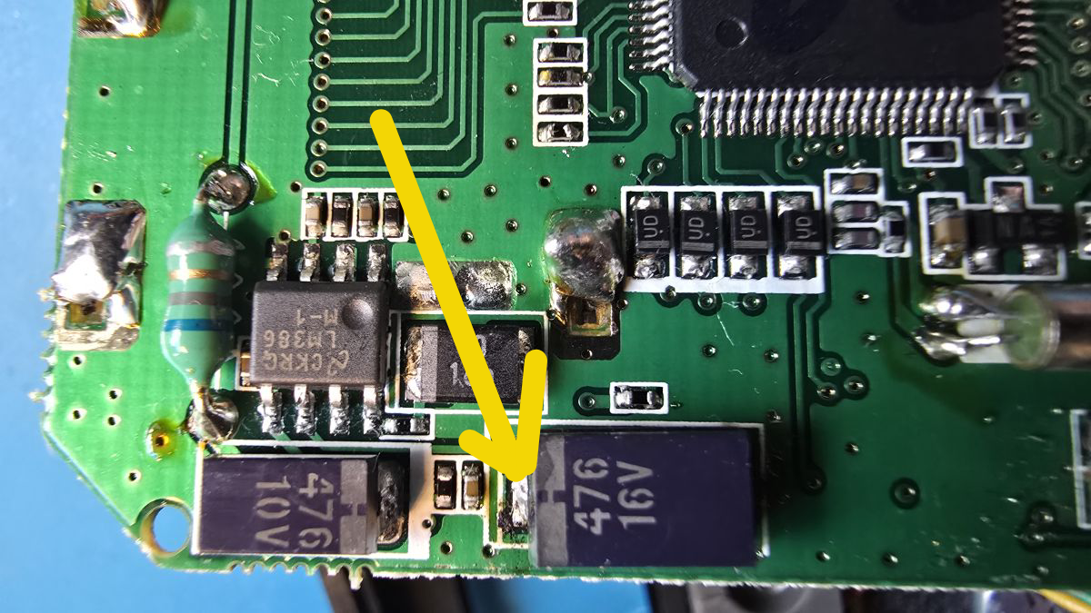

    it "appears "not to have a short circuit.... if you don't know how to check it, solder a wire to the LM386 power supply and see if it gives voltage when the squelch is open. Squelch engaged - no voltage, squelch to max left - there is voltage.
    Added after 29 [minutes]:
    Solder a wire here, assemble the radio and check the voltage as above.
    Close-up of a PCB with SMD parts; yellow arrow points to a solder point near a 470 µF capacitor
  • Lifted LM386 pin 6 restores 12 V supply

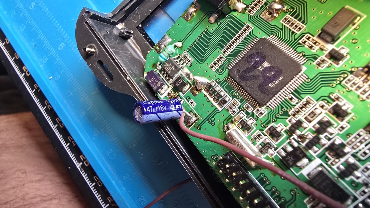

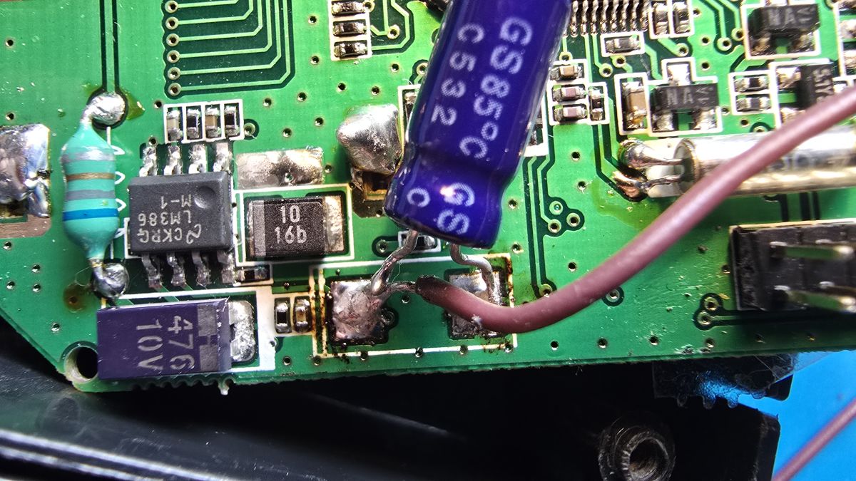

    Just tested, there seems to be no voltage on this cap, or back to Q15 transistor collector, tried the squelch, in both directions, no voltage showing. (edit. I removed the cap and now showing max 2.1 V, replaced cap with conventional 47 uF cap, still showing 2.1 V max) Am I right in thinking that the emitter of Q15 should have 12 V VCC on it? (edit. I have 12 V on emitter), also Q15 on my board has the markings of *HY 716. I presume this is SMD code? But on the schematic it shows it as KTA 1663. Still no audio output. Is this capacitor 476 faulty? Should these SMD caps read the same as conventional caps on a multimeter, as this one is reading a steady 300 ohms out of circuit in both directions, partial short? Maybe? What should the voltage be on this cap/LM386 VCC? 2.1 V seems a bit low?
    (edit. Ok, just lifted pin 6 of LM386 and voltage comes up to max 12 V. Does this confirm faulty cap and LM386 device?_

    So just as I suspected. You have a radio after a 24V shot. The capacitor then gets a short circuit and pulls q15. You need to replace the transistor (can be any pnp), replace the shorted capacitor and check a few things optionally. The LM386 should be fine. As a test, you can apply 12V power to IC3 through a (series ) 10 Ω resistor and it should respond.
  • #7 21915838
    jedi134
    Posts: 6
    A har so you think the lm386 will be fine and its the transistor that's gone weak and not giving the full voltage, and to confirm this I manually supply 12 V to the lm386 to see if the audio works?
    edit: changed the transistor q15 and the cap and all is working now, thank you for all your help Hektar.

    That is exactly what I think. Feed that 12 volts and check.
  • #9 21915999
    jedi134
    Posts: 6
    Yes I put 12 V on the lm386 and the audio came on. Thanks again all working now. Strange this is that the old Q15 transistor tests ok out of circuit on a fluke multi meter...Just goes to show you can't trust all readings.

    The strange thing is that the old tests of transistor Q15 are fine outside the circuit on the Fluke multimeter.... It just goes to show that you can't trust all the readings.
    Just a curiosity. That's why you have a falsified measurement, that the transistor is tested by the multimeter with a current of the order of uA, and under load it simply fails to give its full power. This is why I personally prefer to measure such a transistor under load. You apply such a current to the base of the transistor to set it into a saturated state, and you close the circuit on the collector-emitter side with e.g. a 5W surge protector, and in this way you are 100% sure.
    And it looks like this:
