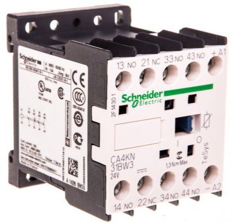

    Need Help: What Is the Contact Configuration of Schneider CA4KN31BW3 Auxiliary Contactor?
  • CA4KN31BW3 has 3 NO and 1 NC contacts

    Just type in the model of the contactor on the internet, and everything is known.
    Schneider CA4KN31BW3 auxiliary contactor - what is the contact configuration?
    You have 3 NO (normally open) contacts, and one NC (normally closed) contact.
    Terminals 13-14, 33-34, 43-44 are NO (normally open) contacts.
    Terminals 21-22 are NC (normally closed) contacts.
    Terminals A1-A2 are the coil of the contactor.
