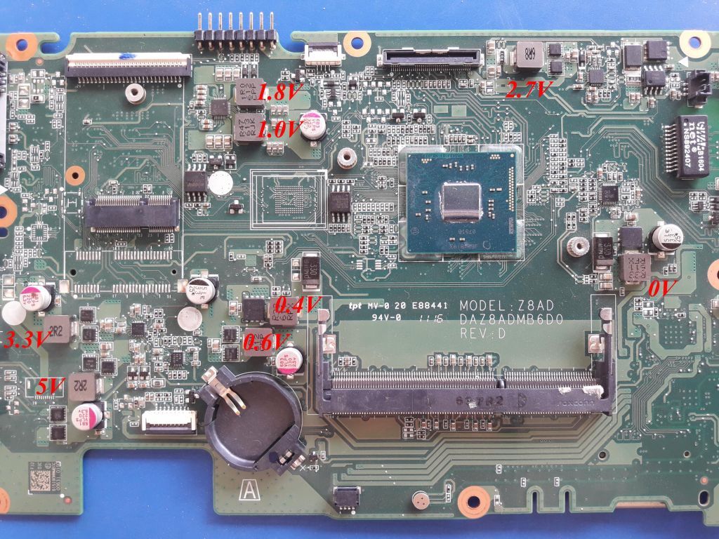

    Good evening, does anyone happen to have this BIOS dump for an Acer laptop? Thank you very much in advance.
    Placa: DAZ8ADMB6D0 REV:D
    Serie
    ES1-431 series
    Model NO.
    N15Q5
    Do you need a clean BIOS dump for this board, or are you trying to fix a specific fault on the laptop? If so, what symptom does it have?
    copia limpia, no da imagen.

    Not necessarily BIOS, measurements.
    SM free Link
    There’s also *.brdview
    read exactly Link
    Laptop motherboard with red voltage readings marked near chips and connectors
    ? DC Power Supply, press power key, consume (?) and then stop ?.
    - or switch Off
    Bios _EC(kbc) clean ME Link
