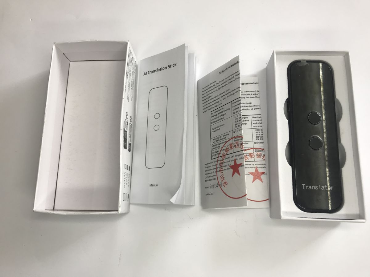

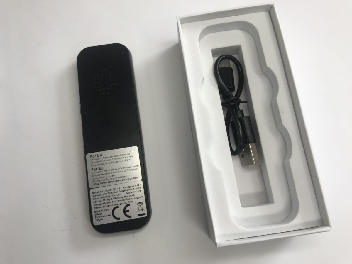

    The box is indeed quite sturdy. It reminds me a bit of buying a new phone – it’s not disposable packaging. The product model is G6, and the FCC ID is 2A6DU-2501.
    Bluetooth One Click Translate – will it come in handy when travelling?
    Inside, we have the device, the manual and a USB-C cable:

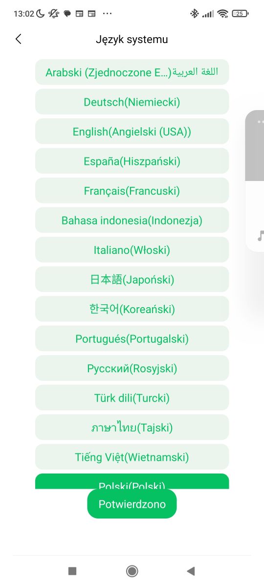

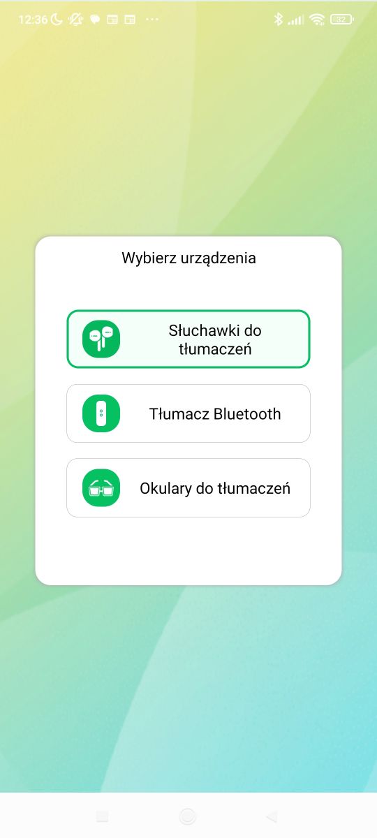

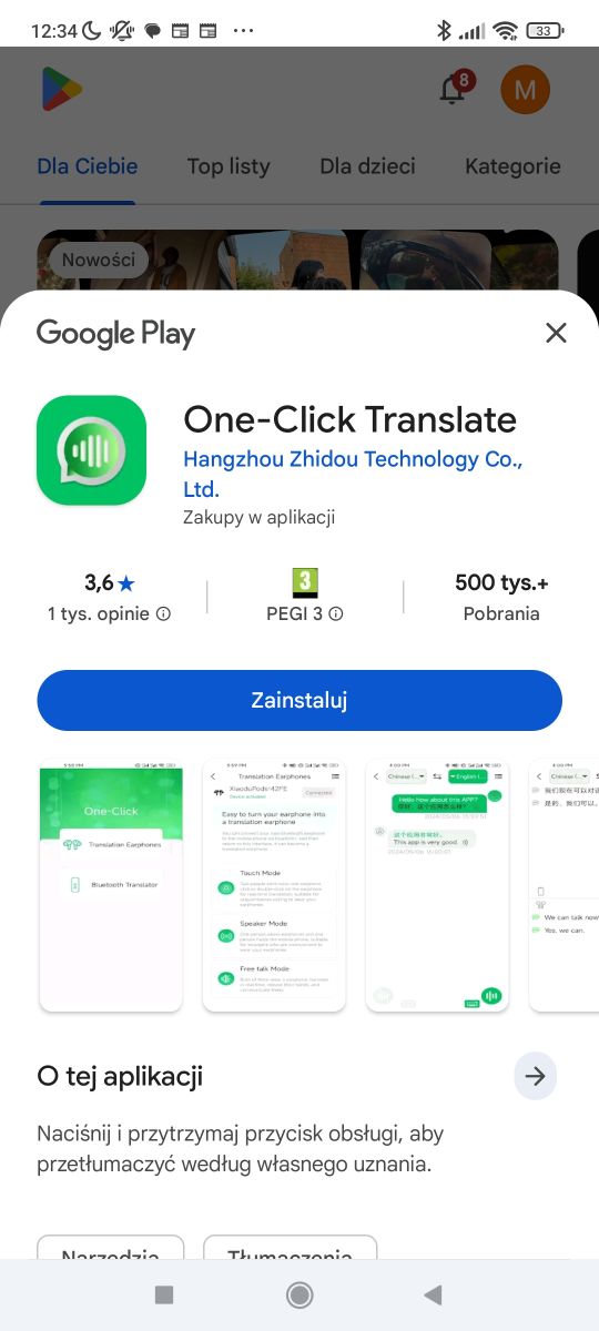

    To use it, you need to download the app – a QR code in the manual will take you there. The app supports several devices; in addition to the translator, there are also headphones and glasses.

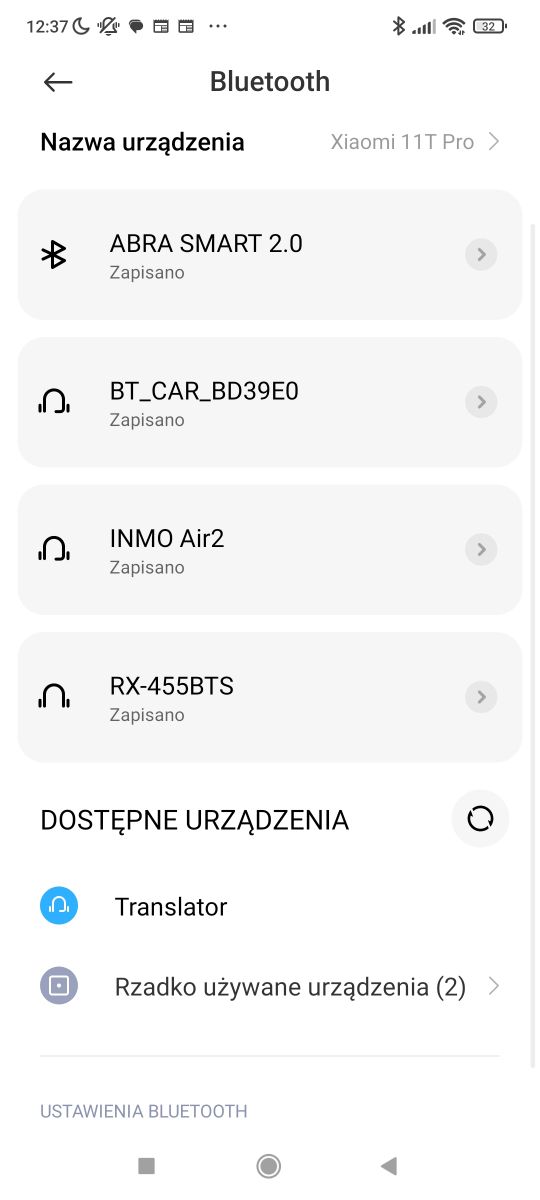

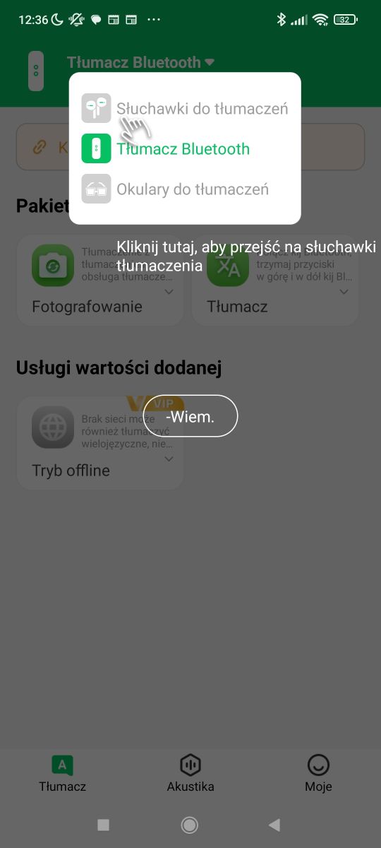

    Pairing requires you to turn on Bluetooth and select the device from the list.
    Bluetooth One Click Translate – will it come in handy when travelling? Bluetooth One Click Translate – will it come in handy when travelling? Bluetooth One Click Translate – will it come in handy when travelling?

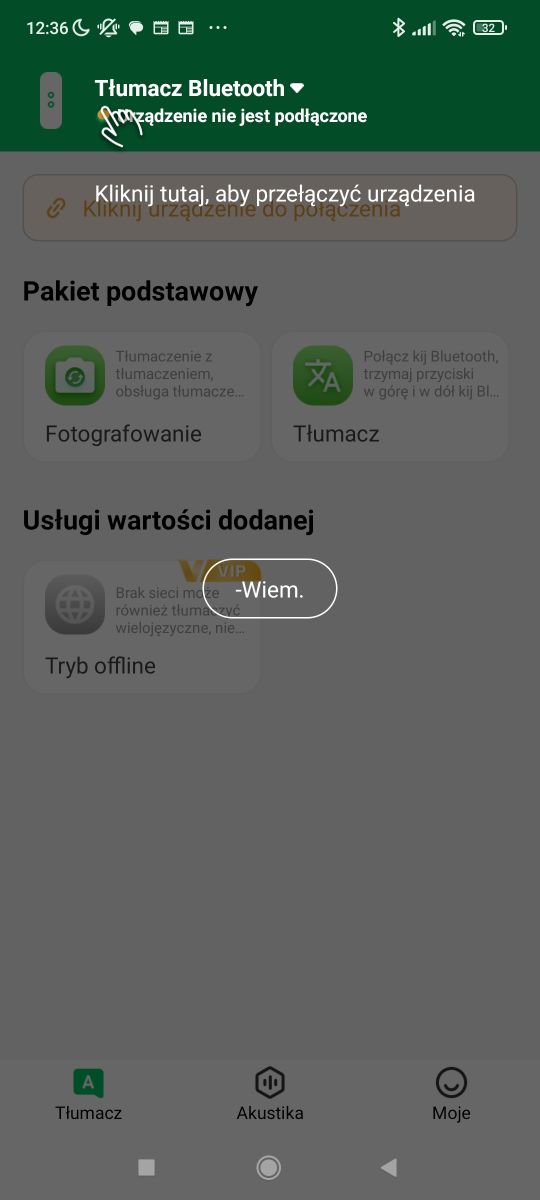

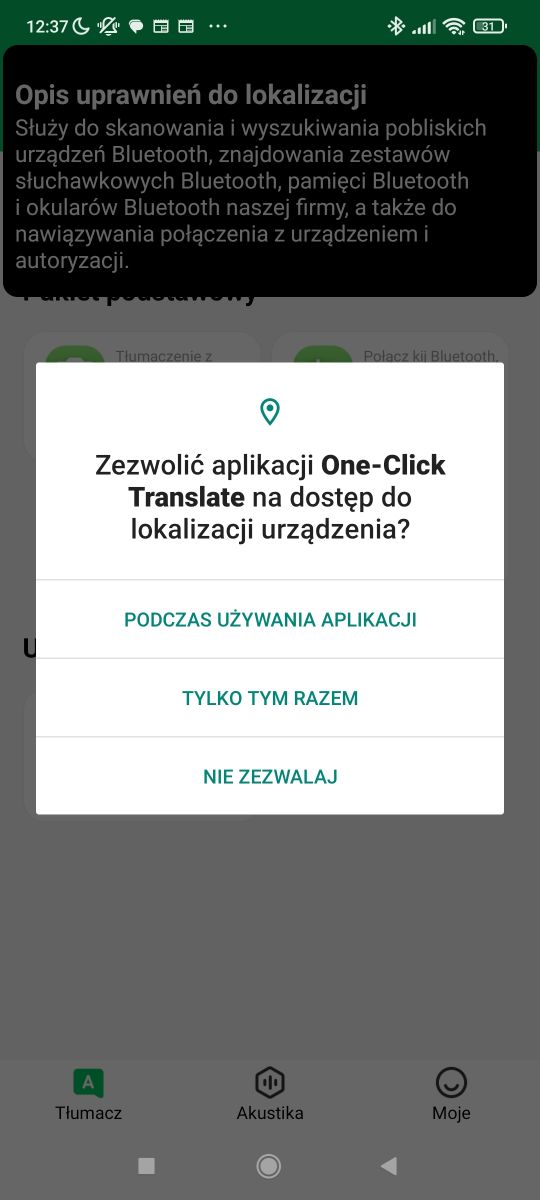

    You must also grant the necessary permissions to the app. From this point on, it’s simple:
    1. In the app, select the languages (between which you wish to translate)
    2. Press the side button to turn on the translator until the LED lights up
    3. To translate, press one of the two buttons and speak whilst it is held down. When you release the button, the translation into the target language begins

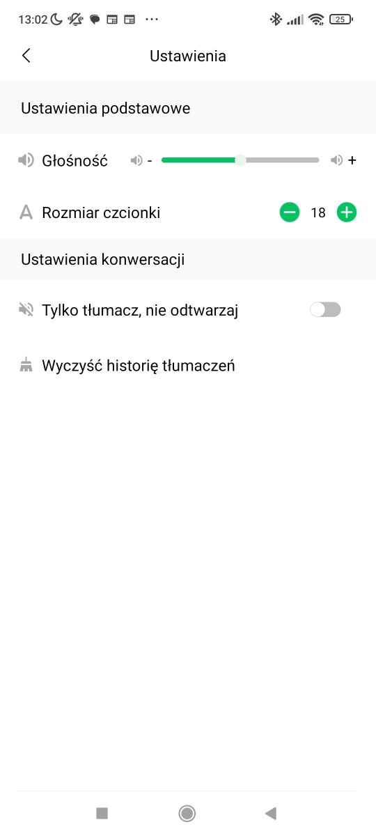

    The app also features a history of translated messages.

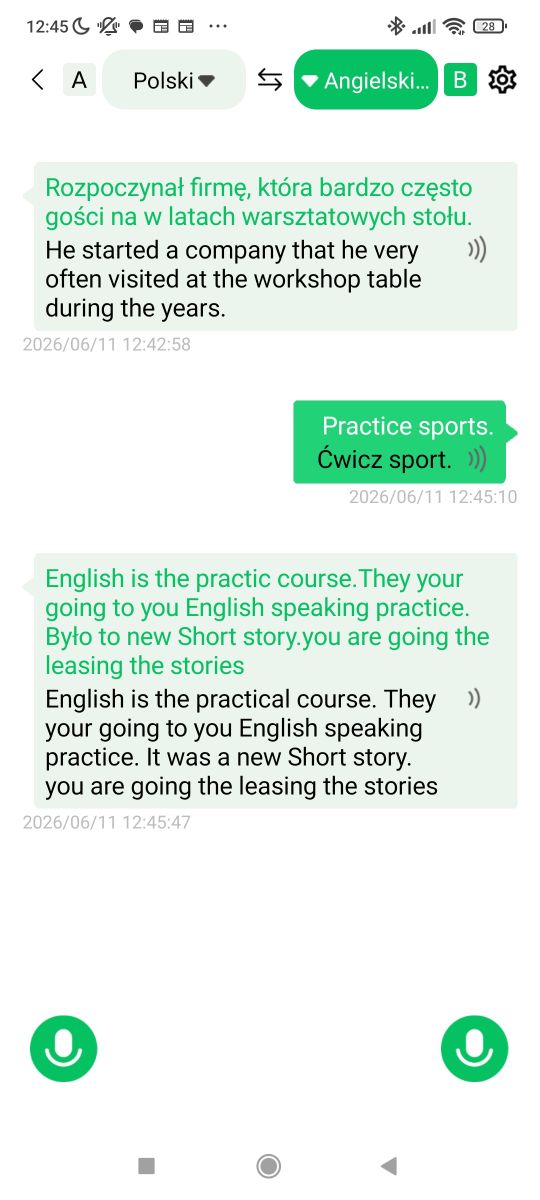

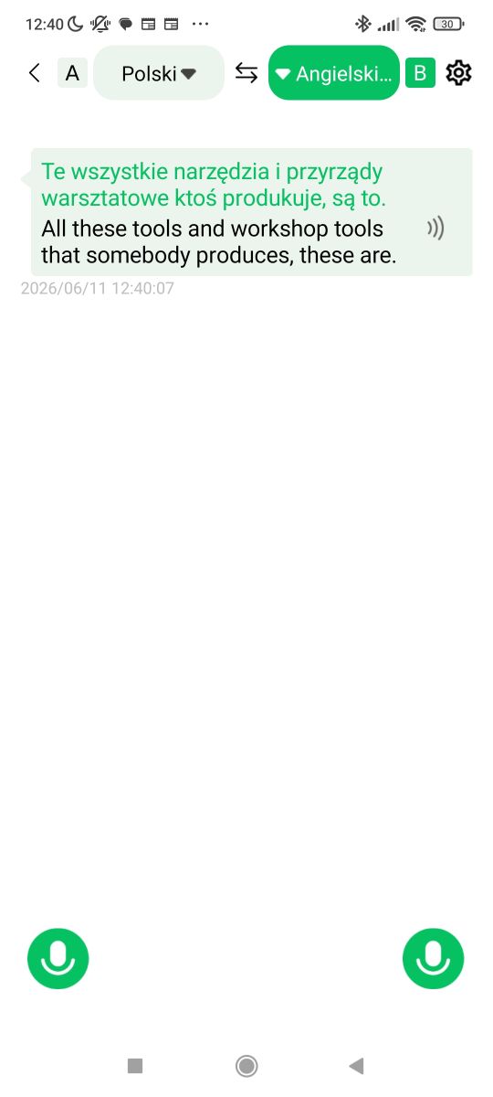

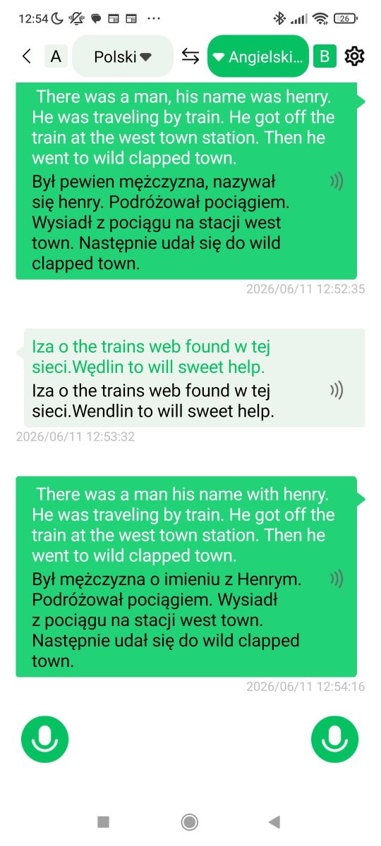

    That’s the theory – but what about in practice? Here is a video demonstration based on free English-language material from YouTube, actually just a short clip:
    The sound is from the translator. First I press the button, then I release it. After a moment, you can hear the translator. You can immediately spot a few issues:
    - there is a brief delay between the end of the utterance and the translation
    - the translation is not on a par with modern AI systems; it is more like Google Translate
    - the device often fails to pick up what is said; you have to speak loudly and clearly
    - the device has trouble with proper nouns – in this example, it failed to translate one of the names, though it is debatable whether it should have...
    Additionally, there is also an issue with which button corresponds to which language – you cannot make a mistake; the button you press determines the source and target languages. There is no automatic detection.

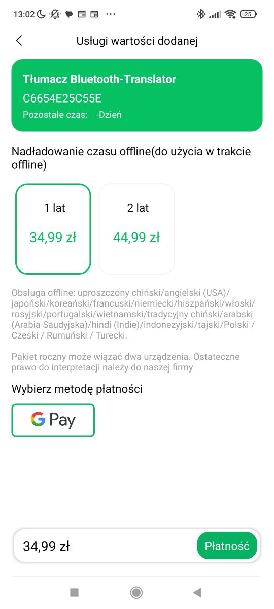

    Another issue is that translations are done in the cloud – there is potentially an offline version, but it’s a paid service, so I haven’t tested it:

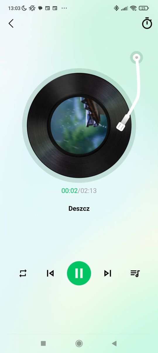

    Additionally, the app has some built-in sound effects – rain, etc. It’s essentially just a Bluetooth speaker/microphone; it’s also suitable for playing music, quite happily without the manufacturer’s app.

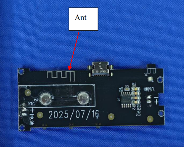

    Finally, a quick look inside - I didn’t want to damage my own unit, so I’ll just quote the photos from the publicly available FCC report:
    Source: https://fccid.io/2A6DU2501/Internal-Photos/Internal-photos-8653107
    Inside, I recognise a single chip from JieLi Technology, the same one I’ve seen in various Bluetooth speakers. This comes as no surprise.

  • Google Translate offline downloads reduce travel dependence

    Google Translate also has options for downloading files so you can translate offline.
    As for the concern that they’ll hijack your phone – you’re right, but let’s bear in mind that most Bluetooth speakers have a microphone and a hands-free calling function.
    The problem I see is the app itself. We don’t know what it might do, what data it might collect or what it might share.
