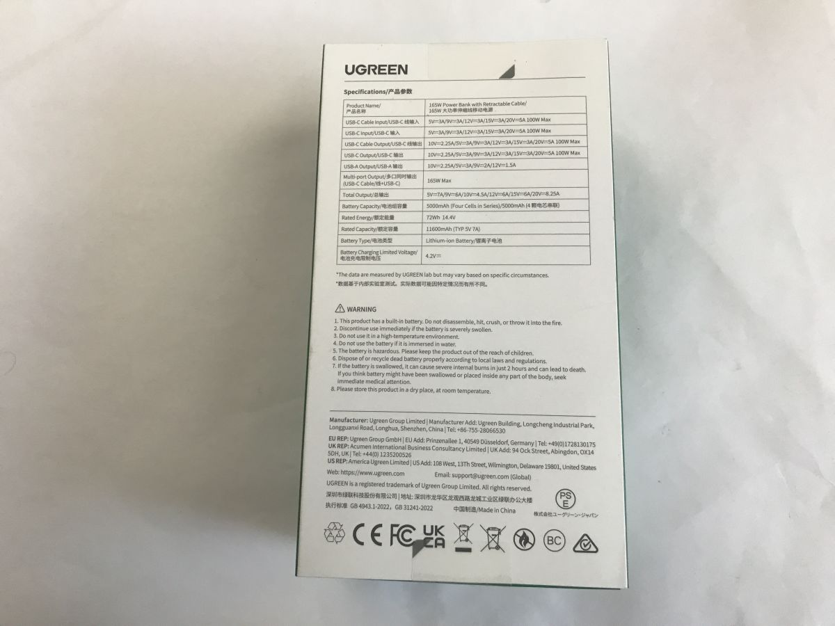

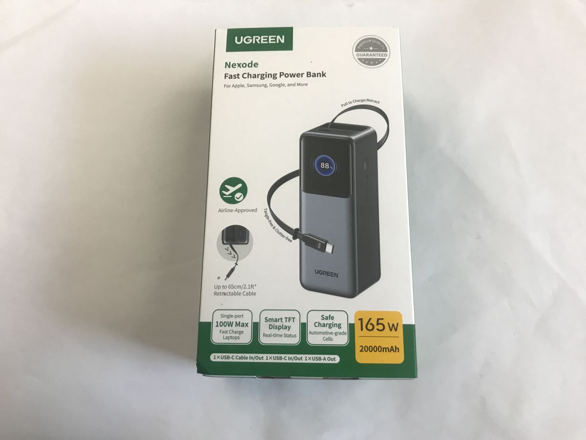

    Let’s start with the packaging. The first thing that catches the eye, however, is the large number of additional features not found in cheaper models. We’ve got a claimed power output of up to 100 W, support for fast-charging protocols and a clear TFT display replacing the simple ‘four dots’ found on cheaper models. I’m a bit puzzled by this 165 W figure – where does it come from, when the text right next to it mentions a value that’s a third lower?
    Is it worth buying a more expensive power bank? We test the high-end UGREEN PB726 20 Ah with PD

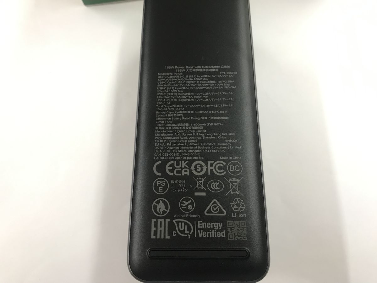

    Everything on the back is also described in exemplary detail. This 165 W is supposedly the combined output from multiple ports; I’m afraid I won’t even be able to test that fully. In addition, the power bank supports voltages of up to 20 V on USB-C and up to 12 V on USB-A.

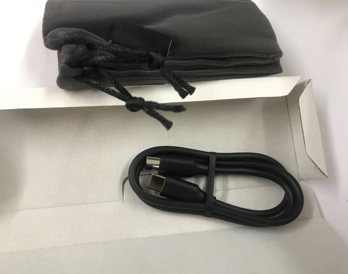

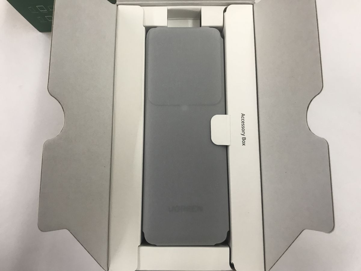

    Everything is nicely packaged; it feels as though I’m unboxing a new mobile phone. The set also includes a modern USB-C cable.

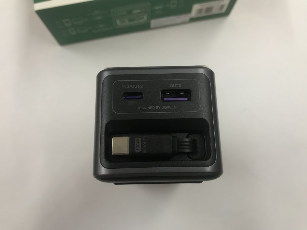

    The power bank also has its own retractable cable with a spring-loaded mechanism; it also features a magnet to keep the cable end in the retracted position, so it doesn’t get caught on other items in your bag.
    Is it worth buying a more expensive power bank? We test the high-end UGREEN PB726 20 Ah with PD Is it worth buying a more expensive power bank? We test the high-end UGREEN PB726 20 Ah with PD Is it worth buying a more expensive power bank? We test the high-end UGREEN PB726 20 Ah with PD

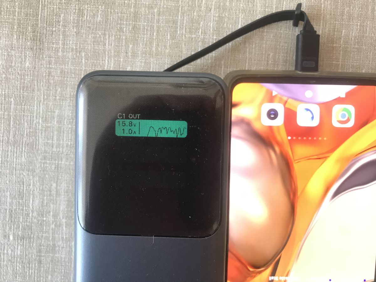

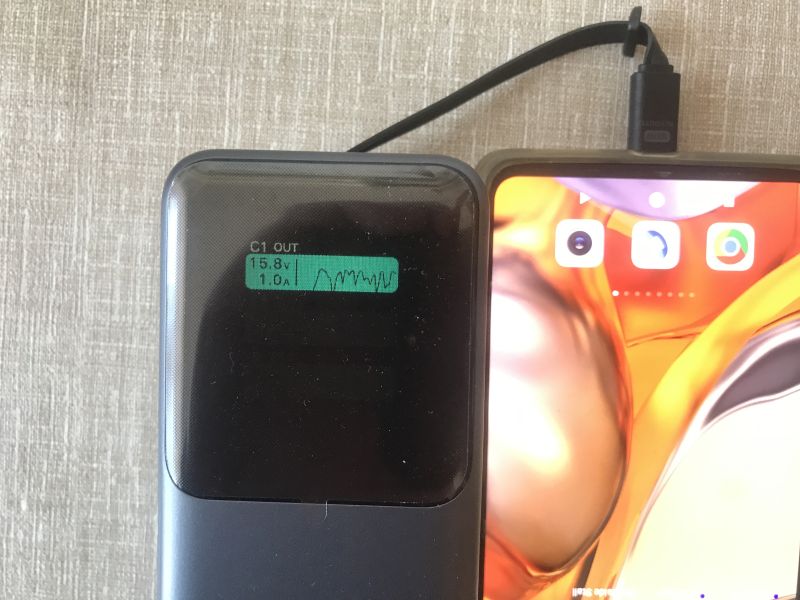

    Time to move on to the tests. First, something simple: charging my Xiaomi phone. The unit supplies 16 V and the phone draws around 1 A, displaying ‘fast charging’. It’s not quite the same as with the original power supply, which could deliver several dozen watts, but it’s still not bad.

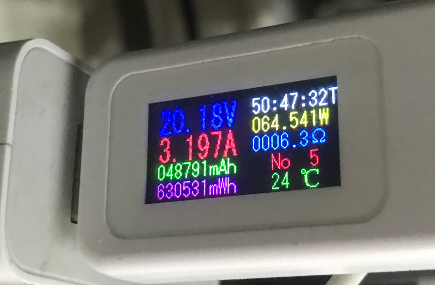

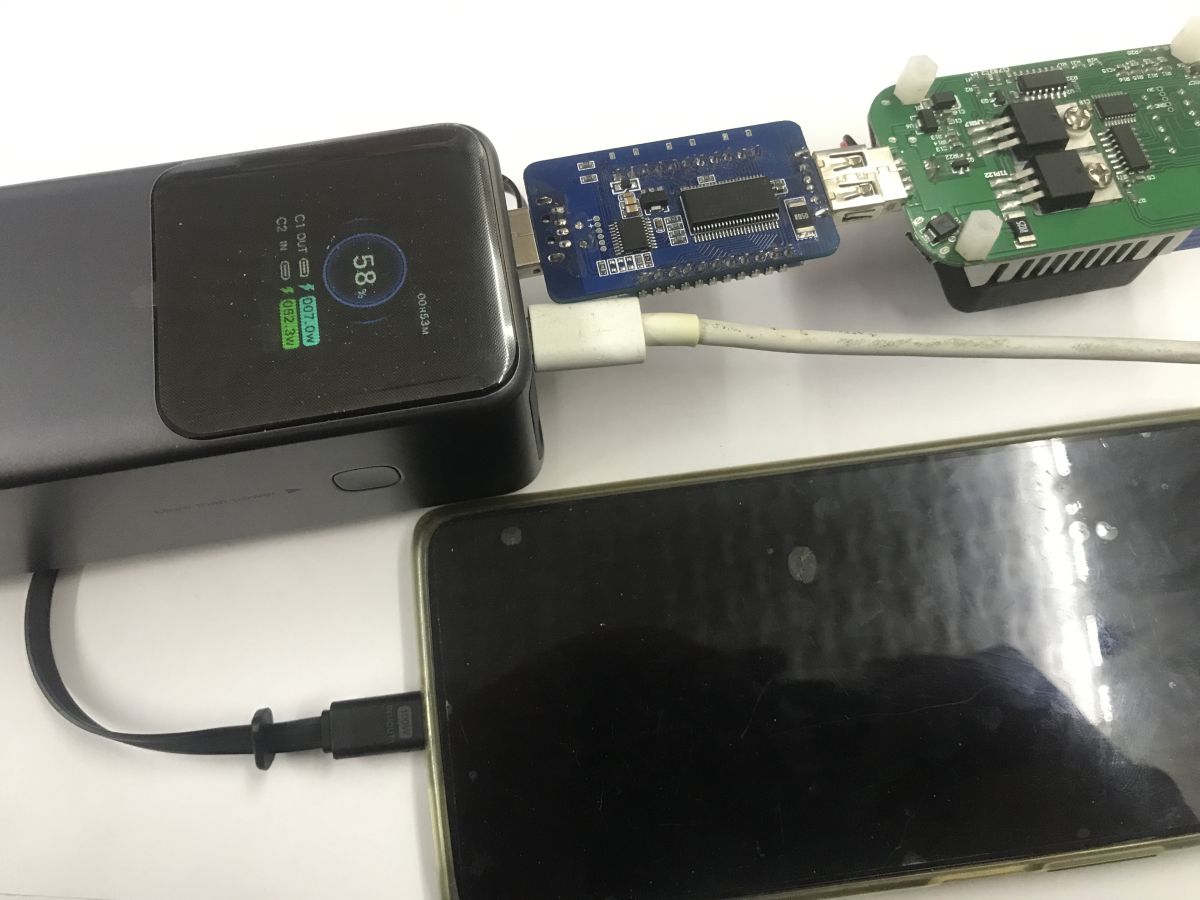

    Now let’s try it the other way round. To make things a bit trickier, I’ve also loaded the output. Now I want to charge a power bank using my Xiaomi power supply:
    That’s impressive. My Xiaomi 11T is from 2021, yet its power supply still got on well with this power bank and delivers a good 60 W.

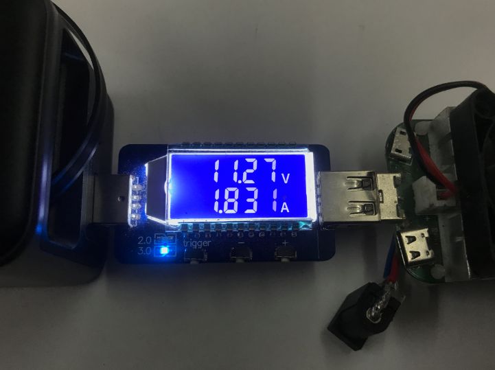

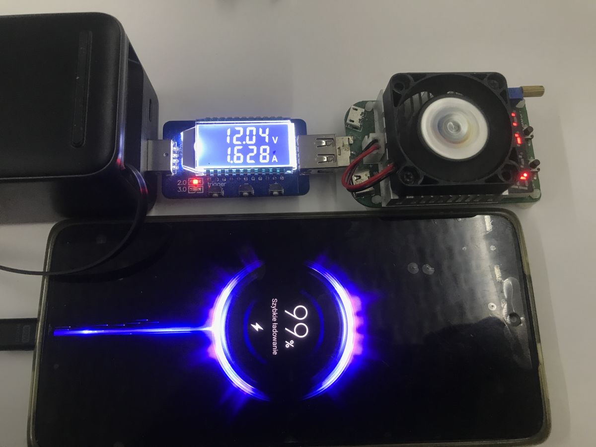

    Now let’s check QC on port A – indeed, it’s exactly as stated on the label. You can draw up to 1.5 A at 12 V:

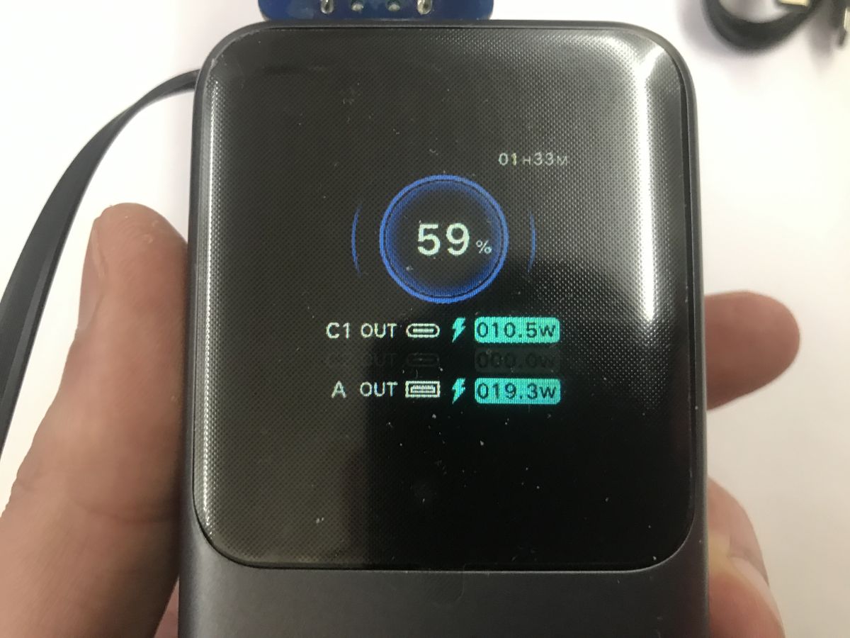

    What’s more, you can continue to load it – so several ports can indeed operate at the same time. Here, the built-in cable is powering the phone at a higher voltage, whilst a separately connected QC Trigger is set to 12 V.
    The display constantly shows the current voltages, currents and power levels, as well as the charge level, and also estimates how much time is left until the battery is fully discharged or fully charged.

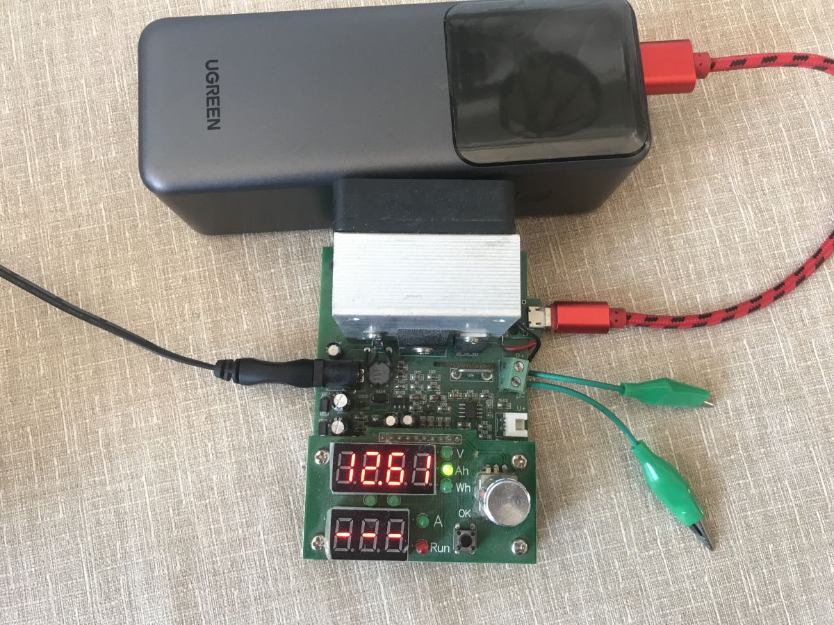

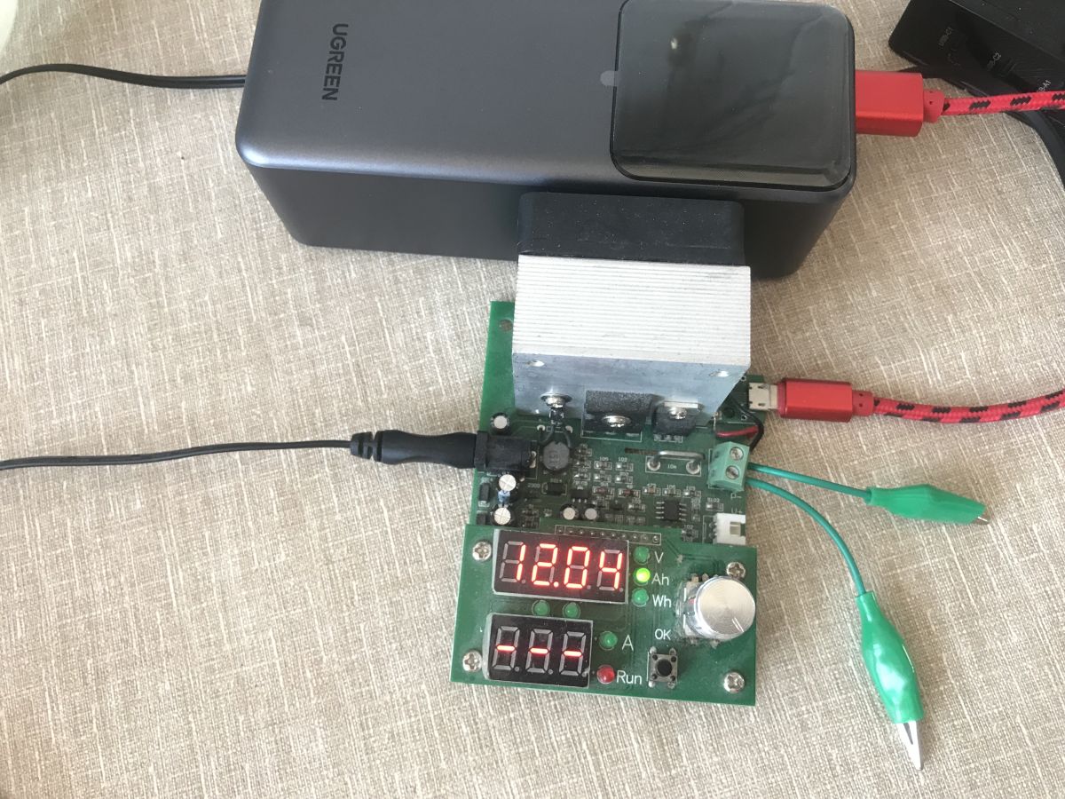

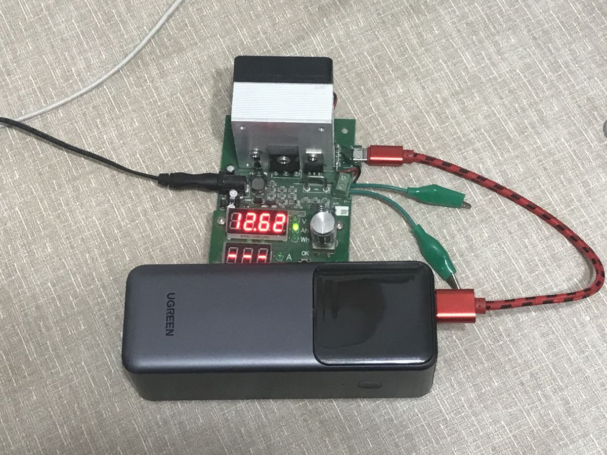

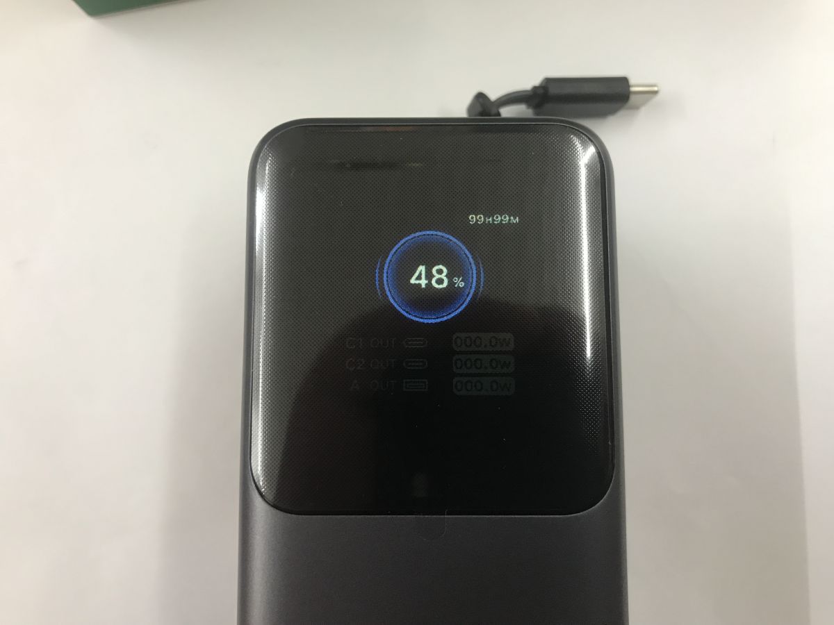

    All that remained was to check the capacity – I opted for a load of 1.5 A at 5 V:
    Is it worth buying a more expensive power bank? We test the high-end UGREEN PB726 20 Ah with PD Is it worth buying a more expensive power bank? We test the high-end UGREEN PB726 20 Ah with PD UGREEN power bank connected to a test board with LED display showing 12.04
    The label states a Rated Capacity of 11,600 mAh at 5 V. Internally, it consists of 4 × 5,000 mAh cells, but this is at 3.7 V per cell. My measurements show just over 12 Ah at 5 V, so everything adds up. You can also multiply: 12 Ah * 5 V = 60 Wh. The packaging mentions 72 Wh, but I think that’s before accounting for losses in the converters.
    To sum up, this was a capacity test of the UGREEN PB726 power bank, bought for a whole 300 zł. Whilst I was at it, I also checked It’s also partly down to its ability to support QC and PD, although I was slightly short of the necessary kit to make it a complete success. That doesn’t change the fact that I can already give a partial verdict:
