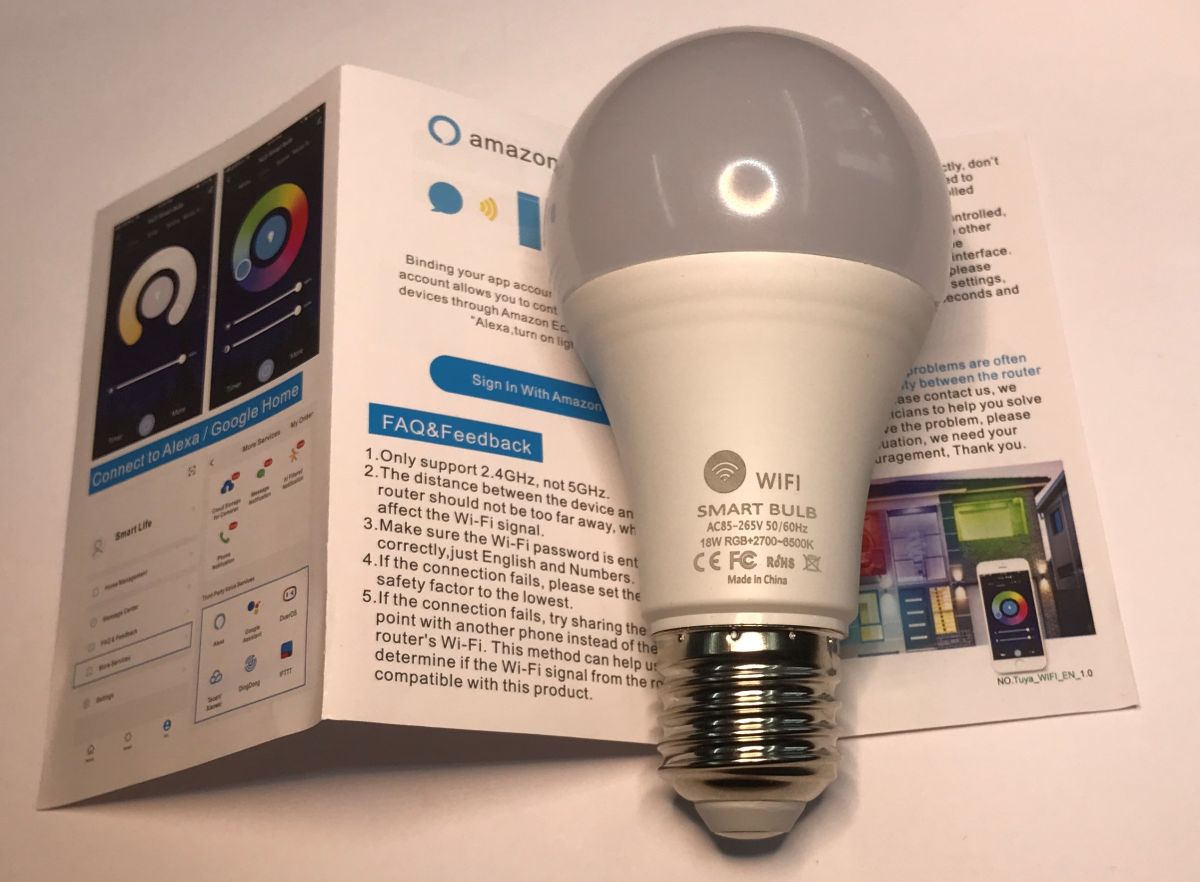

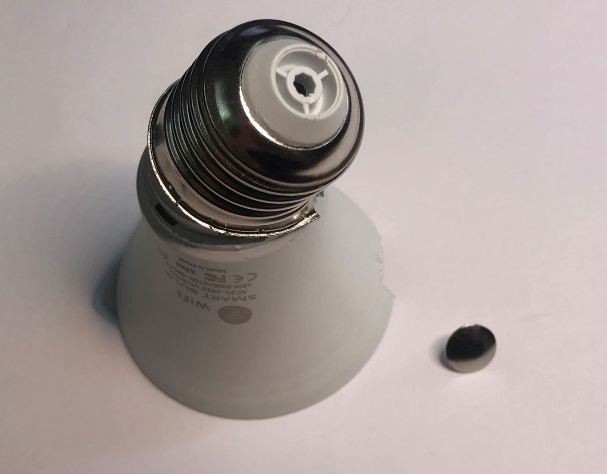

    The box didn’t survive the journey very well, but the lamp is intact. The pack includes a brief guide on how to pair it with the SmartLife app (a Tuya clone). The device is put into pairing mode by switching it off and on three times. The Bluetooth information suggests that this is not an ESP8266-based product – which does not support Bluetooth – but perhaps something based on Beken.
    Can even light bulbs be programmed these days? Updating the firmware on the TY-A60-18W-220V Can even light bulbs be programmed these days? Updating the firmware on the TY-A60-18W-220V Can even light bulbs be programmed these days? Updating the firmware on the TY-A60-18W-220V

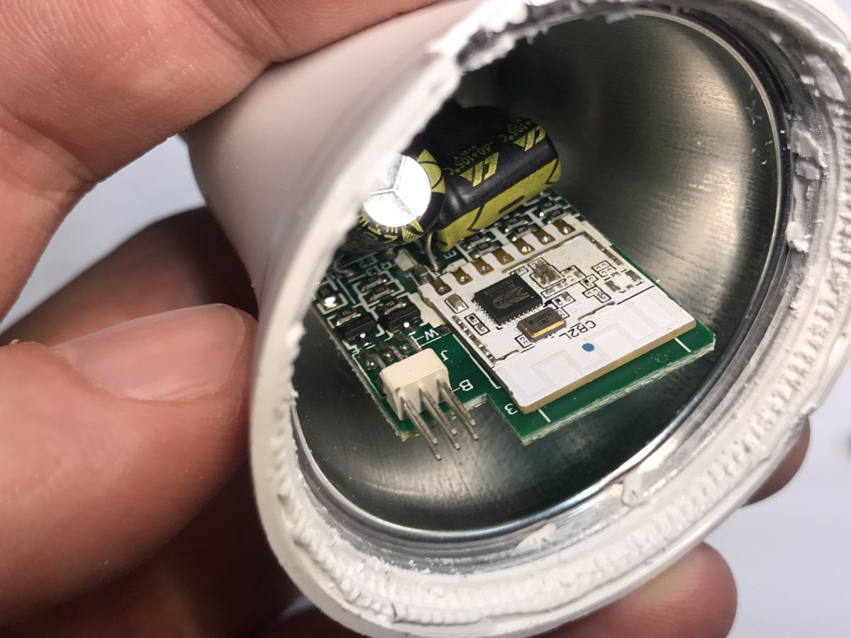

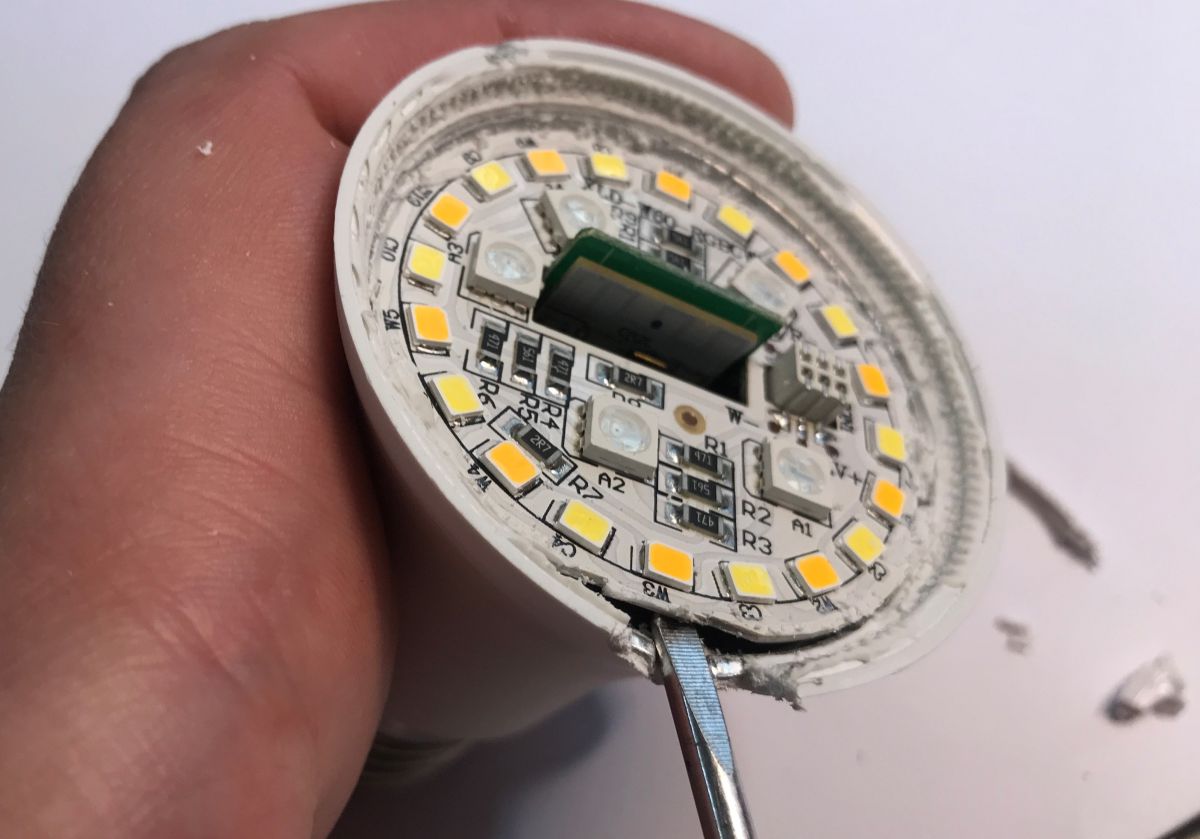

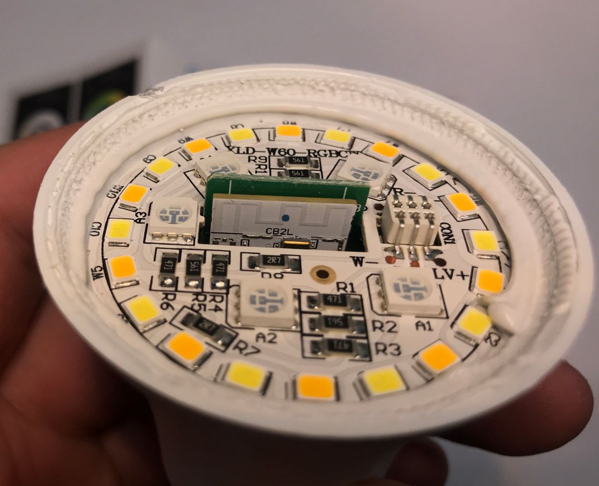

    We remove the dome to expose the LEDs. There are separate coloured (RGB) LEDs, and separate warm and cool white LEDs.

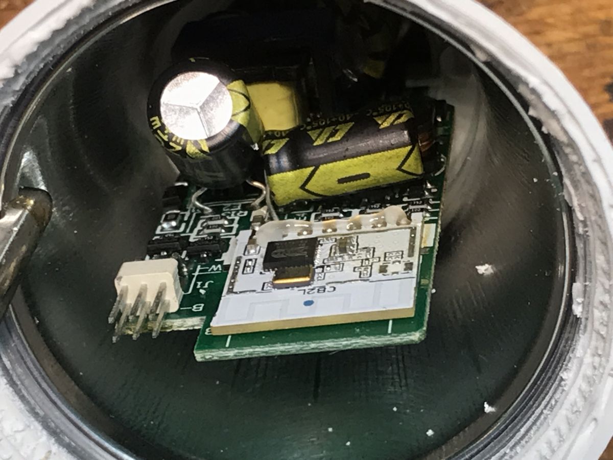

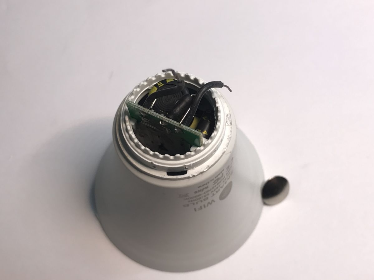

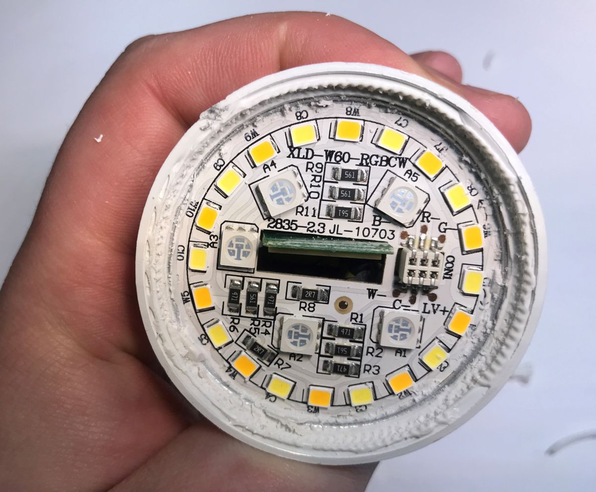

    Unfortunately, this board needs to be removed, which will compromise the cooling system slightly. I struggled a bit to pry it loose.

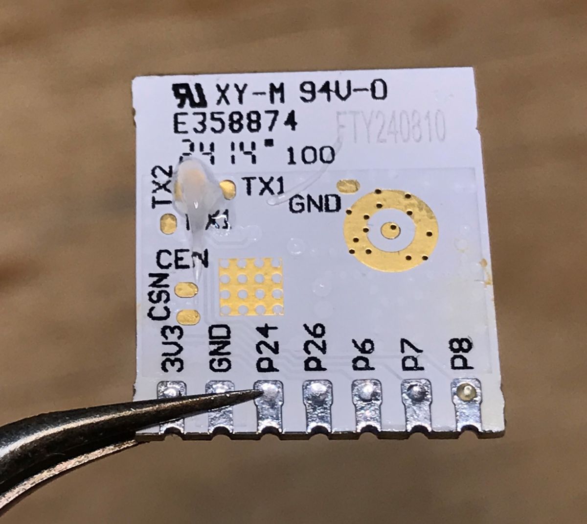

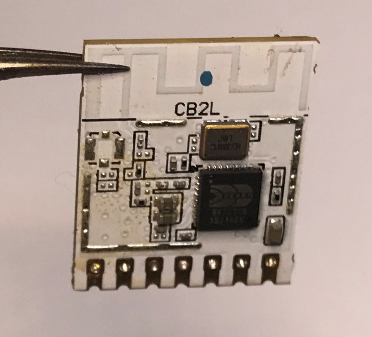

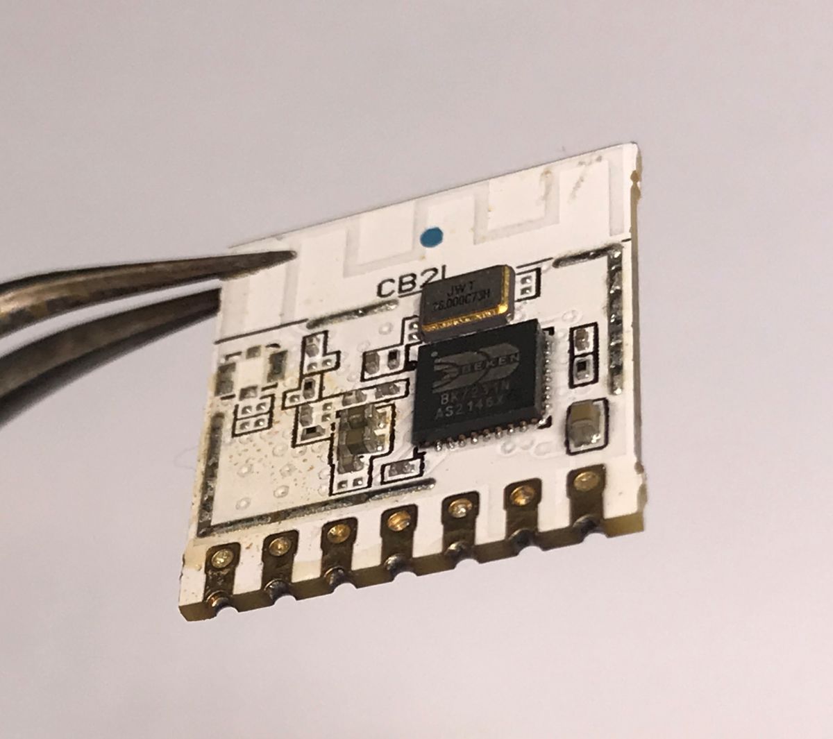

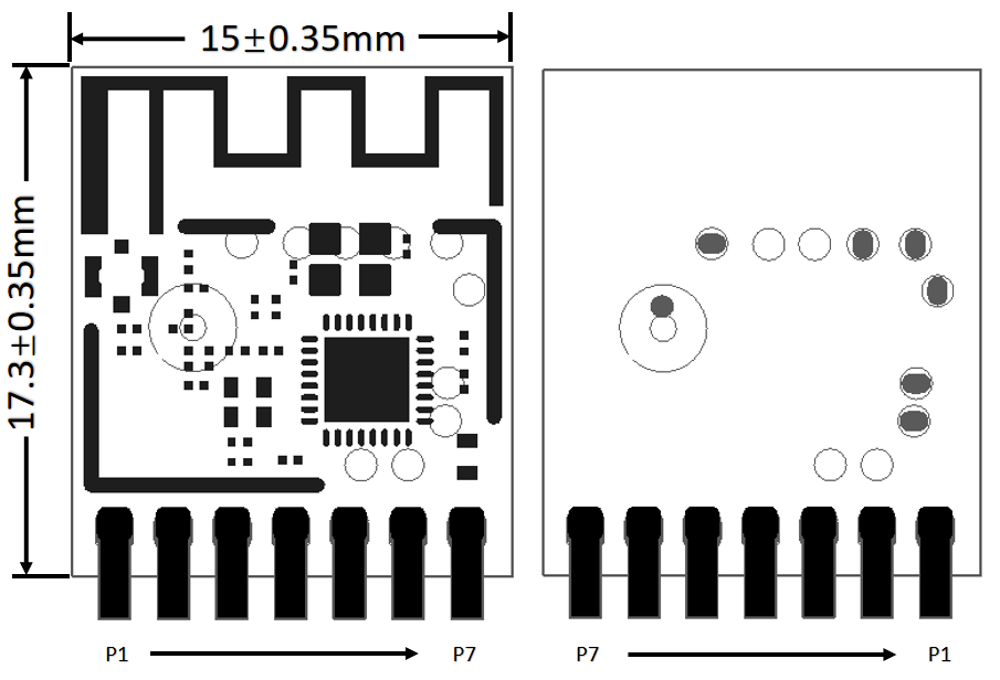

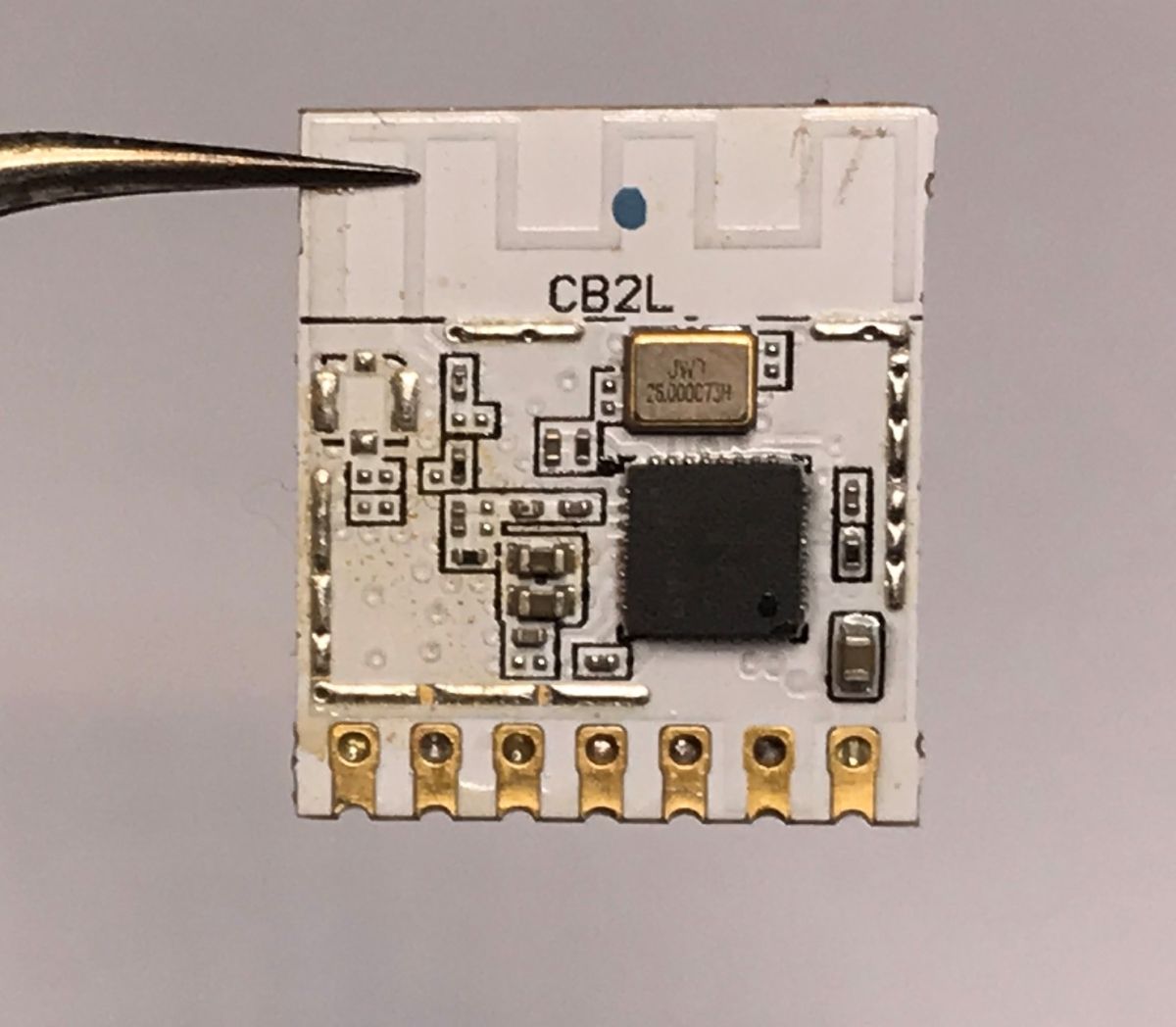

    Inside is the CB2L module, i.e. the BK7231N with PWM pins exposed, designed for lighting (L – lamps/lighting). Unfortunately, to update the firmware, you need to desolder this module. This is because the UART pads are on its underside. I used a hot-air gun for this.

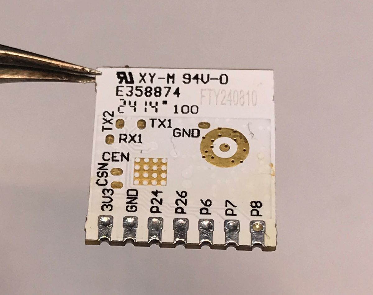

    Pin number Symbol I/O type Function
    1 P8 I/O Hardware PWM support
    2 P7 I/O Supports hardware PWM
    3 P6 I/O Supports hardware PWM
    4 P26 I/O Hardware PWM support
    5 P24 I/O Supports hardware PWM
    6 GND P Power supply reference ground
    7 3V3 P 3V3 power supply

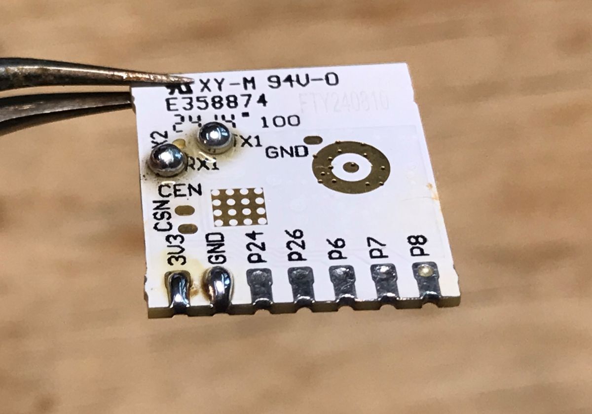

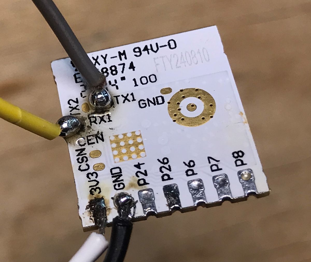

    Here’s what the module looks like from the back – I’ve also white-painted the relevant pads straight away:

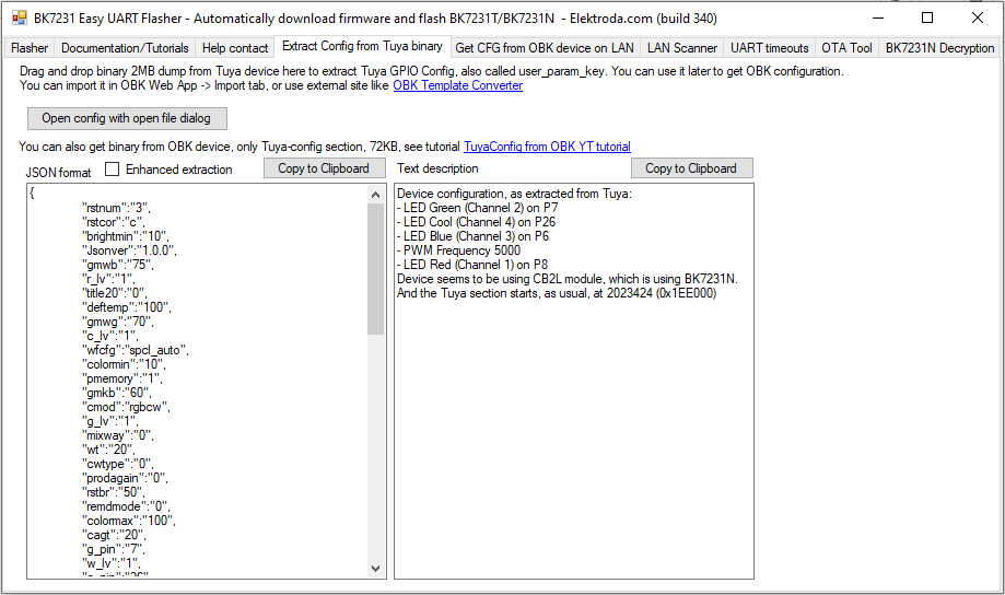

    I’m flashing the firmware using our Elektrodowy flasher, which supports multiple platforms:
    We’re flashing the OBK:
    A copy of the original firmware:
    https://github.com/openshwprojects/FlashDumps/commit/4dcc3d4e7fcfb3b82c81c472281c305926d1a80b
    Extracted Tuya configuration:
    Verbal description:
    Device seems to be using CB2L module, which is BK7231N chip.
    - LED Red (Channel 1) on P8
    - LED Green (Channel 2) on P7
    - LED Blue (Channel 3) on P6
    - LED Cool (Channel 4) on P26

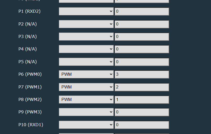

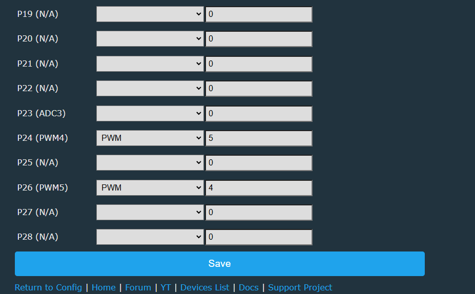

    The warm white pin was missing, but I found it manually. The Beken has a limited number of PWM pins, and the CB2L further restricts the choice:

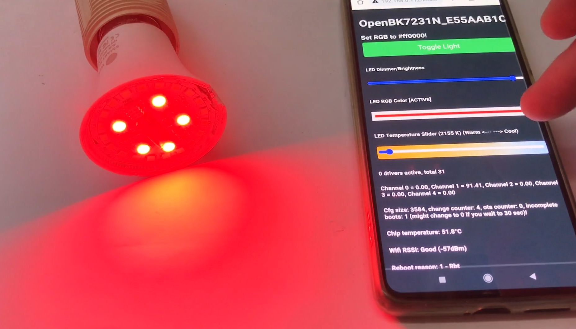

    After a quick configuration, the light works via the web interface hosted on the Wi-Fi module itself by OBK, but you need to assemble it first. There’s no way to solder the Wi-Fi module back onto the board without removing it, so you need to unscrew the thread:

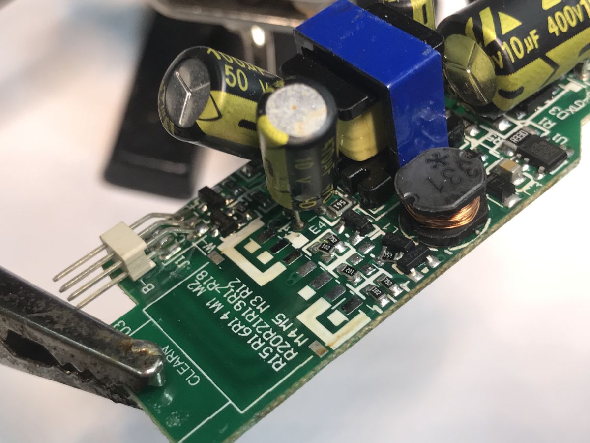

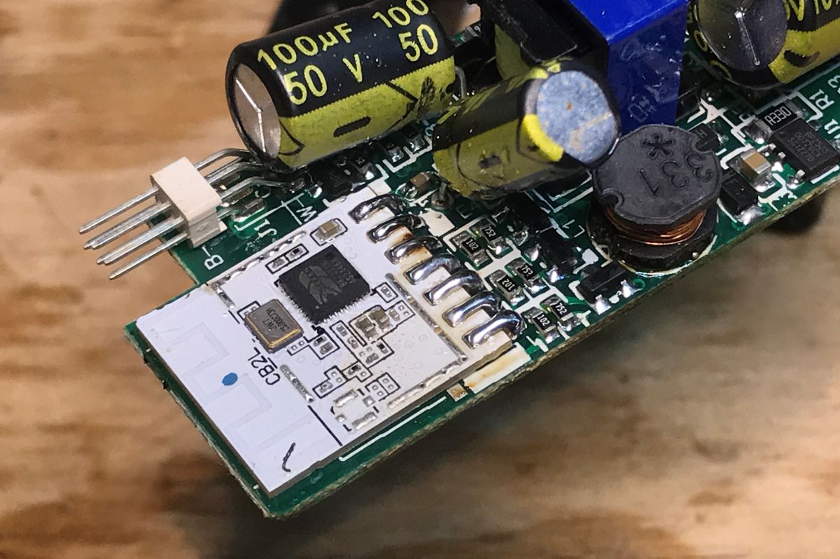

    Whilst I was at it, I also had to tidy up after myself, as I’d moved a few SMD components whilst removing the module:
    In the end, I managed to sort everything out, so you can have another look at the lamp’s construction:

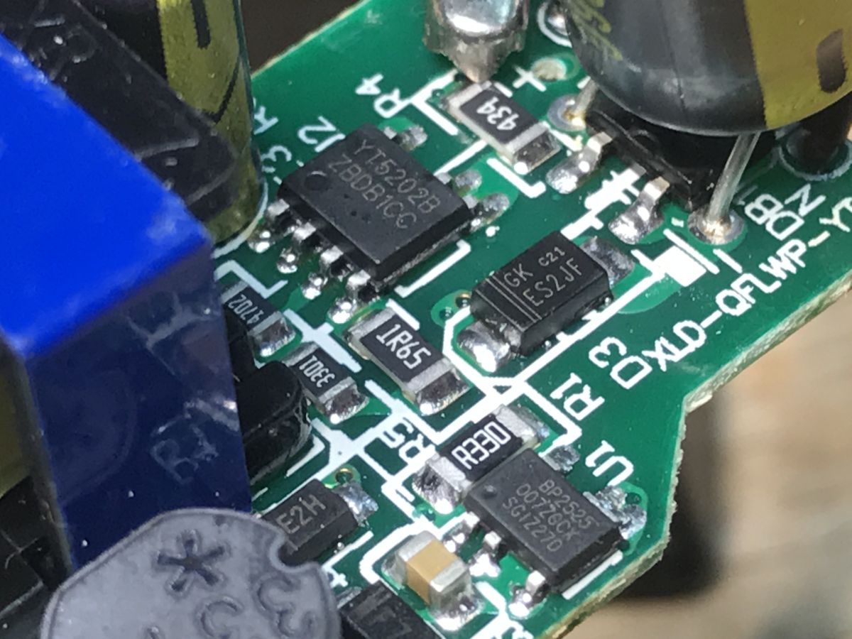

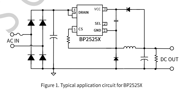

    Here we have the YT5202B separately, which is probably the power supply for the LED, and the BP2525 separately, which powers the Wi-Fi module. It’s quite a complex design; gone are the days when LEDs just had a capacitor and a resistor. The BP2525 is a non-isolated step-down converter; I’d guess the YT is a constant-current controller.

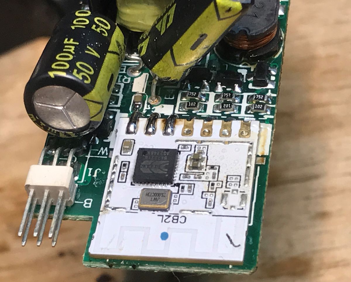

    The Wi-Fi module soldered into place:
    Close-up of a PCB with CB2L Wi‑Fi module and a large 100 µF 50 V electrolytic capacitor Close-up of a PCB with a CB2L module, capacitors and an inductor; a pin header is visible at the edge.
