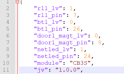

    Let's start by considering a sample JSON:
    This is a description of a simple 6014HA device, featuring a single relay, WiFi LED and a button.
    The most important keys here start with "rl1_", "netled_", and "bt1_".
    The "rlX_" prefix stands for relay. There can be multiple relays, so X stands for the relay number.
    There are multiple keys for relays:
    Code: C / C++
    The "lv" key stands for active level. Value 1 means that relay is active-high, so relay is closed when the given GPIO has high level.
    This is a standard for all Tuya products so we are not even parsing that.
    The more important key is rl1_pin, which is a GPIO index of Relay pin. 14 there means that relay is on P14 (not on the 14th pin of QFN case).
    The same logic applies to buttons. There can be also multiple buttons, for example, bt1_pin is a GPIO of a first button, and bt2_pin is a GPIO of second button. Futhermore, there can be also LEDs following relay states, so led1_pin, led2_pin, etc is possible.
    Of course, most of IO roles are not numbered, for example, status_led_pin. Here is more detailed list of Tuya JSON keys:

    As you can see, Tuya JSON decoding can make "cloudless" conversion of your Tuya device much faster and easy than it was in case of ESP8266/Tasmota devices. Most of the related GPIO roles are included in JSON, so you don't have to guess anymore. Futhermore, OpenBeken can automatically convert Tuya JSON to a template, so all you have to do is just to copy and paste the extracted text.

How do I automatically extract a Tuya JSON configuration from a live device or a 2MB flash dump with BK7231GUIFlashTool?
You use BK7231GUIFlashTool to read the Tuya configuration and then export the JSON. 1. Connect to the live device or open a 2MB flash backup. 2. Extract the Tuya Config JSON with the flasher. 3. Copy the extracted text into the OpenBeken decoder to generate a template. This workflow is explicitly described for both live devices and 2MB dumps, so you do not need manual GPIO probing first. [#21155505]
What is Tuya JSON, and how does it help OpenBeken build a GPIO template automatically?
Tuya JSON is the device configuration blob that lists hardware roles such as relay pins, button pins, LED pins, and communication settings. OpenBeken uses those keys to infer functions like relay output on P14, WiFi LED on P24, and button input on P26 in the sample device. Because the JSON already names many roles, OpenBeken can convert the extracted text into a GPIO template automatically instead of asking you to guess each pin. [#21155505]
Why is Tuya JSON-based GPIO detection easier in OpenBeken than manual GPIO probing in Tasmota?
It is easier because the Tuya JSON already contains many GPIO roles, so OpenBeken can parse them directly. The thread contrasts this with Tasmota, where all GPIO probing must be done manually. In the OpenBeken flow, relay pins, PWM pins, and even TuyaMCU baud can come from the JSON, which removes much of the trial-and-error process. The practical result is faster cloudless conversion with fewer wrong pin assignments. [#21155505]
How should I interpret common Tuya JSON keys like rl1_pin, bt1_pin, netled_pin, and baud?
Interpret them as hardware-role fields tied to specific GPIO indexes or communication settings. rl1_pin means relay 1 GPIO, bt1_pin means button 1 GPIO, netled_pin means WiFi LED GPIO, and baud means the UART speed used for TuyaMCU or BL0942 communication. In the sample JSON, rl1_pin is 14, netled_pin is 24, and bt1_pin is 26. Those values map to P14, P24, and P26, not to package pin positions. [#21155505]
What does the Tuya JSON active-level field like rl1_lv or bt1_lv mean, and how should it be used?
It defines which logic level makes that function active. For example, rl1_lv:1 means the relay is active-high, so the relay closes when that GPIO goes high. The same pattern applies to buttons, LEDs, and other roles with *_lv fields. Later analysis also showed many active-level keys in real dumps, including rl1_lv in 314 unique KVs and bt1_lv in 240, which makes polarity handling important for correct template assignment. [#21834399]
Which Tuya JSON keys are used for relays, buttons, LEDs, PIR sensors, BL0937 energy metering, and TuyaMCU communication?
Relays use keys like rl1_pin, buttons use bt1_pin or k1pin_pin, LEDs use led1_pin, netled_pin, status_led_pin, or wfst_pin, PIR uses basic_pin_pin, pirin_pin, and pirsense_pin, BL0937 uses ele_pin, vi_pin, and sel_pin_pin, and TuyaMCU communication uses baud. The thread also lists bistable-relay keys such as rl_on1_pin and rl_off1_pin, plus battery, I2C, OneWire, and RGB PWM keys. That breadth is why Tuya JSON is so useful for auto-mapping. [#21155505]
Where can I paste and decode an extracted Tuya JSON online to convert it into an OpenBeken template?
You can paste it into the OpenBeken online template importer mentioned in the thread. The author states that the extracted Tuya JSON can be decoded with the web utility and then converted into a template, so the workflow is copy-and-paste rather than manual reconstruction. The same post also points to BK7231GUIFlashTool for extraction and a flash-dump library for examples, which makes the importer part of a larger toolchain. [#21155505]
What is TuyaMCU in the context of Tuya JSON, and what does the baud key tell me about the device?
baud tells you the communication speed used by the TuyaMCU or BL0942 link on that device. "TuyaMCU" is a device-side microcontroller that handles functions through a serial link, with a JSON-exposed baud setting that tells OpenBeken how that UART is configured. In practice, the thread treats baud as a direct clue for automatic setup, alongside GPIO roles, so it helps identify how the WiFi module talks to the rest of the hardware. [#21155505]
How complete is the list of Tuya JSON pin names, and why do aliases like micpin and mic both appear?
The list is useful but not complete, and aliases exist because Tuya key naming is not fully standardized. The thread explicitly says the list is not comprehensive and will grow over time. It also gives a concrete alias example: both micpin and mic were seen for microphone input. A later reply adds that a GPT-generated key list missed micpin, which shows why Easy Flasher and related parsers must handle variants rather than relying on one exact spelling. [#21156244]
What is the difference between netled_pin, net_led_pin, status_led_pin, wfst_pin, and netled_reuse in Tuya devices?
They all relate to LED behavior, but they do not mean exactly the same thing. netled_pin and net_led_pin are WiFi LED names, with net_led_pin appearing later as an alias candidate. status_led_pin and wfst_pin also refer to pairing or WiFi-state LEDs. netled_reuse is different: it indicates that one LED may be shared, first for WiFi state and later for on/off or channel state after connection. That makes it a behavior flag, not just a pin name. [#21447785]
How could OpenBeken handle a shared WiFi/status LED after connection when netled_reuse indicates dual-purpose behavior?
A practical approach is to keep the WiFi LED role and allow a channel assignment after WiFi connects. One proposal in the thread says the LED should keep normal WiFi behavior until connection, then act as the LED for an assigned channel. Another post notes a hard edge case: channel 0 is already a normal relay channel, and -1 cannot be used because the value is stored as an unsigned byte. A special value such as 255 was suggested instead. [#21447955]
Which additional user_param_key pin names are still missing from Easy Flasher handling, such as key_pin, sound_pin, total_led_pin, or ele_rx and ele_tx?
The thread identifies several missing or under-handled keys, including key_pin, sound_pin, total_led_pin, display_led1_pin, net_led_pin, lightplus_sw_pin, lightminus_sw_pin, tamper_pin_pin, zero_io_pin, hl_ctl_io_pin, a_ctl_io_pin, p_sw_io_pin, ir, MOSI, MISO, ele_rx, ele_tx, series_rx, and series_tx. The later bulk analysis ranked them by frequency, with key_pin at 15/18, sound_pin at 6/6, and ele_rx/ele_tx at 14/16. Those counts help prioritize Easy Flasher updates. [#21834399]
When should a newly discovered Tuya JSON GPIO key be auto-assigned in Easy Flasher, and when is it safer to report it only?
Auto-assign it when the role is clear and consistent across devices, and report it only when the role is ambiguous. The thread treats key_pin, sound_pin, and total_led_pin as strong candidates for direct mapping because they clearly match button, buzzer, or indicator LED functions. By contrast, keys such as zero_io_pin, hl_ctl_io_pin, a_ctl_io_pin, and p_sw_io_pin were recommended as report-only because their exact function is not yet safe to assign automatically. That policy reduces wrong templates. [#21834399]
How do SPI and IR-related aliases like MOSI, MISO, ir, irpin, infrr, and infre show up in Tuya JSON, and how should they be mapped?
They appear as both standard and alias-style names, so the parser should normalize them. The thread lists mosi as SPI MOSI, later reports uppercase MOSI and MISO as aliases, and suggests mapping them as SPI pins. For infrared, it lists irpin or infrr as IR receiver input and infre as IR sender output, while later analysis adds plain ir as another receiver-style alias seen 12/17 times. Normalizing these names prevents missed assignments. [#21834399]
What are BL0937, BL0942, SM2135, BP5758D, and BP1658CJ in Tuya-based devices, and which JSON keys usually identify them?
They are chip families identified through characteristic Tuya JSON keys. "BL0937 is an energy-metering IC that exposes measurement-related pins, with separate ELE, VI, and selector signals in Tuya JSON.ele_pin, vi_pin, and sel_pin_pin usually point to BL0937, while baud can indicate BL0942 or TuyaMCU serial communication. LED-driver families such as SM2135, BP5758D, and BP1658CJ appear through current-limit and I2C-like keys, including ehccur, dccur, dwcur, cjwcur, cjccur, iicscl, and iicsda. [#21155505]
