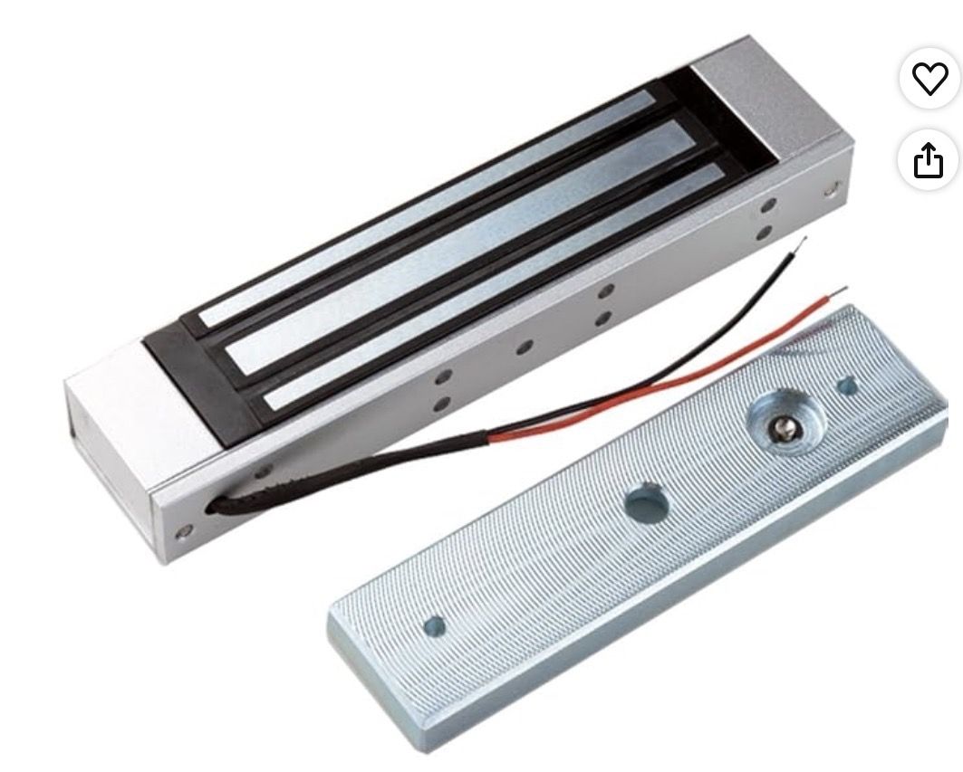

    I have a fairly long and narrow bathroom with doors at opposite ends. I want my guests to feel comfortable, whether they’re using the toilet or having a shower. Are there any sensible solutions that don’t cost a small fortune, which would allow the locks on both doors to be locked and unlocked simultaneously? I’ve come across some ‘miracle locks’ costing 3–4 thousand. I’ve also read about Zigbee or Z-Wave smart systems, but availability in Poland is very limited.
    Hence my question: has anyone here used such a solution and can recommend one? The cost should be no more than a few hundred. As long as it’s reliable, has a mechanical unlocking option (in case of a power cut) and, ideally, doesn’t need to be plugged in (though that can be done if you’re determined).

    I’ve seen this sort of layout before. Two living quarters shared a bathroom. The bolts were fitted in the door frame and were connected to each other so that they could be locked and unlocked from either side; if I’ve understood it correctly, a spindle ran the entire length of the bathroom ceiling, with the bolts mounted on the windows.
    In your case, the only sensible solution is two electromagnets that can remain activated for as long as required. When switched on, the electromagnets lock the doors. In the bathroom, next to the door, there are two staircase switches powering these electromagnets. Each switch independently turns the electromagnets on and off. A power cut causes the door to unlock.
    Such electromagnets are relatively inexpensive and widely used.

    In the bathroom, next to the door, there are two staircase switches that power these solenoids. Each switch independently turns these electromagnets on and off. A power cut causes the door to unlock.
    You just need to think about the possibility of an emergency opening from the outside (an additional cross-switch or switches somewhere out of normal reach).

    What sort of setup is required? They run on 12V, so you’ll need a step-down transformer. One switch (or two).
    Fit it to the door as shown in the picture. In the ‘lux’ version, there’s an indicator light on the door to show when the system is active.
    Emergency opening from the outside? Head to the fuse box, flip the lever down, and you’re all set for a group bath.
