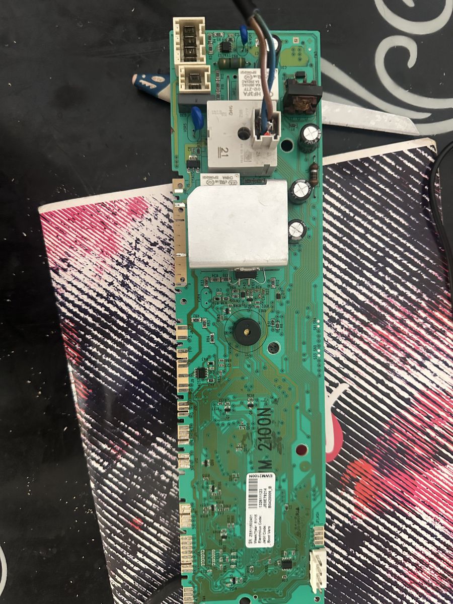

    Hi guys I am troubleshooting an Electrolux washing machine board (EWM2100N). The board lighting up the LED on the start button and another one at the top, and the door lock is not engaging.
    I have verified that the door lock itself is functional. However, the TRIAC (ACS110-7S) responsible for the door lock control shows a leakage of 1 kOhm in my measurements. The board powers on, but the processor refuses to trigger the pump or motor, likely due to a safety lockout caused by the door lock circuit failure.
    Has anyone encountered this issue or confirmed if replacing the ACS110-7S resolves the issue lockout on this specific module?
    Thanks

    Take the measurements of the triac, but either desolder it from the PCB or solder in a new one – it isn’t expensive.

    >>21938582
    I tested all the trics on the board and found the same value 1 kΩ so the triac is not the problem I guess.
