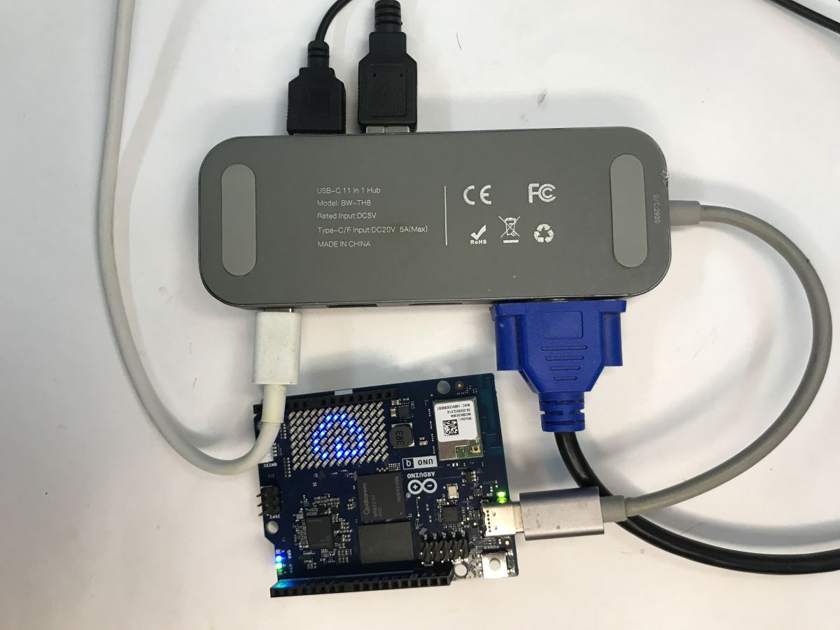

Let’s start with the initial set-up. Essentially, the whole thing can function like a standard single-board computer. To get it up and running, I connected a multi-port hub (model BW-TH8) to the single USB-C port. This allowed me to connect the power supply, monitor and peripherals, such as a mouse and keyboard, all at the same time.

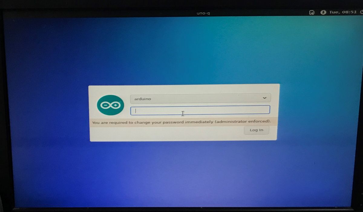

Normally, the system boots up very quickly and greets us with a login screen. The default username is “arduino”, and on the first attempt to log in, the system immediately prompts us to set our own password.

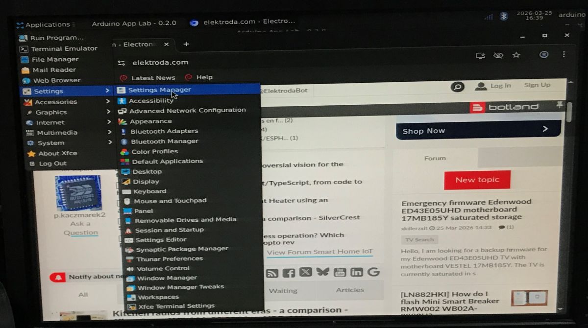

This gives us access to a fully-fledged graphical environment. As you can see, the lightweight XFCE environment is pre-installed, and we immediately have access to, amongst other things, a web browser (you can browse our forum) and the Arduino App Lab tool.

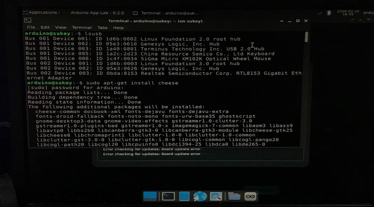

Now we need to test the USB webcam that’s been connected. As we’re using Linux (Debian), all we need to do is open the built-in terminal. I used the
lsusbcommand to check whether the system had detected the devices correctly, and then, with a quick
sudo apt-get install cheesecommand, I installed a popular, simple programme for viewing the webcam feed. The camera works flawlessly.

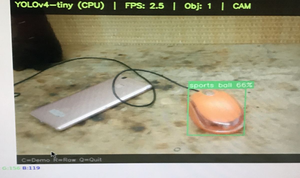

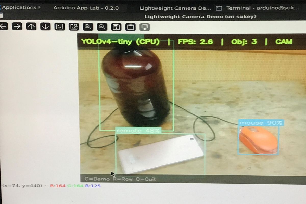

And now it’s time to move on to the actual tests. What does the camera see?

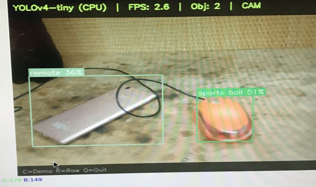

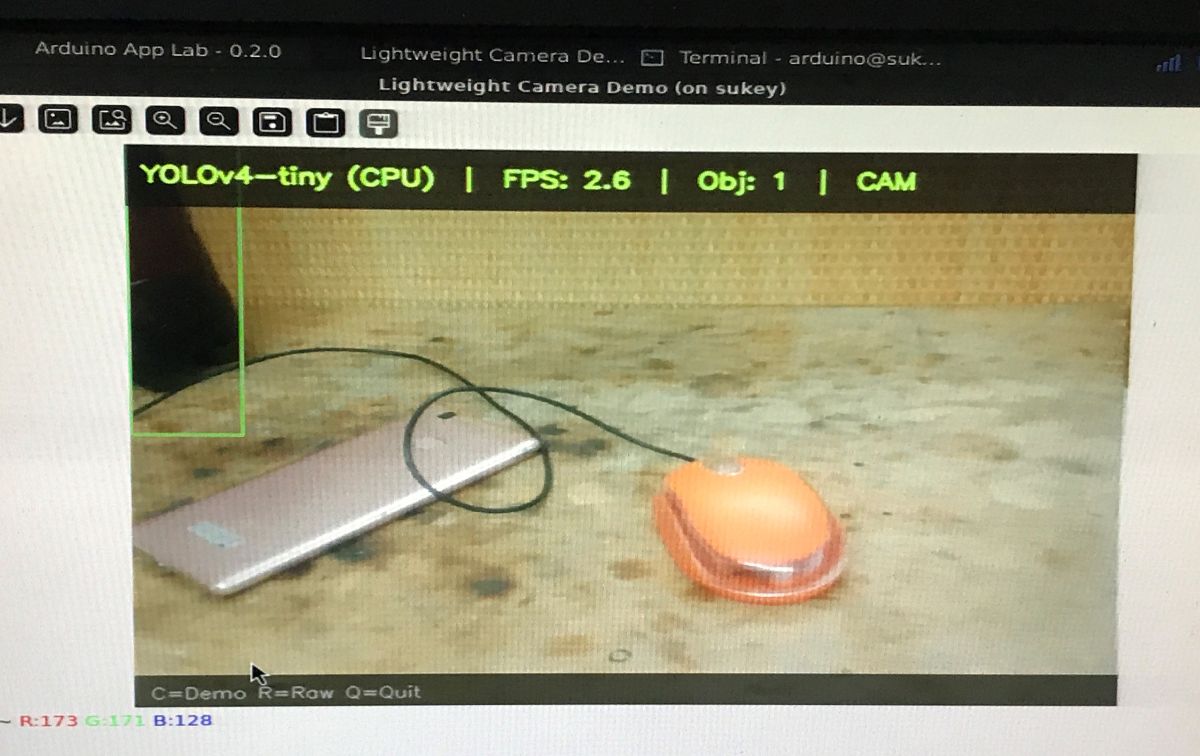

For convenience, I’ve chosen the smallest model – YOLOV4-tiny, running exclusively on the CPU (without any additional acceleration). Unfortunately, the FPS hovers around 2.5 frames per second, as can be seen in the on-screen statistics.

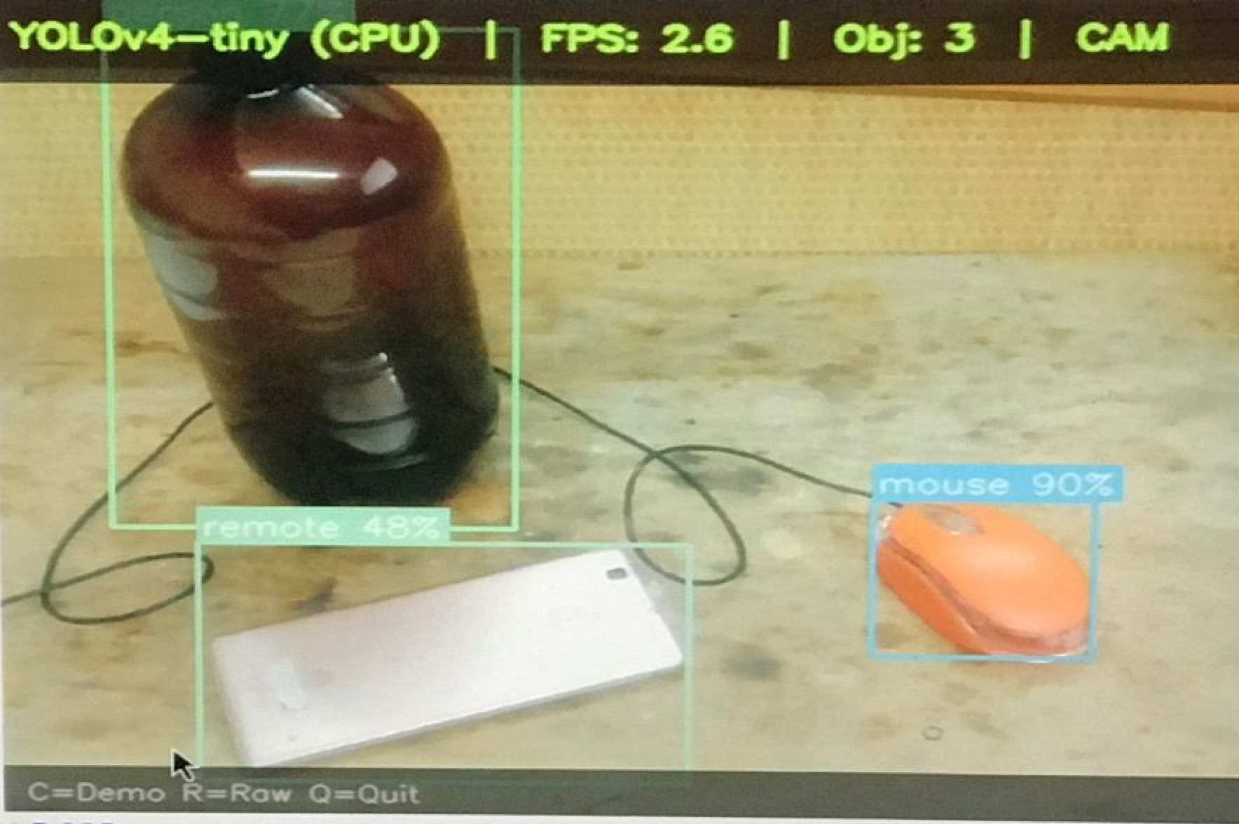

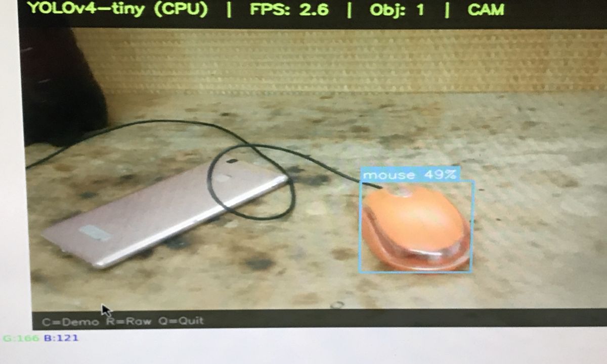

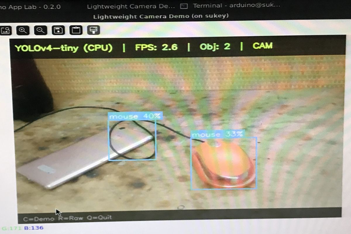

The first three screenshots show that the algorithm has considerable difficulty recognising objects. A smartphone lying on the desk was identified once as a “remote” (36%), whilst a computer mouse was mistaken twice for a “sports ball” (51% and 66%). It was only in the last screenshot that the mouse was correctly classified as a “mouse”, albeit with a fairly low confidence level of just 49 per cent.

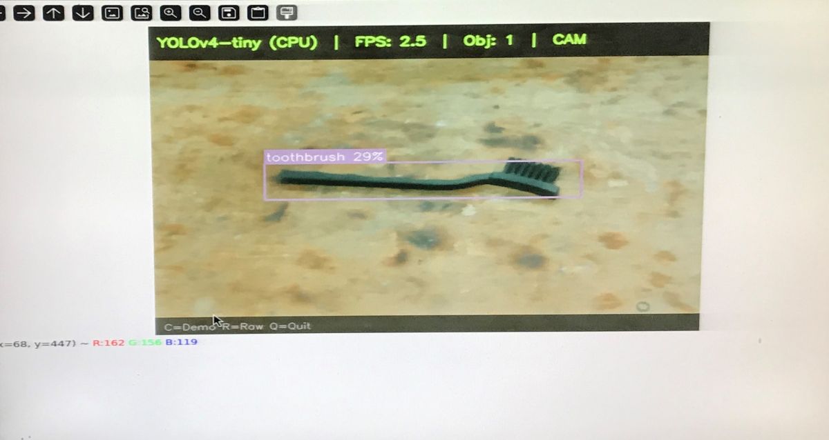

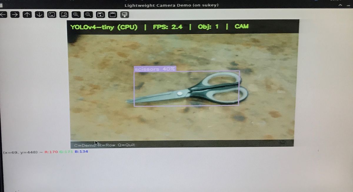

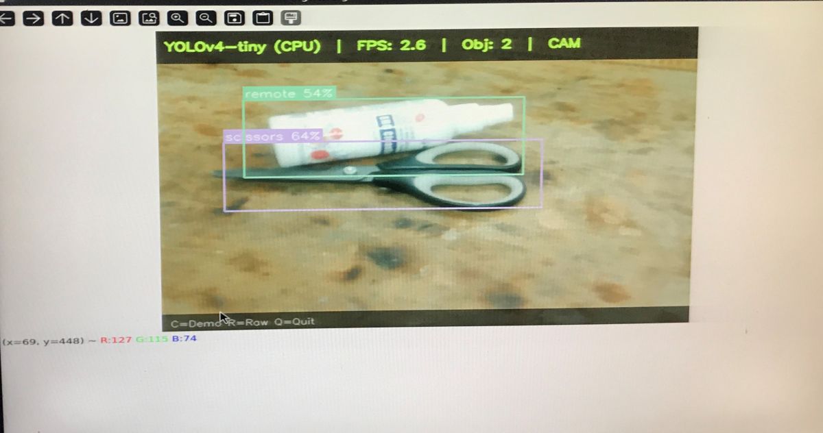

A moment later, we see another challenge. The scissors lying on the table were initially identified quite accurately (“scissors” 40%), but when I added a white spray bottle, it was recognised as a remote control (“remote” 54%). In the final frame, the small brush was ultimately classified as a “toothbrush”, albeit with a confidence level of just 29%.

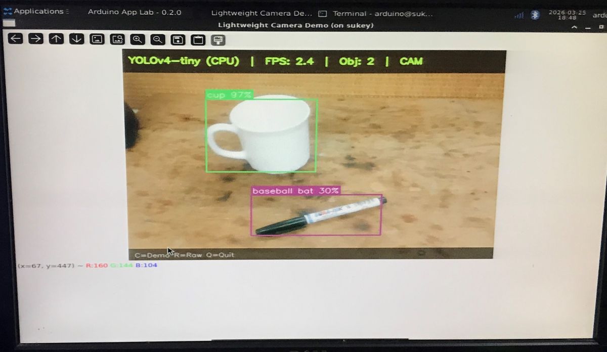

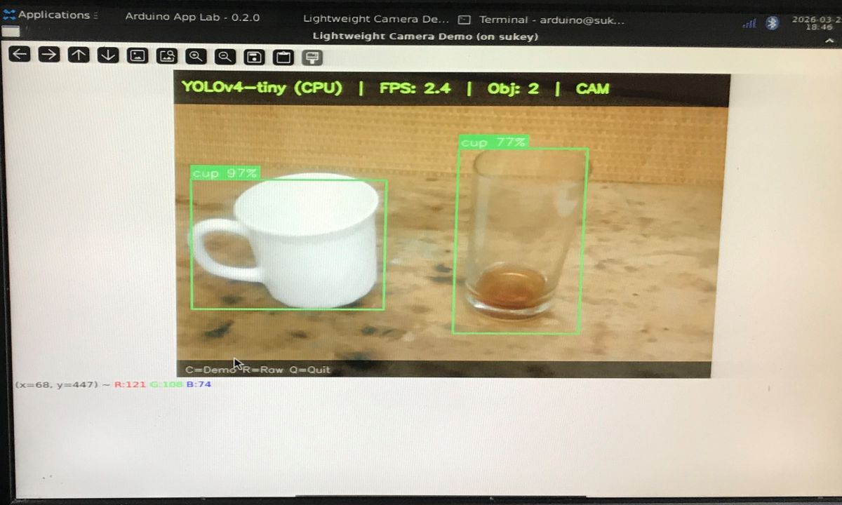

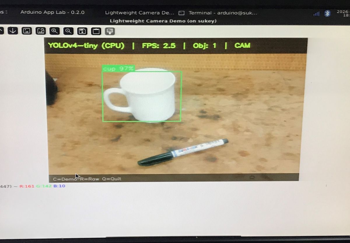

Further tests finally yielded some success, but also brought new comical mistakes. The model correctly recognised a white cup (“cup” 97%) and a glass standing next to it (“cup” 77%). Unfortunately, when a marker appeared on the scene instead of the glass, YOLO mistook it for a baseball bat (30%), and in the next shot, it failed to recognise it at all. In each of these situations, however, the cup was consistently identified with 97% accuracy.

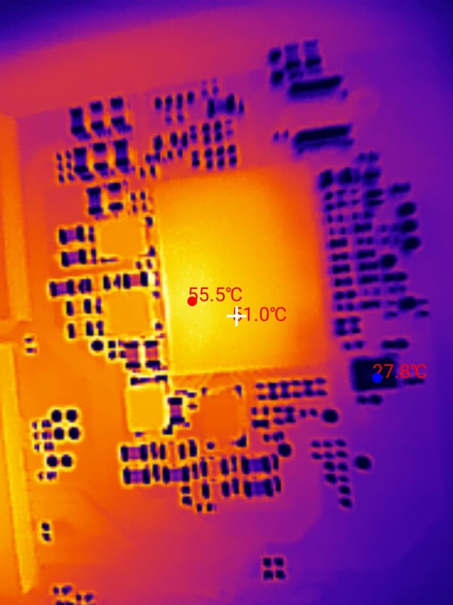

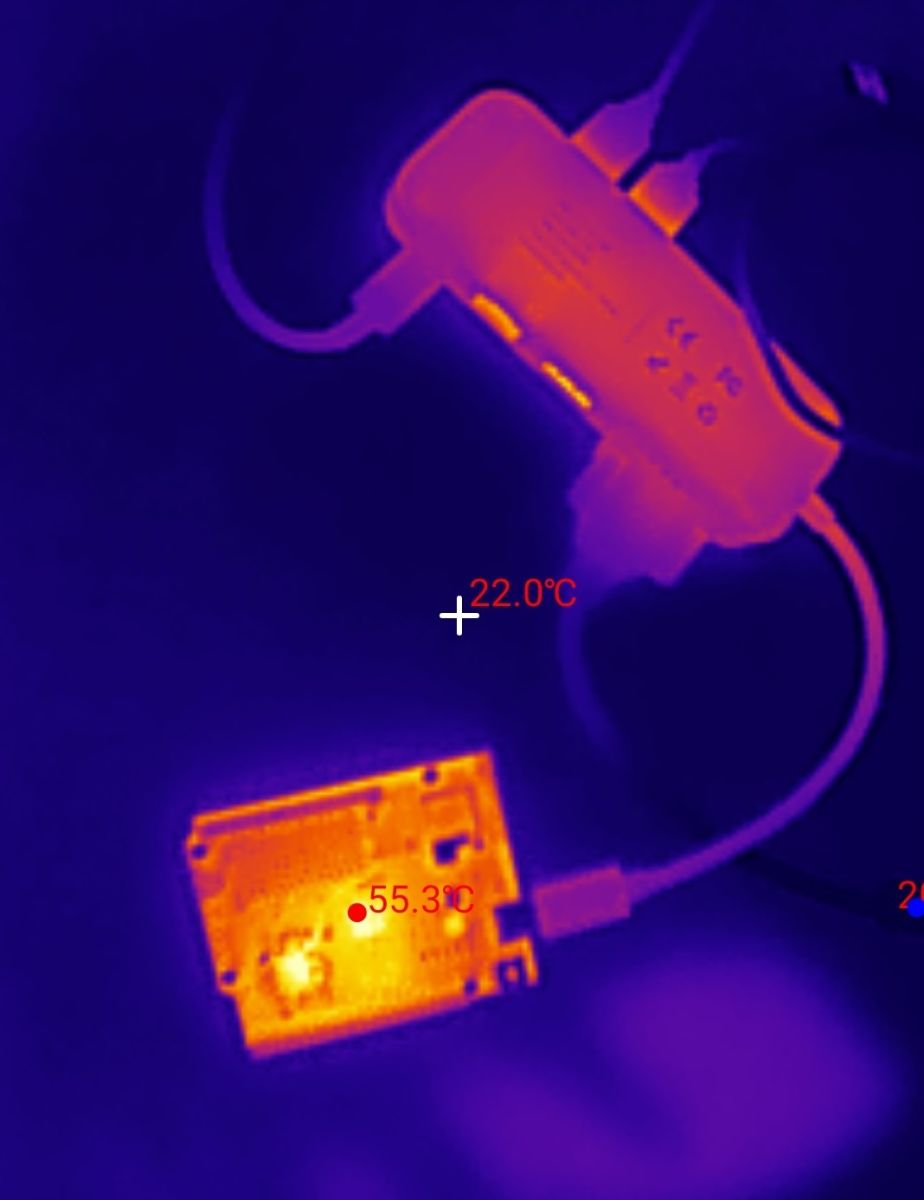

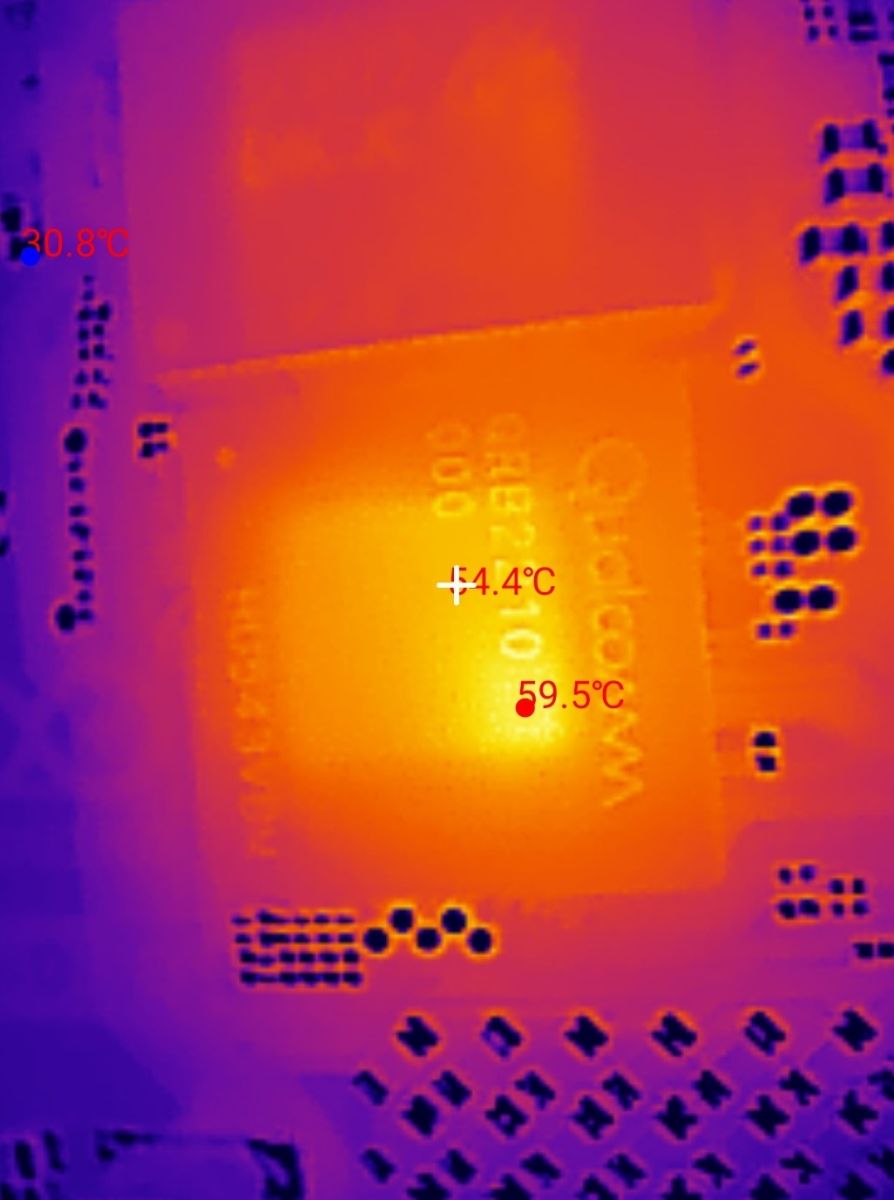

I also wanted to check how the board copes with heat dissipation under load. Measurements from a thermal imaging camera revealed temperatures in the range of 55–60°C. The hottest component on the front panel was, of course, the Qualcomm QRB2210 chipset, which heated up to around 60°C.
The whole unit heats up fairly evenly and there’s little cause for concern about overheating – the underside of the board registers temperatures of around 57°C. However, it’s always worth ensuring adequate ventilation within the case for more advanced projects.
