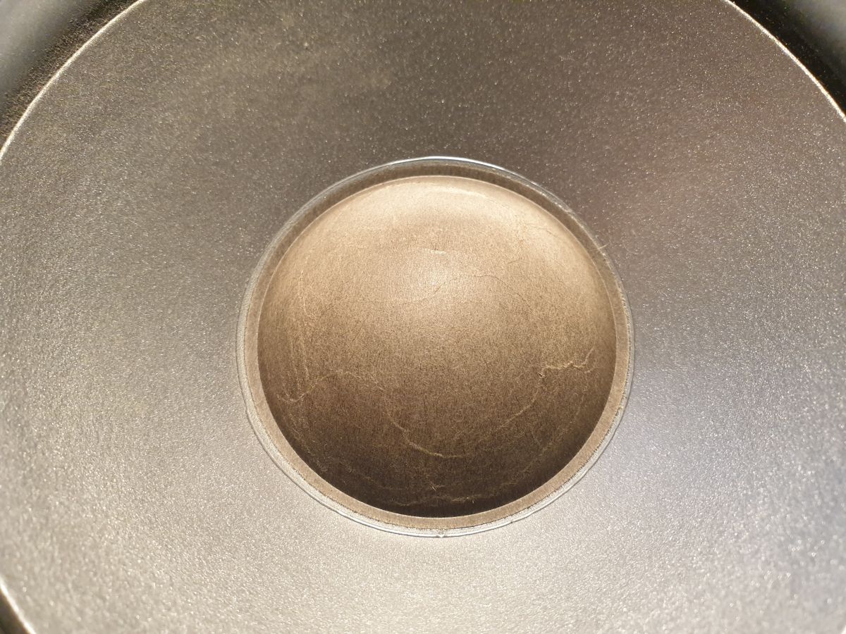

    #16 21228806
    zeto
    Posts: 37
    Rate: 10
    >>2203610 .
    The hoover worked great with my Sony paper low-midrange.
    My only advice: instead of fiddling with the thrust, I opened the air bleed shifter on the handle, pressed it against the perimeter of this "convex" cap and used my finger to obscure the opening (increasing the suction Close-up of a paper mid-woofer speaker dome with slight creases. ). When I heard a 'popping', I exposed the hole and removed the end of the handle from the speaker - the dome looks perfect, apart from the lighter 'veins' at the bends - it was badly dented.
