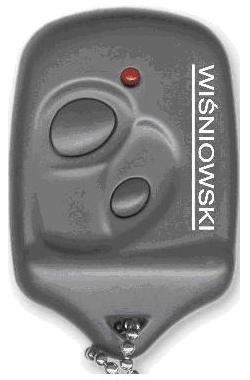

    Gentlemen,
    I also have the same problem.
    I would like to "make extra" my wife a remote control for the entrance gate to the garage.
    The developer wants PLN 150 for the pilot.
    I have already bought a 2k433 dual-channel remote control for PLN 47, such as in the picture:
    How to Self-Code a New Wiśniowski 2k433 (2-Button) Remote with an Existing One?
    Gate drivers are made by Wiśniewski.
    Is there anyone on the forum from Warsaw who would like to undertake the coding of the pilot in Ursynów at a reasonable price?
    I am completely green on the subject :)
    Thank you in advance,
    greetings
