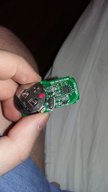

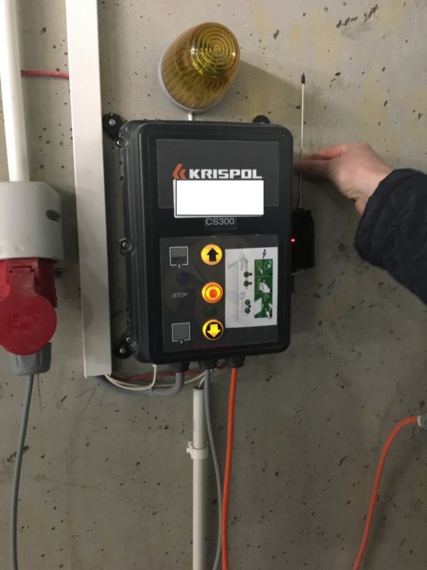

    Upload a photo of the drive, remote control and disassembled pilot.

    Look for the MFZ CS300, but also throw the remote control photo.

    PROXIMA pilot, PROXIMA receiver - unknown coding system.
    If you have the consent of the owner or it is your drive, unscrew the antenna, remove the cover, take a photo of the receiver board.
    Certainly your cloner pilot will not do it.
    If this is not your drive, don't worry - buy a remote control from the administrator.

    This remote control you buy is fixed code and will not fit.
    The transmitter (remote control), as you can see, is from the Proxima company. Question - what is the receiver?
    Proxima manufactures remote controls for most gate systems in Poland.
    Judging by the housing of the receiver, it is also a Proxima or DTM.
    It is highly probable that the receiver is secured with a pin against unauthorized addition / loading of other transmitters.
    I think that it will be easier (and cheaper) to buy another pilot in the administration than to combine it while breaking the law or applicable rules ...
    Sorry Proximilian - we wrote together ... I didn't see Led on the receiver. The Proxima receiver, of course.

    I'll talk to the administrator if he will open this transmitter for me.
    It is not a transmitter but a receiver.
    If you agree with the administrator (which I doubt because the receiver with a PIN is not supposed to be added to everyone later on piloy's request), he can tell you (or let you ask the installer) what system the remotes and receiver work on, then you will buy the right one - and then he will introduce it to you.
    If not - as colleagues wrote above - regret a few zlotys more and just buy from the administration ready.
    Prices - if you buy elsewhere (the administrator turns out to be gracious) - about PLN 50, from the administrator - usually from PLN 100 upwards.

    I am pleased to see a photo of "our work" with the logo of the company in which I work hidden.
    At least we know why the gate in this building works strangely.
    Gate remote controls can be purchased directly from the company that supplied the gate - contact us on the company logo that has been cut or through the administration.
    The price depends on the number of purchased remotes.
    In the future, it is better to contact the gate supplier or building administrator directly ...
    This way, you will save costs related to the replacement of a damaged gate control unit - let the service center come and look for a fault ...
