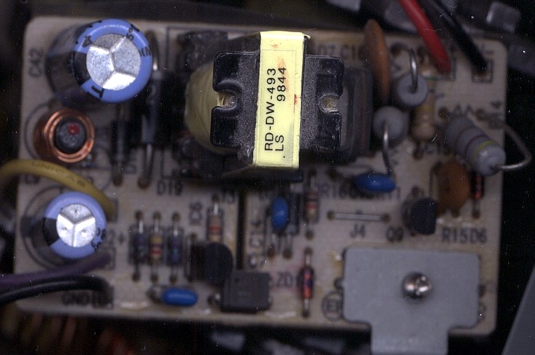

    Burned components:
    Identifying Burned Components in ENlight ATX-723B 230W PSU: 15SP 016 & 08SP 015
    15SP 016 (reference plate TR1)
    08SP 015 (reference on the TR2 board)
    What to do?
    Probably the power supply was very long running in "keybord on" mode, something like that, the power strip was not turned off.
    I am asking for exact specifications of these elements.

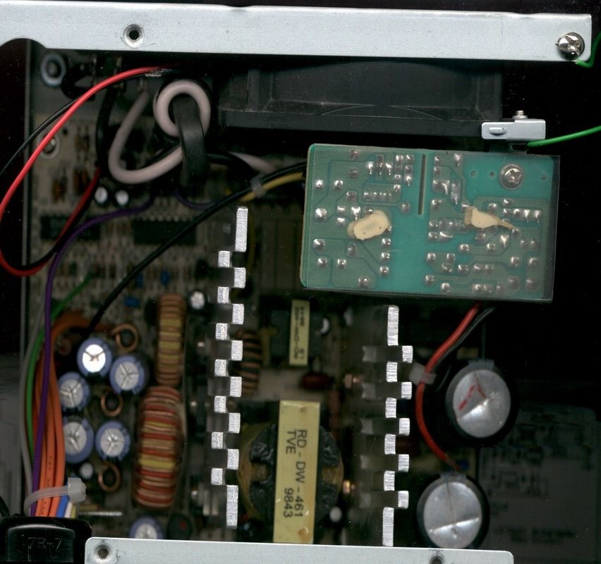

    Since they are varistors, after burning out they should not have a transition, and these have so are good. Besides the bridge is good, good transistors (those on the heatsink seems to be the ones that key Q1, Q2), capacitors (those 2 large C8, C7 200V 470uF) charge, I think I have a short circuit at the diodes (such a double attached to the heat sink) I desorbed one D15 and it is operational. The big one in the middle is also efficient D16. (there are three on the heatsink D14, D15, D16). I'm not sure if there should be such a situation that you can not check D14, D15 on the board (the transition is in each direction)

    Identifying Burned Components in ENlight ATX-723B 230W PSU: 15SP 016 & 08SP 015 Identifying Burned Components in ENlight ATX-723B 230W PSU: 15SP 016 & 08SP 015
    I replaced the 560K (0.5W) resistor,
    After shorting green with black starts me only for a moment why?
    I charged him with an old CD-ROM, and at the output of the stand-by system I have 5V on purple, 20V on yellow, and at the ATX output I have 4.5V on green 5V on purple.
    I suspect that something is still to be exchanged.
