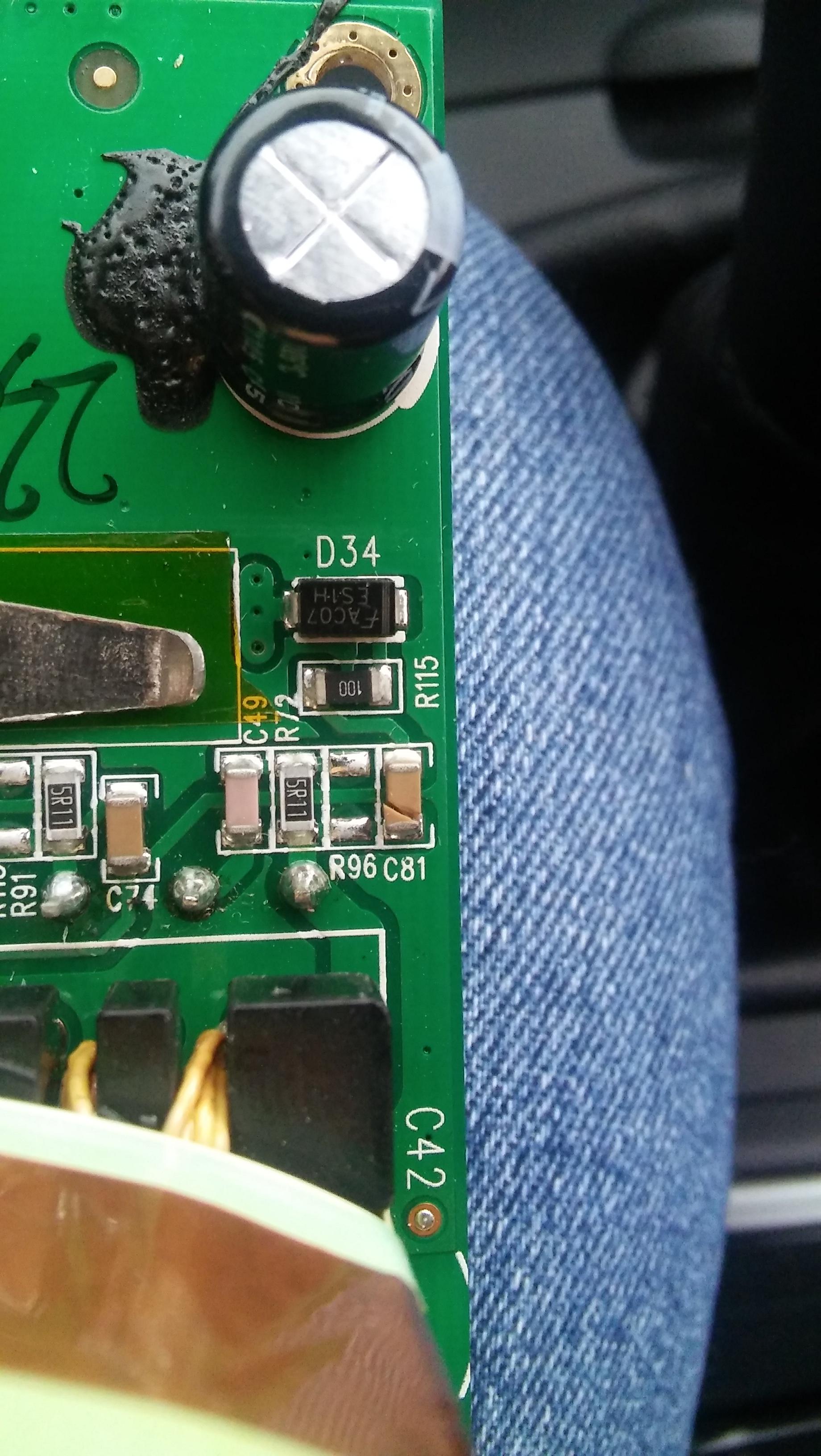

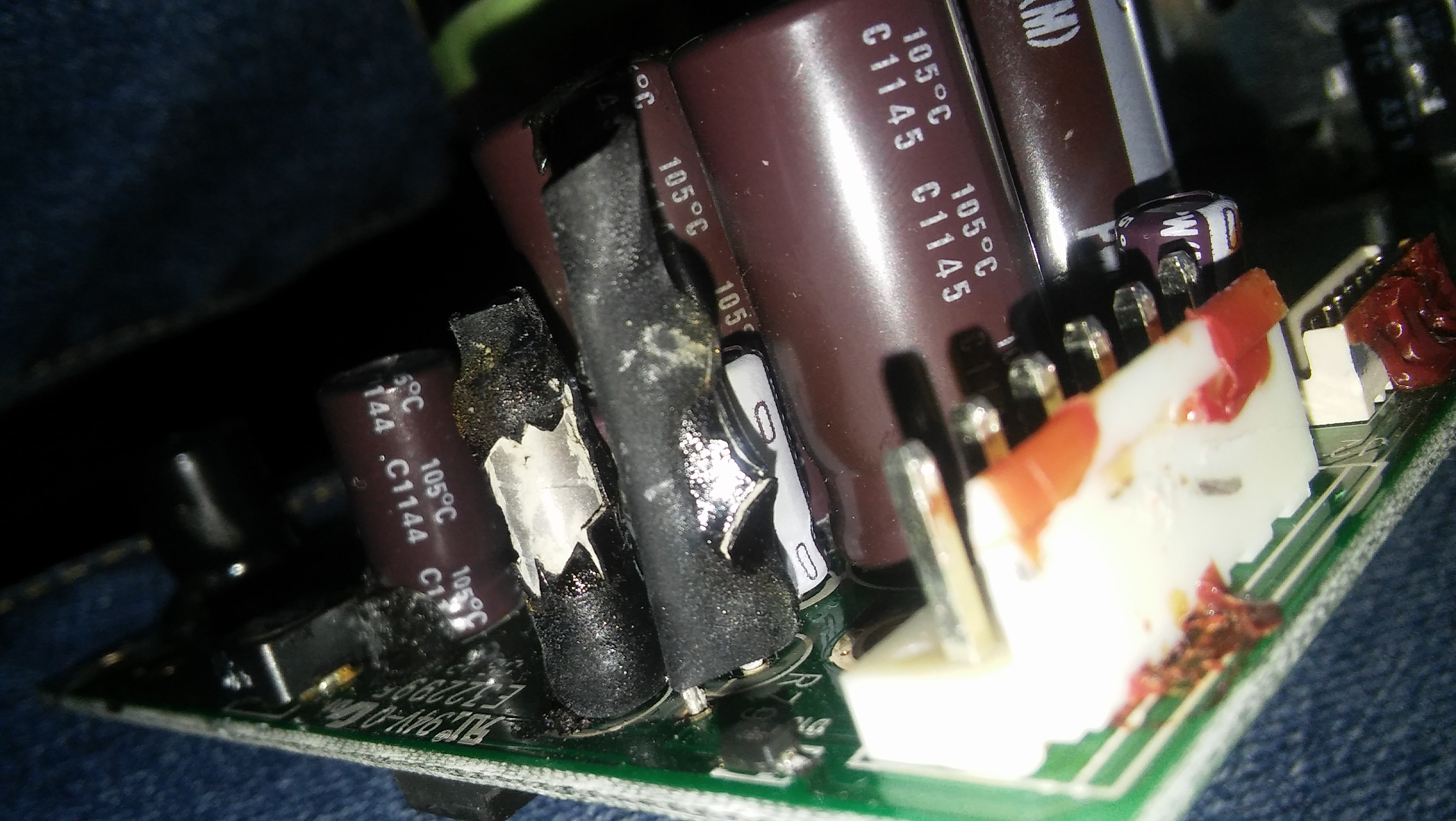

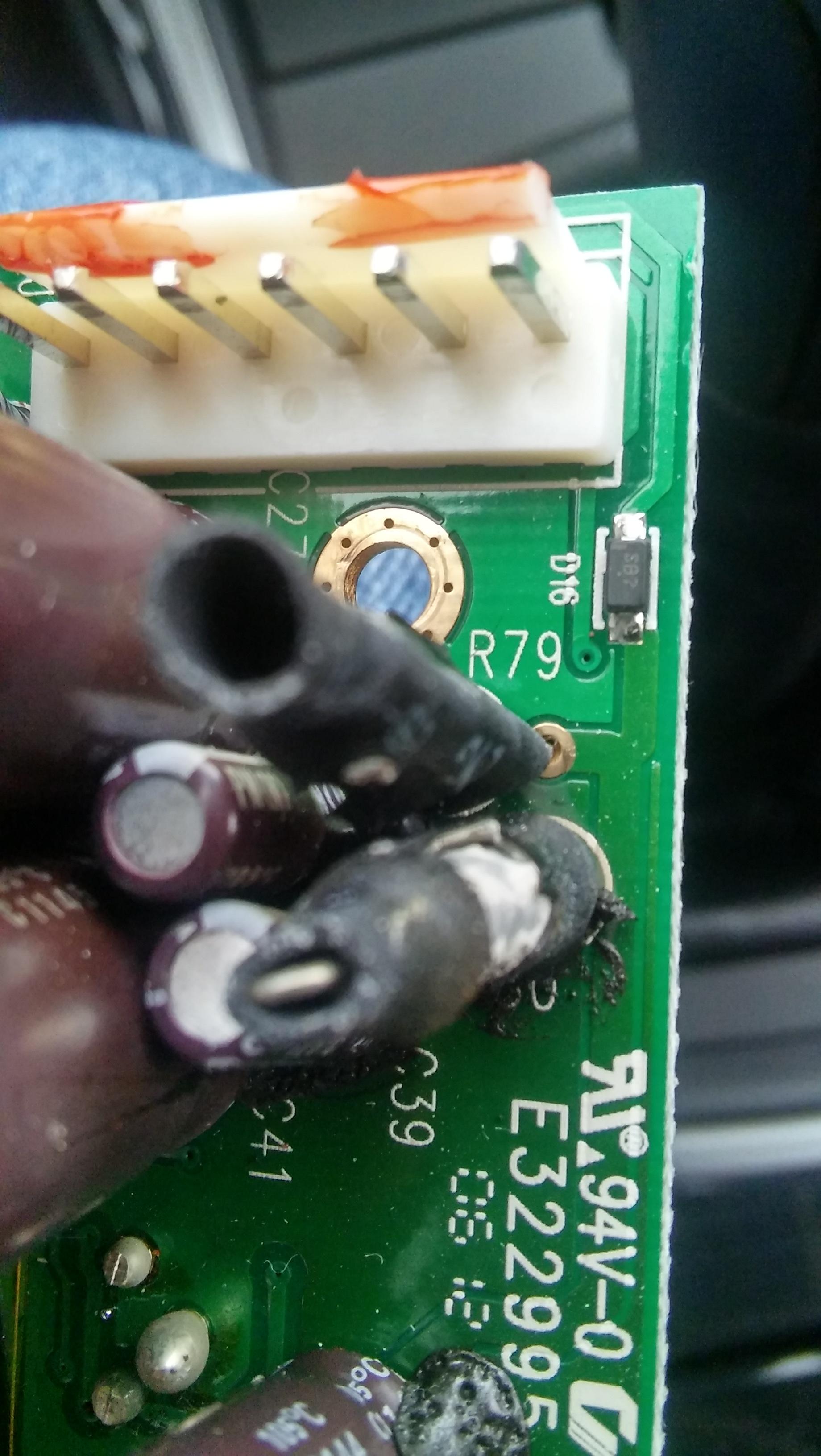

    Hello. The set included the power supply that is placed in the subwoofer. The case looks dull, because one of the resistors charred and desoldered from the temperature. I couldn't find a service manual for this crap anywhere on the net. Can any of my colleagues help? The power supply is marked 94V E322995. It would be nice if there was a service available :) The charred resistors are R26 and R95. Without a schematic, don't move, because these resistors probably did not burn themselves.

    Upload photos of the entire board and an approximate photo of the area around these resistors.

    Below are the photos you requested.

    Hello. Could someone please tell me the values of some of the components of this power supply? Exactly, it's about C81 at the converter and 2 resistors R79 and R80 right next to the connector.
