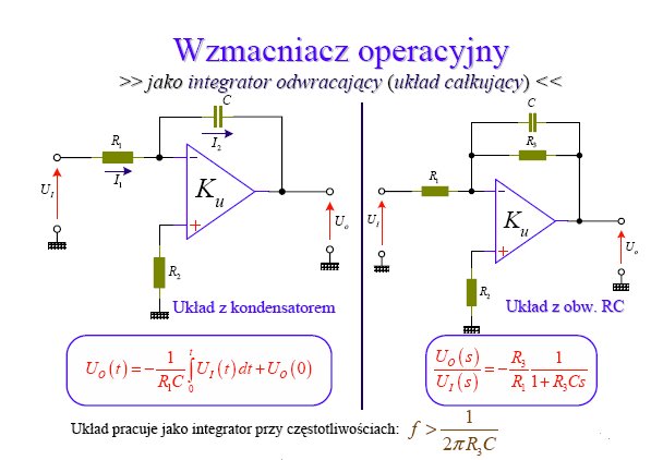

    Thank you for the explanation :) Where in the diagram this point falls, please provide an example drawing

    please, here is a sample schematic:
    Understanding Apparent Ground or Virtual Ground in Operational Amplifiers
    Virtual ground potential on both schematics have inverting (-) inputs of amplifiers.
    And this is mostly the case in all circuits with differential operational amplifiers operating with a closed feedback loop. It is the response of the feedback loop that forces a virtually zero potential difference between the inputs of the amplifier.

    With this apparent ground is that an ideal operational amplifier has a voltage gain of infinite magnitude and the operational amplifier strives to have the same voltage at its inputs.
    That is, for the schematic what GregBa gave.
    The non-inverting input is connected to ground. The amplifier „wants” that the inverting input also has the same voltage, that is, 0V, and so controls the output so that this voltage is 0V. That is, we can say that the inverting input has the same voltage as the non-inverting input, so we have, as it were, a virtual ground on the non-inverting input.
    Look at Fig18 and compare with Fig17 from this course, and you will find the answer to your question about the voltage value of this „almost ground”.

    When it comes to the first schematic, the formula for gain is the same Ku=R2/R1 only in this circuit instead of R2 we insert a capacitor C.
    As you know, the capacitor for direct current constitutes a gap i.e. we have an open loop and the gain is equal to the gain of the operational amplifier itself.
    As is known, for alternating current, the capacitor represents a passive resistance called reactance Xc=0.16/F*C depending on the frequency (reactance decreases with increasing frequency).
    So we have an amplifier whose gain is Ku=Xc/R1=0.16/F*R1*C
    With increasing frequency, the resistance of capacitor XC decreases. Thus, the gain also decreases. This circuit is called a low-pass filter because it attenuates high frequencies.
