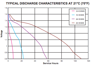

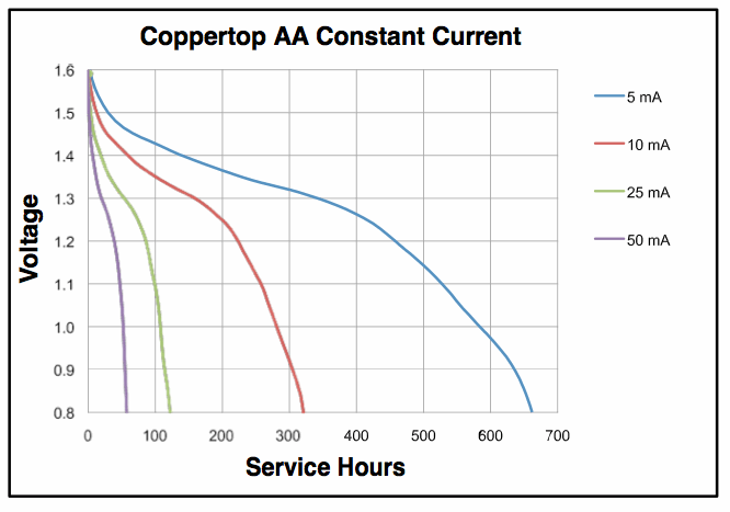

    Batteries should always be checked under some load, i.e. with a resistor. As long as checking with a meter
    will directly give you an indicative assessment, but you can be fooled. The voltmeter has a high resistance
    in order not to disturb the tested system. Battery measurement on open contacts shows
    voltage as it would be when connecting a ~ 100 Mega ohm resistor, i.e. with a negligible load.
    If we connect the battery with a resistor selected so that the current is close to what it is in
    a good battery - powered device and we will measure the voltage, then we will be able to judge
    battery condition. Measuring the voltage with a good battery will show a value close to the nominal value. Bad measurement
    even one that seemed good when measured with open contacts, will show a significant voltage drop
    with a tendency to further decline. Battery manufacturers provide characteristics of voltage drop over time
    at load with different values of resistors.
