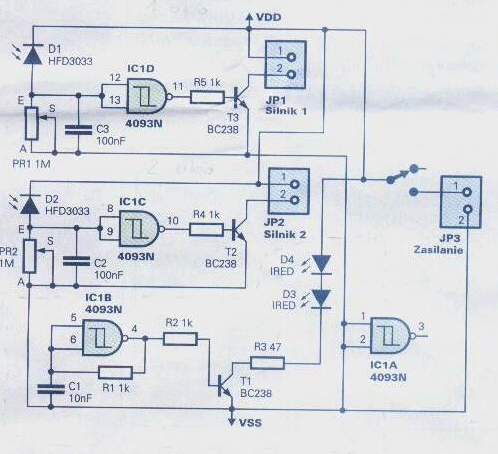

    Hello! I have a problem that when in some electronic scheme there are meanings such as vdd and vss, I immediately give up their implementation because I don't know what it is and where to connect it :( from what I know, it's probably masses, but where is it connected in the system ?? :( please be understanding because I am just starting my adventure with electronics :)

    Vdd is the voltage (exactly V is the potential) which is the power supply circuit of the unipolar transistor
    Vss supply voltage of the source circuit of the unipolar transistor

    and in this system what should I connect to?

    VSS - "GND" - Ground
    VDD - "+ supply voltage"
    more precisely, Vss is the negative power terminal ... in many constructions it is the "GND" ground, but not always ;) eg with symmetrical voltage supply, there is a separate ground potential and must not be connected to Vss

    ok thanks for your help, the topic can be closed :)
