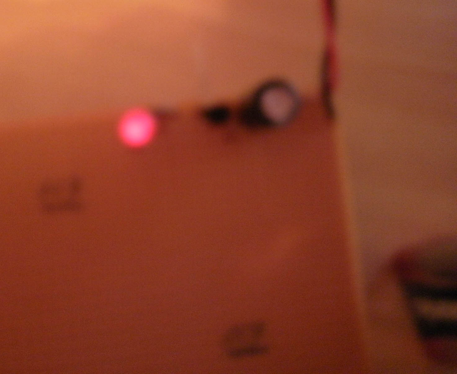

    My first post on this forum. I decided to put together the flashing LED chip presented in this topic and of course it doesn't work! :) parts I used:
    - 2.2k? resistor
    - 1000uF / 10V capacitor
    - BC547 transistor
    - 9V battery
    after connecting everything, the diode burned out - at least that's how I understand it, because first it caught fire, and then it burned less and less until it went out. I replaced the diode and gave it a 220? resistor. Now the LED is on but not flashing. I thought maybe I soldered the transistor upside down, but when the transistor is inverted, the same thing happens. The LED glows barely and does not blink. Anyone have any idea what I could have done wrong?

    Make the latter with two LEDs, it will definitely work.

    Thanks a lot, but first I would like to understand why the circuit I did not work. Today another three LEDs burned out, I wonder how is it possible since I used a 2.2k? resistor and it seems that a 350? resistor would be enough for 9V?

    maybe put it "on a spider" to be sure or check the connections for short circuits etc.

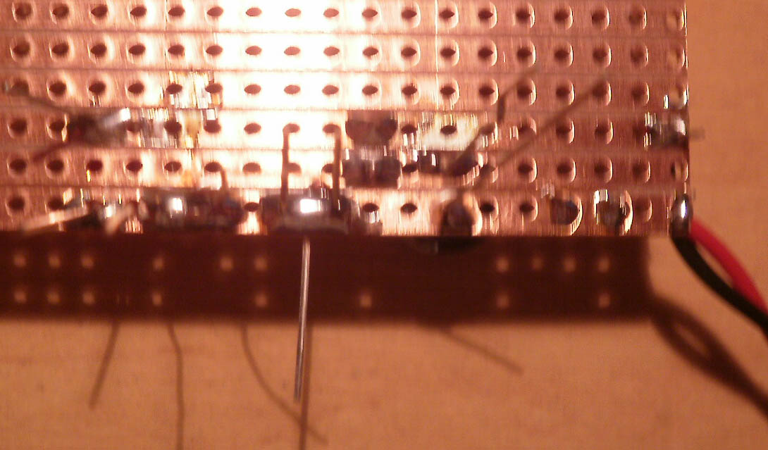

    I figured out myself why the system was not working. I soldered everything on a universal board with parallel longitudinal tracks. Of course, I forgot to scrape the copper between the feet of the components ;) so it turned out that the resistor was connected in parallel and not in series.
    I corrected this error, but the circuit is still not working, what I noticed is that the diode starts to glow when I touch the base of the transistor with the emitter and if I stretch the protruding resistor foot and touch the emitter with it. The conclusion is that the capacitor does not fulfill its role in the circuit and in fact something may be wrong with it, because when I bring its legs closer together, no spark will jump. Any suggestions? :)
    greetings

    Do not play with it with one diode, because I have seen hundreds of posts that it does not work, they had to mess around before they launched it, do it with two diodes, because at least it works right away when done well.

    I was tempted to do Link circuit for BEAMbot Apparently the simplest that can be with a zener diode, two transistors. I used a solar battery from a calculator (gives 1.5V) and a pager motor. I placed the circuit on a universal PCB. Of course it doesn't work :P I have a few observations, maybe thanks to them you can help me determine the cause.
    - When I connect the zener diode with a wire, the motor starts to move for a moment, which proves that the capacitor is charging.
    -When I connect a 9V battery to the capacitor feet, the whole circuit works like crazy.
    -When I connect a 1.5V battery to the capacitor, the system does not work. It starts working continuously when I shorten the legs of the zener diode for a moment.
    do you have any ideas what could be wrong? greetings
