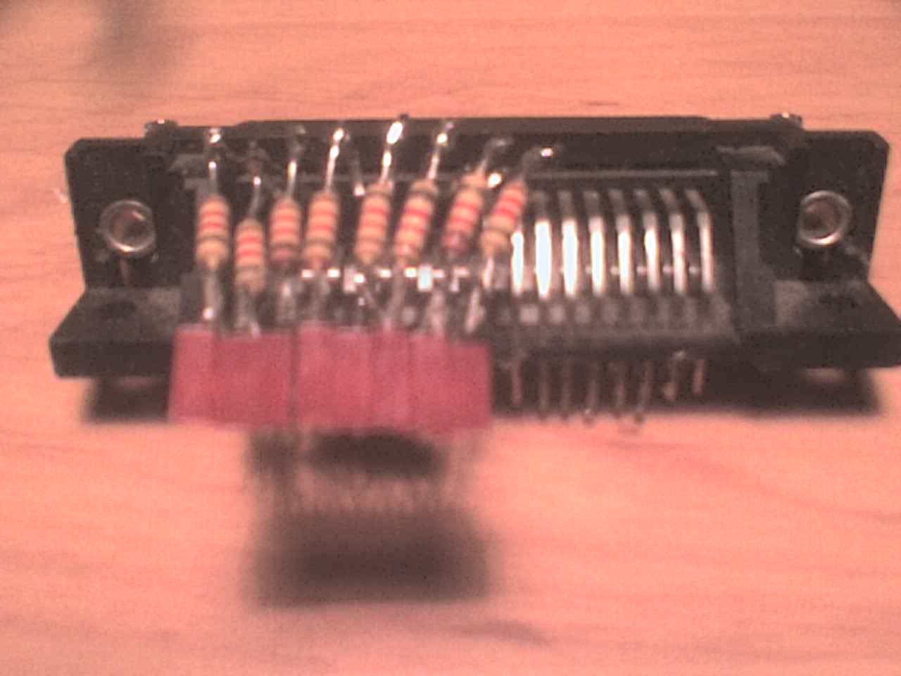

    make yourself led lights for the computer
    eight LEDs
    you connect plus the diodes to pins 2-9
    and the minus you connect and to pin 25
    there are plenty of programs to control
    even on the electrode in the download section there are two
    then you can expand the circuit and instead of diodes, insert npn transistors and connect relays to it
    possibly triacs and without relays
    and you have a home control system :D
    I still have a program to control these devices on lpt via the internet :D

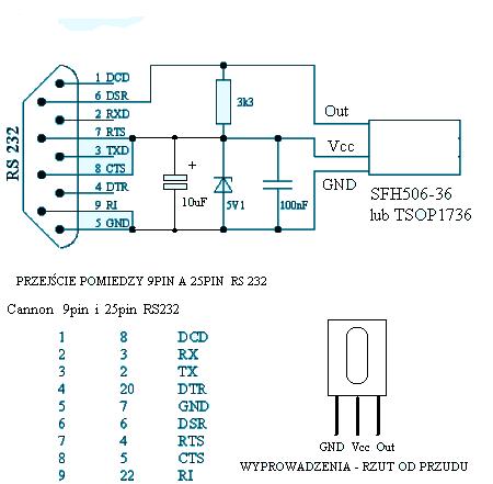

    or do a se girdera
    it is a coma infrared receiver
    you can control the computer with the remote control

    When it comes to this girder, don't take a risk, I burned the com port: / And this led.jpg project, with each led, the resistor should be separate (when you turn on all the LEDs, it's a bad effect (I apologize in advance for the poor quality of the photo)

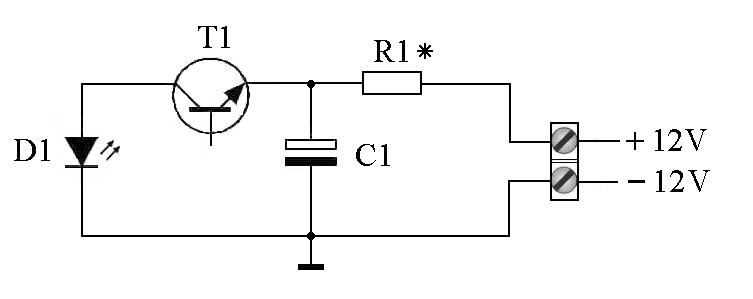

    Try to make such a toy
    Beginner-Friendly Electronic Circuit Layouts: LEDs, Capacitors & Easy Projects for Students
    It doesn't have to be 12V at all, I connected a flat 9V battery and it worked too
    I put on a regular diode with increased brightness 3V 5 mm and somehow it holds (it flashed continuously for 30 minutes). The best transistor is bc547 and the capacitor and resistor depend on the length of the blink and the length of the pause
    resistor - break capacitor The length of the diode's flash.
    I put a 10k potentiometer and a 1000 uf capacitor.
    greetings

    This is my first post on this forum. I am a beginner. I have a question for the above layout. Will the transistor T1 conduct if no current flows through the base? I don't think so, but please reply.
  • #19 6300227
    bejano
    When no current flows through the base, no current should actually flow through the transistor, unless the voltage is so high that a breakdown occurs. The operation of this system is precisely based on the breakdown.
    At first, nothing happens because the capacitor is charging. Then the voltage across the transistor increases to 12V minus the voltage drop across the potentiometer. The potentiometer should be set so that the voltage across the transistor slightly exceeds its breakdown voltage. Then current will flow through the transistor and the diode will glow. At this point, the capacitor starts to discharge and the voltage drops across the transistor. The transistor (if it is not damaged) stops conducting again and the diode turns off. The whole process starts all over again, i.e. the capacitor is charging etc ...
    With the appropriate potentiometer setting, the diode should blink. If it is still on, either the potentiometer has too low resistance or the transistor has been damaged

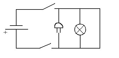

    In my technique exercise class there is the following task:
    "Make a project and draw a diagram of the alarm system, e.g. securing the car against theft. The system is to consist of:
    -battery
    - bulbs
    - the ringtone
    -two switches
    The installation is to meet the following conditions:
    - with each switch we can turn on the bell and the light bulb at the same time.
    - unscrewing the bulb does not affect the bell operation and vice versa. "
    I drew such a diagram, but I would like to ask you if it is well drawn :)
    https://obrazki.elektroda.pl/19_1239613093.jpg
    I am waiting for a response :)

    Bad, because the first condition is not met, the circuit breakers should be together in parallel.

    Please
  • #24 6412832
    Alann7
    Posts: 58
    Thanks :) And did the bulb and bell do well? (I forgot to give these connections only).

    Hello, I have a question - can someone explain to me what it is:
    R1 *
    T1
    C1
    D1
    i bought all the parts but i don't know how to put it together.
  • #26 6470209
    Alann7
    Posts: 58
    These are the markings in the diagram, eg R1 will be a resistor, T1 - transistor, D1 is a diode. It can also be R2, R3 because these numbers only number them to make it easier. You can connect everything on a universal board. :)
