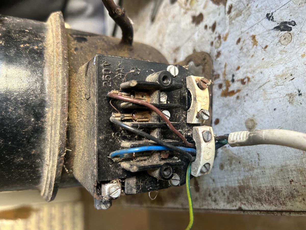

    marcinkozuch
    Posts: 93
    Rate: 62
    Can anyone suggest what and how ? As with this black and two free contacts
    Close-up of motor wiring with visible wires and two unused terminals
