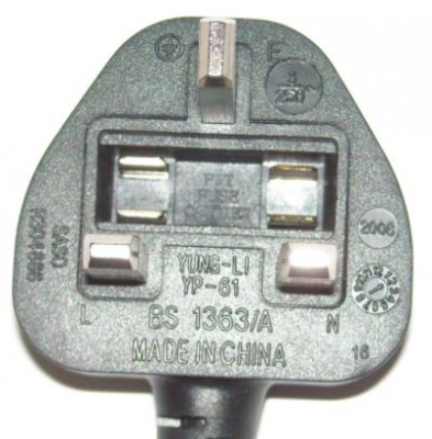

    Despite the request of my friend Krzysztof, I will explain and attach photos.
    My friend HeSz You can't apply the Roman maxim when the law sucks. If in one object the sockets are connected in the same way and in the other, they should be connected well in one object and wrong in the other. This is an example of a law hole because nothing can be questioned as both are correct.
    It will also be correct when in one object, or even in one room, the phase will be on the left and on the other side of the socket.
    It only remains to refer to the principles of good work, i.e. the principle you mentioned.
    And the matter is very simple when looking at the socket we accept phase (phases), neutral and PE clockwise (as it is assumed in Europe).

    There have been many quarrels about this. I would like someone to explain to me why any device would work incorrectly or not work at all if we swapped the N and L wires in the socket. But it does not matter. Well, unless someone is born in the military (put the socks on the left, the razor on the right - that is ch ... oh but the same :) .
    This is important when there is a fuse in the plug, as shown in the picture, but in Poland, fuse sockets are not used.

    You forgot to mention one. In the sockets you have attached pictures of, there is a clear L and N mark !!!!! And in Poland?
    And the photo shows: L, PE, N - according to the rule you give!
