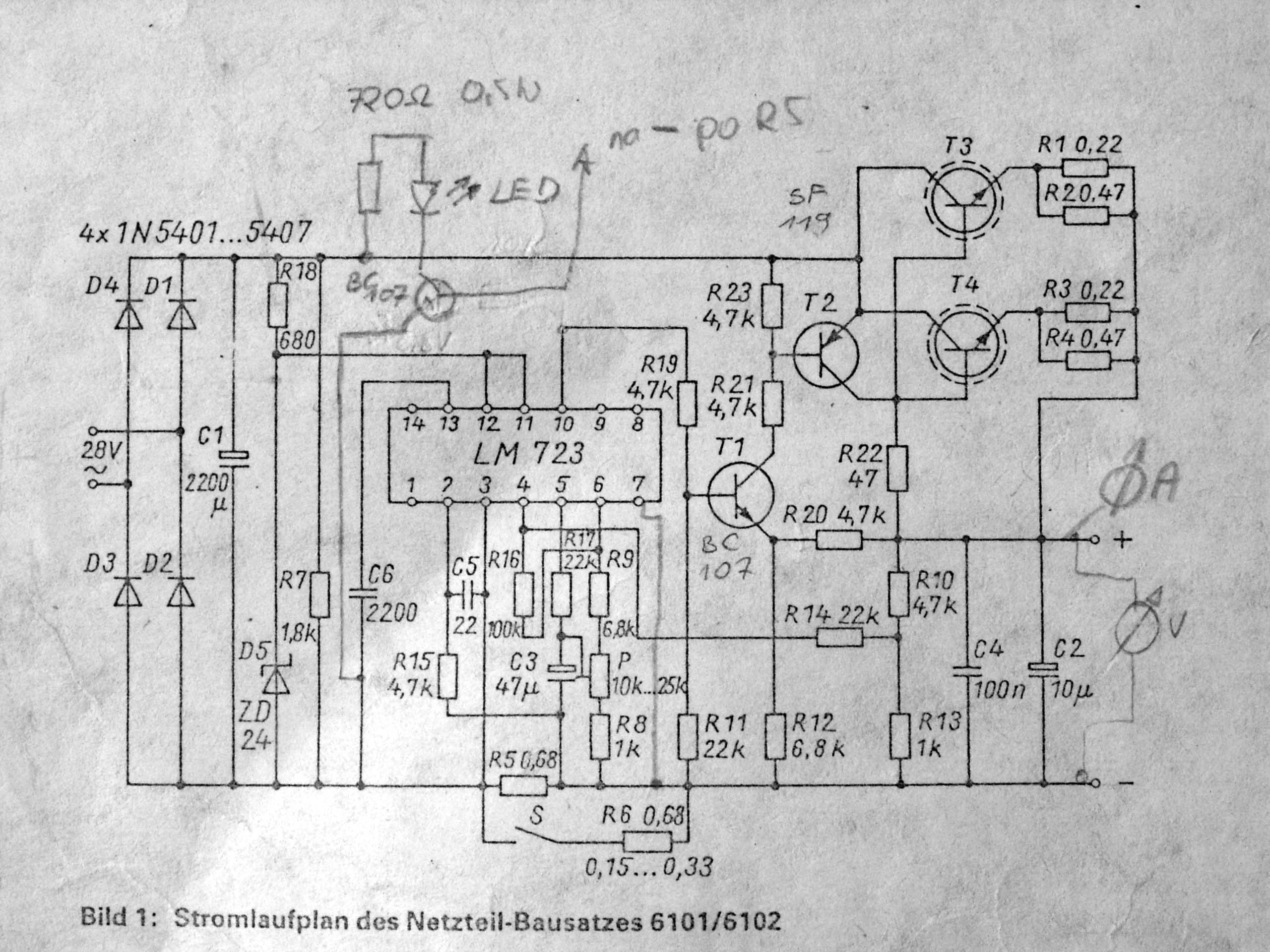

    To my colleague PIEF and others.
    In order not to assume a new similar topic, a few photos and an explanation and a diagram of the power supply.

    The power supply I put was directed, among others, to my colleague PIEF, who asked for a diagram. I attached a description and photos additionally. If someone else is interested, it will be good.
    Additionally, I will attach the diagram again.

    A tiny note: I don't see a smooth regulation of the output current here, so the description of "0-3A" is misleading.

    Hello Alpha.
    I did not write about smooth current regulation. Current limitation in steps and voltage smoothly, coarse and accurately.
