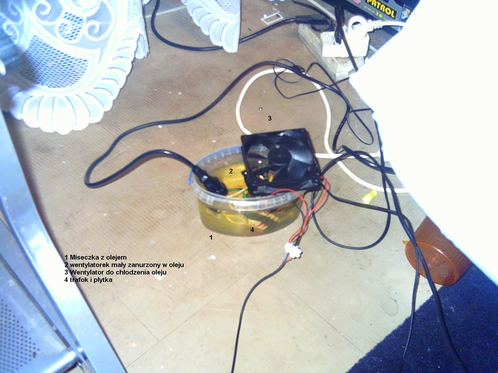

    Hello, as in the topic.
    I saw a video of how the whole computer was immersed in oil.

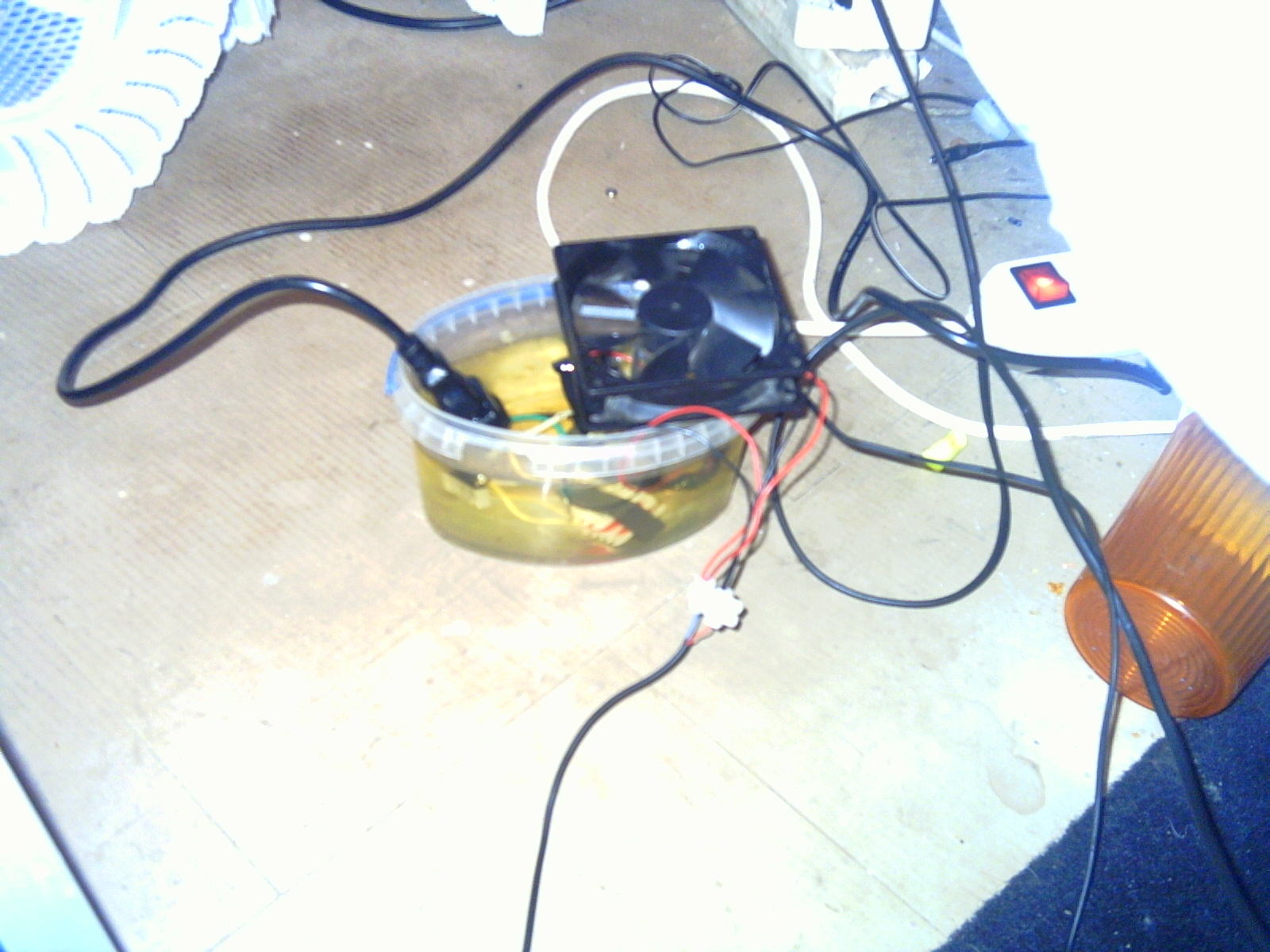

    I was curious and did a small test I took oil HAUSGOLD Universal oil.
    I poured a little into the small container (after herring) and put in a computer fan and fed it from a small 12 V / 1 A power supply.
    It worked and so I turned off and put everything in the power supply with the cable from the power supply to the inside and the sub-zero in full fear or something will not be destroyed. I turned on and started working.
    Now the main question.
    Because something like that can be done with distilled water (CLEAN water does not conduct electricity)
    But after some time the water can absorb the chemical components from the air and the plates of the hands of the breath, which after a certain time of use or carelessness can become a guide.
    The question is, can the oil be the same?
    Because if not, a simple computer cooling system / an open-loop cooled component can be made.
    What I'm going to do.

    Transformer oil is used for such purposes. There was already a forum discussion on oil cooling. Look for.

    Hmm ... after reading, but there is no answer there.
    Plus that I just used :D cooking :D
    and I want to use it as the cooling of the whole computer, that there is a set of fans in the top.
    As I know, liquid can absorb heat more easily and give it back.
    And you do not have to tinker with heat sinks.
    I will then provide a schematic drawing.
    test photo
    Submerging Computer in HAUSGOLD Universal Oil for Cooling: Conductivity & Open-Loop Systems
    I :D testing it like :D

    Oil cooling is nothing new. Transformer oil would be appropriate, has a different consistency and chemical composition than edible. Only is it a practical solution at home? Such solutions are used in industry.

    In fact, the consistency is different from the transformer one. BUT, heat takes over and gives away quickly!
    The only disadvantage is that the heat does not want to go up quickly and you have to move in a small movement.
    That's why there's a small fan there.
    How these tests will burn up to 500 MHz P 2 will go for the test:]
