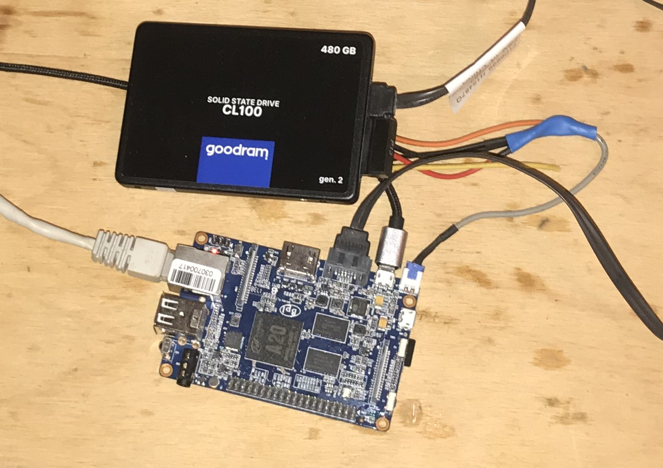

Soldering the 2.5" drive power cable with the Banana Pi
The Banana Pi BPI-M1+ has one SATA connector on board. Connecting a 2.5" drive to the Banana Pi essentially requires two cables:
- a standard SATA signal cable
- a SATA power (5V) cable - unfortunately a rather unusual one, generally fitting into the two-pin 5V connector on board the Banana Pi.
You can get both of these cables in combined form from several online shops, I recommend searching under "banana pi sata cable", they look like this:
But I didn't want to wait for the project to be shipped, so I soldered a suitable cable myself to start with from what I already had in my drawer.
I used a two-pin cable with a plug:
And wires from an old computer power supply:
Before soldering, I double-checked the polarity of the connector from the Banana Pi - connecting it the other way round would certainly damage the drive.
Finished adapter:
I tested the adapter with an old 2.5" drive, still without SD card in the Banana Pi:
By the way, I measured that even without the SD card, the Banana Pi itself with the 2.5" HDD draws 0.4-0.5A.
I also used a SATA data cable to connect the drive:
Full disk connection:

Power consumption after 2 weeks of use
I will describe here the results of measuring the server's power consumption already normally in operation, measured with a plug-in power consumption meter purchased in China on a V9261F chip.
I started up the server and left it switched on for 2 weeks without an enclosure. Only the Ethernet cable and the SSD were connected to the Banana PI. OpenMediaVault was running on the server along with an enabled torrent client providing the aforementioned .ISO images of the operating systems. This was to create additional load - so that there was always something going on in the network. In addition, of course, Samba was also enabled and I backed up files from my PC to the server from time to time. I also used it to flip files between computers.
The results of the measurements (from the photos above and the calculations) are as follows:
Energy measurement - time since switch-on: 13 days, 20 hours and 31 minutes -> approximately 332.5h non-stop operation.
Highest recorded power measurement: 4.3W
Power consumption during this period: 0.756KWh
Average energy consumption per day: 0.055KWh
Average power: 0.756KWh/332.5h = 2.23W
