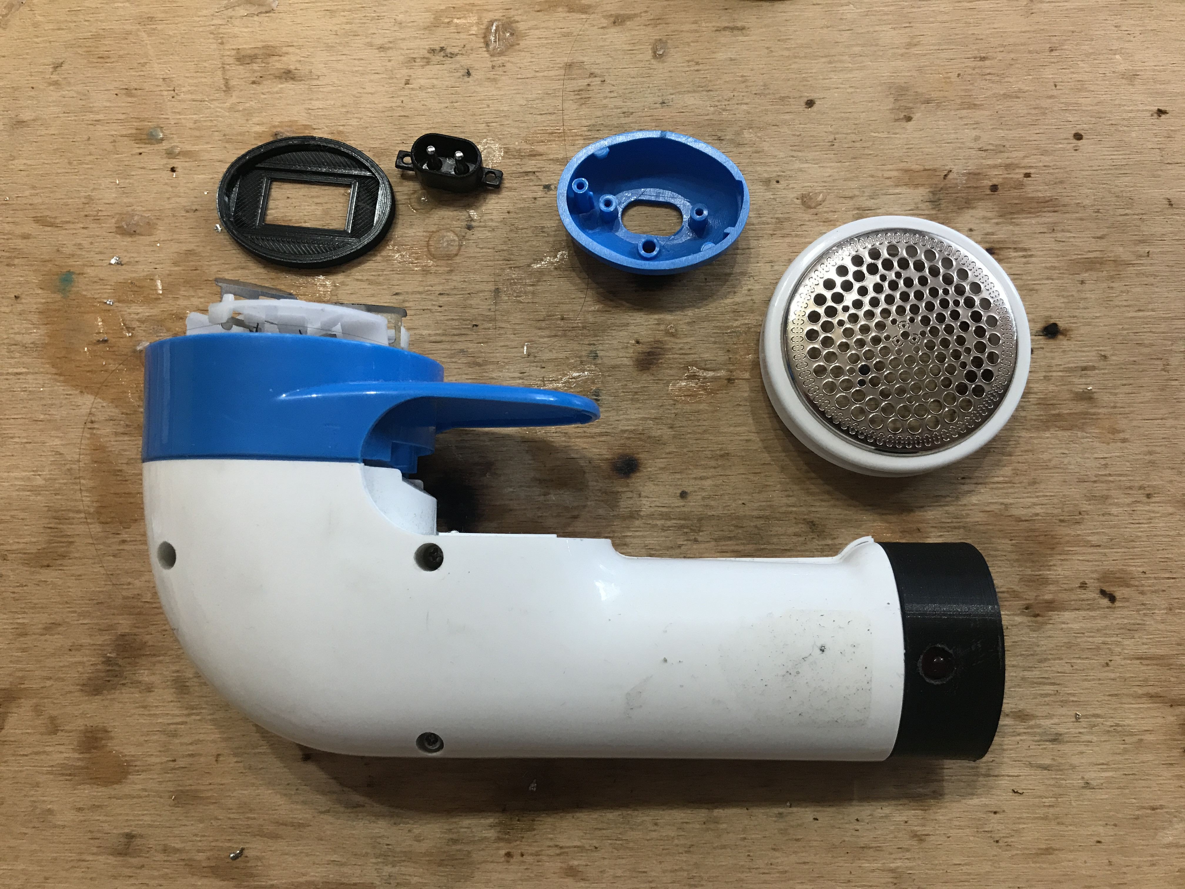

Here I will present another simple yet practical project for which I used 3D printing. This will be a modification of the so-called "jumper shaver", more specifically the replacement of the power connector with another, more standard one. This swap saved the shaver from being thrown away as the original non-standard power cable was lost when moving house.
NOTE: this topic will also be written "tutorial-wise", more or less step-by-step I will present the process of designing a new part in Blender, although I will not give the absolute basics here anymore as there are already other Blender tutorials of my authorship available in this section.
Teardown Hualing HL-677
The Hualing HL-677 is a so-called clothes shaver with a built-in, non-removable rechargeable battery. There must also be some sort of transformer inside, as we connect a 230V cable to the device to charge it, unfortunately its connector is quite non-standard. The product costs around PLN30-40:
To start with, let's see how this gadget is built in general.
The knife cover is unscrewed, but this does nothing for us.
The housing is held on by three screws and a blue piece with a socket for the mains cable.
You can now see that our modification will involve printing the equivalent of the blue element.

After printing - it fits ideally:
I then had to size a new socket. I took them from an old radio, I had the parts in a drawer after some teardown. I transferred the dimensions into Blender:
In the form of two elements, I modelled the connector. One will be cut from the other:
I also modelled the base of the element for the connector, without the hole:
A boolean operation (cut out) allowed me to get this result:
The connector will go in at the squeeze, but for the sake of principle it can also be glued.
Now, however, you need to think about attaching the printed part to the rest of the shaver. You can always glue, but this is rather overkill and not a recommended solution, especially as the original has hooks .
It was time to map them out. I did this by hand via extrude. I modelled the protuberance once, its duplication was done for me by Mirror.
Well, and a fitting:
Fits, you can immediately combine our two objects into a whole:
Printed element:
Comparison. My element is necessarily larger, as the connector is also larger.

Pre-assembly test:
Finished:
Ultimately, I still wanted to round off the corners and print the component in white, but the new owner of the machine decided that this was unnecessary, so I just final glued the connector to the component (so that when the plug is pressed in, it doesn't fall inside the housing).
Summary
The project essentially cost nothing, and even if you counted the weight of the filament it would come out to 7 grams per final piece, so in total with prototypes maybe 25g, at PLN50/kilo that's PLN1.25.... as you can see, it was worth it to save a decomposed machine where a new one costs 35PLN. 3D printing once again showed its usefulness.
