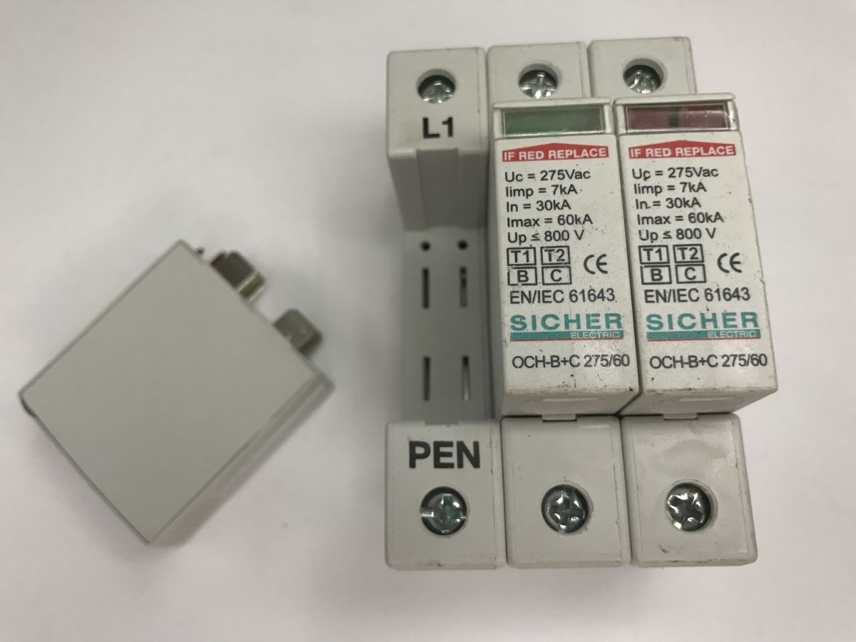

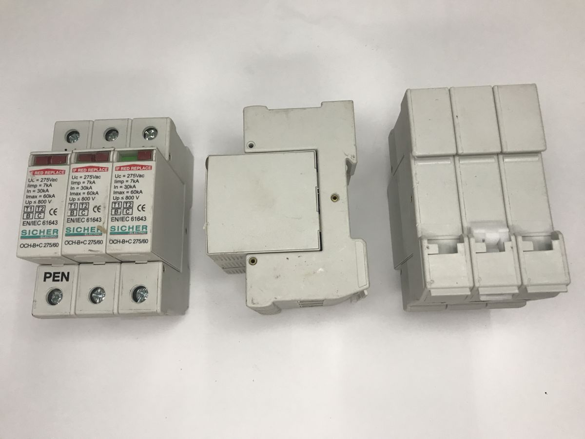

    Today, something completely different – a few photos of the inside of a Class B+C surge arrester (protector). The focus of this post is the three-phase OCH-B+C 275/60 model from Sicher Electric. Its main function is to protect low-voltage installations against the effects of partial, direct and indirect lightning strikes. According to the markings on the housing, this device has a continuous operating voltage of Uc = 275 V AC, a rated discharge current of In = 30 kA and a maximum current of Imax = 60 kA. Voltage protection level Up up to ≤ 800 V.

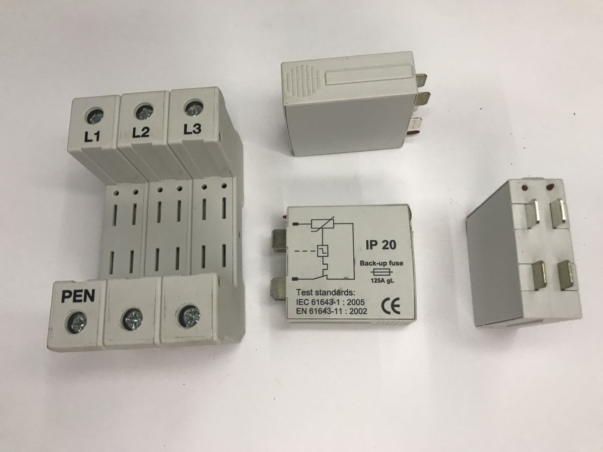

    The first thing that catches the eye is the device’s modular design. There is a separate base mounted on a TH35 rail, to which the phase conductors (L1, L2, L3) and the neutral conductor (in this case, the PEN) are screwed, as well as replaceable plug-in operating inserts. This means that, once a protective element has worn out, there is no need to unscrew the cables; you simply replace the insert itself. The inserts have an IP20 protection rating.
    Inside the Sicher OCH-C 275/40 surge arrester: what lies within this three-phase protection device

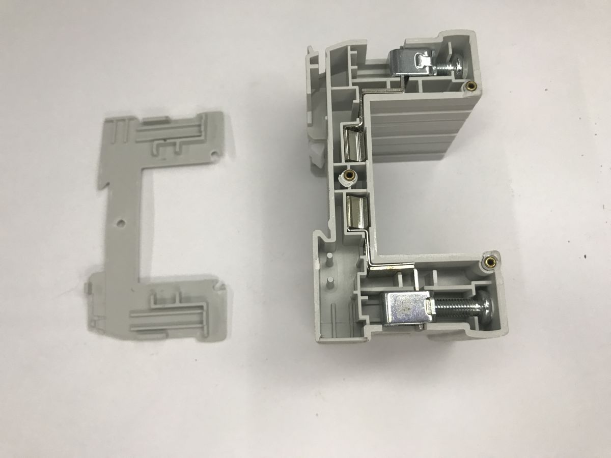

    Just for the sake of it, I also had a look inside this frame, but of course, there’s essentially nothing there apart from the robust and solid contacts, which ensure good connection.

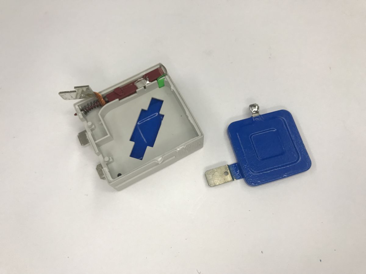

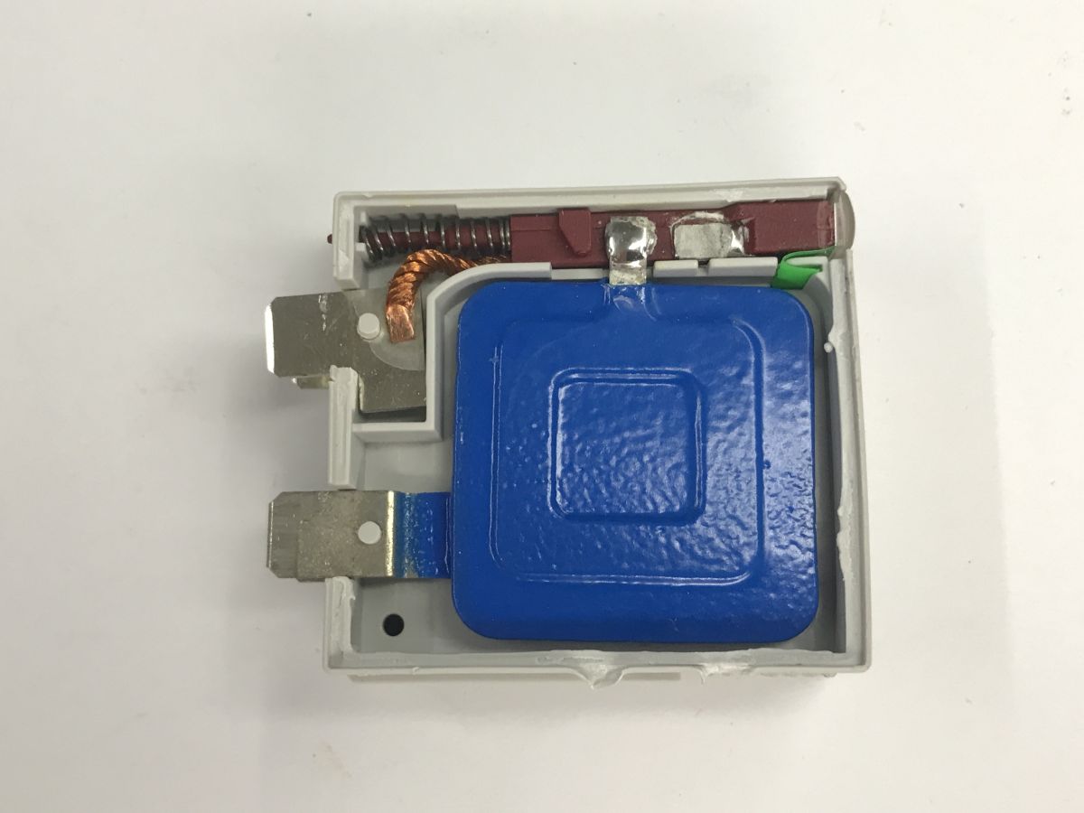

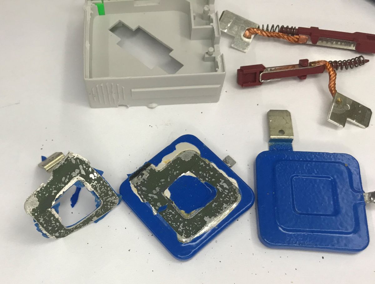

    The situation is more interesting inside the cartridge. It is here that the actual surge-suppression component is hidden, namely a massive metal-oxide varistor (MOV). Its function is to instantly reduce its resistance when the mains voltage exceeds a safe threshold, and to short-circuit any dangerous surge to the PEN conductor.

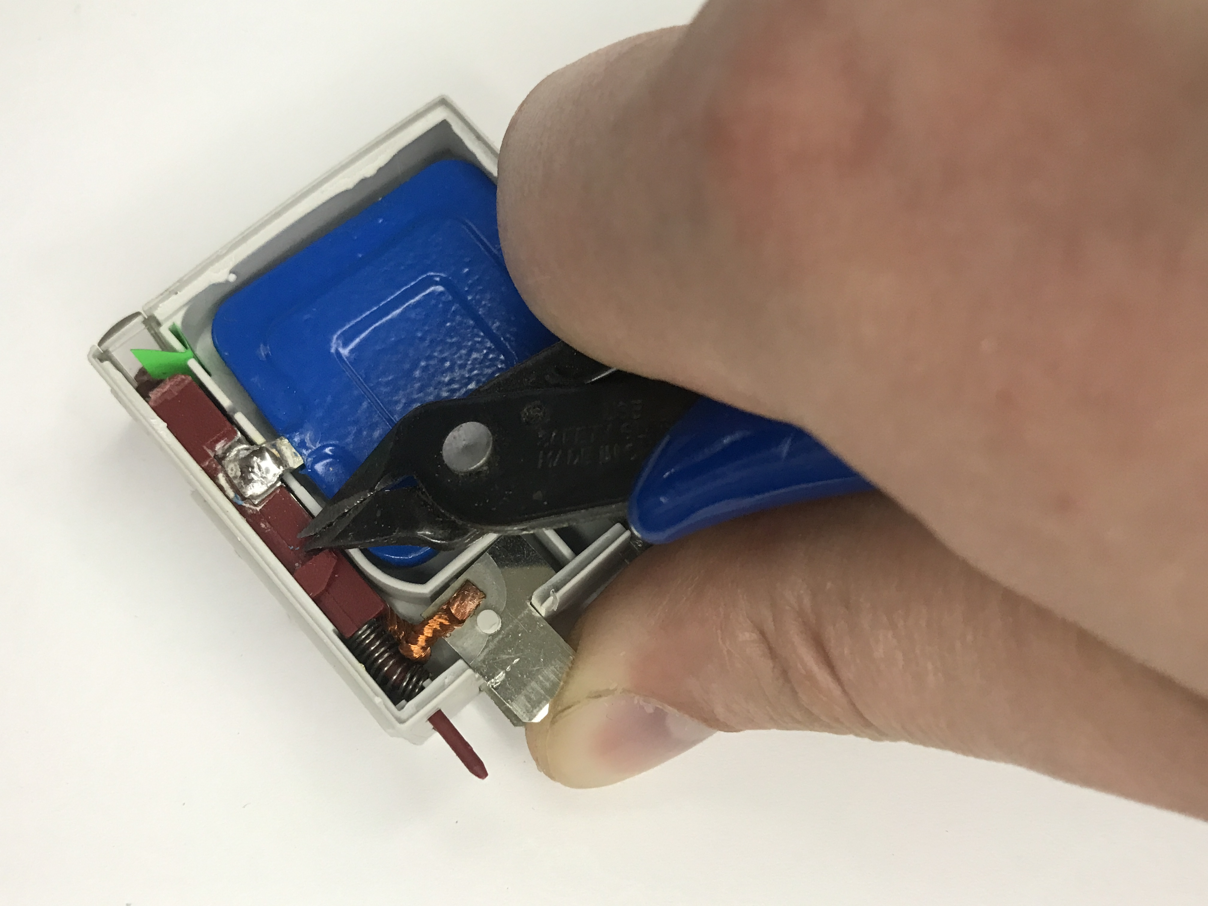

    You can also see a spring-loaded mechanism which, following degradation and overheating of the varistor, releases the lock and changes the indicator to red (the inscription ‘IF RED REPLACE’). This is known as a thermal cut-out. Varistors degrade over time and with successive surges, resulting in increased leakage current and significant heating. To prevent a fire, the varistor’s terminals are soldered using a special low-melting-point solder. When the temperature exceeds a critical point, the tin melts and the visible spring mechanically pushes away and disconnects the circuit, whilst simultaneously extending a red flag onto the front panel.

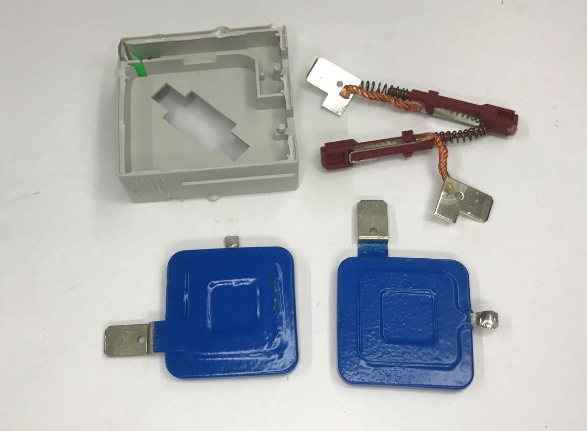

    After removing the cartridge:
    Inside, there are two rectangular varistor blocks and the clearly visible thermal cut-out mechanism with a spring, as mentioned above.

    That’s basically it; I’m unlikely to be able to get inside the varistor itself…
