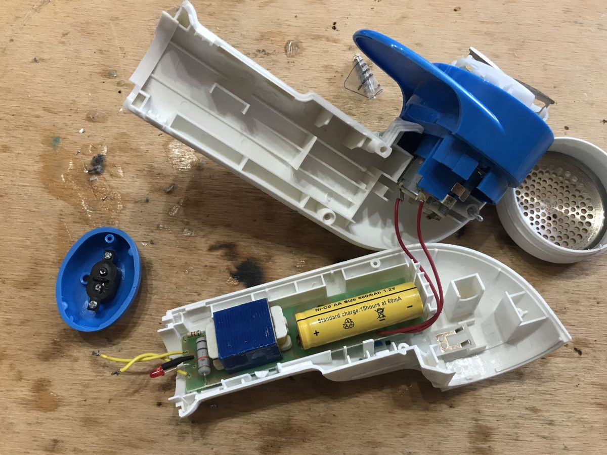

    Teardown Hualing HL-677
    The Hualing HL-677 is a so-called clothes shaver with a built-in, non-removable rechargeable battery. There must also be some sort of transformer inside, as we connect a 230V cable to the device to charge it, unfortunately its connector is quite non-standard. The product costs around PLN30-40:
    Alteration of a jumper shaver, design and printing of a housing section
    To start with, let's see how this gadget is built in general.
    Alteration of a jumper shaver, design and printing of a housing section Alteration of a jumper shaver, design and printing of a housing section
    The knife cover is unscrewed, but this does nothing for us.
    The housing is held on by three screws and a blue piece with a socket for the mains cable.
    You can now see that our modification will involve printing the equivalent of the blue element.
    Still out of curiosity you can look at the electronics from inside:
    Alteration of a jumper shaver, design and printing of a housing section Alteration of a jumper shaver, design and printing of a housing section Alteration of a jumper shaver, design and printing of a housing section
    A 600mAh 1.2 Ni-Cd AA cell is used here with the charging system trimmed to the limit. Behind the transformer we only have a rectifier bridge, and in front of it an LED (which only indicates that the power supply is connected) and current limiting resistors.

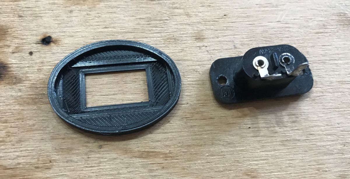

    I then had to size a new socket. I took them from an old radio, I had the parts in a drawer after some teardown. I transferred the dimensions into Blender:
    In the form of two elements, I modelled the connector. One will be cut from the other:
    I also modelled the base of the element for the connector, without the hole:
    A boolean operation (cut out) allowed me to get this result:
    The connector will go in at the squeeze, but for the sake of principle it can also be glued.
