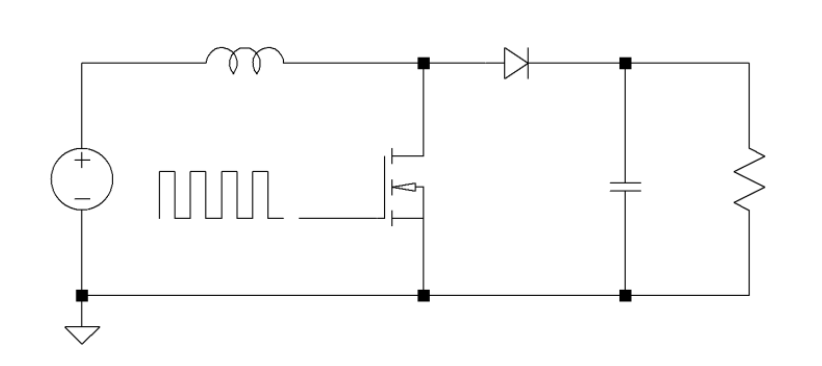

Boost converters are useful devices for designers because they solve a number of power problems at low, medium and high voltages. If it is necessary to reach a certain voltage, which might be higher then the one available, a voltage step-up converter will solve the issues. A boost converter, or step-up converter, is nothing more than a direct current (DC) to direct current (DC) converter, which increases the input voltage to obtain a higher voltage on the output load. Obviously the price to pay is a decrease in the available current, since the power P = V * I cannot change.
How a boost converter works
Boost converters are a class of switching power supplies that contain two active semiconductor components (a diode and a transistor or MOSFET) and some energy storage elements such as the capacitor and inductor (see the principle diagram in Figure 1). To reduce the voltage ripple, filters consisting of capacitors can be added to the output of the converter. The voltage gain depends on the duty cycle, the value of the inductor, the input voltage, the switching period and the output current. In the system there are two distinct logic states of the switching element:
• in ON state, the MOSFET is closed and the current on the inductor increases;
• in OFF state, the MOSFET is open and the inductor current flows through the diode, the capacitor and the load.
If the switching element works very quickly, the inductor does not completely discharge and there will always be a voltage that is higher than that of the input even when the MOSFET is open. During the OFF time, the blocking diode prevents the capacitor from discharging through the MOSFET. This whole process has to happen very quickly.
A simple electrical circuit diagram with elements like a diode, coil, switch, capacitor, and resistor.
Figure 1: The basic diagram of a boost converter

After having entered all the information in the Web calculator, the system immediately provides the results and the values of the components to be used, as shown in figure 4. The same wiring diagram has also been reproduced on the LTspice simulation software, for the execution of different static and dynamic simulations. Remember that a complex simulation with LTspice (or other simulators) with the presence of inductors and external components is extremely slow and could take a few hours to obtain the final results. The electrical components used are the following:
• V1: 12 V battery;
• V2: 0-15V (zero-peak) square wave generator with a frequency of 30 kHz and a duty cycle of 50%. The voltage of 15 V is dictated by the MOSFET datasheet as the recommended gate voltage;
• R1: load;
• R2: resistance of 2.5 Ohm;
• L1: inductor of 0.5 mH;
• C1: 200 uF electrolytic capacitor;
• U1: C3M0060065D SiC Mosfet;
• U2: Schottky diode C3D16060D (another more performing model, the E4D20120G, was used in the diagram).
The site provides users with SPICE models of MOSFETs and Schottky diodes, ready to be incorporated and used with their favorite electronic simulation program. The pins “Tc” and “Tj” are reserved, respectively, to set the component container temperature and the junction temperature. This will be covered in an upcoming tutorial.
Figure 4: Wiring diagram of the Boost converter, proposed by the Speedfit calculator and drawn with LTspice
