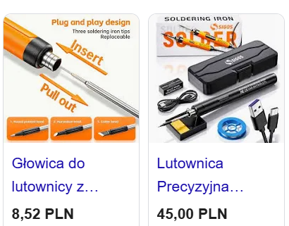

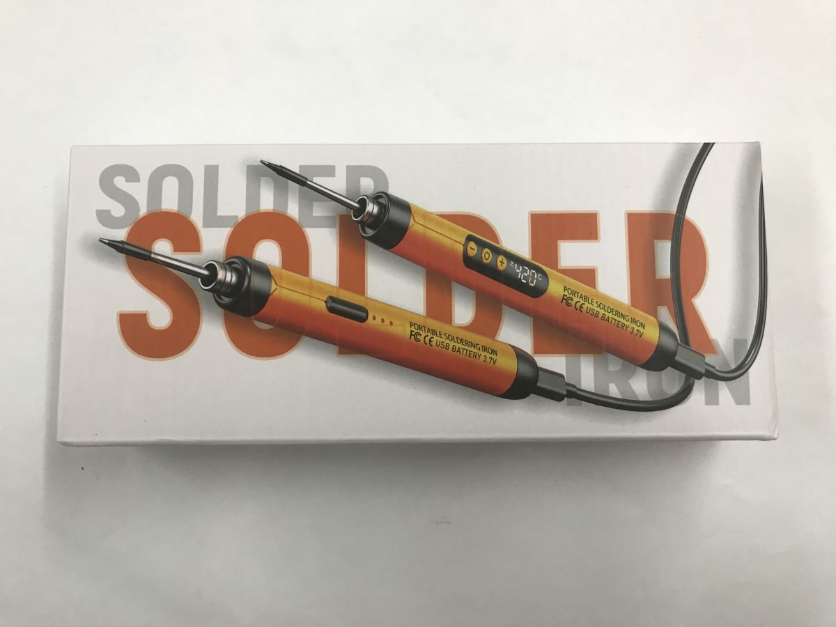

    Is it sensible to buy a tiny, battery-powered soldering iron? Can such a soldering iron cope with soldering wires or goldpins? I invite you to a video test - with a breakdown of lead and lead-free solder. I bought the soldering iron for PLN30 - importantly, you can also buy soldering tips for it.
    Screenshot of soldering offers: replaceable tip and soldering iron kit in a case with prices in PLN

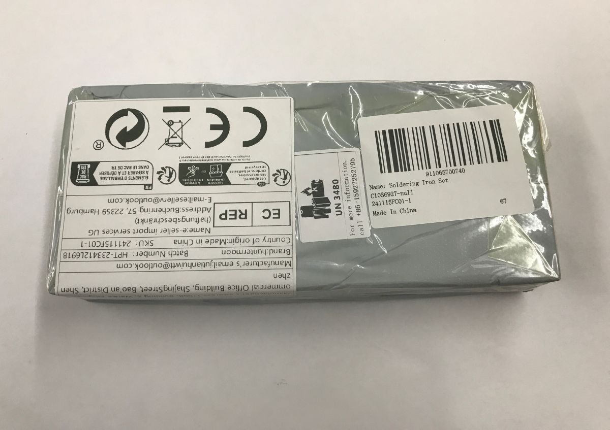

    There was a bit of a wait for shipping, but maybe it was worth it?
    Gray plastic-wrapped box with label and barcode reading “Soldering Iron Set” on a white surface

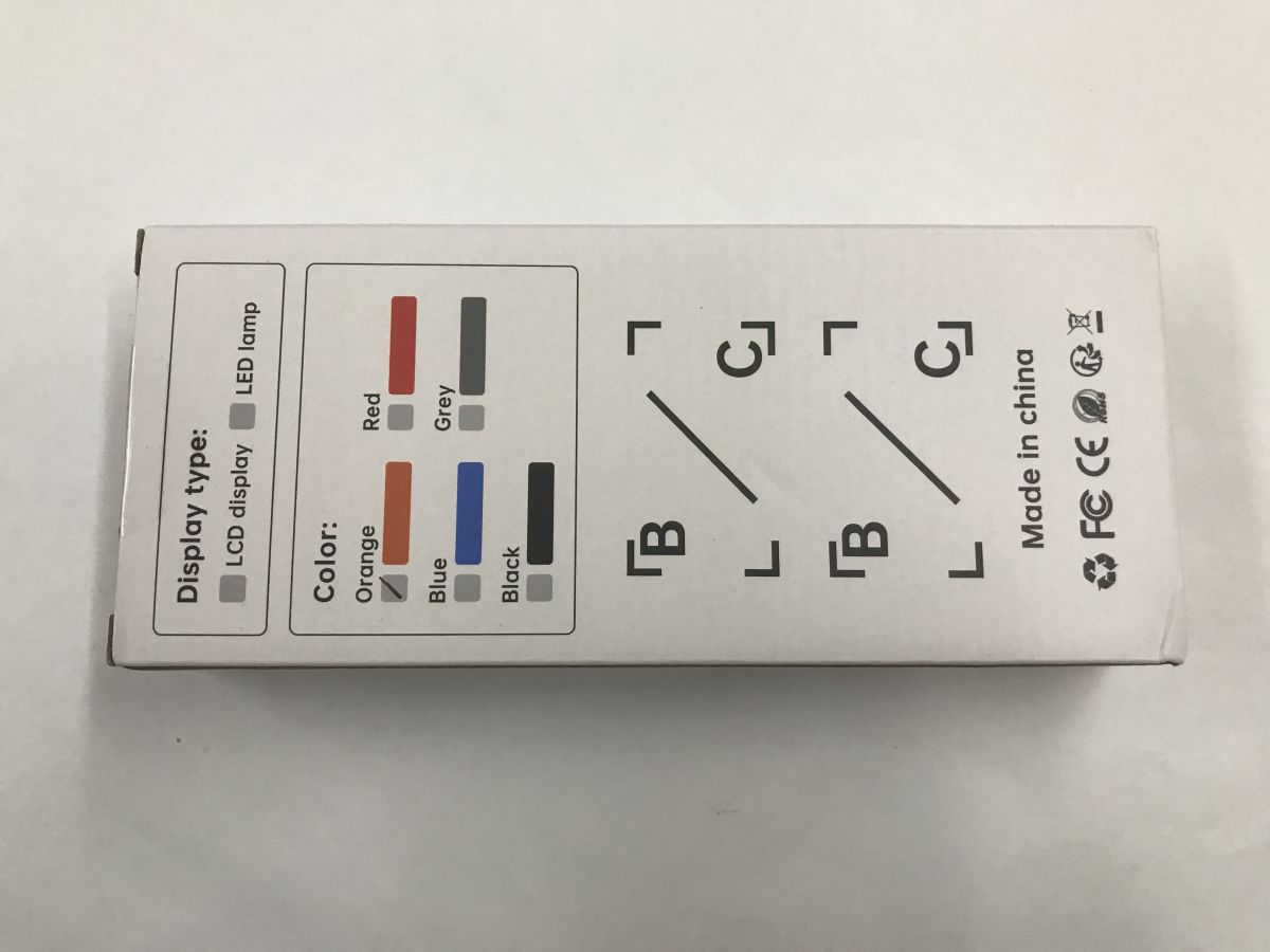

    The product comes in different colours and there is also a version with LCD.
    White product box with display-type and color options printed, plus “Made in China”

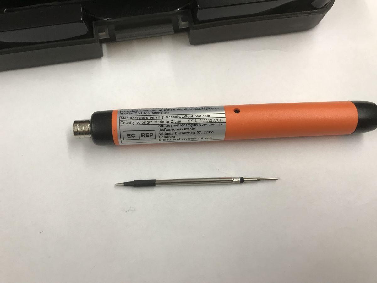

    Time for testing:
    Orange USB soldering iron with a detached tip lying on a white surface
    I started by warming up. The soldering iron takes a good minute to warm up. It is not a tool for the impatient.
