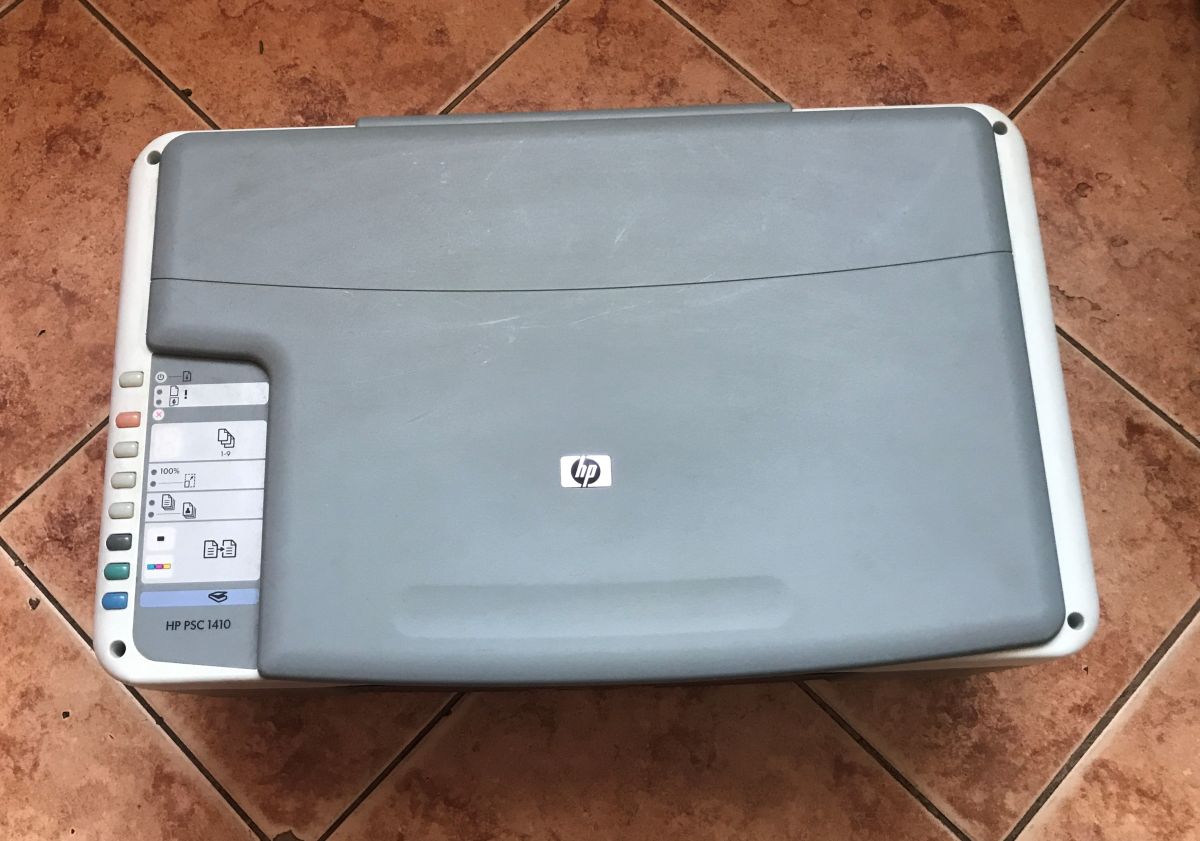

    Top view of an HP all-in-one device with a gray lid and a left-side button control panel.

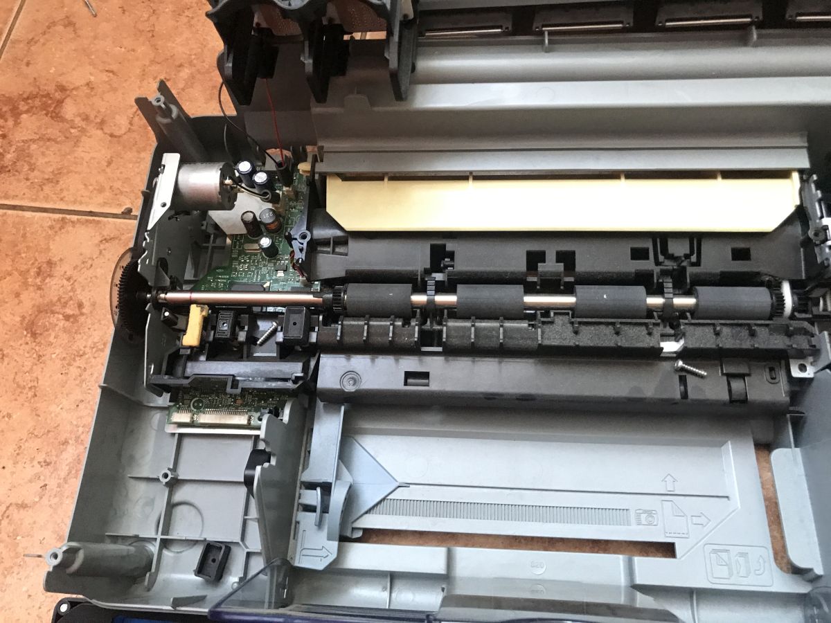

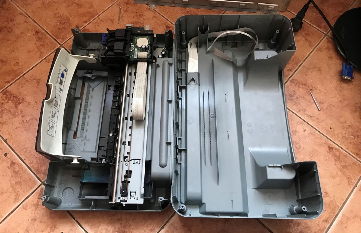

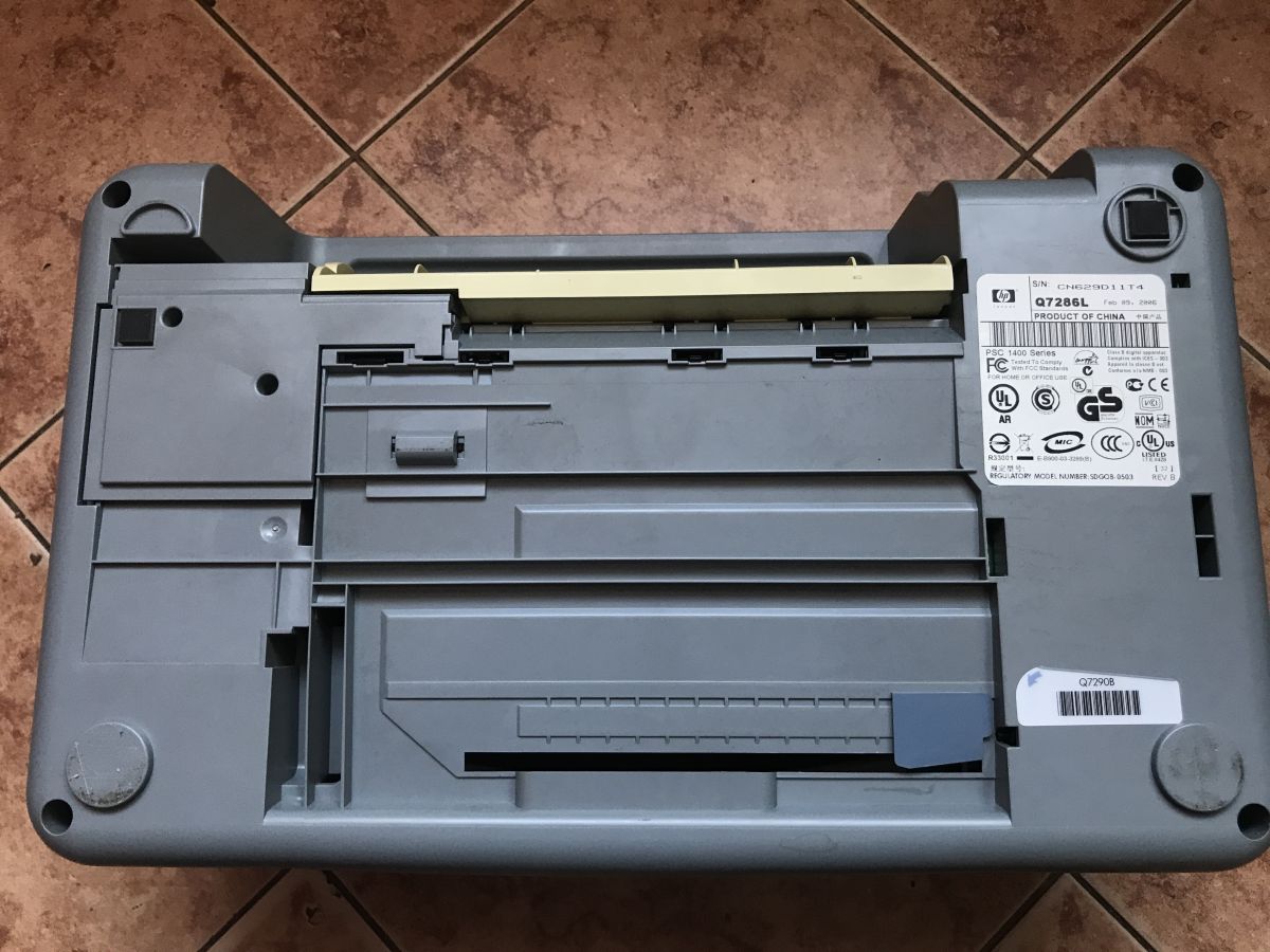

    This printer has essentially just knocked 20 years off its age - it's a 2006 piece of hardware, a PSC 1400 series. The kit is pretty poor, as even the power supply didn't come with it, but maybe it's worth taking a look inside anyway?
    Bottom of an HP printer on tiled floor; label with product details and compliance marks visible

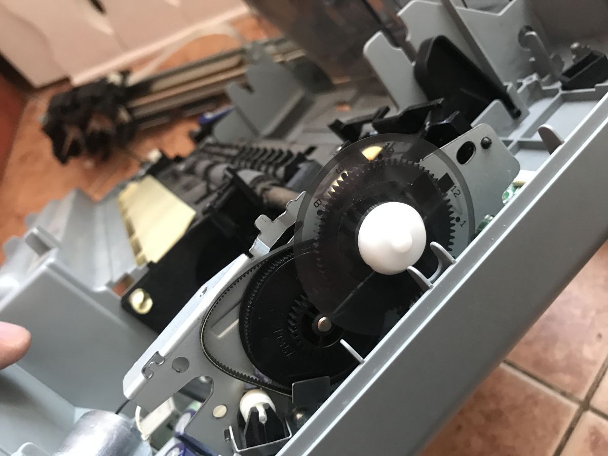

    Look in vain for stepper motors inside, everything is based on DC motors and encoders, I presented this in detail the other day:
    Teardown of an HP Deskjet D1360 printer and an example of using its parts with an Arduino
    Opened printer casing on tiled floor, internal mechanisms and flat ribbon cable visible
    The motherboard is small, in the corner of the printer:

    Here another photo of one of the dials for the encoders (the carriage also has its own bar):
    Close-up of printer interior with encoder wheel and gears in a gray plastic housing

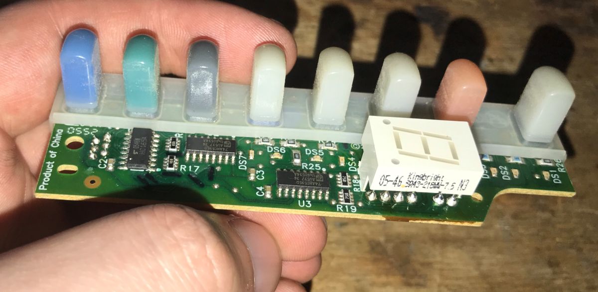

    Basically I recovered two boards - the one from the buttons, based on the sliding registers, with one display segment:
    PCB with LEDs and a white segment display held between fingers

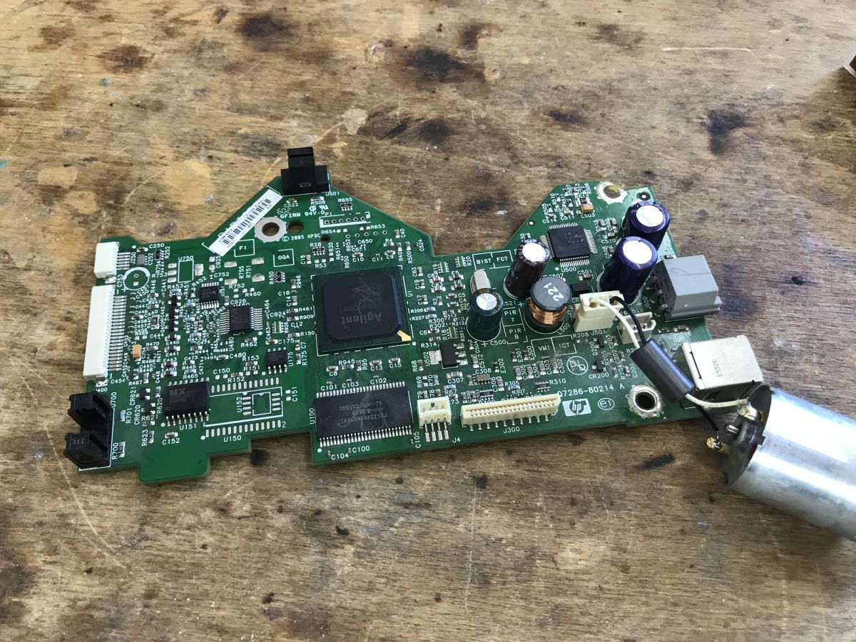

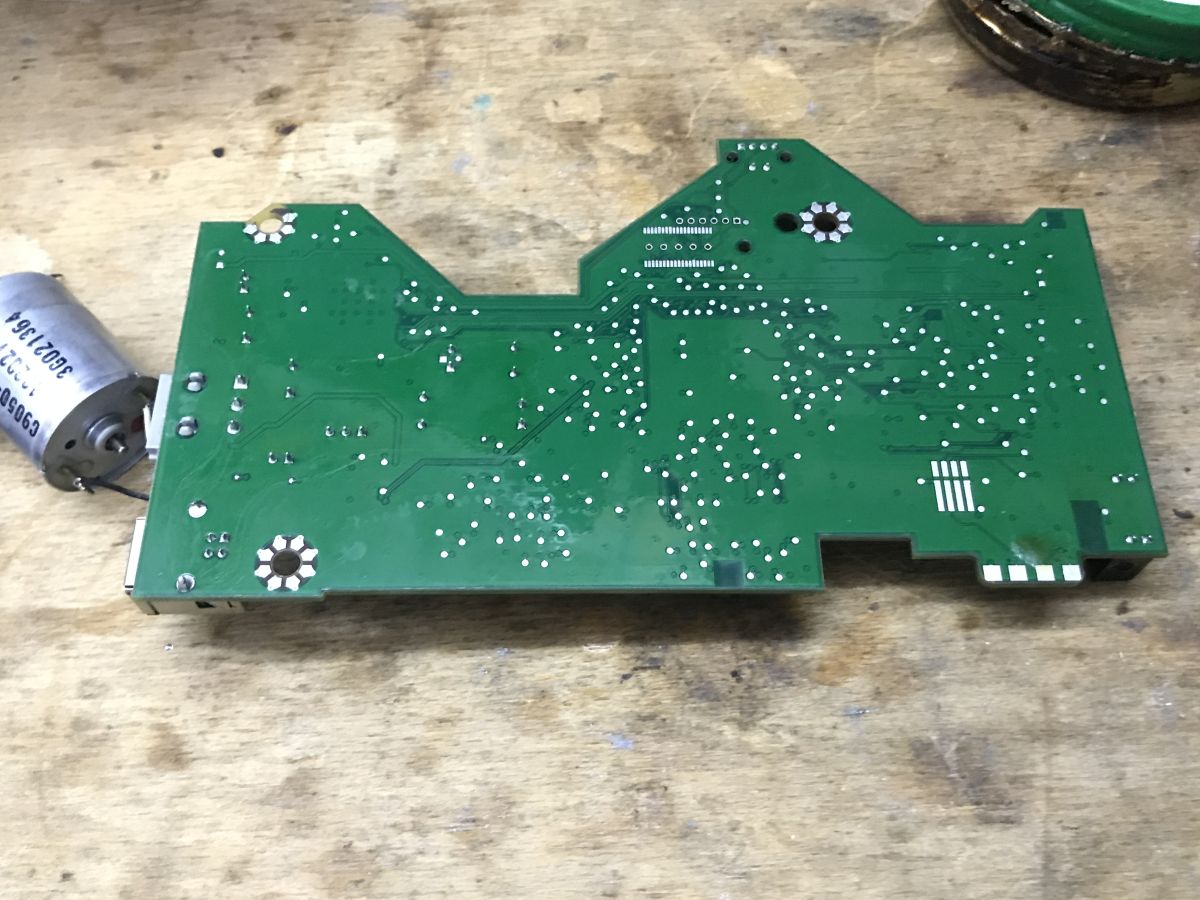

    And the motherboard:
    HP printer main PCB with chips and capacitors on a wooden workbench Underside of a green PCB on a workbench, showing solder points, traces, and edge connectors

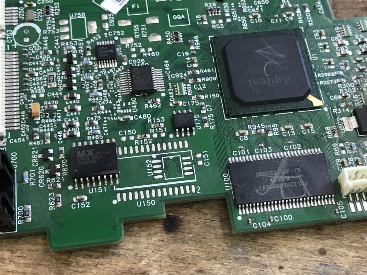

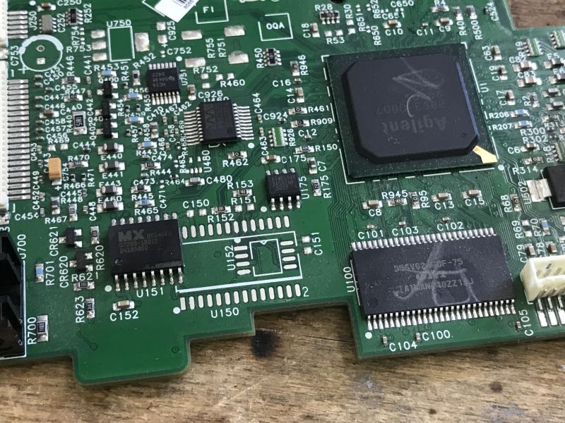

    You can see the really big savings and design simplifications here. The motherboard has encoders on it, and is matched throughout the mechanical design.
    The date on the board indicates 2005.

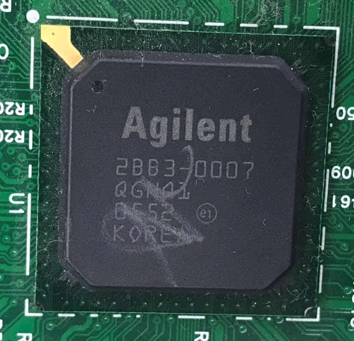

    Close-up of a green PCB with ICs, including a large Agilent chip and an MX memory chip

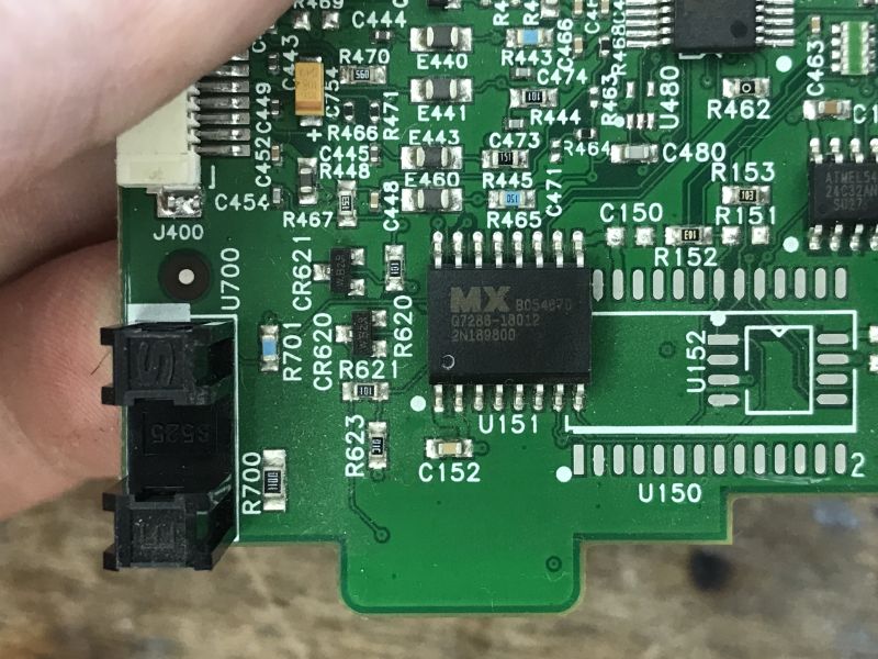

    The main MCU is an Agilent 2BB3-007 QGNQL - I can't find anything about it. The D56V62160 is a 2*512K*16 bit DRAM. The MX chip is probably a program flash memory.
    Close-up of a PCB with an MX IC and J400 connector; visible R and C component labels

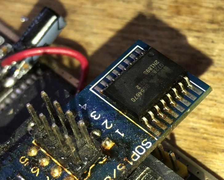

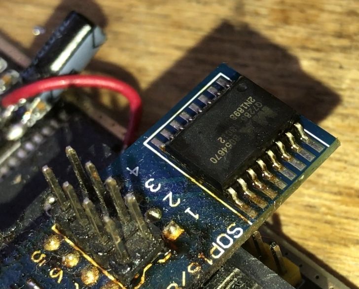

    Flash was successfully soldered and ripped out using CH341:
    Flash memory connected but programmer does not see it? Solution to CH341 NeoProgrammer problem
    Close-up of an SOIC IC soldered on a blue adapter board labeled “SOIC”, with header pins and wires
    I have placed a copy of the batch on my repository: https://github.com/openshwprojects/FlashDumps/commit/c183ec39e092d085d77f4b822aa392a94090270a

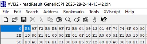

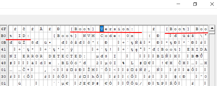

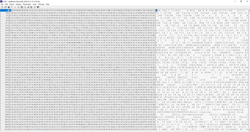

    I started with an analysis in a simple hex editor. You can see the ASCII captions.
    Screenshot of a hex editor showing binary data on the left and an ASCII preview on the right
    Among them, quite a lot of text related to initialisation and errors is striking, but the most important is probably the code name of the whole chip (SoC): "Eridani".
    0x000630	[BIST] START
    0x000640	[BIST] RESULT:
    0x00095C	[Boot] Bootstrapping:
    0x0009B8	[Boot] Decompressing:
    0x0009D0	[Boot] Jumping to:
    0x0009E8	[Boot] ROMOBJ found:
    0x000A1E	[Boot] Version:
    0x000A33	[Boot] Boot ID:
    0x000A48	[Boot] NVM Code: 0x
    0x000ABC	[Boot] ERIDANI ERROR DETECTED:
    0x000F68	[Boot] Header record data: '
    0x000F98	[Boot] Downloaded Program ID: '
    0x0011AC	[Boot] Bad Download type:
    0x0011D0	[Boot] Download address:
    0x0011EE	[Boot] Download length :
    0x001218	[Boot] Downloads complete
    0x001292	[Boot] To execute program you must type '
    0x0012C2	[Boot] Continuing to execute program
    0x0012EC	[Boot] Jumping to downloaded program
    0x001334	[Boot] Downloading s-records over USB
    0x001AA0	[Boot] Something very bad happened in USB code (1)
    0x001AF0	[Boot] USB disconnected
    0x001B10	[Boot] USB re-connected
    0x001B2C	[Boot] USB connected
    0x001B8C	[Boot] USB re-disconnected

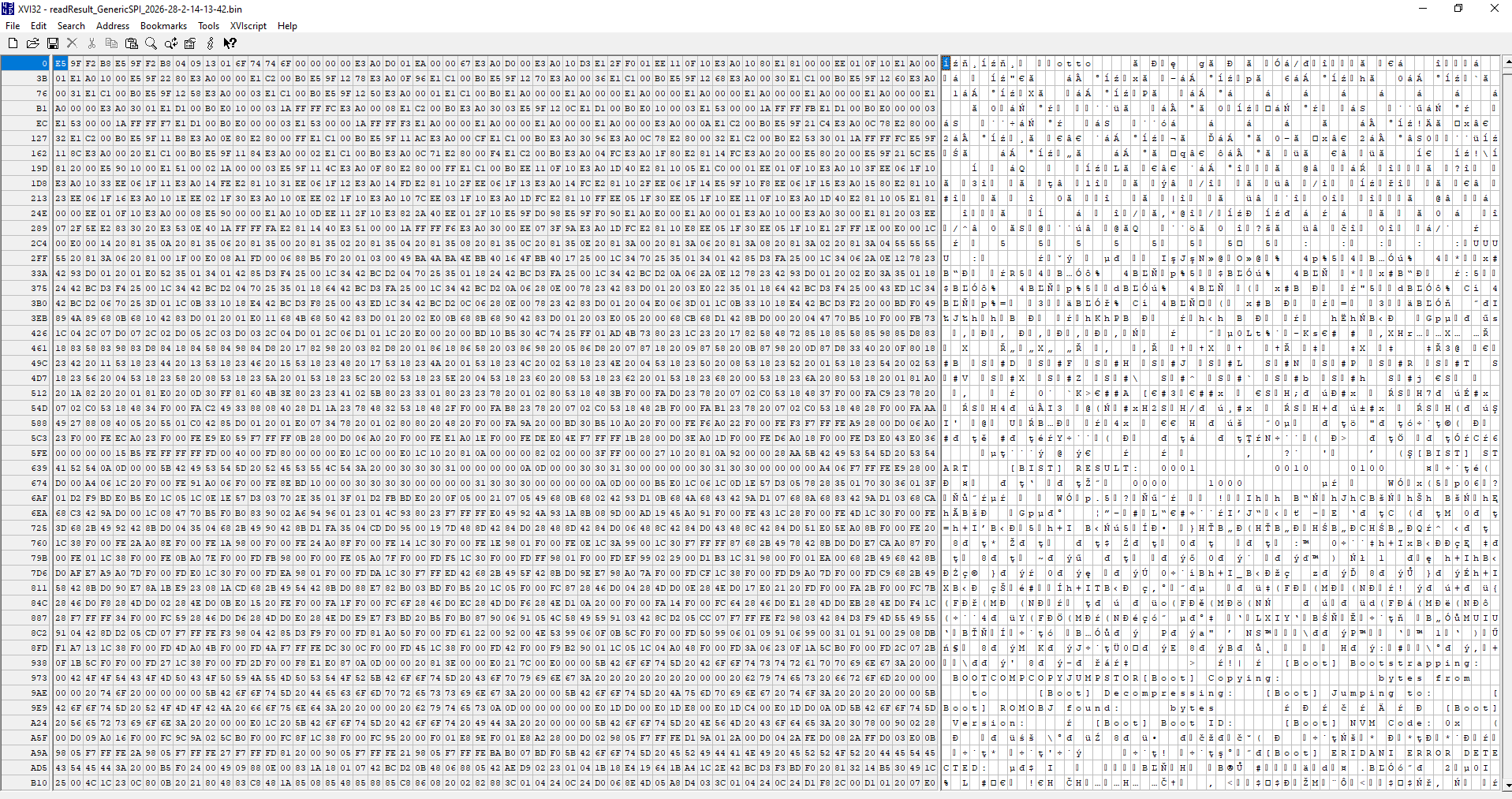

    ARM9 - which means we have a clue! This makes it a lot easier, because there are different architectures and instruction sets, I don't need to check them here anymore, I know that for example it's not MIPS, etc.... now let's check the first bytes of the file:
    Screenshot of a hex editor showing firmware bytes with address offsets on the left.

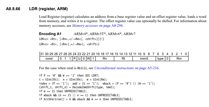

    0xE5 0x9F 0xF2 0xB8 is repeated twice. This looks like an ARM interrupt table, LDR PC instruction, [PC, #0x2B8]. Jumps to the memory value from PC offset + 0x2B8.
    https://developer.arm.com/documentation/dui03.../ARM-and-Thumb-Instructions/LDR--PC-relative-
    https://www.macs.hw.ac.uk/~hwloidl/Courses/F2...0406C_C_arm_architecture_reference_manual.pdf
    ARM documentation excerpt showing LDR (register) encoding with a bit-field diagram

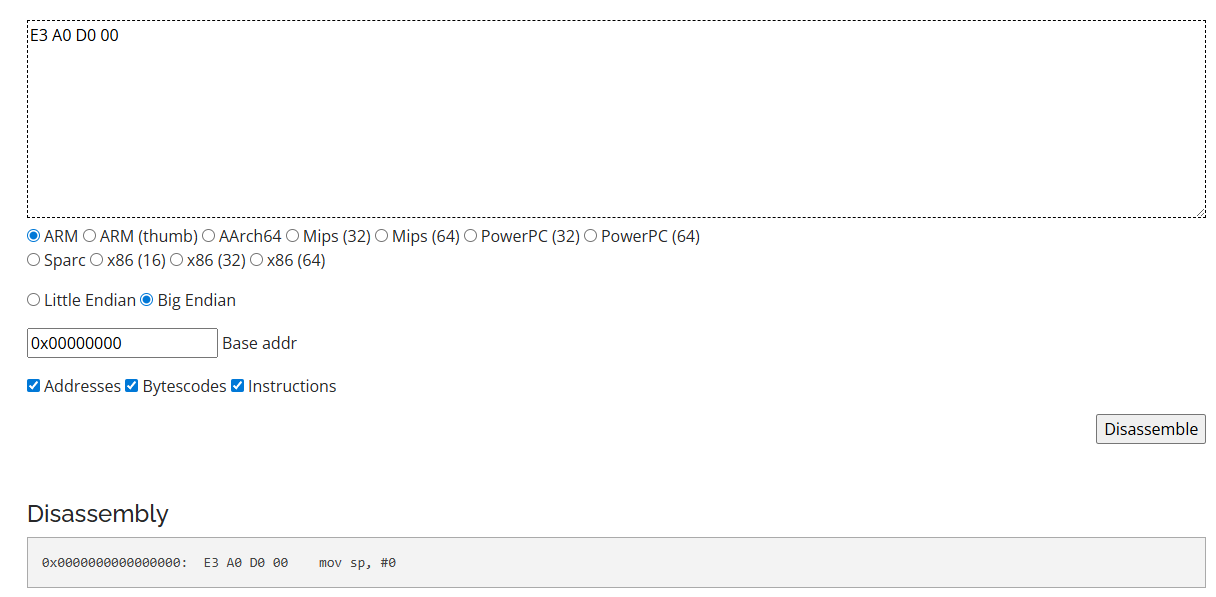

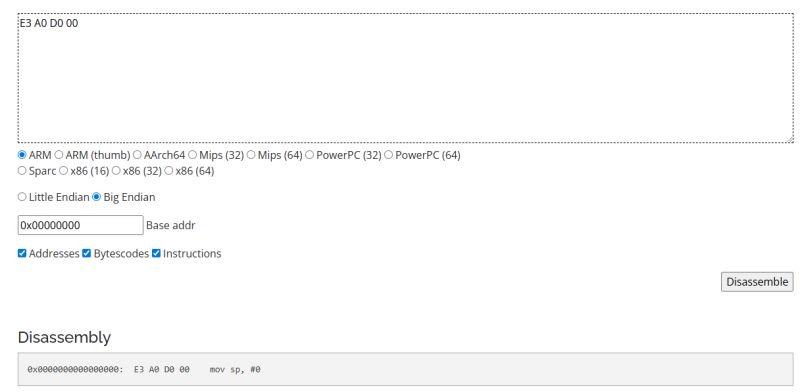

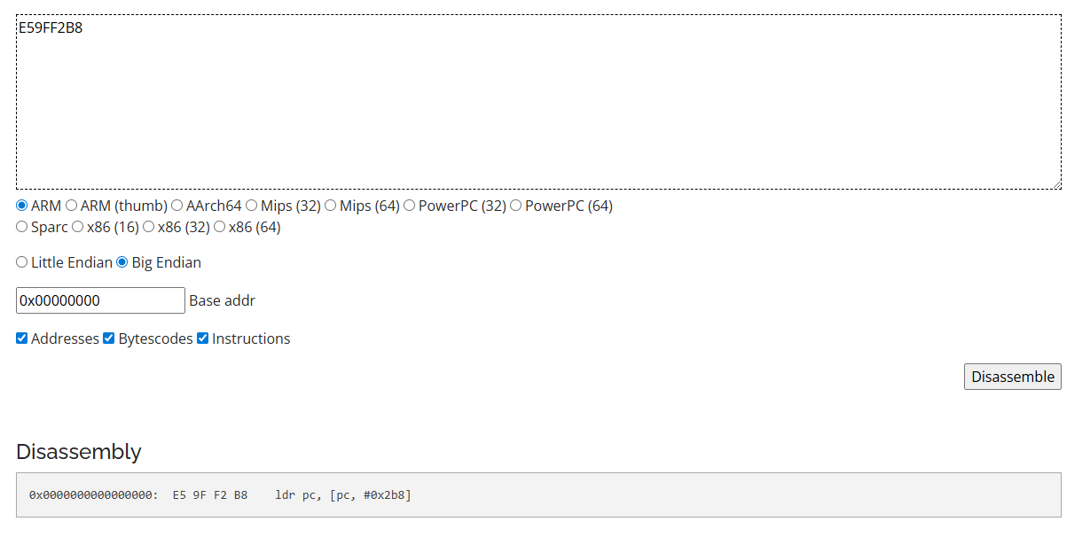

    I also helped myself with this converter to instructions from ARM:
    Screenshot of a disassembly tool showing E59FF2B8 and the result “ldr pc, [pc, #0x2b8]”

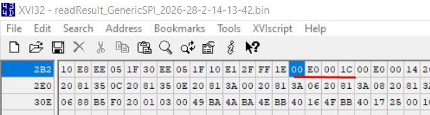

    The PC is already on next instruction, so at offset 8, after adding 0x2B8 we come out with offset 0x2C0, there is 0xE0001C.
    Screenshot of an HxD hex editor showing binary data and a highlighted sequence “00 E0 00 1C”.
    The second instruction in that case is at offset 0x00E0001C. It looks like a flash memory mirror to me, because it's too big an index for a 1 MB program, so I looked at the file at offset 0x1C. There it is in turn E3 A0 D0 00:
    Screenshot of a disassembly tool set to ARM, showing bytes E3 A0 D0 00 decoded as “mov sp, #0”
    Setting the stack pointer to 0 undoubtedly looks like something that might be done at the start of the program.... i think all went well, you can emulate.

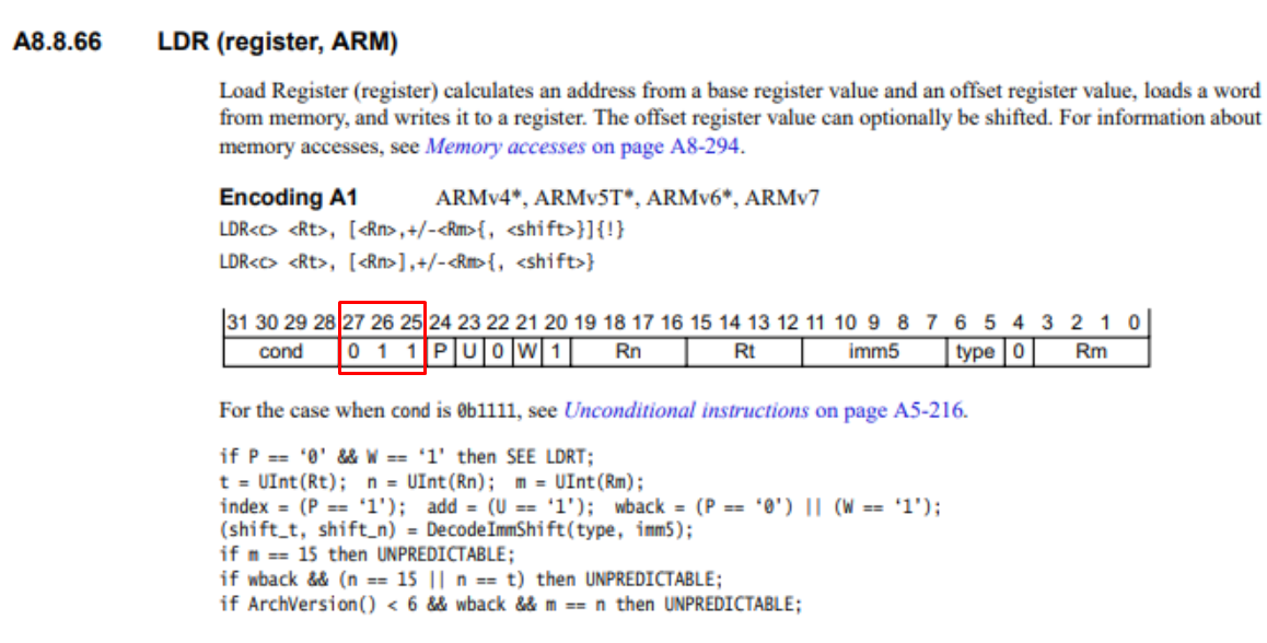

    This is how I started to make a simple ARM emulator complete with condition and jump support. Each instruction changes the state of registers, memory and the program counter accordingly.
    Code: Python

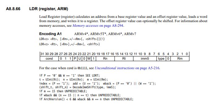

    This is how one instruction is handled - it is broken down into bits, which then allow you to determine what to execute. Let's take the example of those LDRs mentioned:
    ARM documentation excerpt for LDR instruction with bitfield encoding diagram and bits 27–25 highlighted
    We detect bits 25-27.
    Code: Python

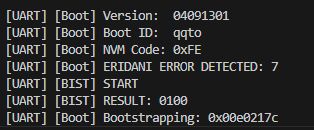

    Right away we have a candidate - 0x20812900+0x06, well you can see that the bytes stored there look like ASCII codes! Now this can be sorted out... this is how I added the UART peripheral. My script simply catches the writes to that offset and adds them to the UART buffer.
    Code: Python
    The result after firing:
    [UART] [Boot] Version:  04091301
    [UART] [Boot] Boot ID:  otto
    Screenshot of a hex editor showing ASCII text “[Boot] Version:” within memory data
    I couldn't believe it was working. I changed two letters in "otto" to "qq" in the source dump to verify this, but the program still correctly displayed what I expected:
    Console screenshot with UART bootloader logs, including “[Boot] Version” and “ERIDANI ERROR DETECTED”.
    Finally, the full log from the emulator:

    Hello, I think you have set the address wrong.
    The first byte 0xE5 indicates that this is an unconditional branch "b" instruction.
    The address in it is bits 23...0, which is 0x9FF2B8 and is a number with a sign that needs to be shifted 2 bits to the left. Bit 23 is copied to bits 31...26.
    After the transformation, I came up with 0xFE7FCAE0.
    I attach the code in Assembler that converts the address in the R1 register to the real address:
    mov r1,r1,lsl#8
    mov r1,r1,ASR#6
    Alternatively:
    LSL R1,R1,#8
    ASR R1,R1,#6

What UART address produced readable boot logs?
Writes to 0x20812900 + 0x06 produced ASCII (for example, “\n\n[Boot”). Mapping a UART peripheral at base 0x20812900 and buffering byte writes at +0x06 yielded logs like “[Boot] Version: 04091301” and “Boot ID: otto.” [Elektroda, p.kaczmarek2, post #21853483]
What concrete boot messages can I expect if emulation works?
You should see lines such as “[Boot] Version: 04091301,” “[Boot] Boot ID: otto,” and block copy/decompress logs with hex sizes and addresses. One run executed 500,000 instructions and printed multiple BIST and ROMOBJ messages on UART. [Elektroda, p.kaczmarek2, post #21853483]

Can I patch the dump and see changes over UART?
Yes. The author modified two letters in “otto” to “qq” in the dump and the emulator still printed the expected sequence, confirming the mapping from flash to UART output. Patch small ASCII regions to verify your pipeline. [Elektroda, p.kaczmarek2, post #21853483]
