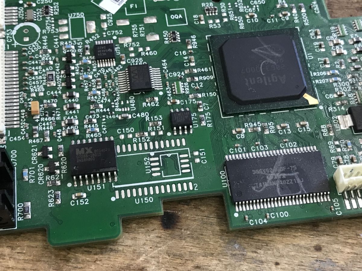

    Have you connected the flash memory correctly to the CH341 programmer, but the PC program does not recognise it at all? NeoProgrammer shows IC not responding, is the chip faulty? The Read ID operation (reading the flash ID) returns 0xFF alone? Don't give up - here I'll show an unusual case demonstrating well that some memory chips simply don't support read ID and yet you can rip data from them.
    Close-up of a PCB with a Macronix “MX” memory chip and other ICs

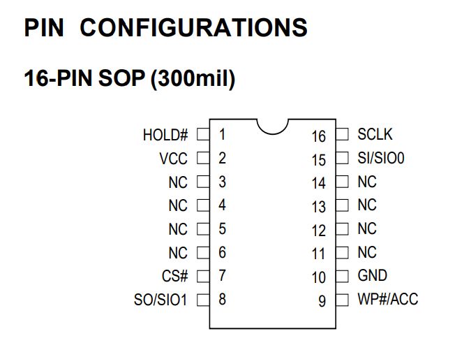

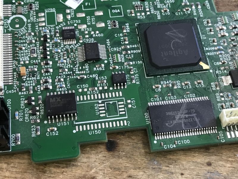

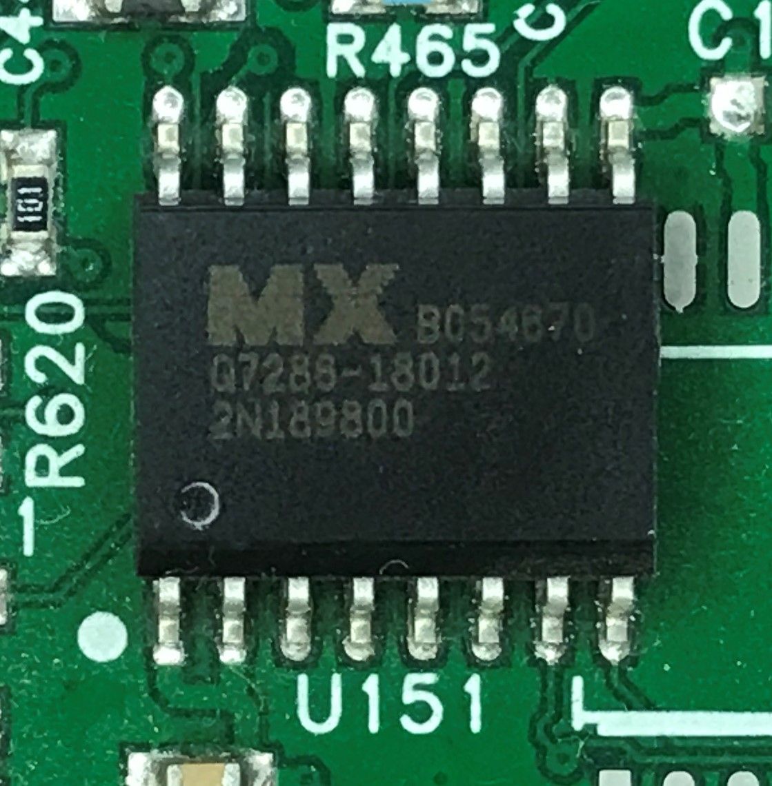

    The patient is a Macronix memory, unidentified by me, from an old HP PSC1410 printer. The fact that it is a memory is evidenced not only by the marking, but also by the way the leads are connected. You can see here that only the pins that are responsible for SPI in the case of a typical SO16 chassis are just going to the main processor.
    Pin configuration diagram for a 16‑pin SOP (300 mil) SPI memory with labeled signals

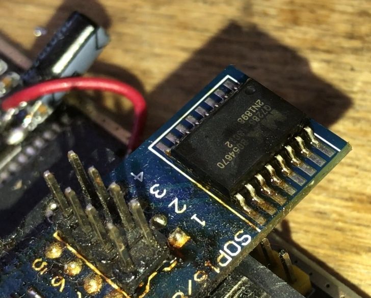

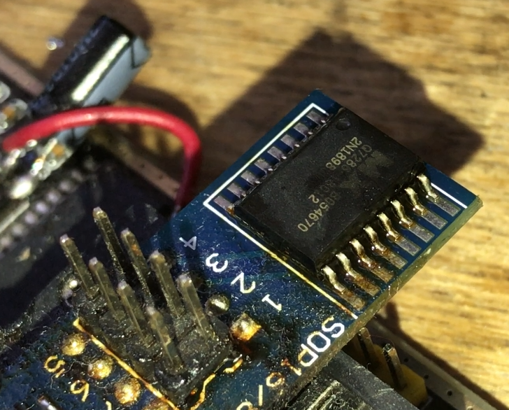

    I hot-air stripped the memory and soldered it onto the board-adapter from CH341, making sure I positioned the first pin correctly (the so-called notch). Everything looked ok:
    SOIC memory chip soldered on a blue adapter board next to a pin header

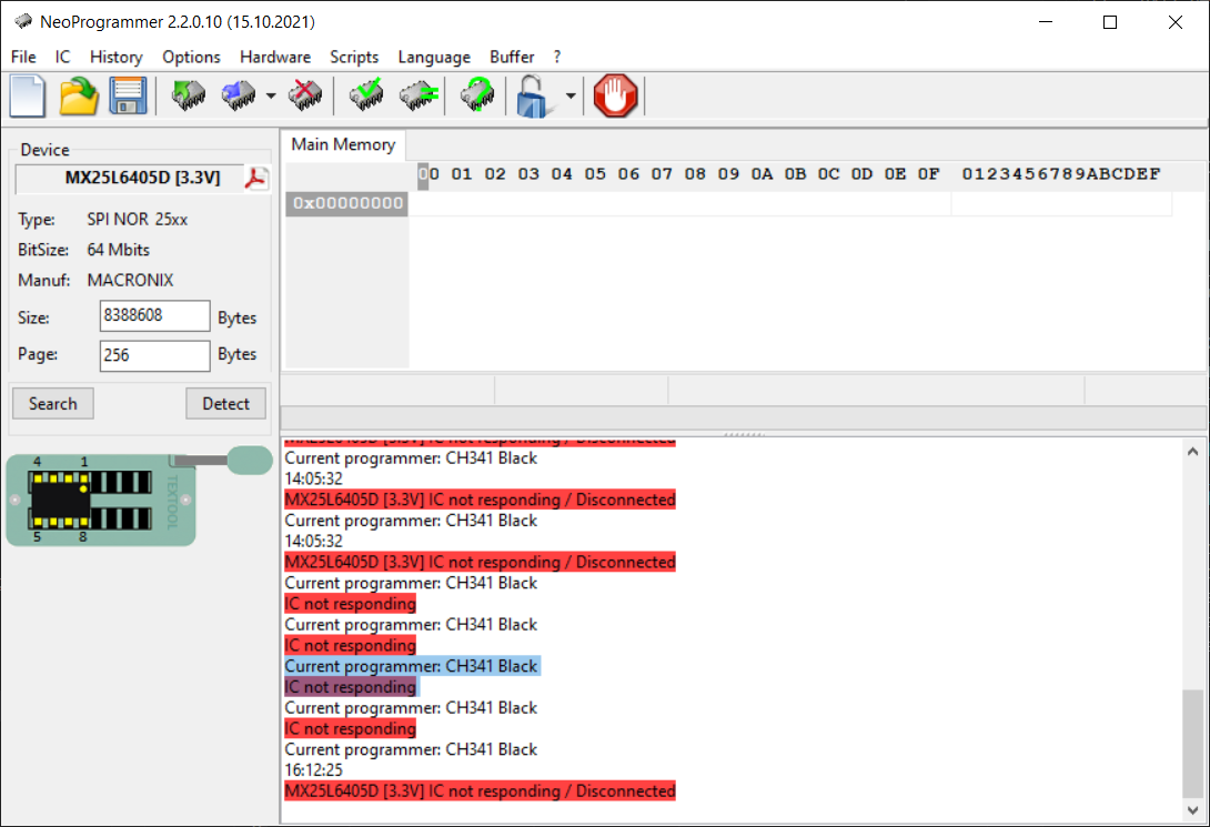

    However, NeoProgrammer says that the chip is not responding. The same error is when there is an empty socket:
    NeoProgrammer screenshot showing “IC not responding” error for MX25L6405D [3.3V] chip

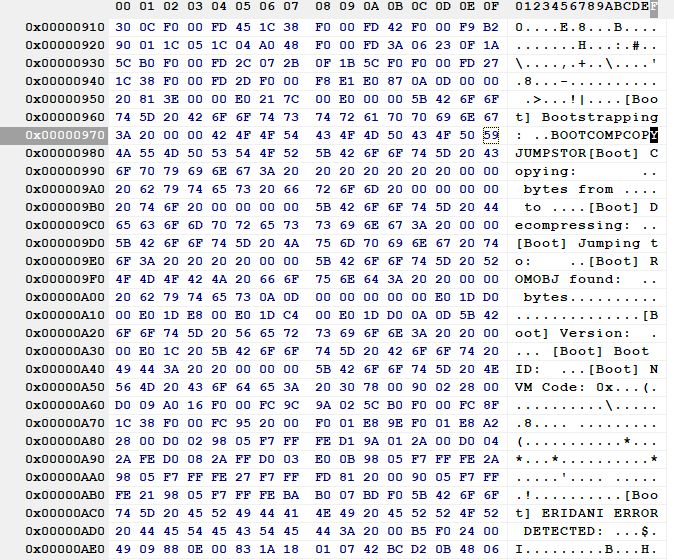

    Surprisingly something was able to be read:
    Hex dump view with ASCII column; readable strings include “Boot” and “ERIDANI ERROR DETECTED”.
    I repeated the operation in NeoProgrammer - to no avail. This one is stuck on the ID anyway.
    However, I quickly came to the conclusion that this memory does not support reading ID, but does support reading data.

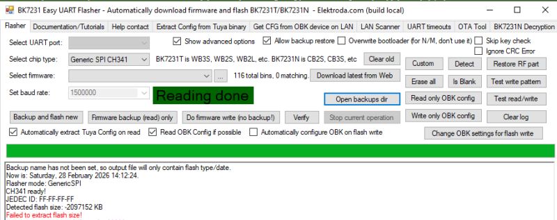

    It was time for a final verification, as I have my own programmer that supports, among other things, Flash memory via CH341 :
    Screenshot of BK7231 Easy UART Flasher showing green “Reading done” status
    Well yes, the JEDEC ID is 0xFF 0xFF 0xFF....

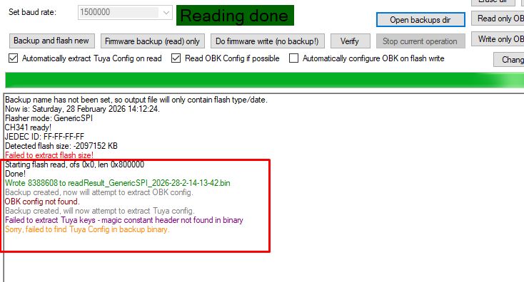

    On the other hand, what happens if we nevertheless send standard data read instructions?
    Screenshot of a flash read tool showing “Reading done” and a red-boxed log with JEDEC ID FFFFFF
    The memory is read correctly, there are no more non-standard protocol changes.
    As a result of this observation, I added to my BK7231GUIFlashTool (aka Easy Flasher - yes, the name needs to be changed) the ability to read the Flash bypassing ID verification and manually declaring the expected size.
    In summary , it looks like the NeoProgrammer developers don't know about this at all, and the ASProgrammer developers either lucked into it, or forgot to mention it in case it is possible to read the first sector but not the ID. In my opinion, the CH341 handling tools should not give a misleading "IC not responding" message in such a situation (quoting NeoProgrammer), but should attempt to read one side and only then assess whether there is communication. Only this approach will give reliable results.

    PS: Does anyone recognise what specific Flash model I've shown here?

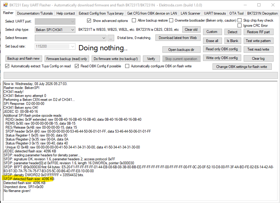

    Can I have "skip JEDEC Flash ID" feature (along with ability to read custom flash size, since no JEDEC FLAsh id check means we won't know the flash size automatically)?
    I wonder if that chip would have responded to an SFDP query. Here's an Easy Flasher test that adds size detection fall-back based on SFDP
    Screenshot of BK7231 Easy UART Flasher showing SPI read logs and the message “Doing nothing..”.
    I can only test on chip with JEDEC ID supported.
