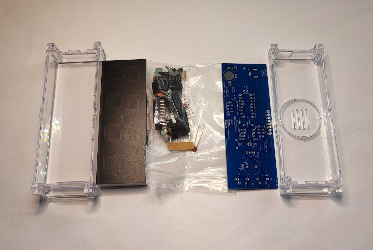

    What kit for a beginner to learn soldering? Here is another simple and enjoyable kit - a clock with alarm and temperature measurement based on a large 7-segment display, all realised on a double-sided board based on through-hole assembly and available to buy for just under a dozen zloty.
    DIY clock kit parts: PCB, large 7‑segment display, bag of components, and clear acrylic case pieces
    The kit includes the board, a set of components, the display, as well as a neat acrylic case. You will additionally need a 5 V power supply, but such probably everyone, as well as of course a soldering iron with accessories. The cheapest one will suffice:

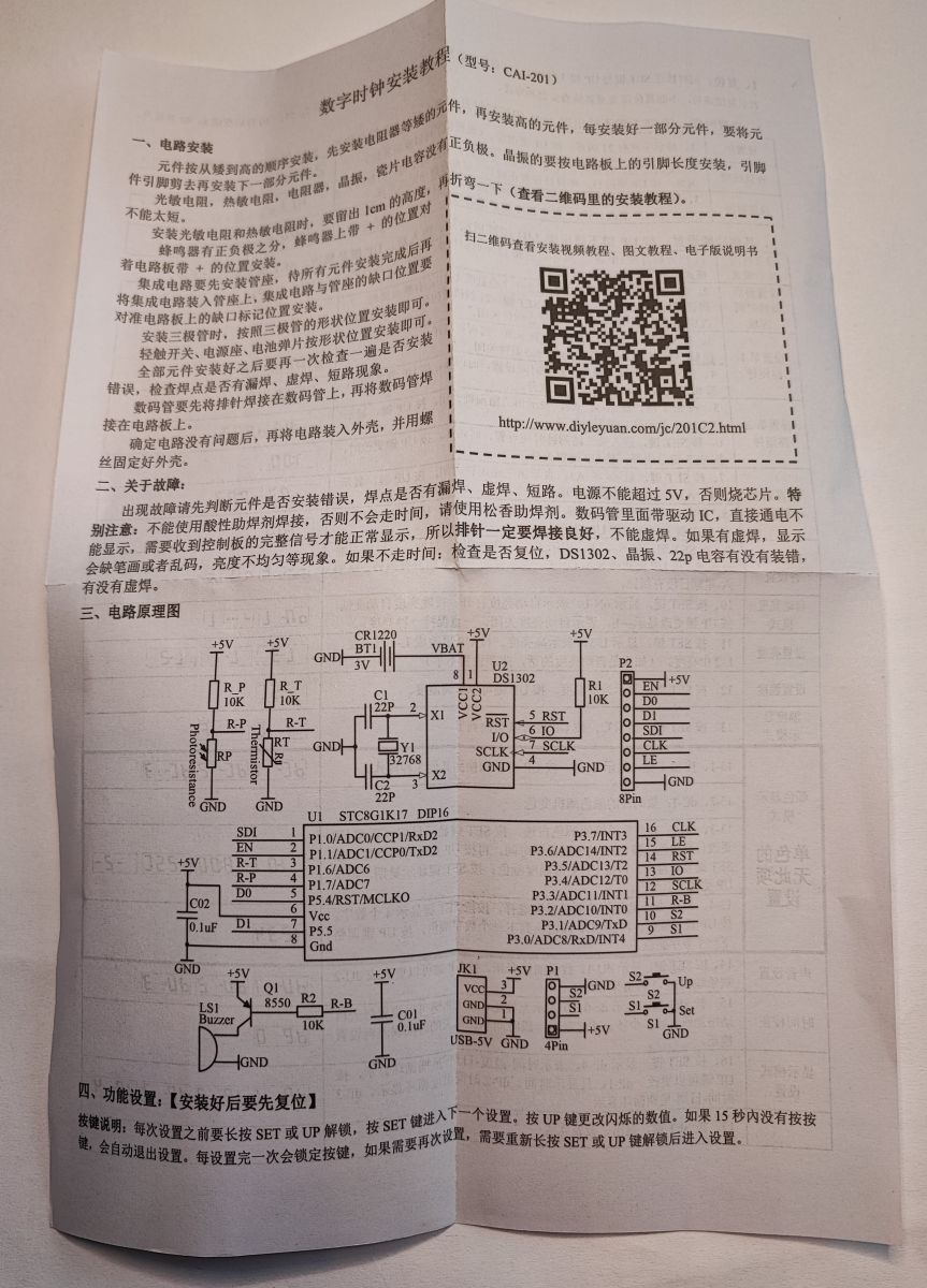

    I also received a manual - but in Chinese, will this help us?
    Opened sheet with Chinese instructions, a step table and example display readouts Folded sheet with Chinese instructions, an electronics schematic, and a QR code
    Fortunately, there is documentation for this clock available separately on the web, you can find it by the name CAI-201.

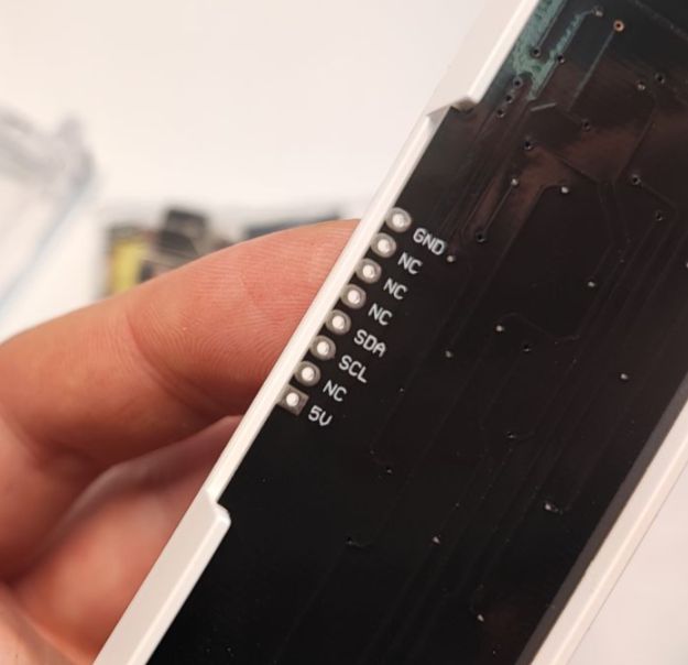

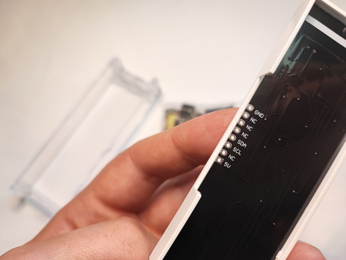

    I was most interested in the display - it is controlled via I2C, it must have a built-in controller:
    Close-up of the back of a display module showing pin labels: GND, SDA, SCL, and 5V

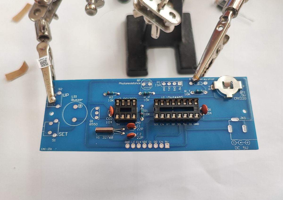

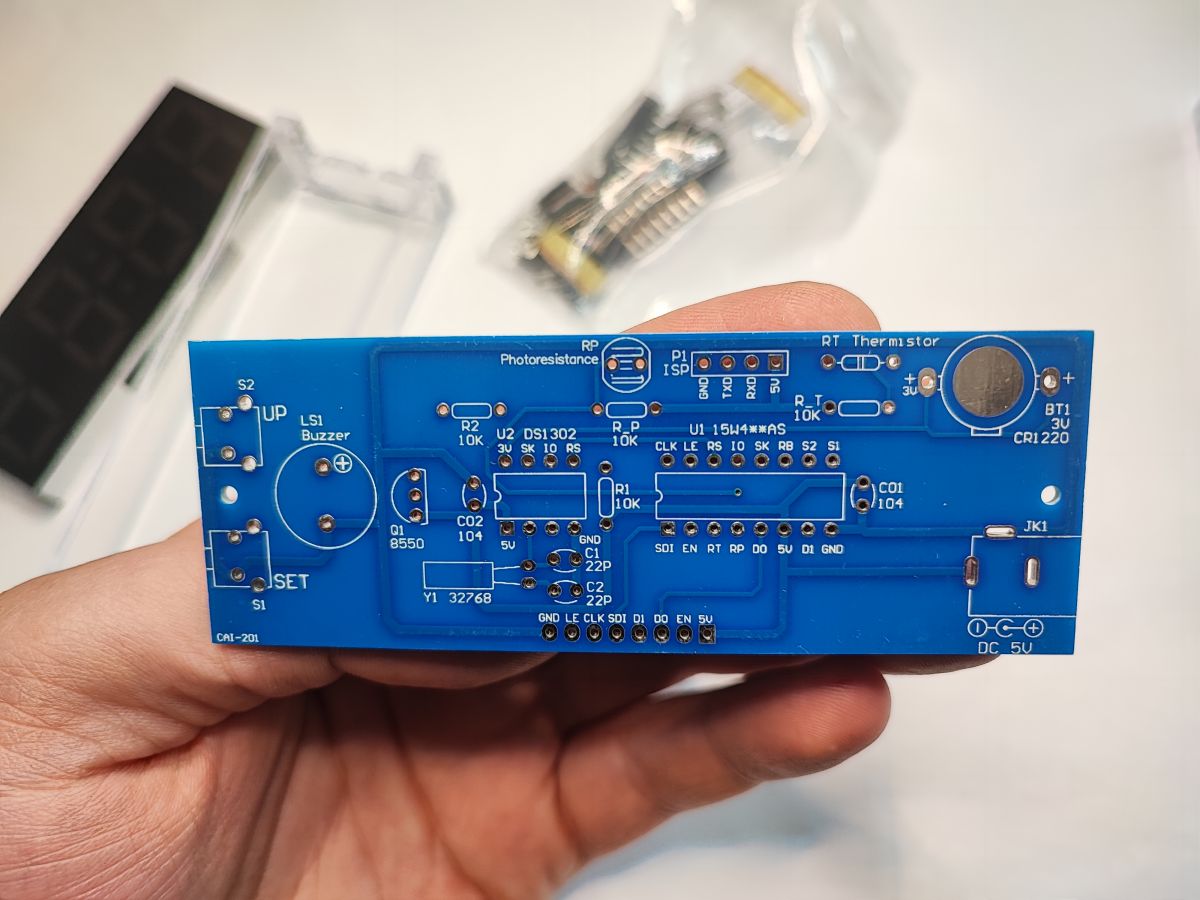

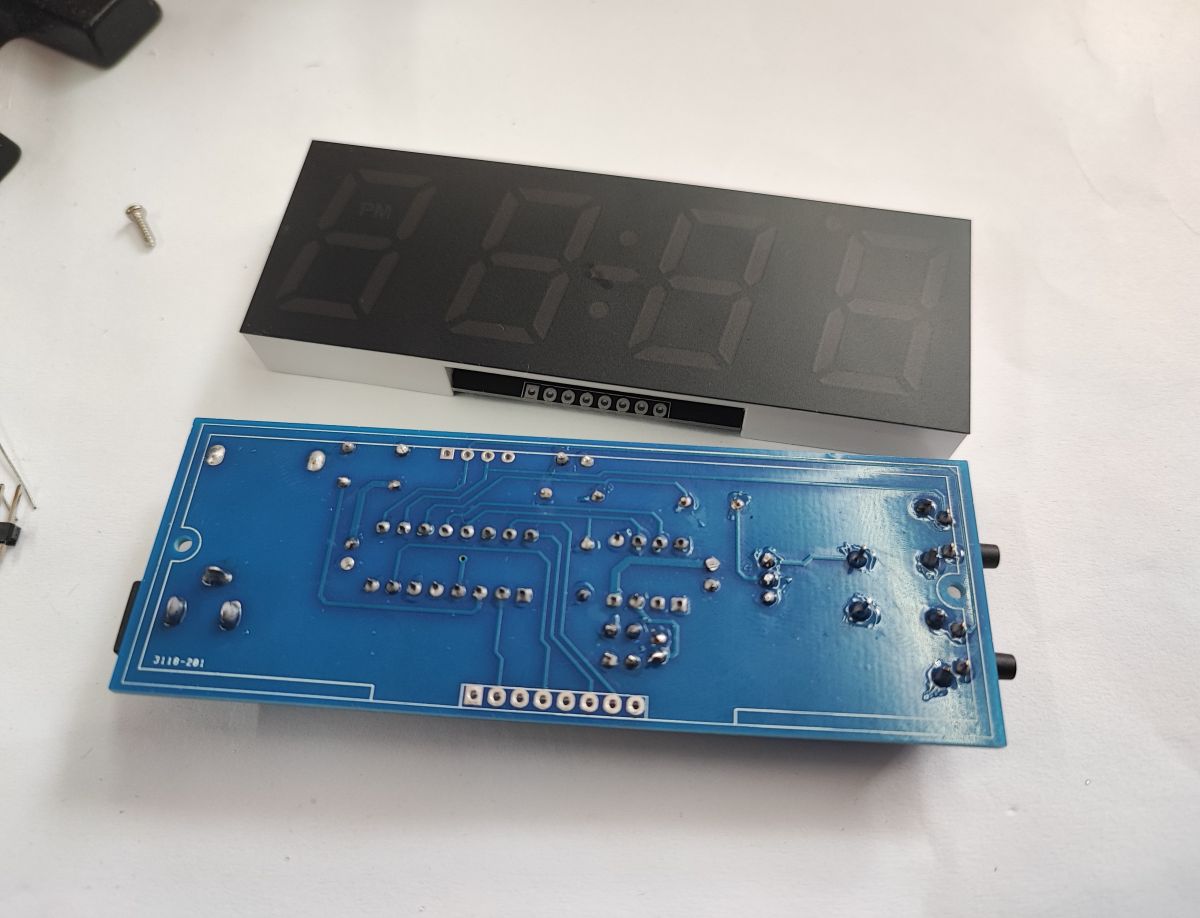

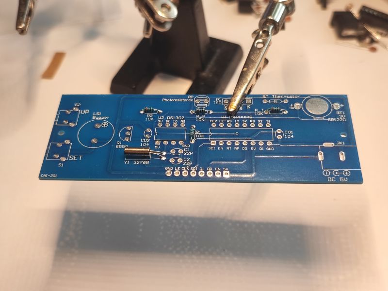

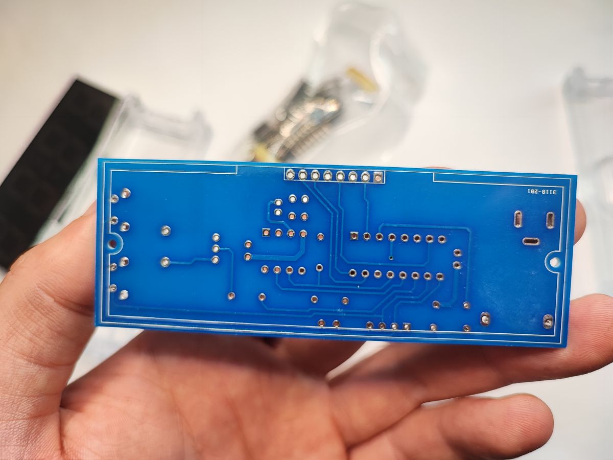

    The board is quite simple, it could probably be realised on its own with just one layer of copper, but why, as the production cost would probably not decrease at all:
    Blue double-sided PCB held in a hand, showing traces, vias, and through-hole pads

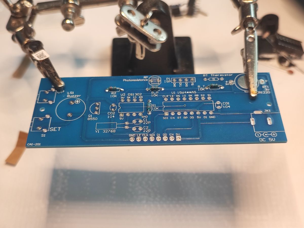

    On the description layer everything is nicely shown - orientation, symbols and component values. Rather, there is no way to get confused here - even next to the jack socket there is information that the outer contact is ground and the middle contact is power.
    Blue CAI-201 clock kit PCB held in a hand, with labeled solder pads and component outlines
    Before soldering it is a good idea to clean the board with isopropyl alcohol IPA. Then solder, starting with the smallest components. Insert the component, heat up the soldering iron (but without overdoing it), you can add a little flux to make it easier, and heat up the pad, applying the solder to it. We take care of the hygiene of the soldering iron tip. We cut off the rest of the legs.

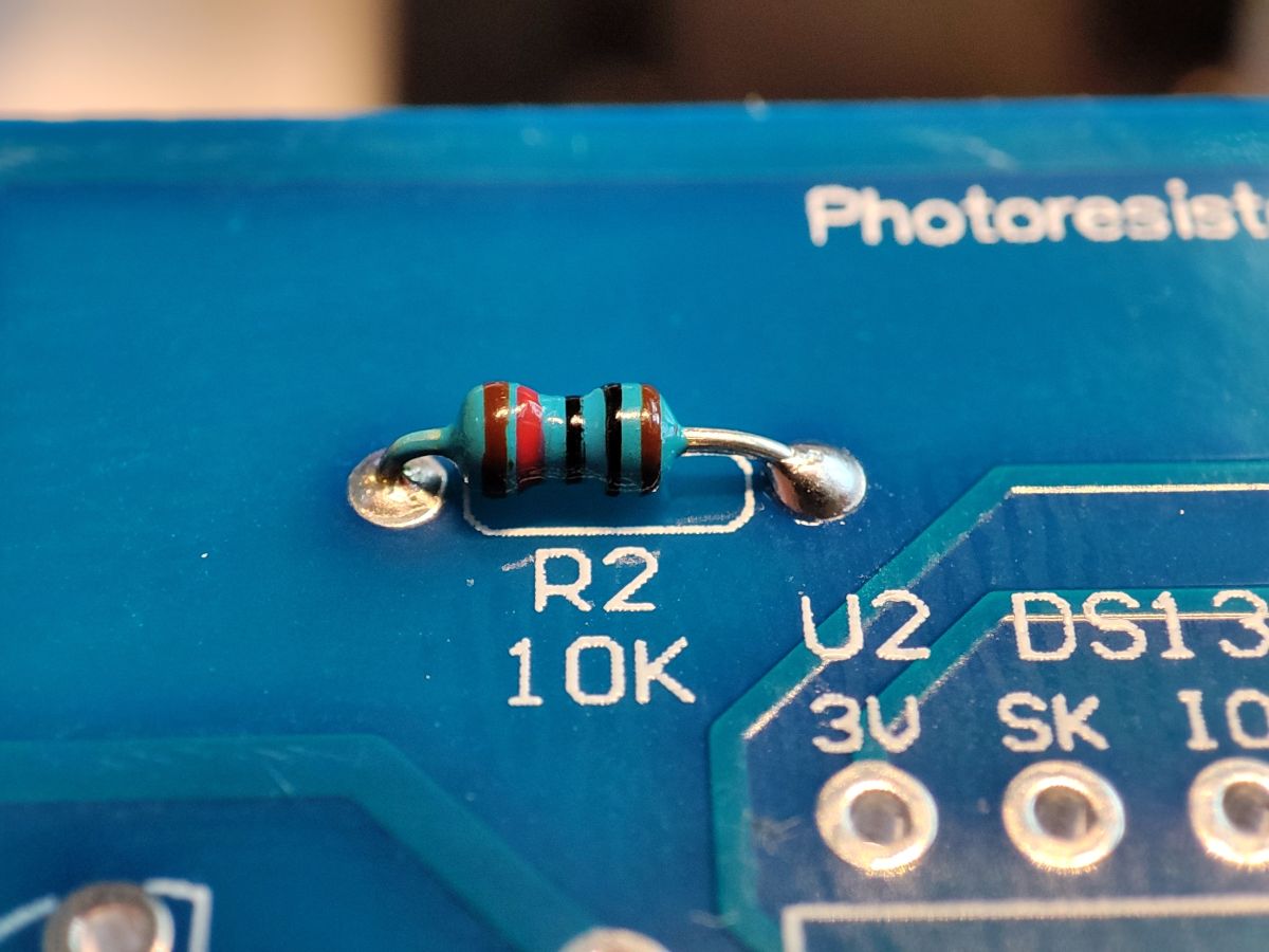

    I started with the resistors. It's best to check the values with a multimeter, unless we have signed off. It is also useful to know the barcode.
    Blue CAI-201 clock kit PCB held by alligator clips, showing labeled footprints for components
    Close-up of a through-hole resistor soldered on a PCB, labeled R2 10K

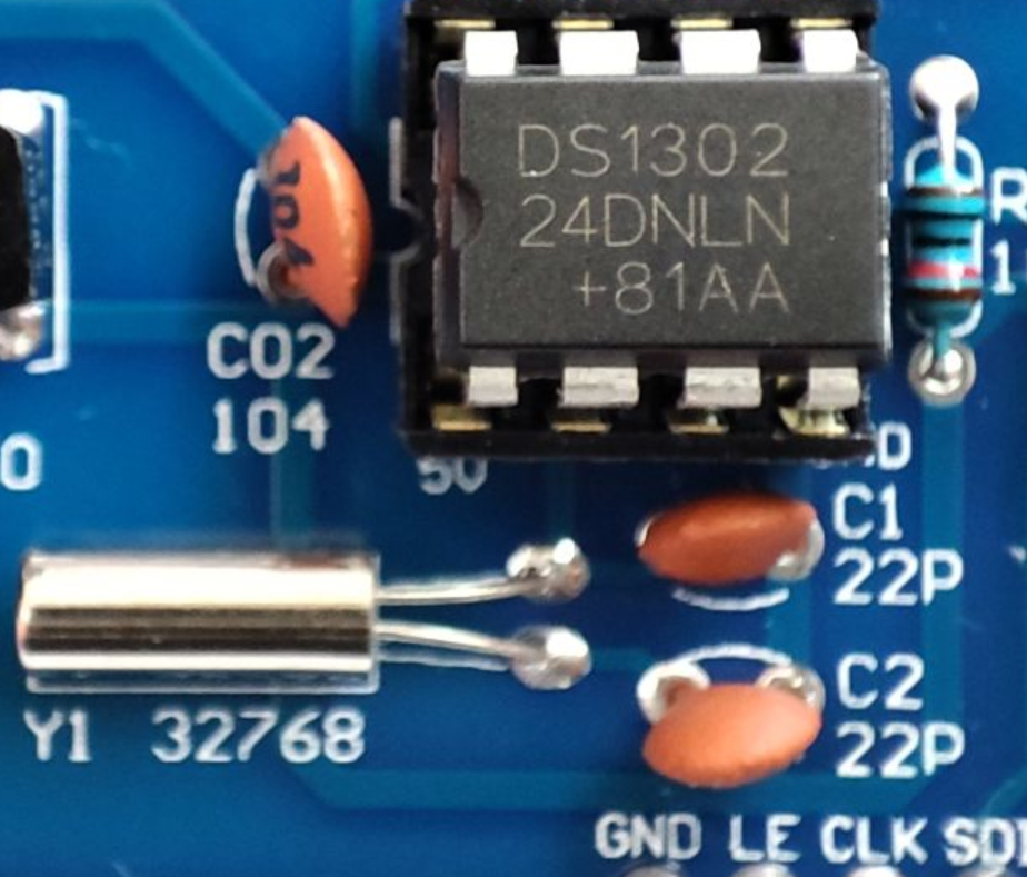

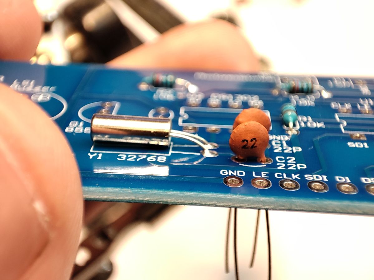

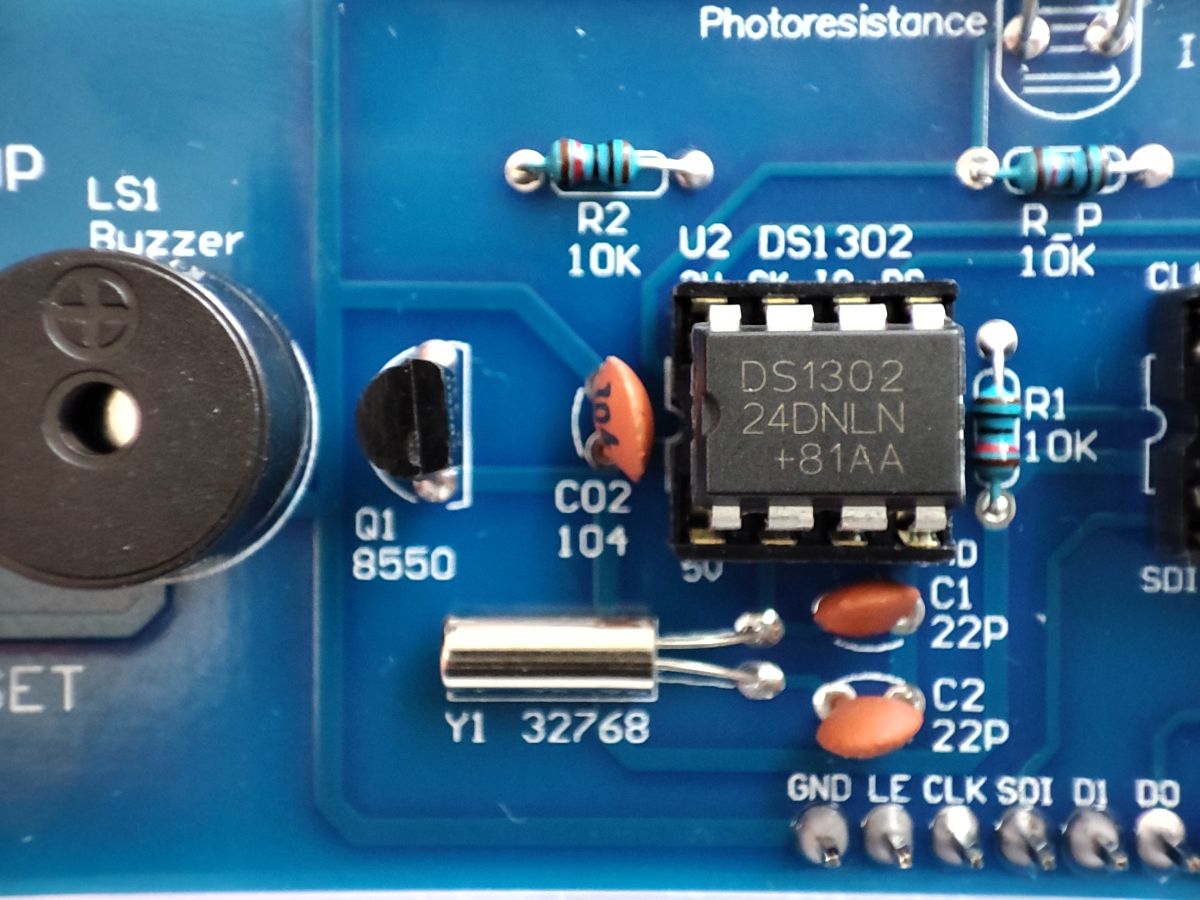

    Then a 32.768 kHz quartz resonator, for precision timing, used by the DS1302 Real Time Clock (RTC) chip.
    Blue CAI-201 clock kit PCB with labeled solder pads, held in a helping-hands clamp
    Capacitors 22 pF between oscillator legs and ground - to stabilise operation.
    Close-up of a PCB with a 32.768 kHz crystal resonator and a ceramic capacitor marked “22”

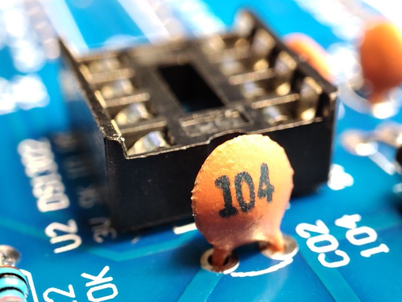

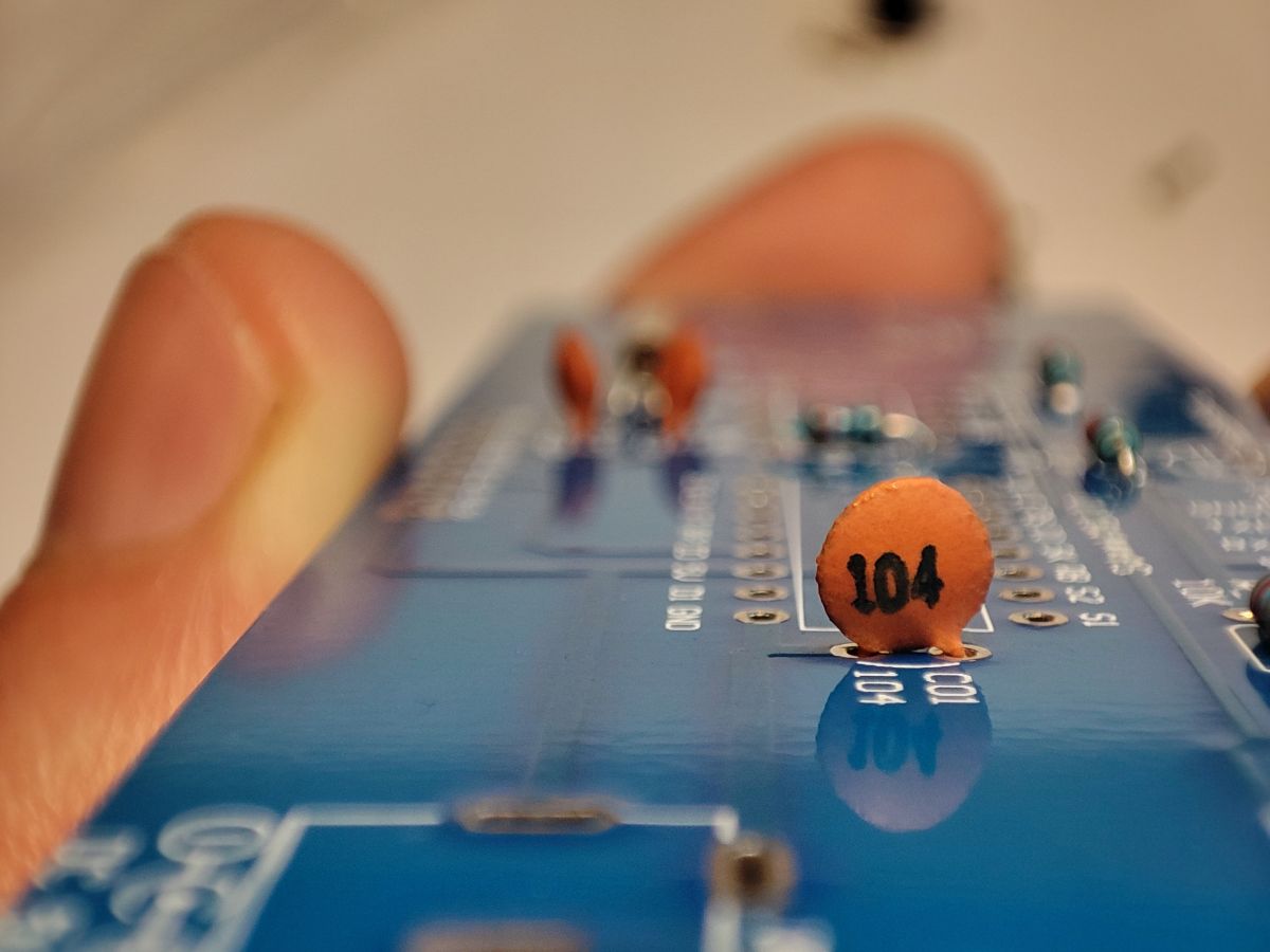

    100 nF ceramic capacitor at the microcontroller supply - for power supply decoupling. Same for the RTC.
    Close-up of a blue PCB with a soldered “104” ceramic disc capacitor and fingers in the background
    Close-up of a PCB with an IC socket and a ceramic capacitor marked “104”

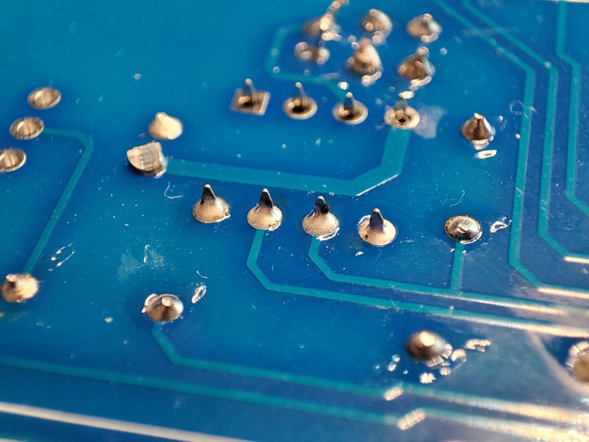

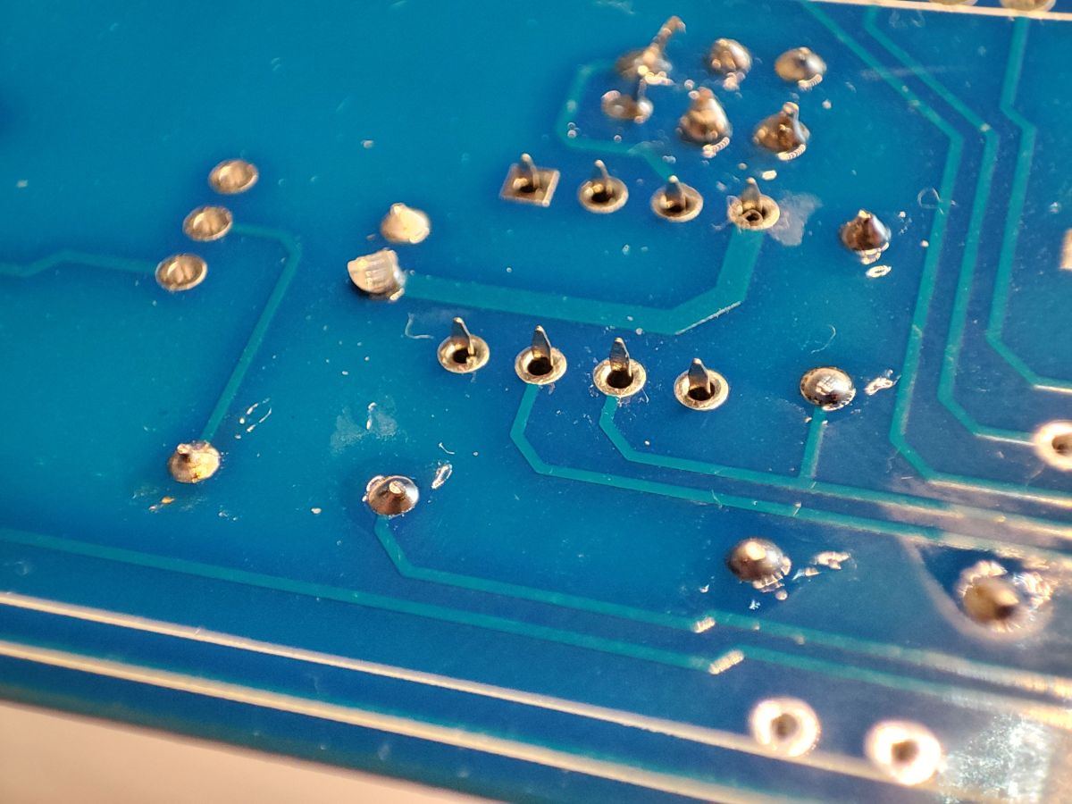

    Soldering the bases - obviously cut according to the marking on the board.
    Close-up of a blue PCB with through-holes and fresh solder joints on the underside Close-up of solder joints and traces on a blue PCB

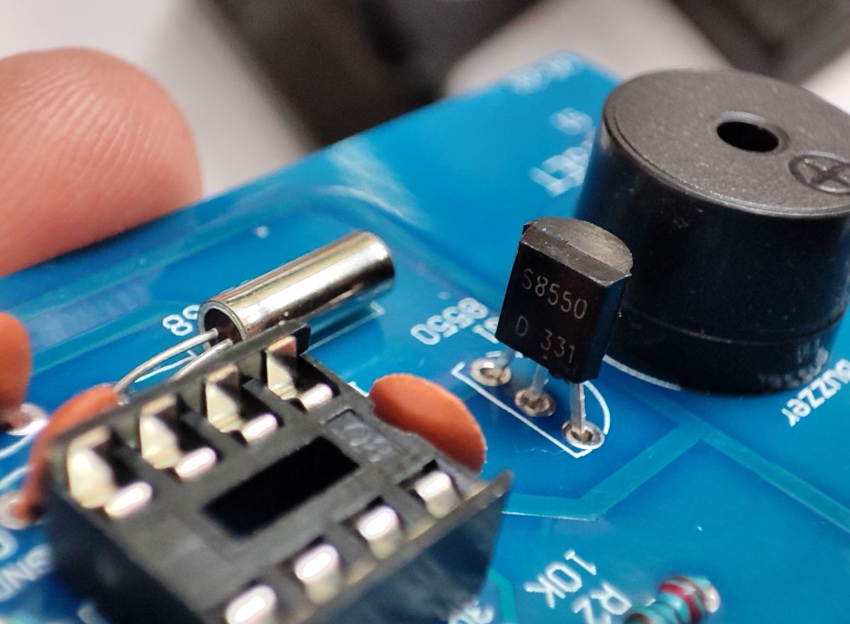

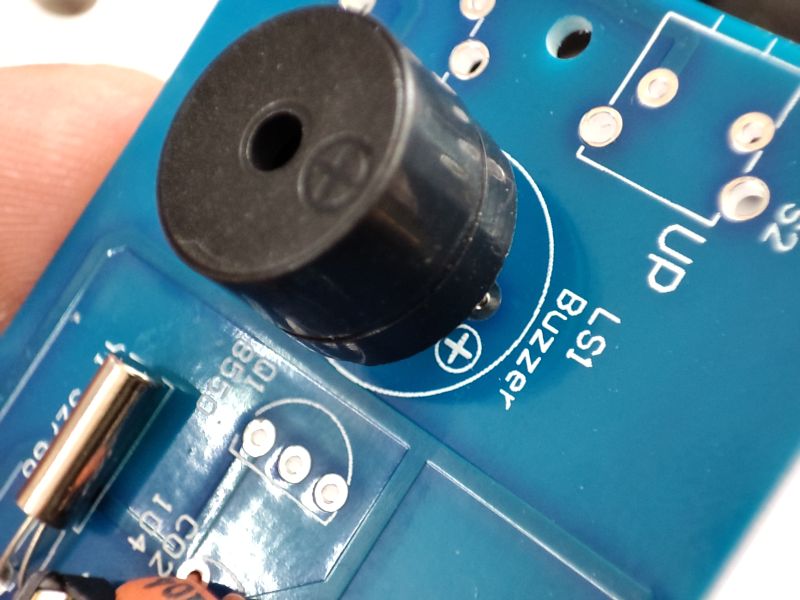

    Buzzer (buzzer) also has polarity:
    Close-up of a buzzer on a blue PCB labeled “LS1 Buzzer” with a plus polarity marking
    Transistor for switching on the buzzer (can't be soldered in reverse here either!):
    Close-up of PCB with IC socket, metal can resonator, S8550 transistor, and black buzzer

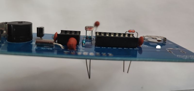

    The photoresistor is used to adjust the brightness of the clock to the environment. It needs to be left long enough to dogleg it to the case later:
    Side view of a blue PCB with a buzzer, DIP sockets, capacitors, and a coin-cell battery holder

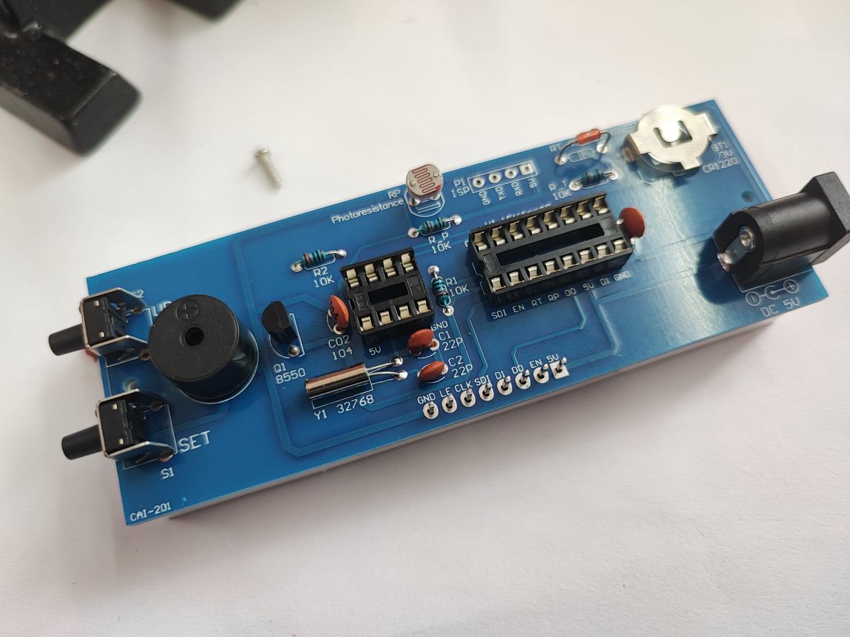

    Almost done, we finally solder the display and place the circuits in the bases:
    Bottom of a blue PCB with solder joints next to a large 7-segment display module Assembled CAI-201 DIY PCB with DIP sockets, buzzer, buttons, and a DC 5 V power jack
    Close-up of a PCB showing DS1302 IC, 32.768 kHz crystal, buzzer, and 10 kΩ resistors Close-up of a PCB with an STC 8G1K17 DIP IC in a socket and labeled 10k resistors
    A thermistor (for temperature measurement) remains and the housing can still be screwed together.

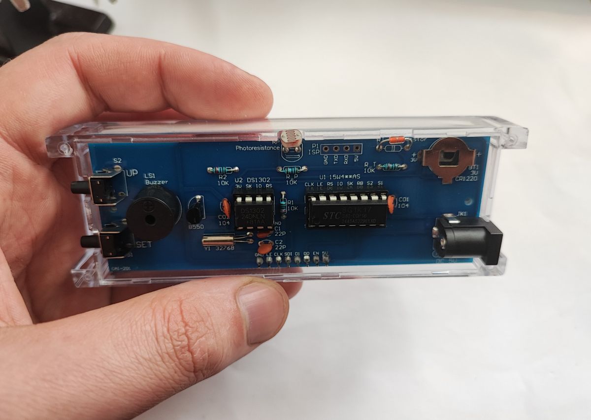

    DIY clock PCB in a clear acrylic case held in a hand; visible buttons, buzzer, and DC barrel power jack. Close-up of a screw and nut fastener in a transparent acrylic enclosure

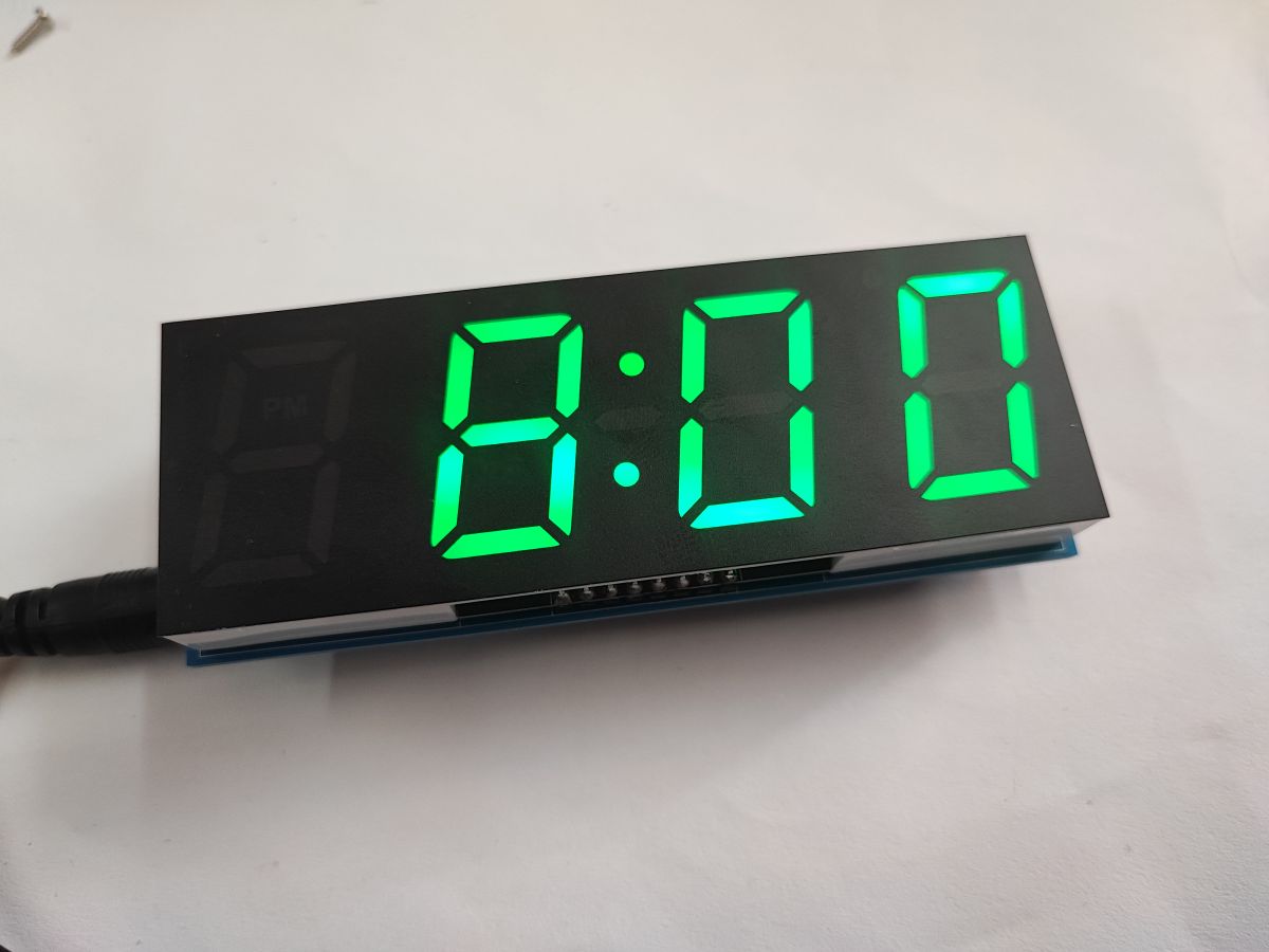

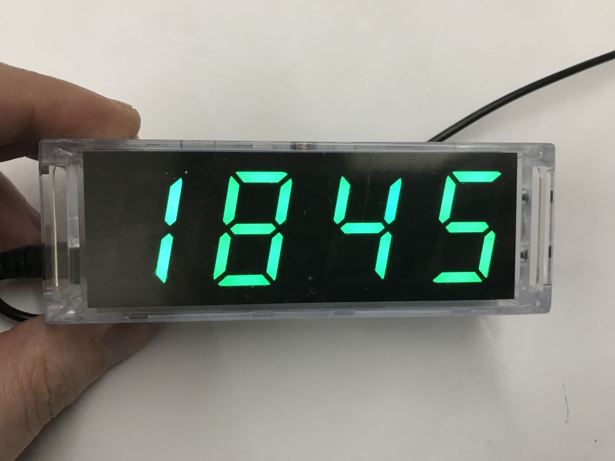

    Clock in action:
    Green 7-segment display in a clear case showing “1845” Green 7‑segment display in an acrylic case showing “17°C”
    Basically, everything works, although you have to make sure you turn off the alarm, as it is quite loud and can wake you up in the middle of the night if you click blindly.
    Plus, the whole thing can be unplugged and the battery from the DS1302 will still hold the time, so you don't need to re-set it when you move the clock to a different location.
    In summary , this was a simple to run DIY for a beginner. Basically, it rather exercises only the soldering, as the whole thing starts immediately after assembly and it's hard to run into a problem to solve here. The microcontroller in the kit is of course already programmed and the board is well labelled, so you know what to solder. Resistor values are also unlikely to be confused here, as there is essentially one - 10 kΩ. But is that a bad thing? Just in time to encourage electronics.

    or run the display separately at all - I wonder if its control protocol is known, I need to look
    The display interface is quite specific, similar to sliding register control, e.g. 74595.
    CLK and Dn are known, LE is the latch, SD1 is the serial output - allowing multiple such displays to be connected in series.

    Such a small comment.
    The instructions available in English refer to the RGB watch "CAI-201-V2".
    The watch described here is the "CAI-201", it is not RGB, it is not possible to change colours in it.

    The display has two data inputs D0 and D1, theoretically these are two different registers for different colours.
    DIY LED clock kit with clear acrylic case, PCB board, and a multicolor display reading 12:15
  • #9 21841621
    Posts: 14683
    Help: 656
    Rate: 12711
    Now I can already see the ambiguity seriously myself.... on the schematic there is indeed a display with D0 and D1, but my display has only SDA and SCL described:
    It looks like I got a different display than on the instructions?

    I suspect that depending on which display is given in the kit then that is the soft in the microcontroller and the manual itself is universal for both versions.
    Here is the translated Chinese manual, note the text in the bold table.
    • CAI-201-V2-1.pdf (189.16 KB) You must be logged in to download this attachment.
  • #11 21841654
    acctr
    Posts: 4554
    Help: 389
    Rate: 2021
    On the one hand it's bad that it's something different, but on the other hand you have free prock pins that can be used for e.g. DCF77 when writing your program on STC.

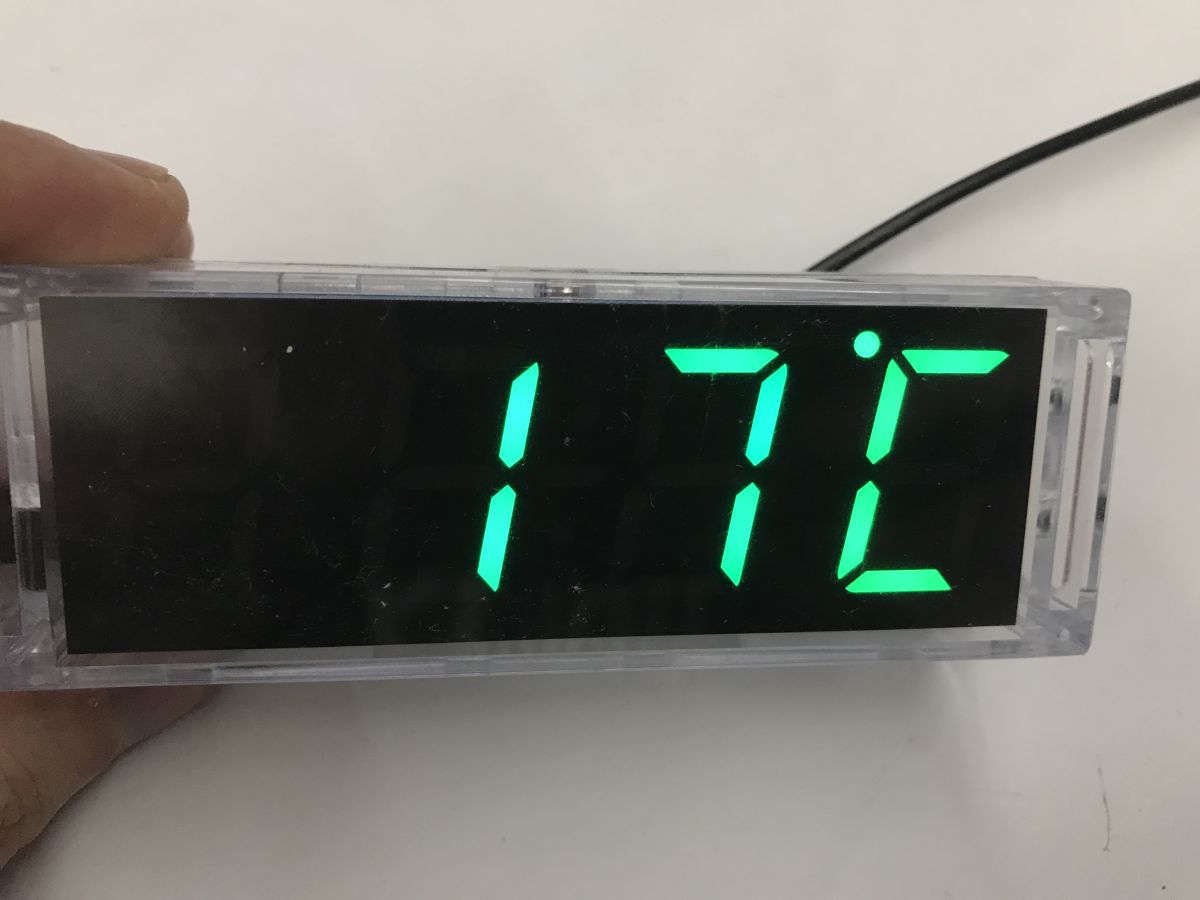

    Does it run fairly stably? Any lag, acceleration? Temperature measurement holding up?
  • #14 21842080
    bubu1769
    Posts: 8061
    Help: 1176
    Rate: 2367
    Watch like a watch, it works even well.
    The temperature can be adjusted in the settings.
  • #15 21842234
    Ktoś_tam
    Level 40  
    Posts: 5332
    Help: 504
    Rate: 2881
    music wrote:
    Is it reasonably stable? Any lag, acceleration? Temperature measurement holding up?
    It has a time correction. You can add or subtract a given number of seconds each day.
    The temperature is also set according to a standard temperature. Does the thermometer indicate the correct temperature? Yes 100% I am not convinced. It would have to be checked in a wider range.

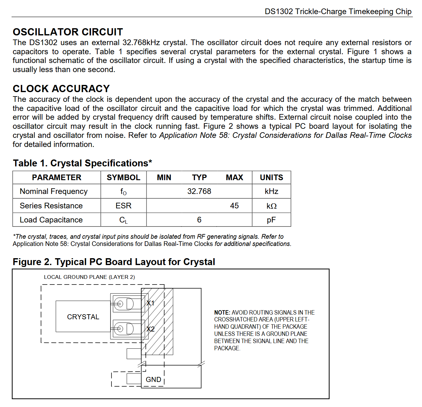

    st_krzysiek wrote:
    The only flaw I have noticed is that the villain is in a hurry. Like 2-3 minutes a month.
    The only flaw I've noticed is that the villain rushes
    Because there somehow the resonator connection area is done strangely. According to the DS1302 datasheet, the resonator directly connects to the X1, X2 outputs.
    DS1302 datasheet excerpt: 32.768 kHz oscillator notes, crystal specs table, and typical PCB layout for X1/X2
    Here, 22pF capacitors have been added to each X1, X2, for ground, and obviously no one has bothered with the advice about a ground field under the resonator and as short resonator/circuit connections as possible. The base probably doesn't help either.
    Close-up of a PCB with DS1302 IC, 32768 crystal, and 22 pF capacitors C1 and C2
    Maybe you could try if by replacing C1, C2 with such C0G/NP0 with smaller tolerances or possibly gently changing these C1, C2 you could correct the frequency. Or maybe replace the resonator?
    The topic of correcting rushed clocks on 32768Hz resonators was discussed in this thread: https://www.elektroda.pl/rtvforum/topic4082811.html
  • Clock runs 2–3 minutes fast per month
    #20 21843993
    Ktoś_tam
    Level 40  
    Posts: 5332
    Help: 504
    Rate: 2881
    st_krzysiek wrote:
    The only flaw I have noticed is that the villain is in a hurry. Like 2-3 minutes a month. In principle in the bedroom this may not bother you because a person has better movements in the morning because they have "overslept" :) but a DCF would be useful. The rest OK
    Setting 'd9 0' (second character is mirror image 9), penultimate setting as per instructions. Divide 120 or 180 seconds by 30 days and subtract that many seconds in this setting.

    Rate: 333
    And in human terms what is decoupling can you explain ?
  • #28 21854231
    acctr
    Posts: 4554
    Help: 389
    Rate: 2021
    If you start a tractor with a trailer loaded with bales, without the flywheel the engine would stall. The flywheel, thanks to the stored energy, temporarily drives the shaft until the next ignition.
    The same with the capacitor - the energy stored in it is used to supply power in brief moments when current consumption increases rapidly. In digital systems, this is the norm.

    lukas198820 wrote:
    And in human terms what is decoupling then can you explain ?
    A capacitor can only "decouple" the DC component, i.e. not allow vibrations to pass through by short-circuiting them to ground through capacitance - I guess that's what it would be in this case.
  • #30 21854262
    acctr
    Posts: 4554
    Help: 389
    Rate: 2021
    sq3evp wrote:
    A capacitor can only "decouple" the DC component, i.e. not allow vibrations to pass through by short-circuiting them to ground via capacitance - I guess that's what it would be in this case.
    But why should it short circuit to ground? The voltage collapse alone when switching the digital outputs reaches the ground potential.
